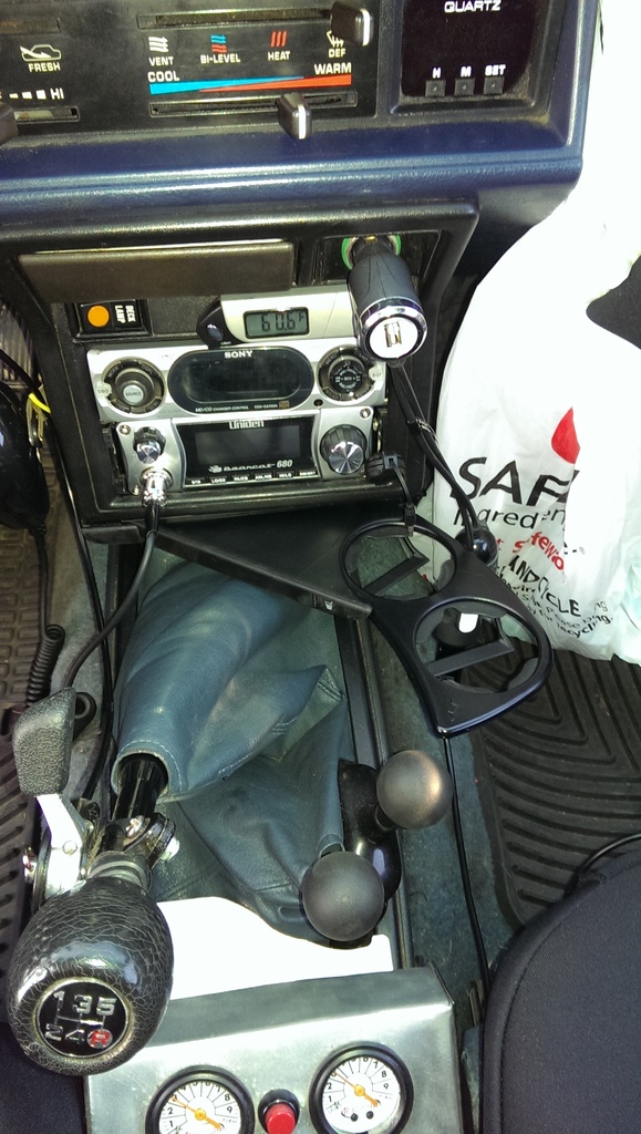

here s a picture of my truck in 5th with the cup holder out

So, today I mounted my new VW cup holders:

From: L.A. CA.
How did you secure yours? ^^ ^^
Magic.
With the help of some aluminum stock I'm not completely done yet though. Still have to clean up the metal.
