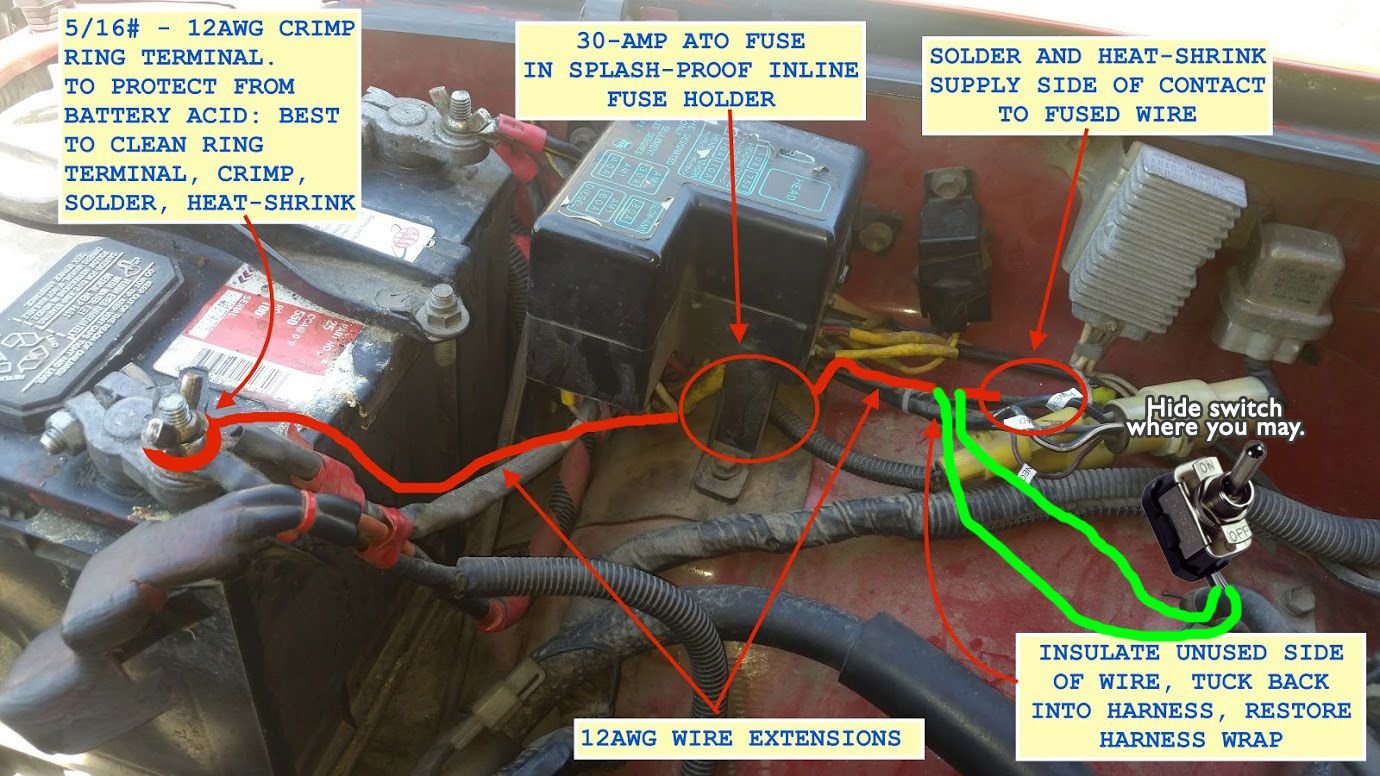

Working on my click-no-crank issue. You mentioned:
*CAVEAT:
I RECENTLY REALIZED THAT WHEN THE STARTER RELAY IS WIRED CORRECTLY ACCORDING TO SCHEMATIC, IN THE UNLIKELY* EVENT THAT THE STARTER RELAY CONTACTS CLOSE* OR SHORT* FOR SOME REASON STARTER WILL CRANK EVEN WITHOUT IGNITION SWITCH BEING TURNED ON. IF PARKED IN FIRST GEAR, TRUCK MAY MOVE AND CAUSE AN ACCIDENT. A KILL SWITCH IN SERIES WITH THE RELAY CONTACT PIN IS HIGHLY-RECOMMENDED. JUST KEEP WIRE RUN TO MINIMUM.
Was wondering if this (see illustration) is what you meant by in series.......as well do you mean pin 4 (is this the actual relay contact pin?) to wire in series?

Never mind.....talked to a mechanic friend. The graphic I modded above works like a charm......love having that kill switch!
There you go! Sorry was out running around last couple of days
