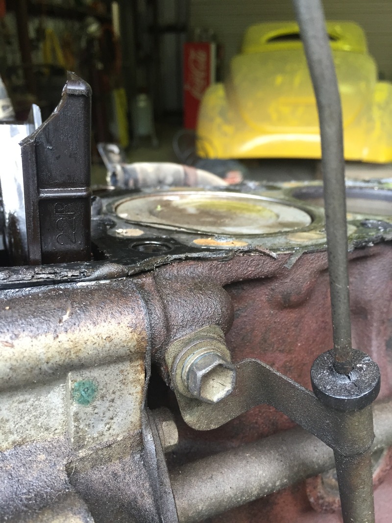

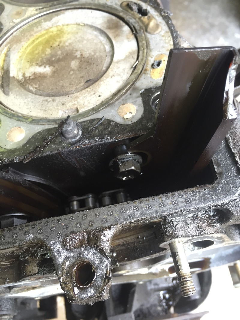

Update.
Engine is mostly apart and found the damage. Timing chain guide just fell apart when i pulled the timing cover, was still in one piece before. #1 cylinder had been steam cleaned and gasket split. Not sure if it was broke or a result of removing the head but #4 was also split just not leaking.

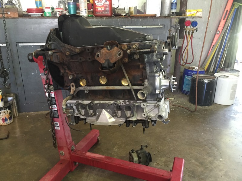

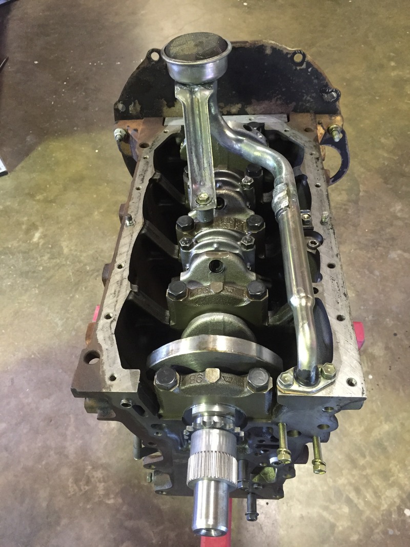

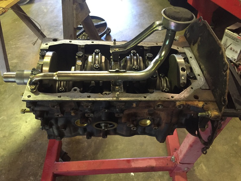

Not much of an update but going back together with it. It was extremely caked with oil buildup. All the bearings and rings are in great condition and i had the head surfaced and valves reground.

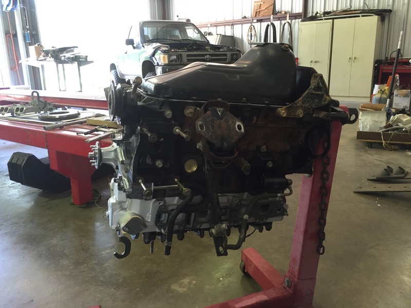

Few pics for along the way.
Mostly done now, will get more pics up in a few days

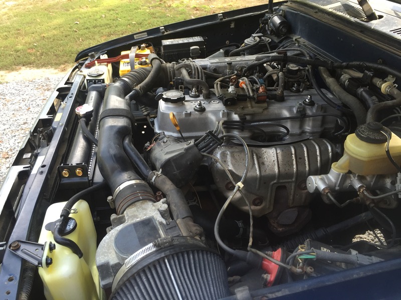

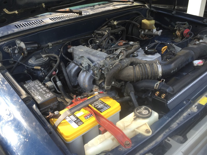

Motor in the bay

Runs great. But has an occasional miss at idle and just off idle. Need to track that down pretty soon.
Closed off screw on throttle body and engine still runs?!! I thought it would kill and i havent found a vacuum leak anywhere.

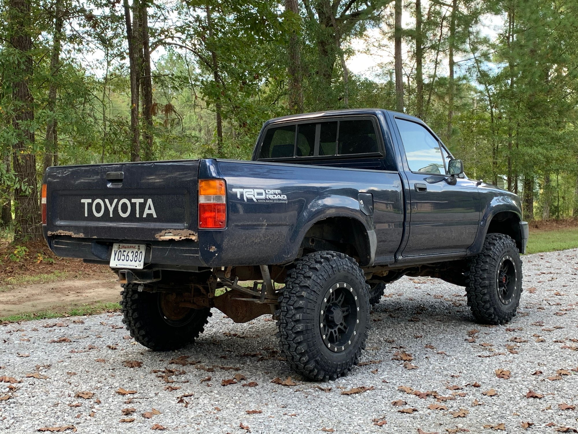

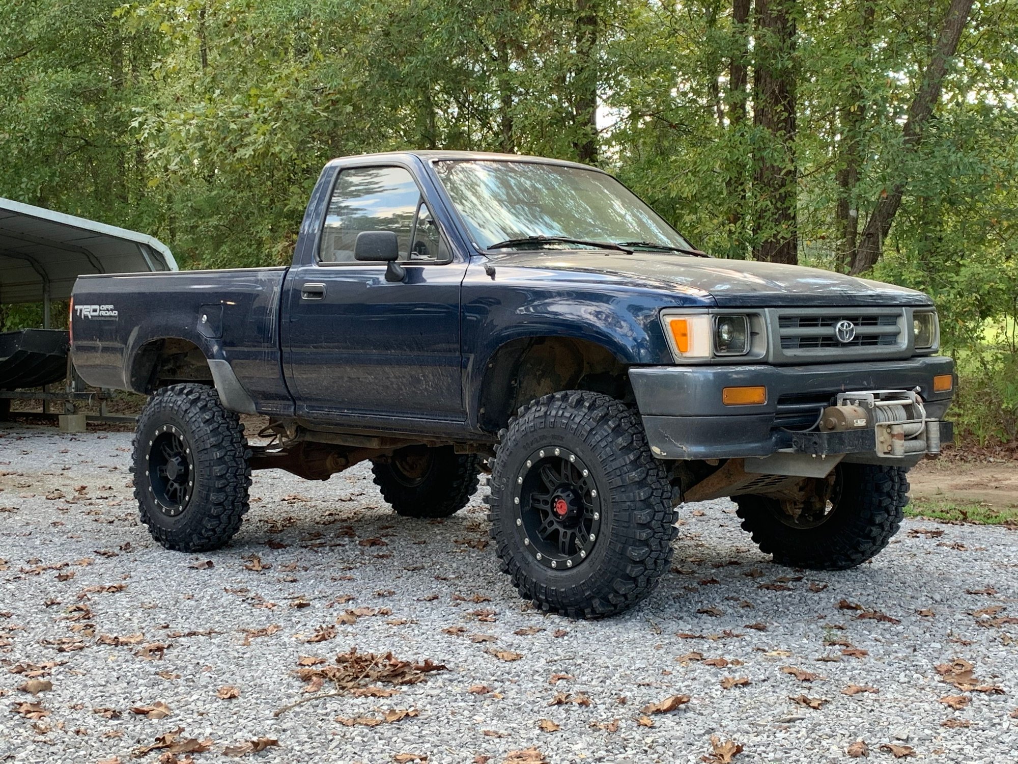

Havent really been active for a while. I will update with a few pics from the last.

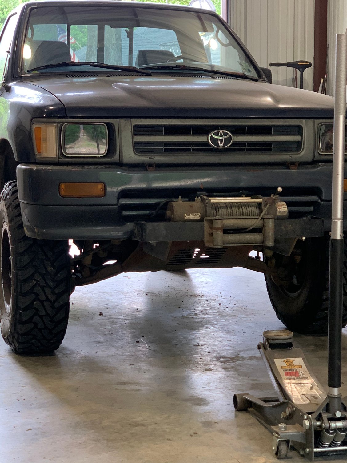

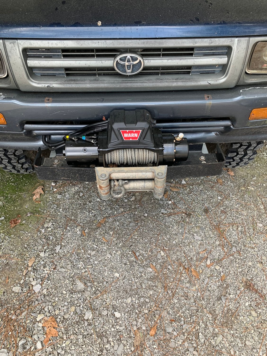

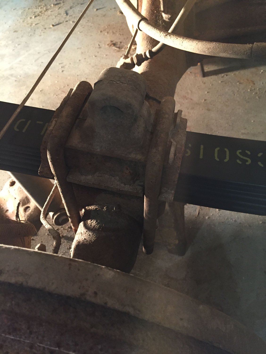

Added a winch but still working on getting it setup, need the aluminum bracket with the new controls, new battery, and larger alt.

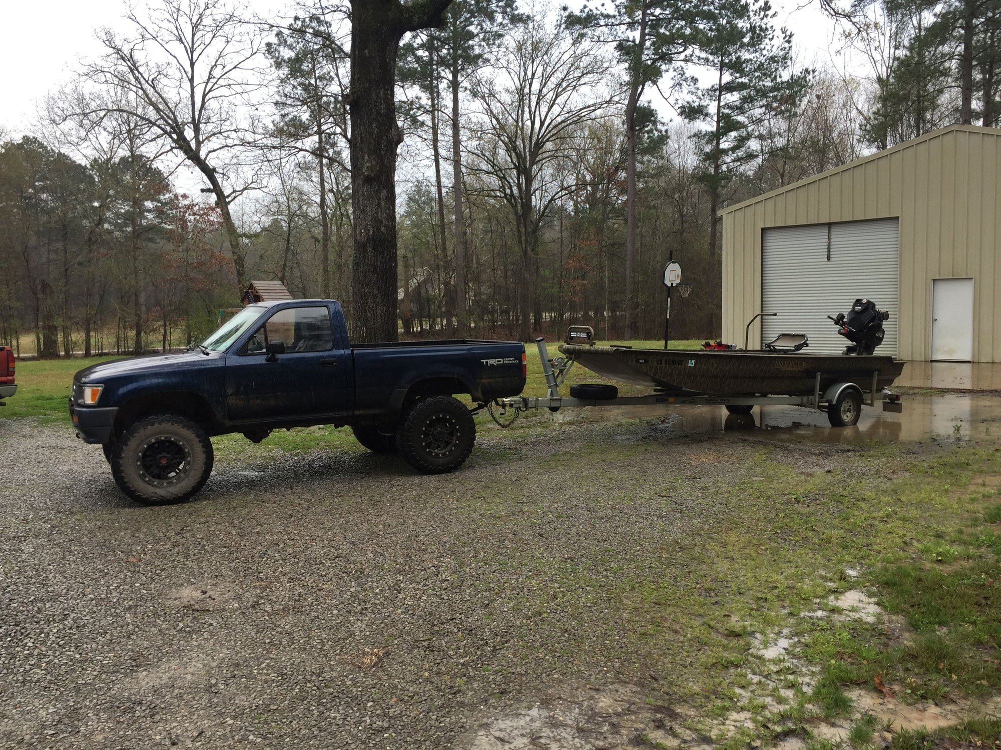

Rear springs were not up to the task of hauling the boat, so i picked up some OME cs019r to help out, crazy ole std cab rear end i had to make it work. Made a bushing for the perch alignment hole.
No pic but also swapped the windshield wiper controls for one with intermittent run, so much better in the drizzly winter days!

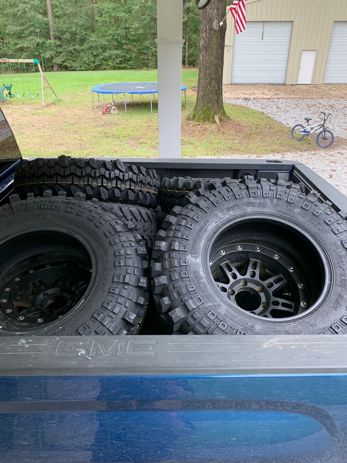

Its been 5 years and i figured it was time for some new rubber so Interco we went. 33x9.50r16, very similar to the toyo mt in specs but very different in looks.

Winch mounting is just some 3” or maybe 4” galvanized angle i had laying around. Its like 1/4-3/8 thick, plenty strong, mounted into the factory tie down and tow hook holes.
Old Mar 15, 2021 | 07:36 PM
  #56
Regency's Avatar
Joined: Mar 2015
Posts: 167
From: Alexandria, LA

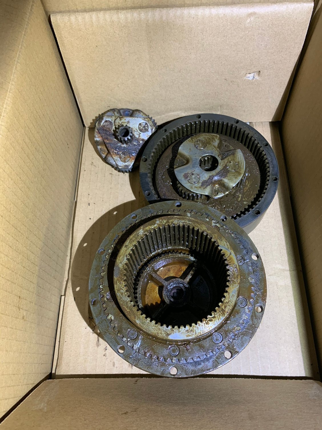

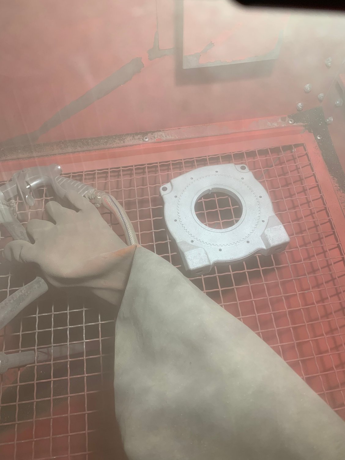

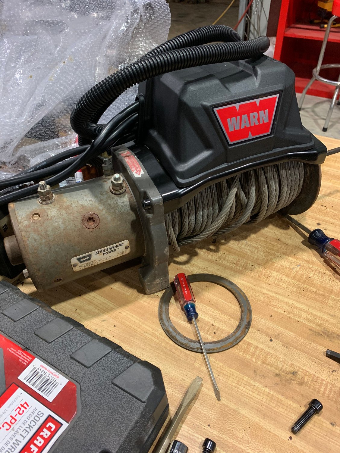

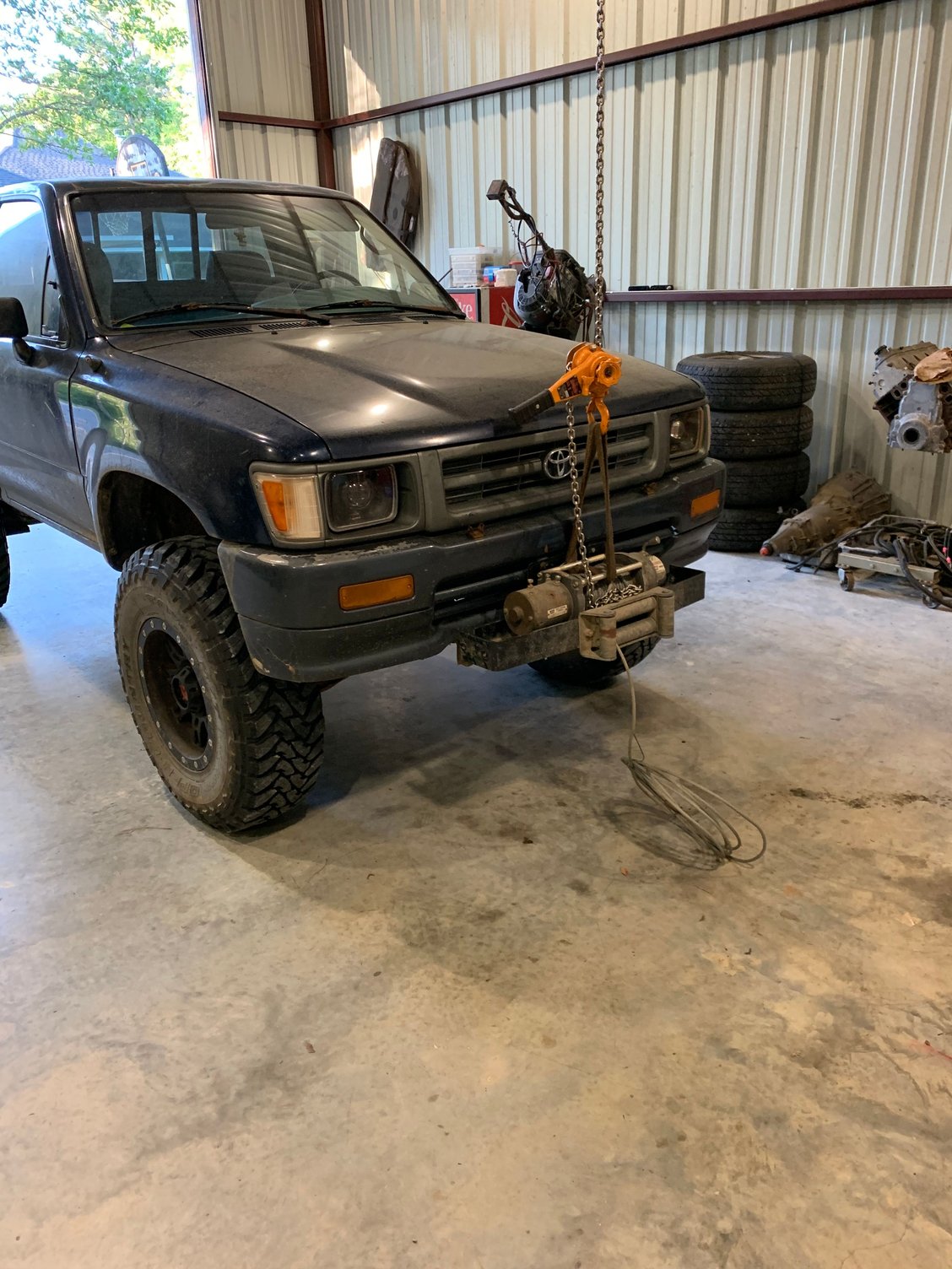

Finally got around to getting this wrapped up (mostly)!
Couldnt get it to free spool so i tore it down and realized just how nasty it was. Soaked the internals in vinegar for a week, then cleaned them up with a crushed walnut in the blaster. Blasted all the original metal parts and repainted them bc i couldnt have it not match the new control box!!
Runs like a champ now. Just need to figure out what im going to do for batt and alt. But it runs and i can use it if i have to now.
