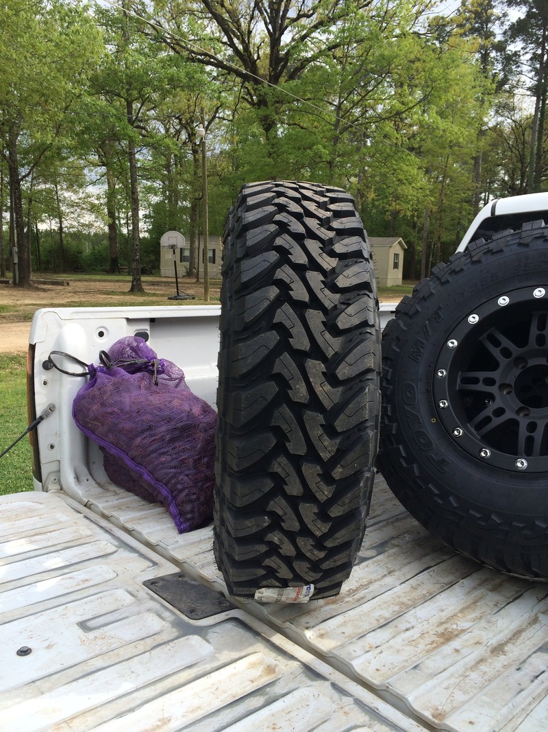

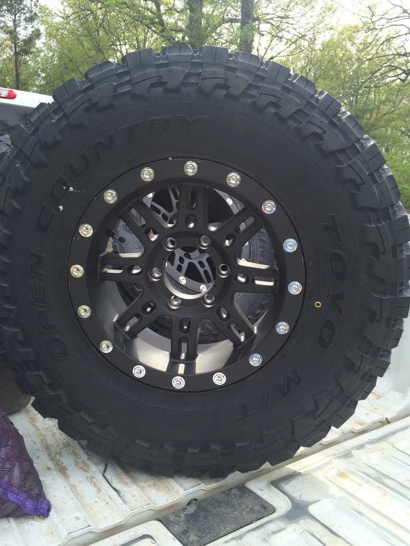

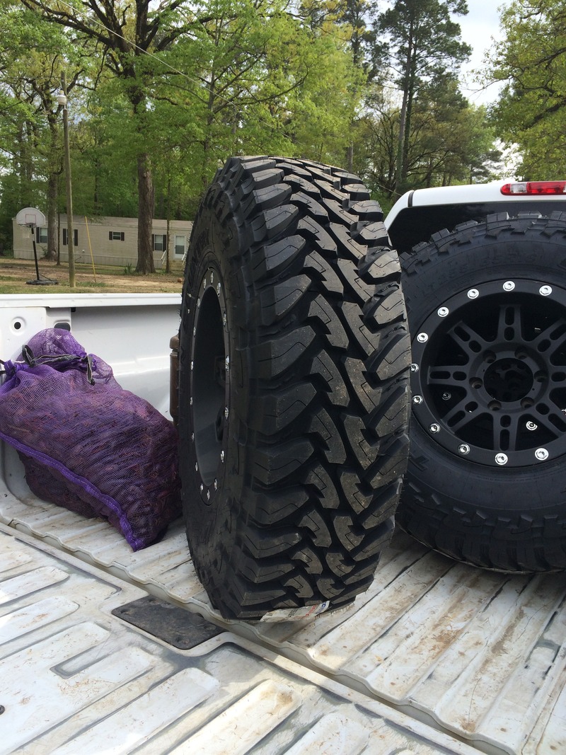

New wheels and tires ready to go on.
255/85R16 on 16x8 ProComp 7031

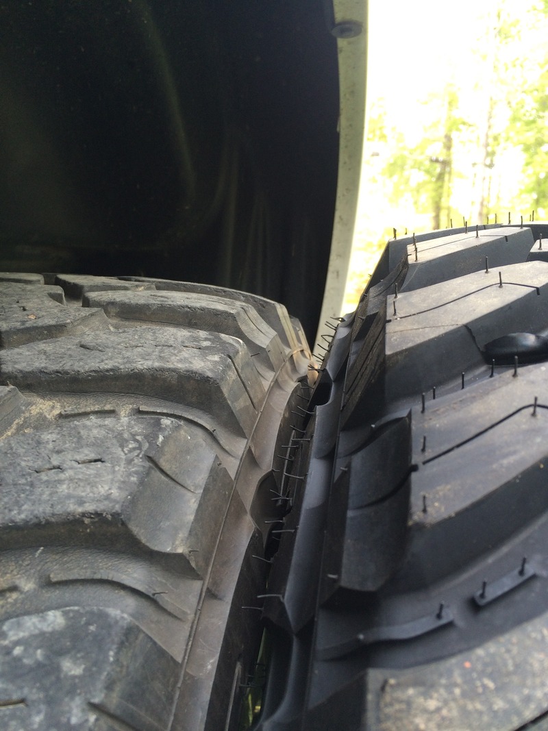

And just rolled up next to a 33x12.5 on a crew cab 3/4 ton dmax

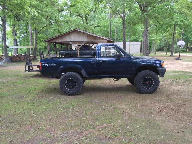

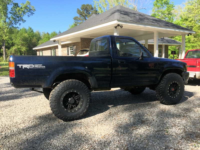

Stock front and 2wd leafs in rear. 1.25" gm blocks were removed because height was too tall. After front is lifted with the spacers I may need to put them back in but I will see then.

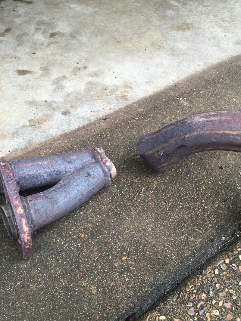

Well i guess i found the exhaust leak!

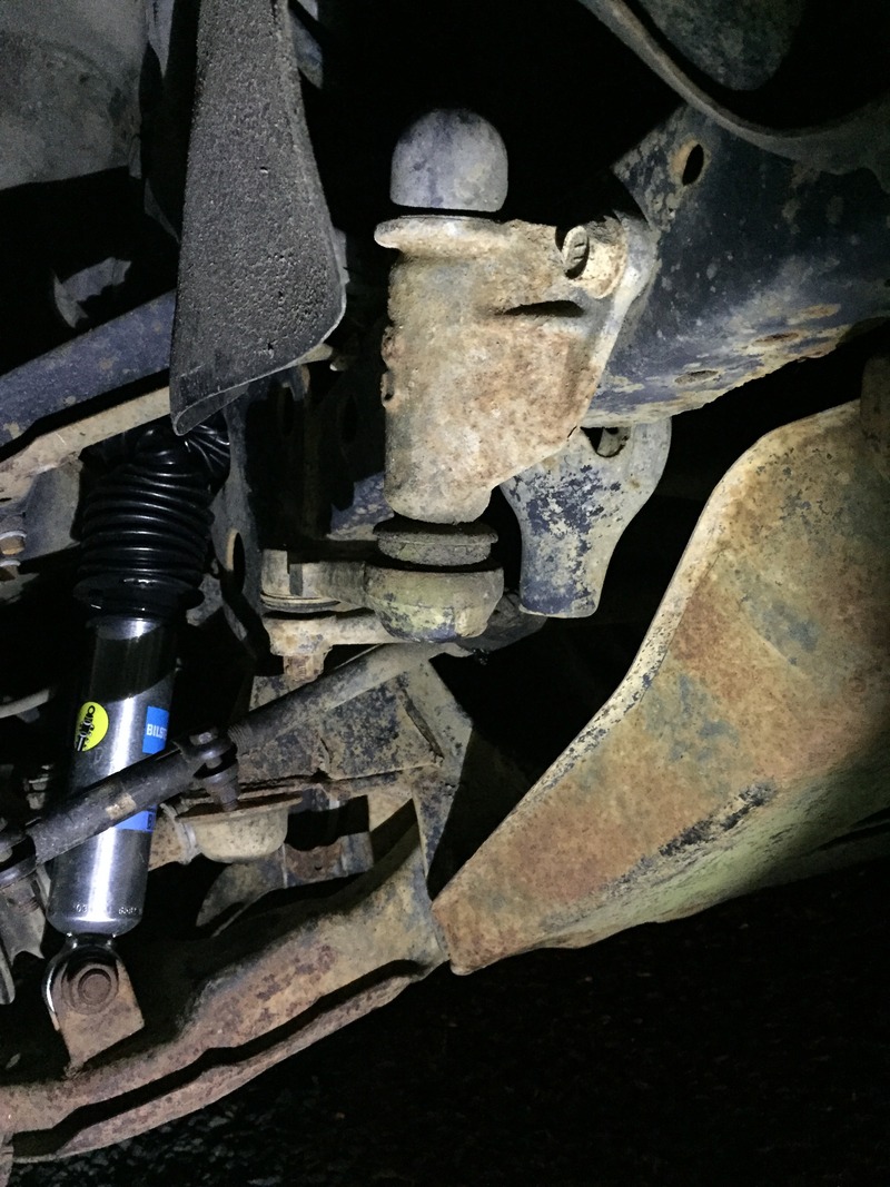

Front shocks are in! But found another wore out part... Idler Arm is shot. So im going to do the brass bushings, im just not sure which arm this one is. I know i need to get a FA5040, but what is my current one? Can it be determined what size the shaft is by the size of the wrench size of the nut?

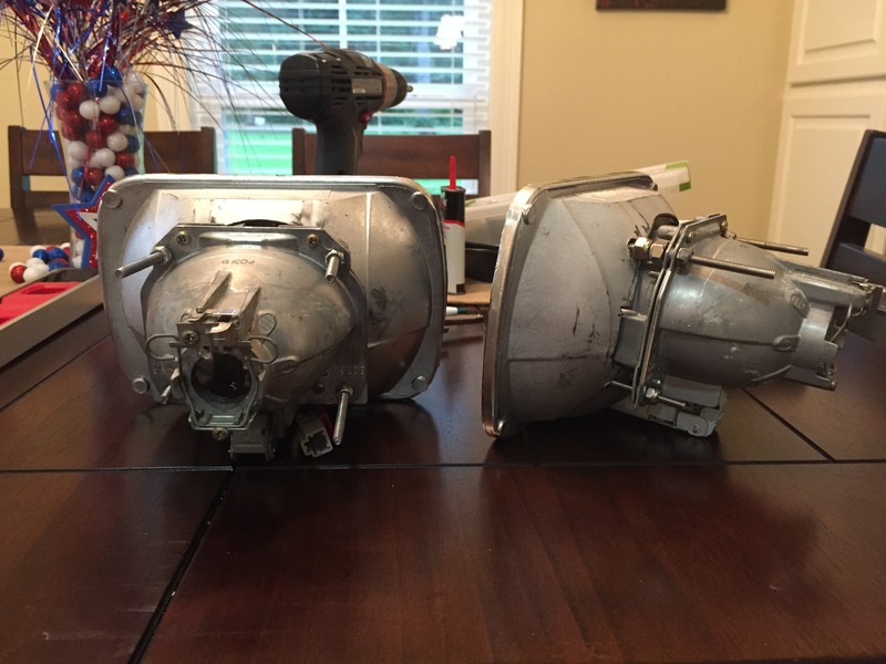

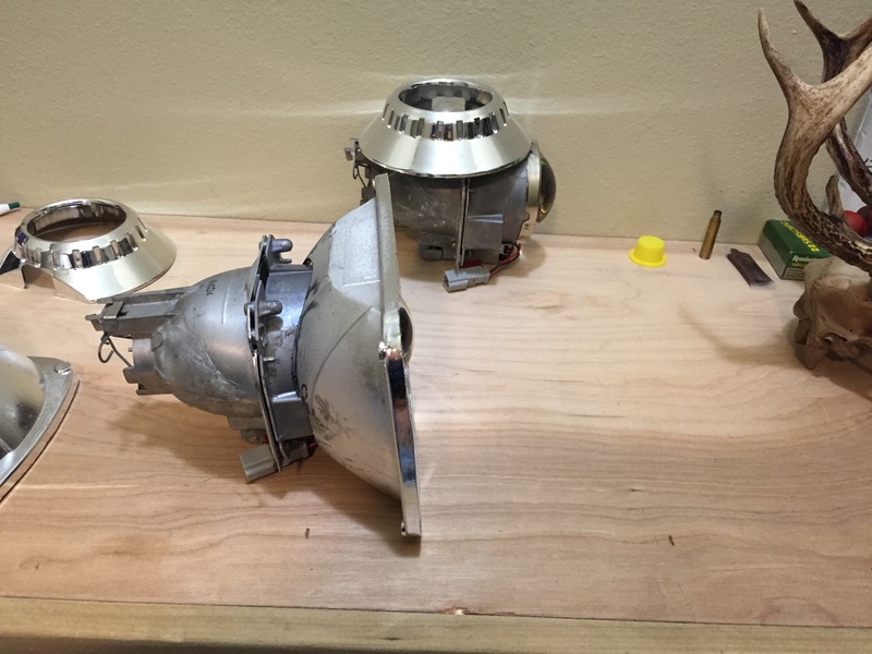

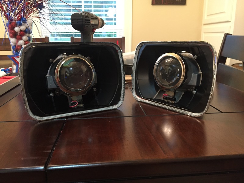

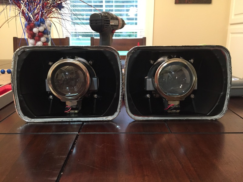

Got both projectors fitted in the housings. I need to install the relay harness so i can test cutoff rotation of the projector.

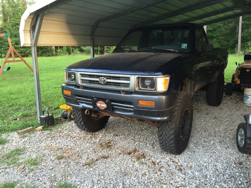

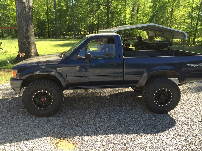

Not really. Was driving it to just see how it was going to be when the upper radiator hose decided to blow. Also doing a Projector retro in the lighting section..

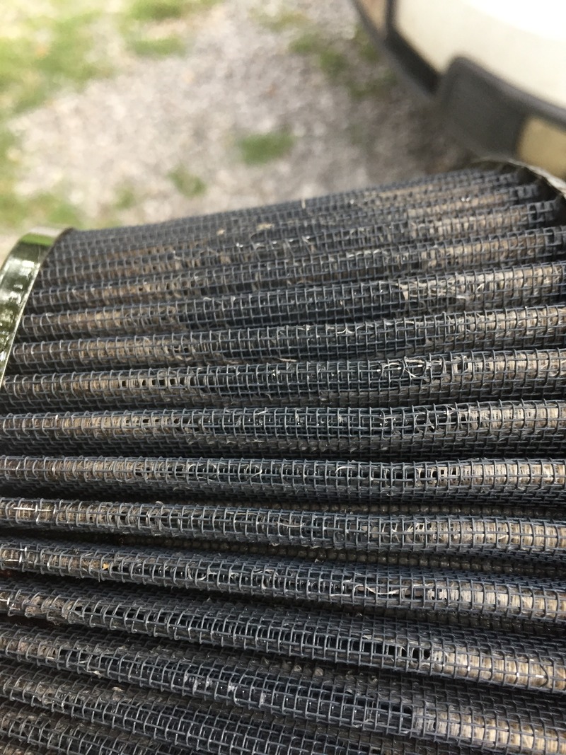

Cleaned the K&N filter today and the cotton gauze pretty much just washed right out of the middle of the filter all the way around it.
I did not install this kit and wouldn't have ran it but I don't have a factory box!
So the ? here is should I just purchase another filter like it has or resort back to finding an OEM box? I mean would that filter really give and benefit other than its washable and reusable? Stock filters are cheap and a dime a dozen from the parts store.

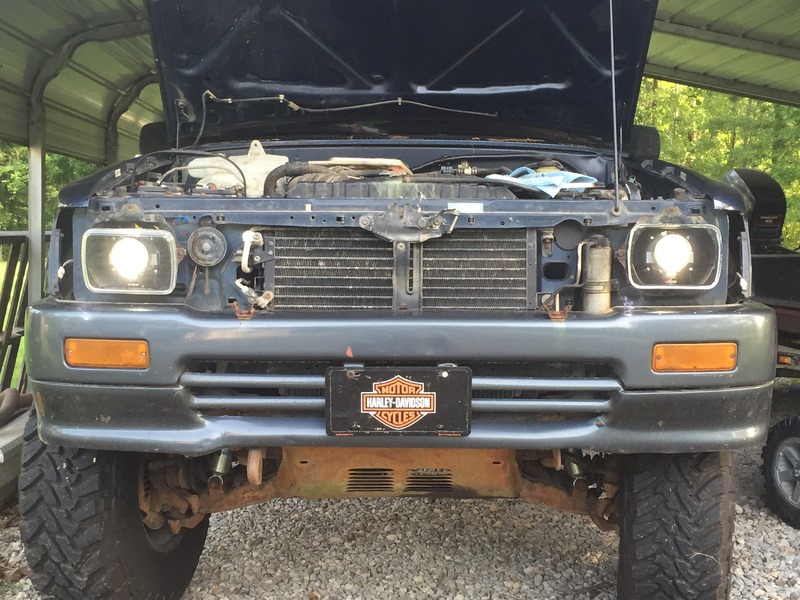

Headlights are in finally! Cant hook up the battery yet and cant drive the truck!!

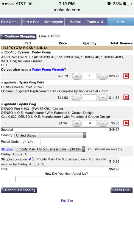

Lets get this started..!!! Probably take a little while to fund up all the parts but i hope i can get this done before October gets here!
About all i will be buying from RockAuto right here. I got in a little rush and didnt want to take the time to figure out which O2 sensor i needed so i may pick that up from them later.
Will be doing the 1200# clutch from Marlin, Gasket set with stainless freeze plugs and OSK timing kit from 22RE Performance, hoses from toyota, and a radiator locally.
