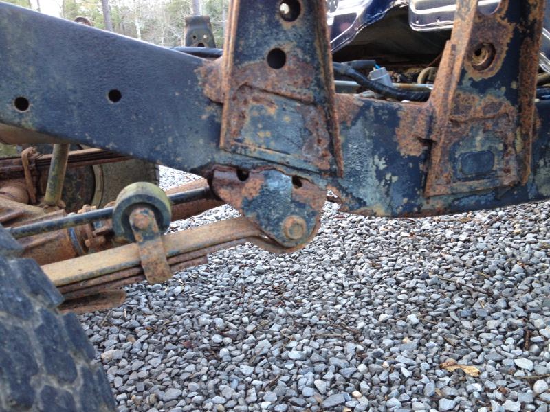

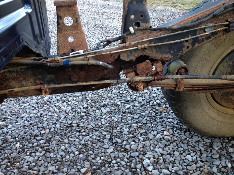

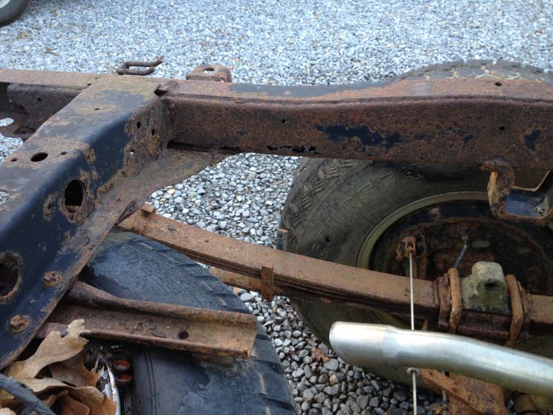

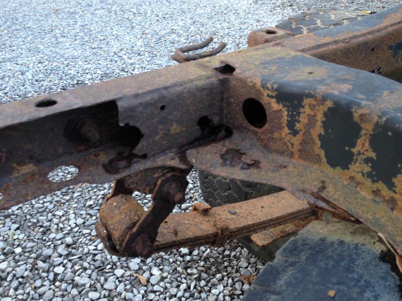

Started working and cleaning on it today i knew of a few problems but 1 turned out worse than i originally thought. Dang stealership got me with the itll be here tomorrow so no fuel pump hanger today. A few pics since we all like pics!
This was a truck from Illinois as you can tell by the rust everywhere!

Wow man that frame has got some rot.Looks like a truck getting eaten by the Maine winters.Nothing a lot of time and some metal and a welder and grinder can't fix.Should be a great project,i have fixed much worse.Also please redo those sketchy looking rear brake lines with the compression fittings on them.Just flare them properly and run all new lines,you will thank yourself.Also make sure the rear spring hangers are both in the same location on each side so your truck goes down the road straight.Personally i would use 1/8 plate and cut out the rot and weld that plate in in the same spot as the piece you cut out so it looks factory.Just get some cardboard and use that to make a template by putting it against the frame and tracing it and then transfering that to your plate.It really isn't that bad and really a piece of cake if you're lucky enough to have a plasma cutter which i don't so i use my angle grinder with a cutoff wheel which will get the job done just takes a little longer.Just take your time and fit your pieces so they fit tight before welding.Then when done patching cleanup the frame and coat it with Master Series Silver,2 or 3 coats,followed by Master Series Ag111 Black.This stuff is inexpensive and is a moisture cured urethane and seems to work great.Pm me if you need the info on where to buy this stuff i get mine from a guy in connecticut that personally uses this stuff everyday.Hope this helps you.
Old Mar 8, 2015 | 07:59 AM
Regency's Avatar
Joined: Mar 2015
Posts: 167
From: Alexandria, LA
Thats exactly what i plan to do if i cant find a good frame section to put in. I have paint that has Zinc in it i plan to base coat or prime with.

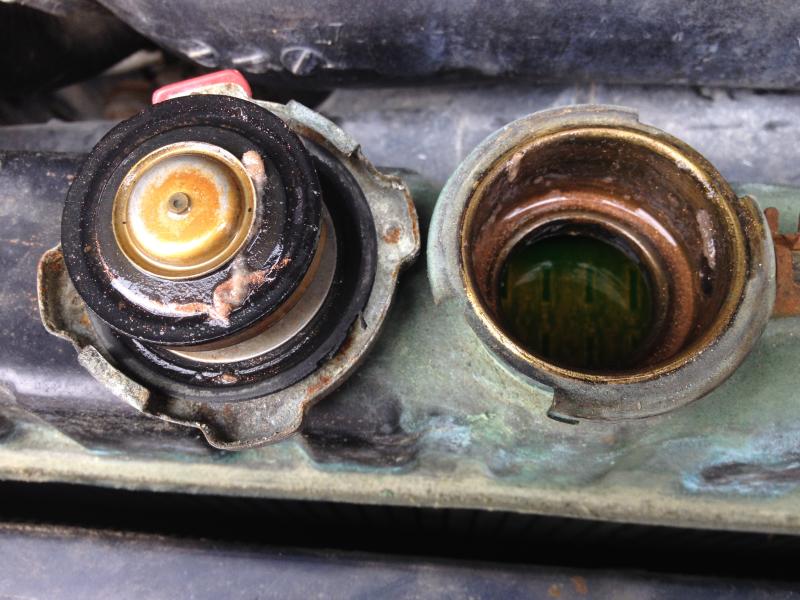

Gave it a little PM this morning. Checked the water and found this copper colored stuff in the rad cap, i hope its just anti-seize on the cap.

My thoughts are that cooper colored stuff is a block sealing product aka headgasket in a can but i could be wrong.
Old Mar 8, 2015 | 12:12 PM
slimbobaggins's Avatar
Joined: Mar 2013
Posts: 123
From: VA
Or perhaps stop leak in the radiator?

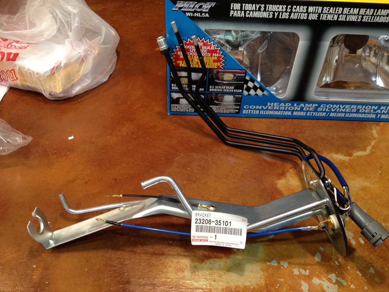

Picked up the hanger today and this week while i was gone my headlights came in so i can get ready for the retro. I tried to get part #'s in the pics and where the lights came from if anyone is interested in doing a retro. These are the perferred housings.

Tank is soaking in vinegar. Been 24 hrs now and still looks rough on the bottom. Hopefully it will get cleaned up before more parts start coming in. Checked fuel pump and no operation so I installed the jumper and checked voltage (11.9) and ground (9.7ohm). Through the pump while on the starter voltage was 6.7. Got on Rockauto and ordered new pump, filter, pump gasket with screws, sender gasket with screws. The sender works properly but the metal flange rusted off the plastic top of the sender.

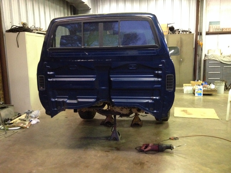

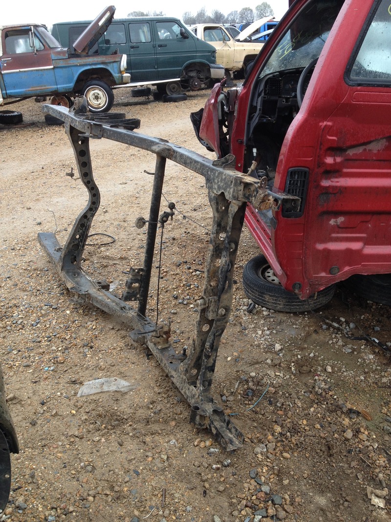

Alright found a donor truck at a junk yard!! Going tomorrow to get the rear section torsion bar mounts back.

Rear section is home!

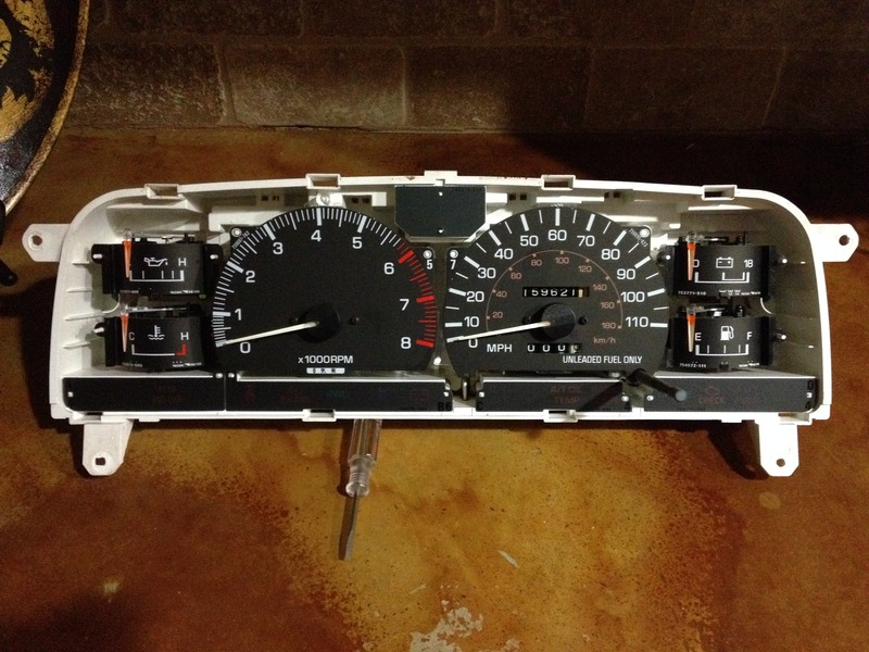

Also snagged a SR5 cluster. Got it calibrated and mileage set. Im thinking about removing old paint from the needles and repainting before i install it.

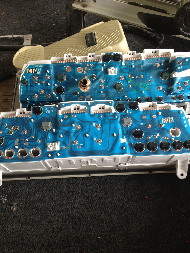

Anybody want to trade a cluster? SR5 cable cluster, i need an electric. Or i need the 2 center dash vents and the radio mounts with under tray.

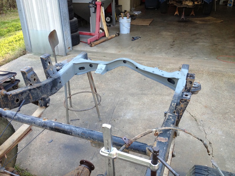

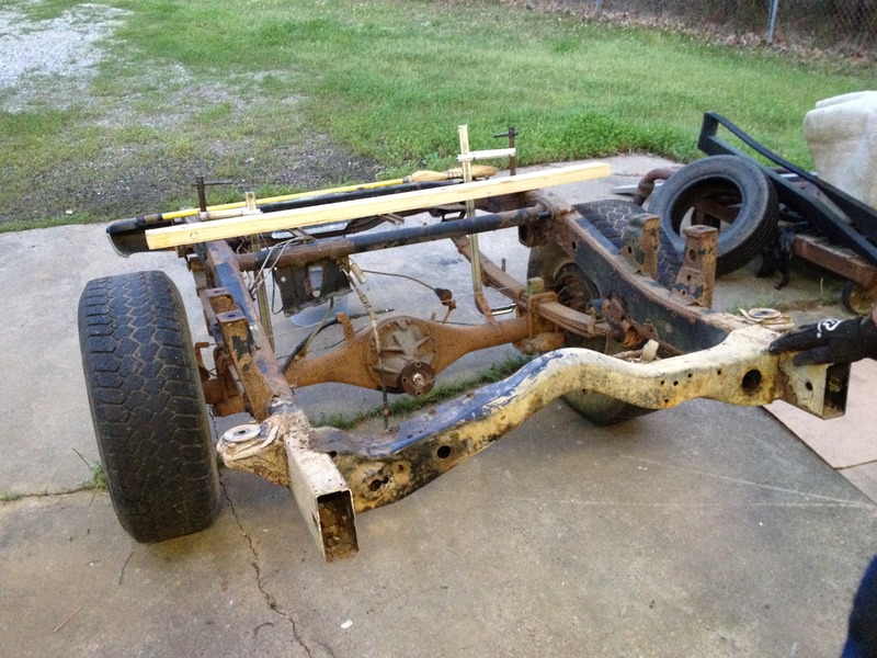

So comparing the new rear frame section theres a few minor differences. First let me say this section came from a 94 reg cab auto truck.
Frame rails are bent the same, all body mounts for the bed, 2 rear crossmembers (round tube and spare tire) are the same, drivers shock mount, leaf spring mounts. Are all the same.
However the crossmember under the rear of the cab is pushed further to the rear on the 2wd for the smaller gas tank, the passenger side shock mount is top mounted rather than being mounted on the side of the frame as the 4wd.
Tomorrow evening after work im going to get started moving the crossmember to the correct location and relocating the passenger shock mount in prep for the sectioning.

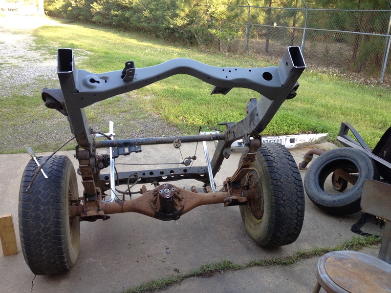

Been a busy afternoon!!

The crossmember under the rear of the cab is not the same about 2 inch difference in height. Being the 2wd is higher than the 4wd. The emergency brake is differenet also, 2wd has a Y or splitter and 2 cables one for each wheel.
