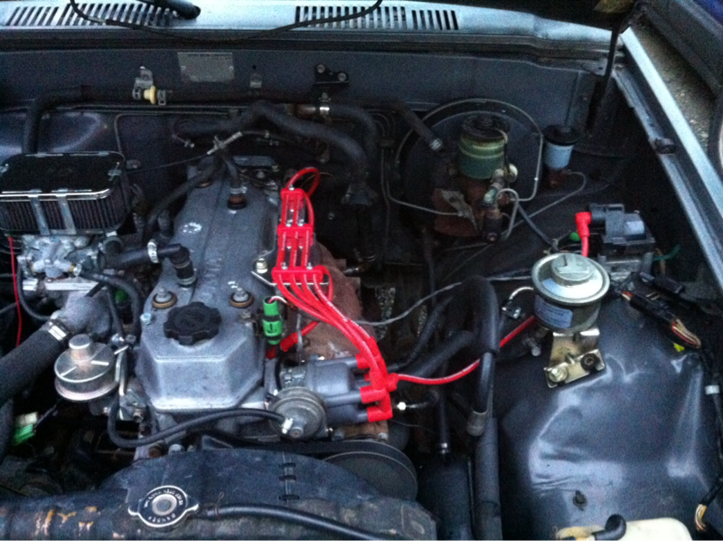

Ey so I bought my 87 Toyota single cab pickup about 3 yrs ago with an ultimate vision of sas'ing it. Thought hey I'll never be able to do it but it's happening now! This was how she sat when I bought her. Red door little banged up in the bed but I loved her. Wanted to do little things till I could really sas it so I put a weber 32/36 carb on new rubber fuel lines, lc 8.5 mm spark plug wires, upgraded dist. cap, lc billet wire loom for wires, ngk spark plugs, lots of little things.

Attached Thumbnails Money pit build-image-1034065557.jpg   Money pit build-image-2883598586.jpg   Money pit build-image-1203600971.jpg

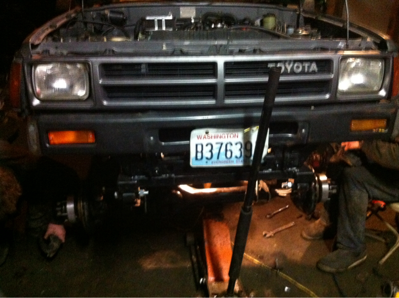

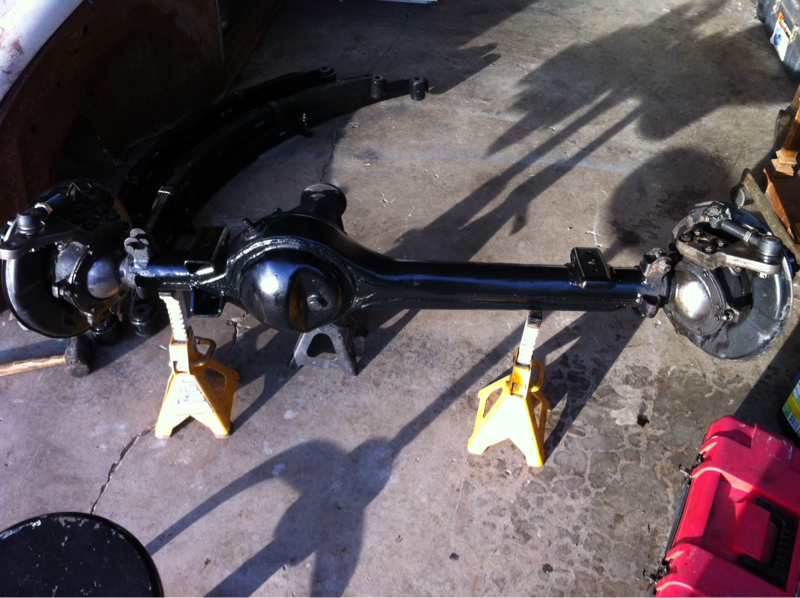

Then I bought an 84 axle complete hub to hub for 250$ which was a score from a friend an the next weekend I bought trail gears 4" lift for rear an ifs eliminator kit for front. I was so stoked even though everyone has something bad to say about trail gear but I'm pretty happy with their quality. That a fridge full of 2300 $ worth of parts haha

Then the hard work started in but luckily my buddy I got the axle from basically helped me install everything, so paid for an axle for 250 an got free install . Went from ifs to sfa in 4hrs in the first weekend.

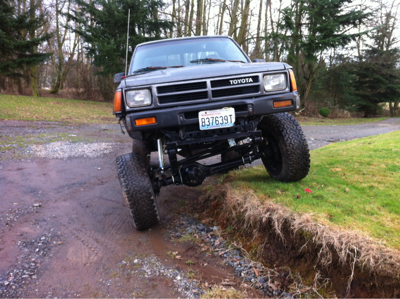

We'll can't upload more pictures for some reason.. But my plan I to finish up the sas need to remount my shocks from an rear. I have all the shocks new shock hoops an lror rear shock mount to mount my shocks in /\ configuration. Need to finish my driveline which I'll probably have built by Olympic 4x4 it's about an hour away an don't mind leaving it there to be done since it's not my daily right now.
So far only drove about maby 200 mi on the sas setup by trail gear, springs are still a bit stiff. When I got the 4" lift I was like oh this won't lift it too much but ended up being about 8" of lift with everything said an done without settling the springs. But drive nicely with the stabilizer, it was a little back an forth play without it but a lot better with stabilizer.
Then tires an gears will be next after the sas. I don't plan on going to big 35" mtr kevlars is my idea of tires. 5.29 gearing an not to sure on lockers yet idk if I'll go air lockers I know there the best out but spendy. I'm sure I can get away owith 33's with 4.10's for small trips for now or just roll my tiny tires for now lol
But I plan to get it all finished an do some armor like sliders, front an rear bumper, an hope to do a tube bed an armor around body. Then in future plan to do duals cases, chromoly rears an fronts.
