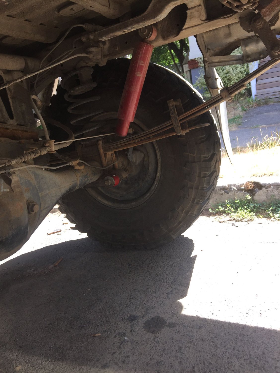

Well I broke a shock somehow I'm assuming it's because of the zuk mod with stock length shocks so I'm going to redo them all and install some ball joint spacers
So I'm not sure what shocks are on there right now. And I was looking at pro comps es3000 then read some more thought the es9000 were the way to go then maybe I should just save the money and do blisteins so I'm kinda stumped are the pro comps a waste of money. I dd this truck but hit the hills and trails about every weekend. If I do the blisteins I need more of a lift I think. And I don't have 400 bucks for a ome set
Completely disconnected! There 2004 tj springs on he bump stops

Almost positive it's because of being over extended those tj springs are super stiff I can't even really tell that my back one is out hah
So I'm Installing 2 inch spacers up front and I've got about 2.5 " of lift in the rear I thought I'd get the 4" lift shocks and if the rear needs more I can get some extended shackles that is the pro Comp es9000
I'm running 33x10.50 I do weigh this thing down with a family and full camping gear
Are the blisteins worth the money or should I just save for the ome set? If did get a ome set which ones all I find on the site is other applications or other vehicles

I think you have to be careful with saying that shocks can handle over extension. While it's true that a lot of solid axle (front or rear) suspensions (the Toyota 4runner rear axle included) use the shock to limit down travel, this isn't really a normal every day occurrence. Usually the only time the shock limits down travel for a highway vehicle is when the vehicle is raised on a lift or jack, and that's a pretty gentle experience.
When the limiting happens rapidly, suddenly, and frequently on the trail, I suspect that may fall outside of the expected use model for many shocks, and I wouldn't necessarily expect a shock to tolerate that long term unless it was specifically designed for it.
Old Aug 12, 2015 | 11:28 AM
punks_is_4x4's Avatar
Joined: Apr 2014
Posts: 396
From: Portland Oregon
So if the rear is lifted and let's put it in to scenario so it's compressed all the way who know how old the shocks are and then sudden drop to far on that one side and it snaps? Or what else? I mean im pretty gentle on the rig but some times that doesn't work. The shock is completely loose I can compress it and move the tube in and out no force needed.
