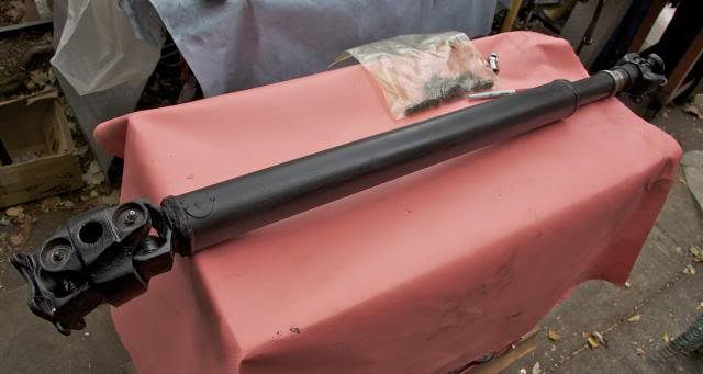

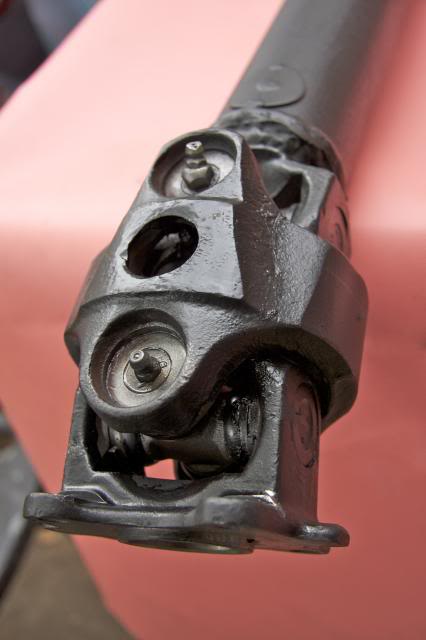

My Double Cardon, (cv) is working out splendidly on my rear DS.

The cv was removed from the stock ifs front drive shaft.

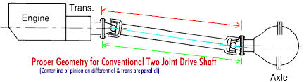

This is why I ran a CV.

Cool, look at the illustrations, you may not need the cv. It all depends on your flange alignment as BigBlue said.

With my rear lift i had vibration issues. My rear pinion pointed up to the transfer case flange. Not the ideal set up for U joints on both ends. So on went the CV.

My rear diff input flange is pointed directly at my tcase output flange, so it's just like the diagram with the double cardan.
