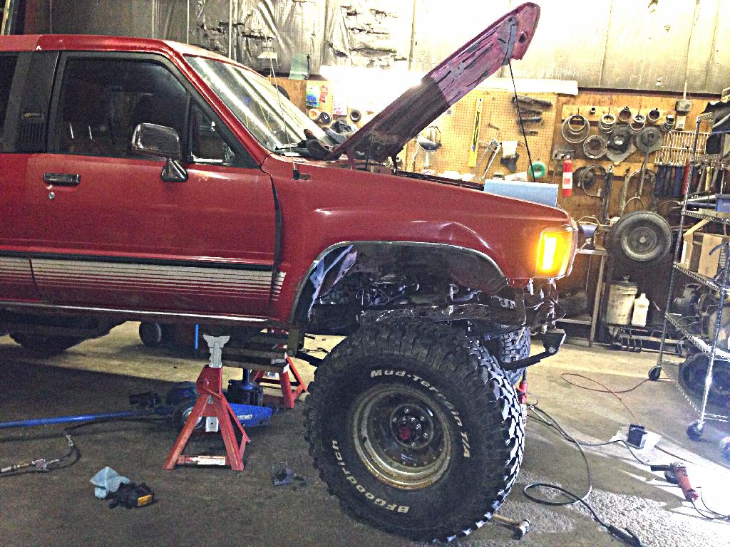

Nice! Pictures working. This is when I found the limitations if the ifs.

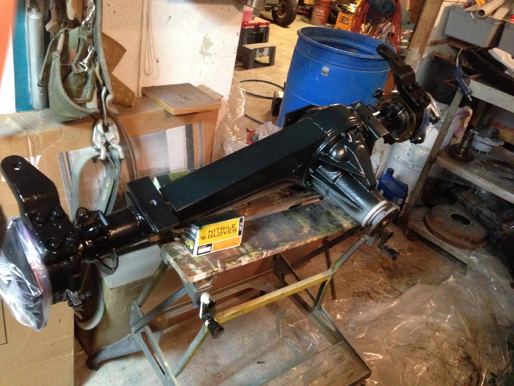

So I decided to sas the old girl. Ordered my tg front 4" kit and rear 5" kit and started the rebuild on the from axle.

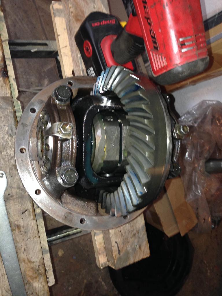

Welded on my upper gusset and large diff armour plate while I was at it. Ground off all unnecessary brackets. Put a lock rite in with 5.29s freshly set up.

The 5.29 and lockrite.

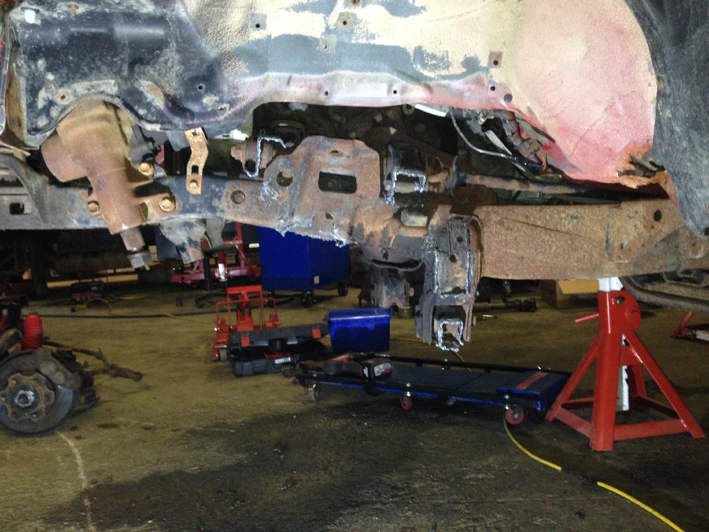

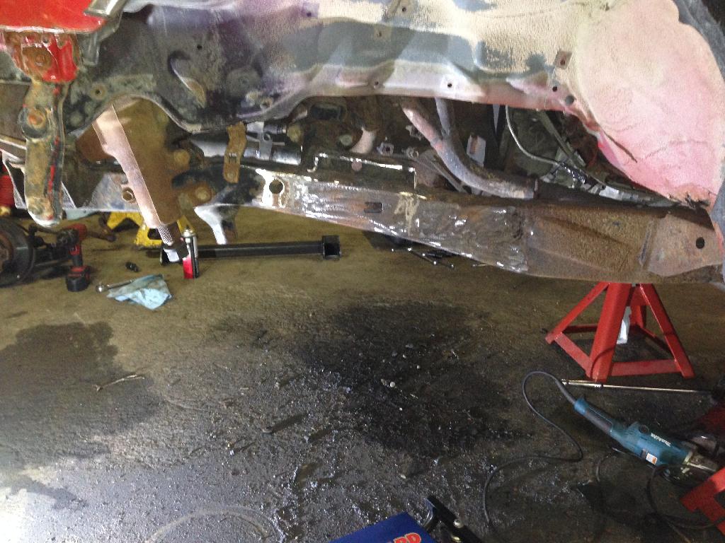

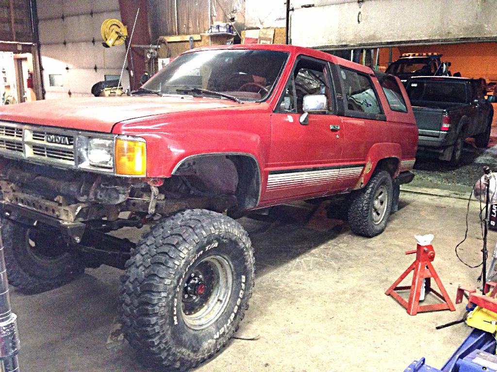

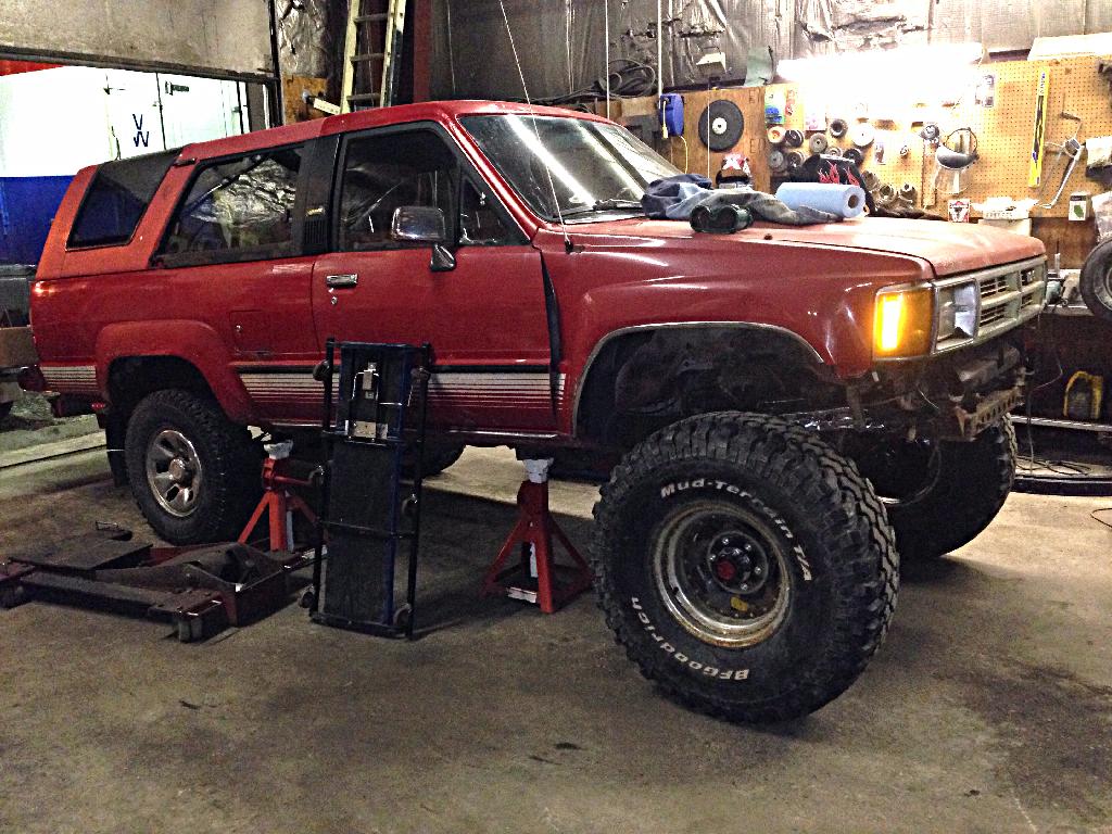

Had a pretty solid weekend on the runner but didn't get as fr as I would have liked to. The front end is done except for shocks, and the back end is yet untouched.

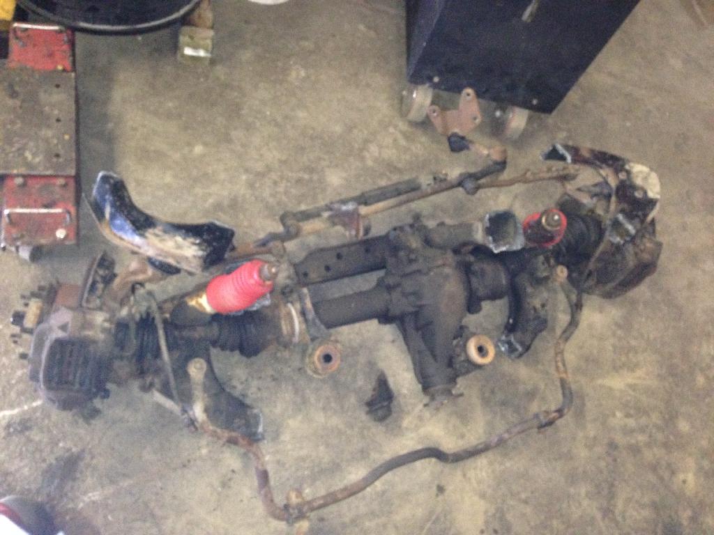

Cutting off the ifs went smooth, there was a lot of grinding and cleanup but it turned out nice.

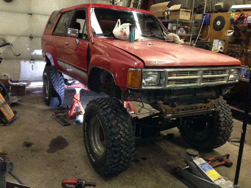

Cutting through the Fran was a pain in the but with the internal brace that's in there. Not to mention I ran out of oxygen for the oxy acetylene half way through the first one and switched over to the air arc gouger for the rest.
So it didn't go quite as smooth as I wanted it to buy a good start none the less.

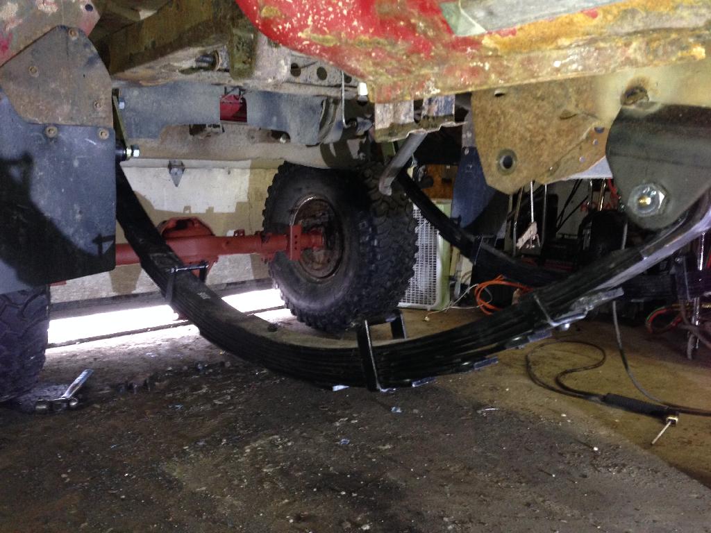

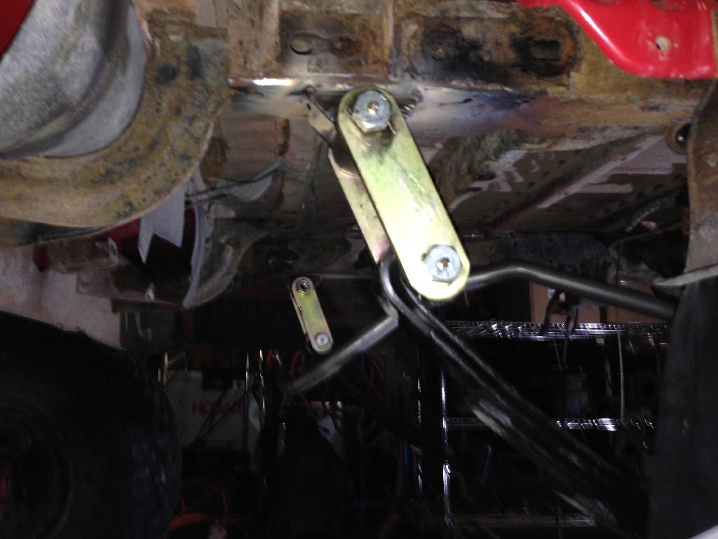

Yeah the front hanger is a bit much. I have it all together, just need to put rear shocks on. The factory mount stud is bigger than the 1/2 inch hole in the shock. Can I still use this mount and just bolt the shock to it? I have heard of guys using the factory upper mounts but not sure how it's done. Super excited to get driving her! Will be off to the driveline shop in the new year to get a front shaft and rear extended and away we go.
Old Dec 23, 2013 | 08:56 AM

Yep. And it's what I plan on doing on mine right off the bat. Unfortunately the shape of the Tacoma's frame doesn't lend itself well to leaf spring swaps. Other than the Trail Gear frenched setup, most people end up mounting the shackle mounts on the underside of the frame. Typically, a Tacoma will end up with 2" more lift than the leaf spring is advertised for lift.

Got my front shocks on today and bled my brakes. Took her out for a spin and it has a rumble in the first three gears when I am on the throttle. Probably driveline?
Possibly. You've got a pretty decent amount of lift there.
Check the driveshaft and see if the joints are maxed out.
