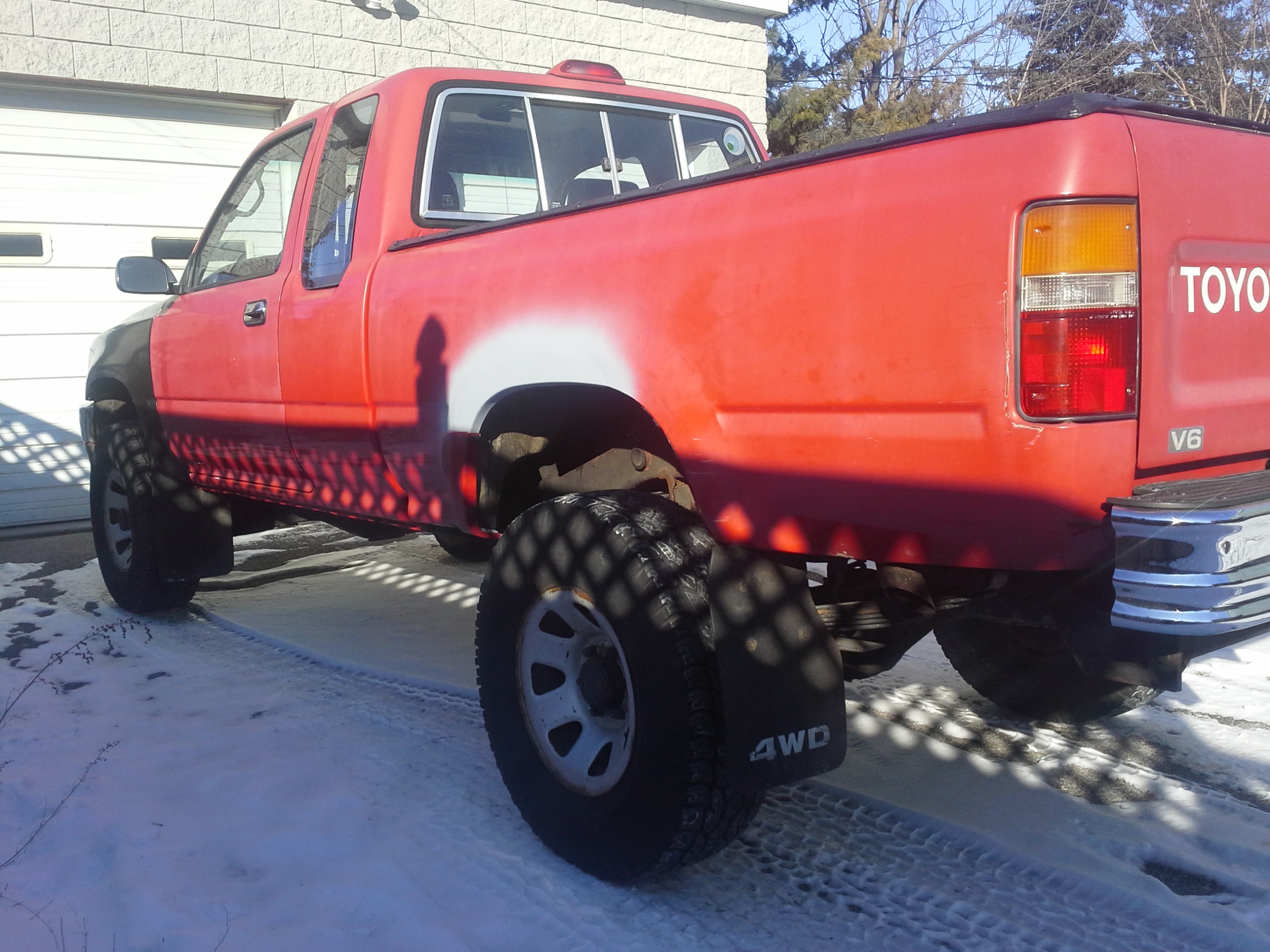

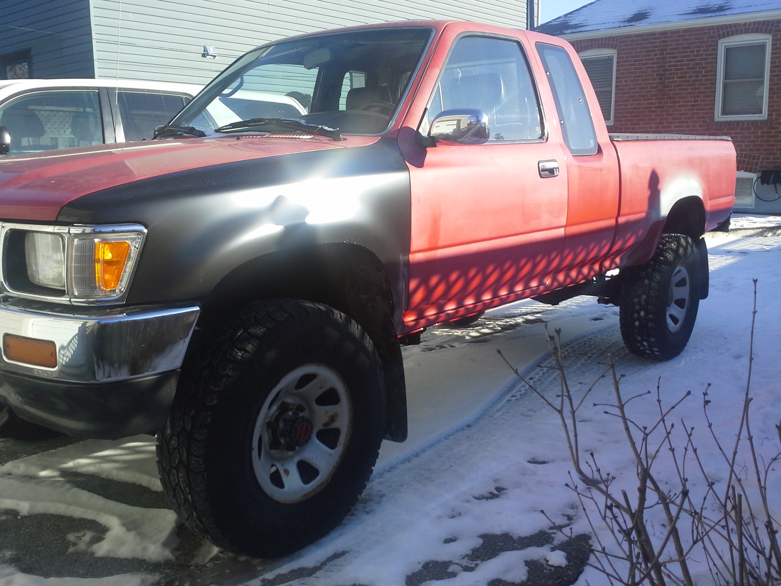

So, quite a bit's happened in the last almost three years. But I finally finished repairing the rust and replacing the fenders (and a whole bunch of other non-buildup-related repairs just to keep this old thing running and safe) so an update is in order.
I've got those XJ Jeep 6-degree wedges in there. Before, as mentioned, the rear joint was running 8-degrees from zero causing vibes. I milled and drilled them to match the metric Toyota/Ironman dimensions and put them in place of the bottom-most overload leaf and they work perfectly running 2 degrees out. Zero vibes, zero drama. I had to cut the excess threads off the Ironman U-bolts as they extended down way beyond the clamps/shock mounts and weren't even square (equal length).
The front bars are adjusted to what I think is about 1" up (which I did years ago). I'm waiting for warmer weather to get under there with a tape measure to see where the front and rear ride height dimensions are relative to the factory specs. So, as it sits, I love it. Empty, it rides very firm, but a good kind of firm, not a harsh, jarring firm. No kidding. These outback springs could support 1,000 lbs. of gear and stuff no sweat.
Attached Thumbnails Ironman Leaf Springs have Arrived-20150116_142527.jpg   Ironman Leaf Springs have Arrived-20150116_142601.jpg   Ironman Leaf Springs have Arrived-20150116_142729.jpg
