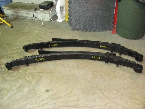

These are sturdy frickin' springs. They are chiropractor-approved. Initial impressions are very favourable. Even the Ironman U-bolts appear to be even better quality than O.E.

upload them to photobucket there should be no limitations, but having photobucket automatically make them 1024 x 748 is optimal. And the use the [IMG] code given.
Where did you get these and how much?

I know about the rust. I'm working on that. One step at a time. Everything, two springs, two U-bolt sets and a bushing kit, taxes in, Canadian, cost me $447.24 through a Canadian retailer here. But the person I delt with said he got it through Camel 4x4 in the U.S.:
http://www.camel4x4.com/merchant2/
Like I said, initial impressions are really good. I can't wait to install these things and see how they work out down the road.

Are they stock height or a lift?

If you look on that website link he provided they are listed I believe as 1.8" lift springs. And these ones if I read that site correct are their softest ones. (least load carrying)

man..they look really stiff,6 leaf...good luck

These are the softest ones, 100 kg or 220 lb. increased capacity and a from Ironman's info, 40 mm or 1.57" increased lift. There wasn't anything to indicate that these weren't bolt-on, otherwise Ironman would've stated they were longer, shorter, etc. These look stiff, but the individual leaves are much thinner. They are, however, plenty heavy physically. There's a rear spring void for us older Pickup/Hilux owners in N. America. Either stock height or 4"-up lift, bolt-on, or less height but super flexy extra length rock-crawler springs whereby the spring hangers need to be relocated. Some people are lucky enough to have a 4x4 "spring guru" in their neck-of-the woods but not me. At least not anywhere near where I am.
The springs on the truck now, worn-out, broken down NWOR "replacement" springs (a complete joke) started out ULTRA stiff -- 750 lbs. increased capacity and 2" lift! -- until I took a leaf out each side. That helped with the ride and the ride height (the arse was waaay up in the air when I first installed them 13 years ago), but they were still were really inflexable. Then they started breaking leaves three years ago and, now after three seperate repairs, the back end is all sagging and uneven. So, I know about too stiff, too high, too low, uneven, dealing with three different local spring shops that told me three different things about springs, (replace, repair, no, replace, no, repair is cheaper, on and on).
