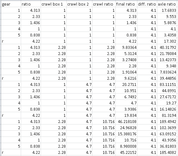

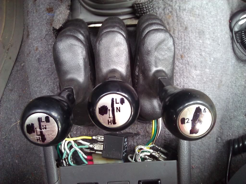

20... 20 forward speeds and 4 reverse speeds
also, temporary shift knob labels
(7/8" for the small ones, 1-1/4" for the big one)

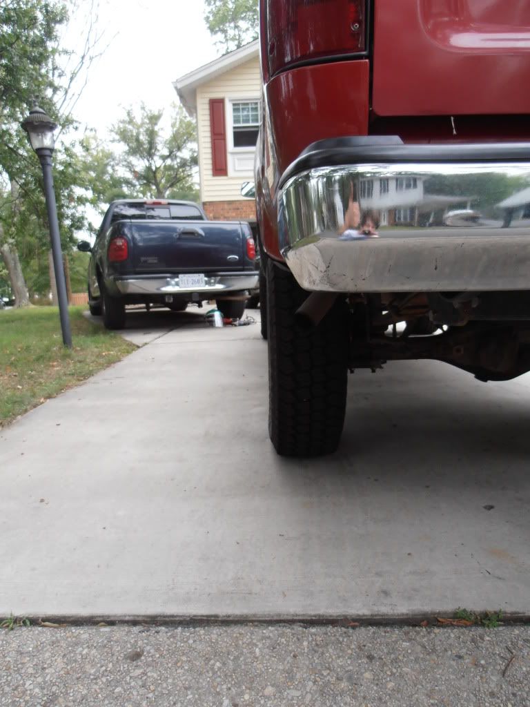

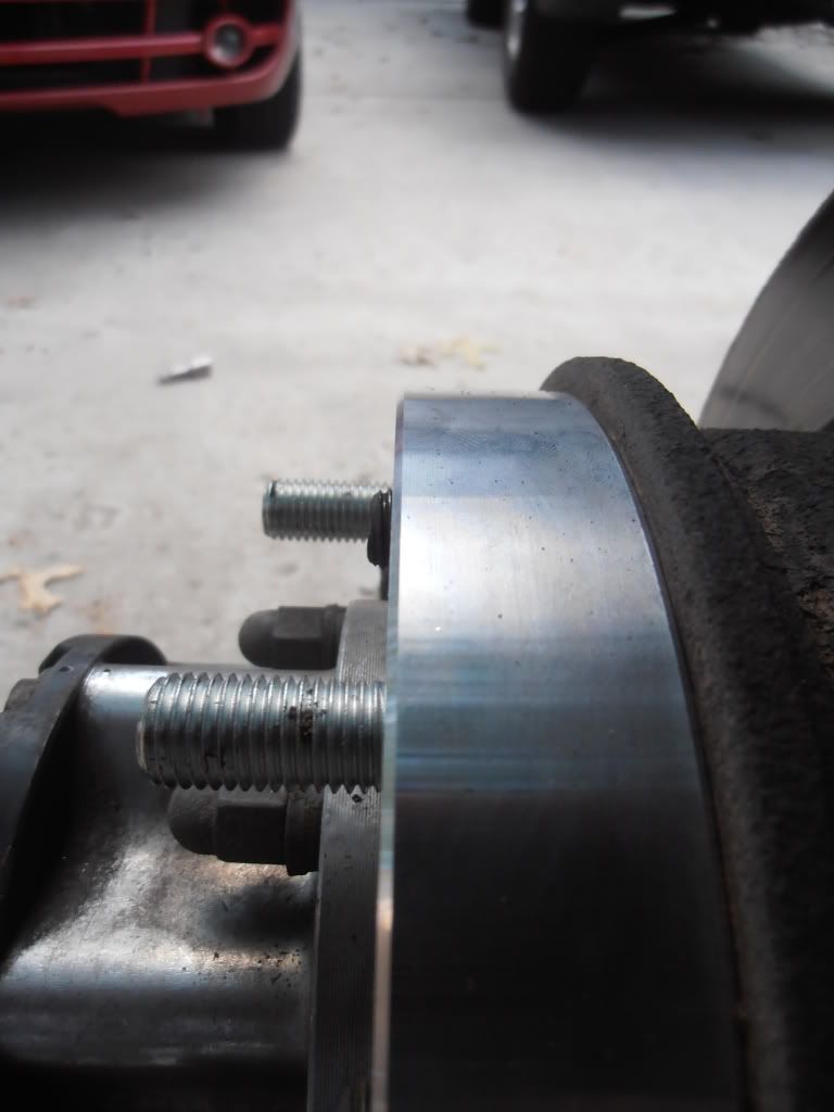

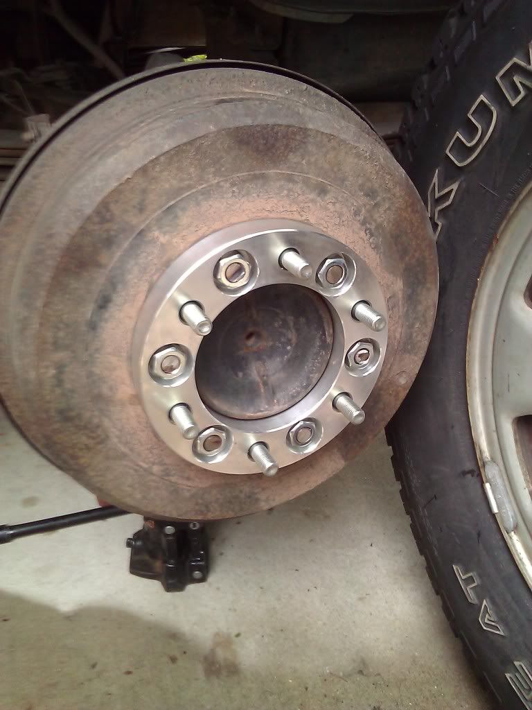

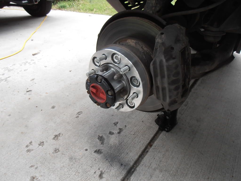

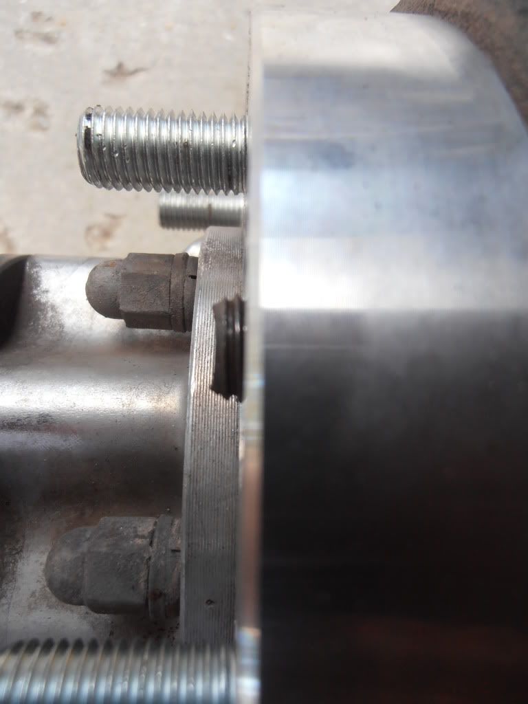

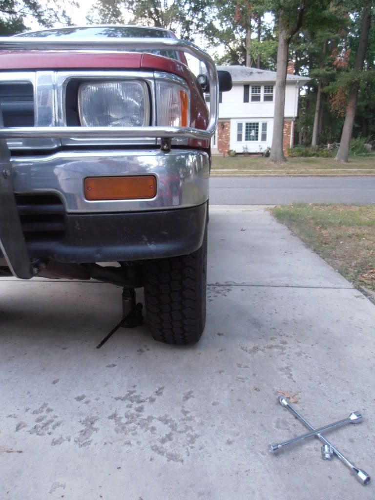

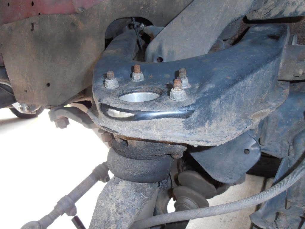

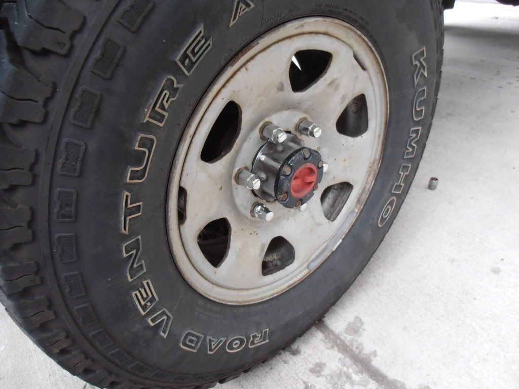

anyway, tonight i tried putting a few wheel spacers on, only to find out that the lug studs stick out too far. grr. i forsee a bit of cutting in my future. pics to follow, shortly-ish.
Old Aug 13, 2012 | 04:22 PM
  #2012
irab88's Avatar
iTrader: (4)
Joined: Jul 2010
Posts: 6,499
Likes: 37
before shots
and the bit to be gone

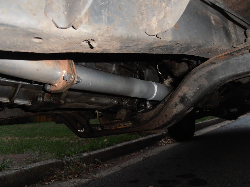

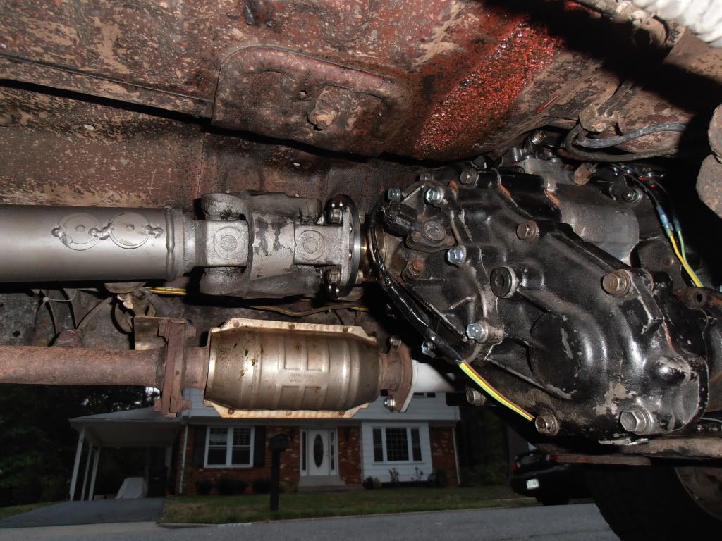

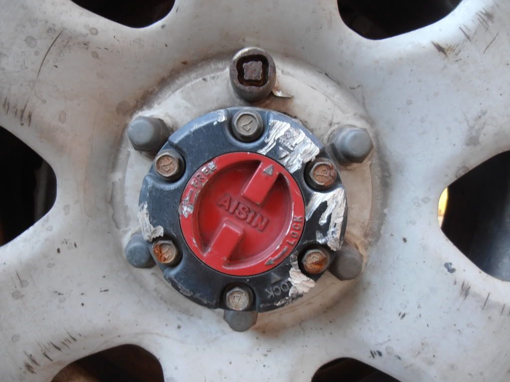

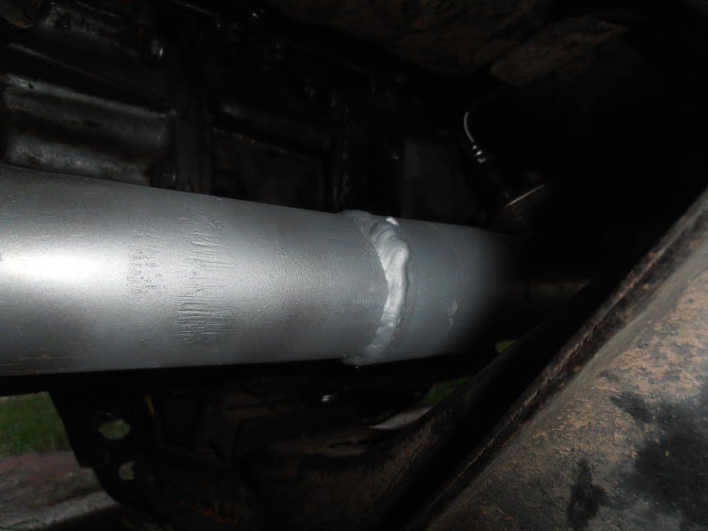

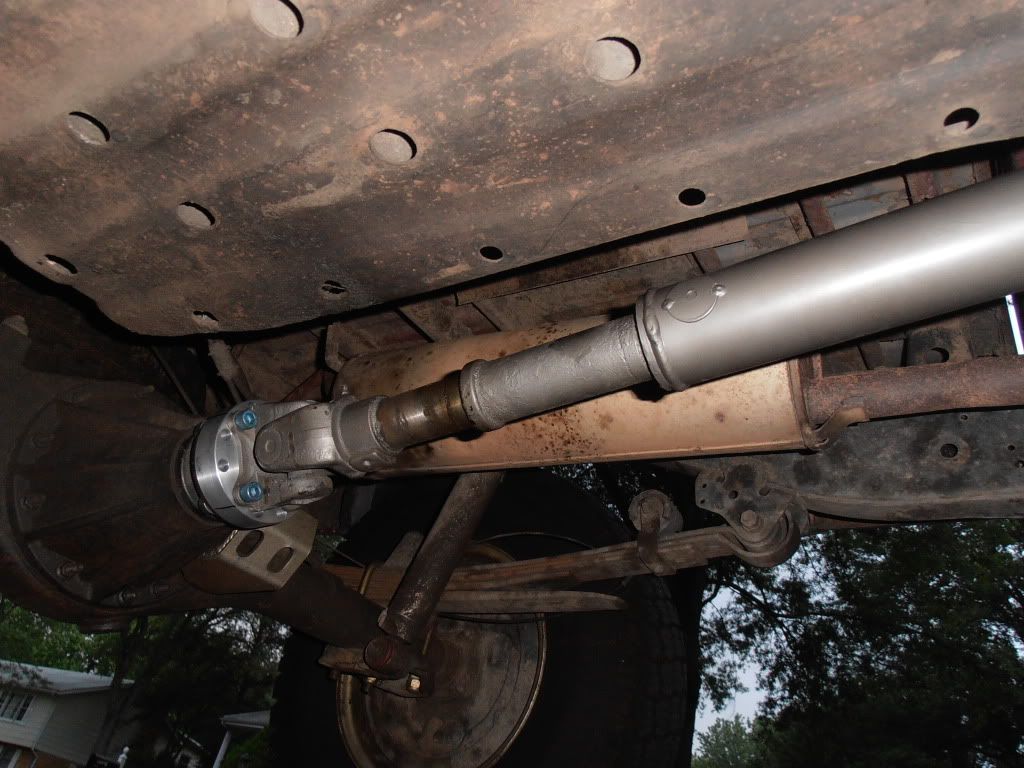

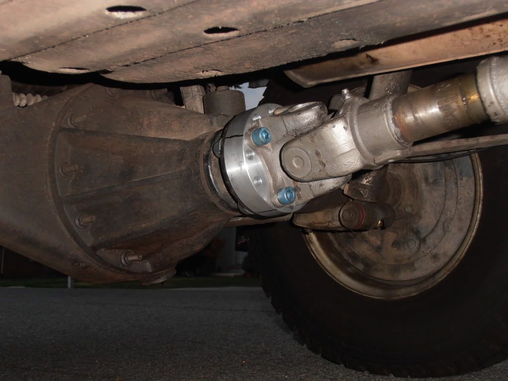

fixed my driveline vibration!!!!! wooo!

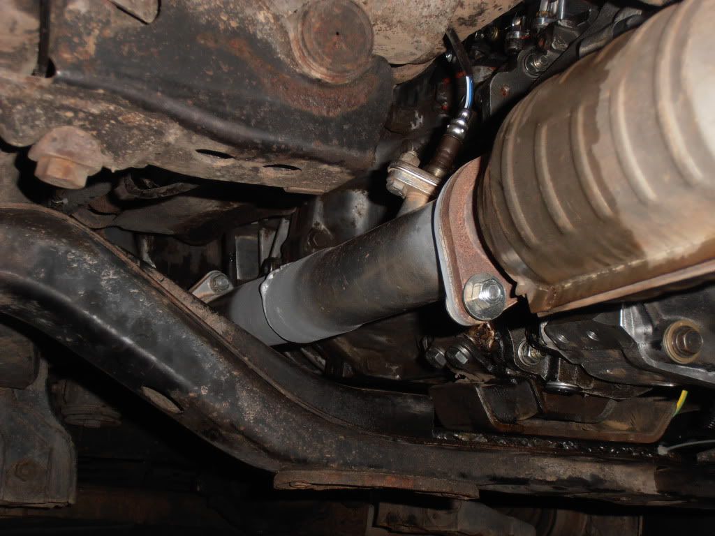

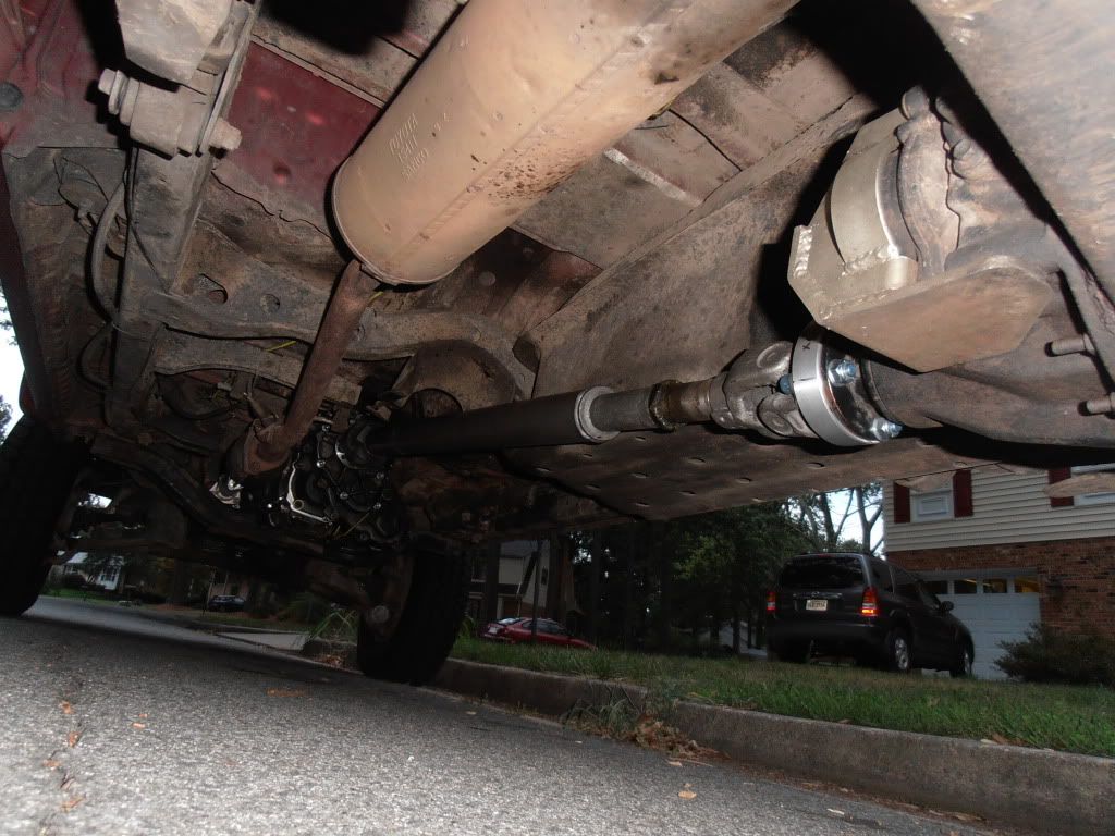

it turns out that the rear disconnect nut loosened since it could not be staked. anyway, took that off, added a triple-drilled flange and 1" spacer (to acount for the length of the disconnect), and there are no more vibes.
the wheel spacers are going on either sunday or next weekend, as i have housing to look at tomorrow, and the grinder makes a bit of noise at night
anyway, on to pictures of the driveline
the spacer from roger brown. damn it's a nice piece. he does great work, highly recomended
and finally some pictures of the modified collector. midas in alexandria (on duke street) did an awesome job. highly recommended
no more band clamps

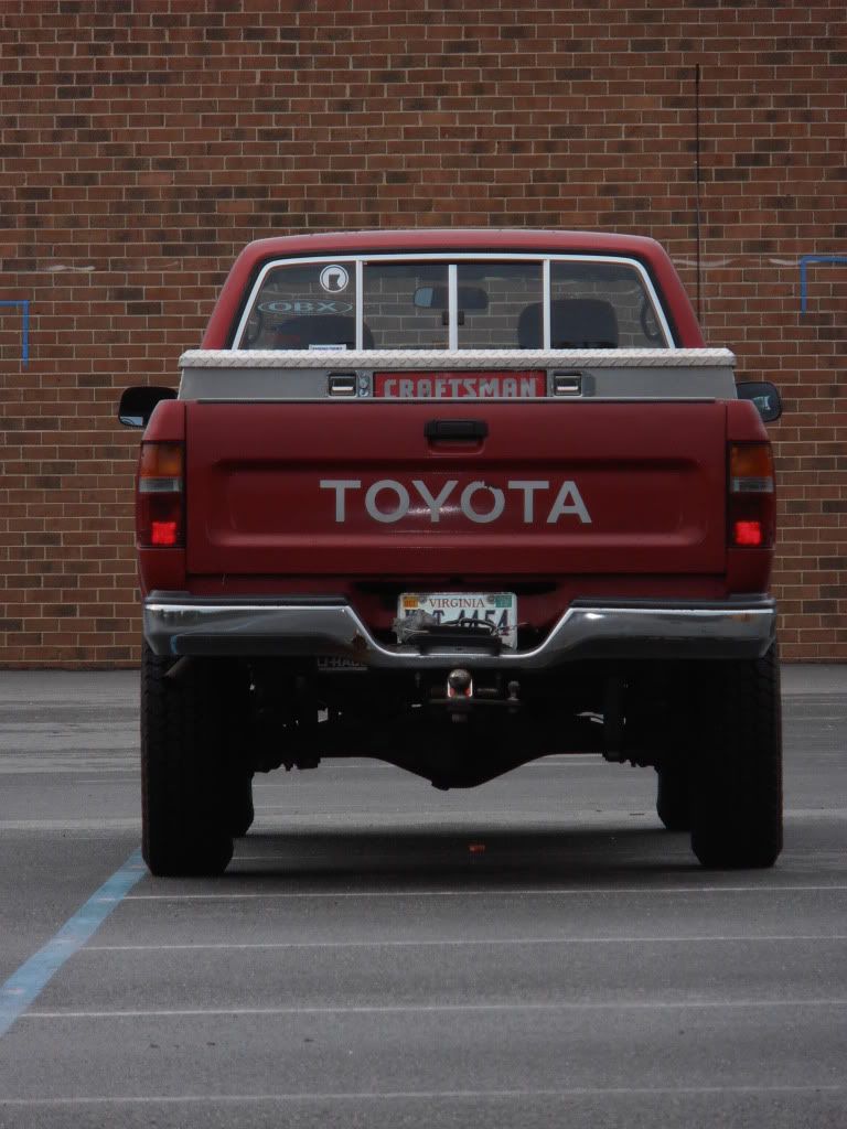

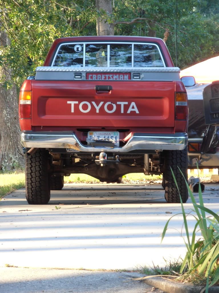

You ever get hassled for the partially obscured rear plate?
Old Aug 19, 2012 | 08:26 AM
  #2016
irab88's Avatar
iTrader: (4)
Joined: Jul 2010
Posts: 6,499
Likes: 37
nope. and if i do, i don't think i'll have too much of an issue with taking it off. it passed inspection like that, too.

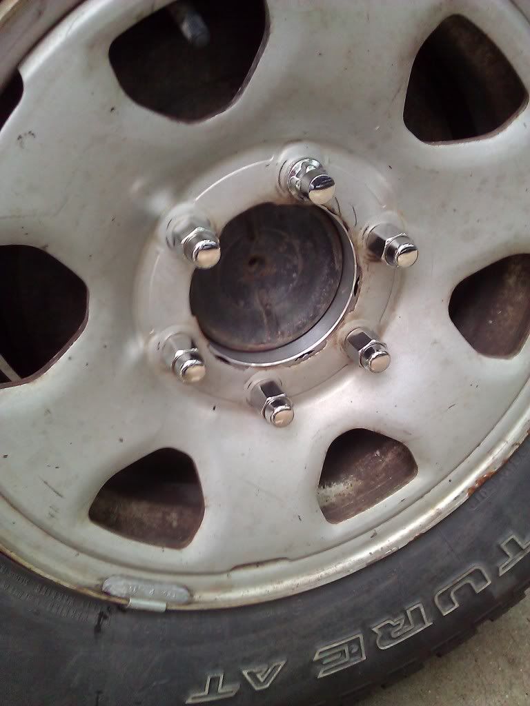

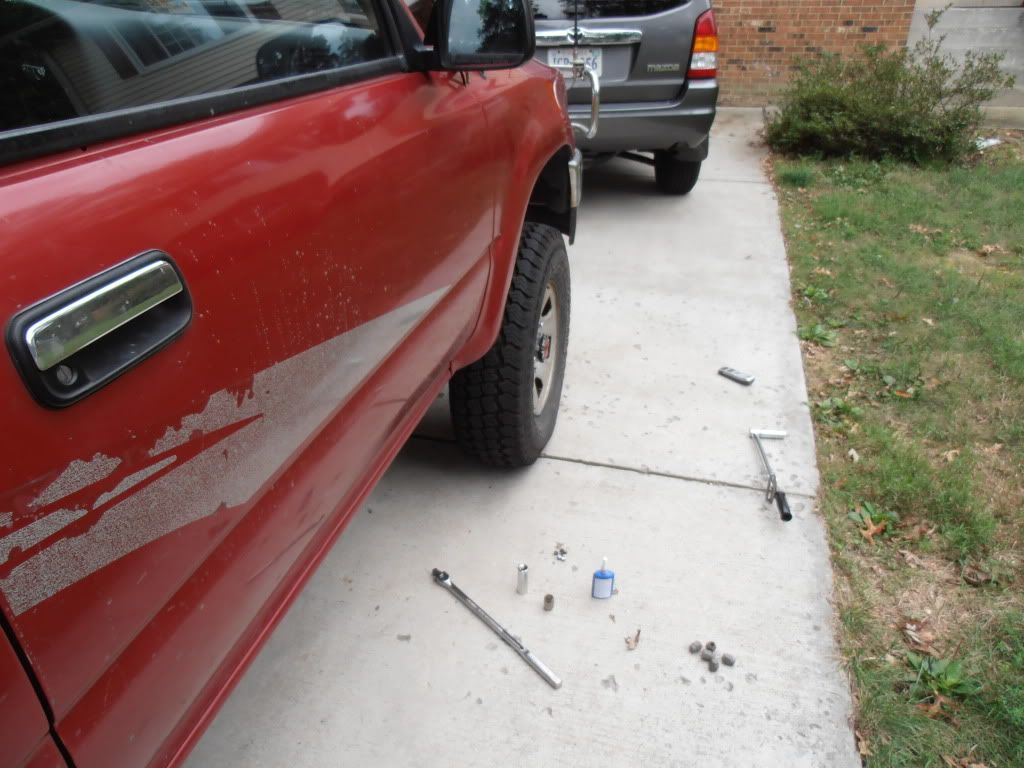

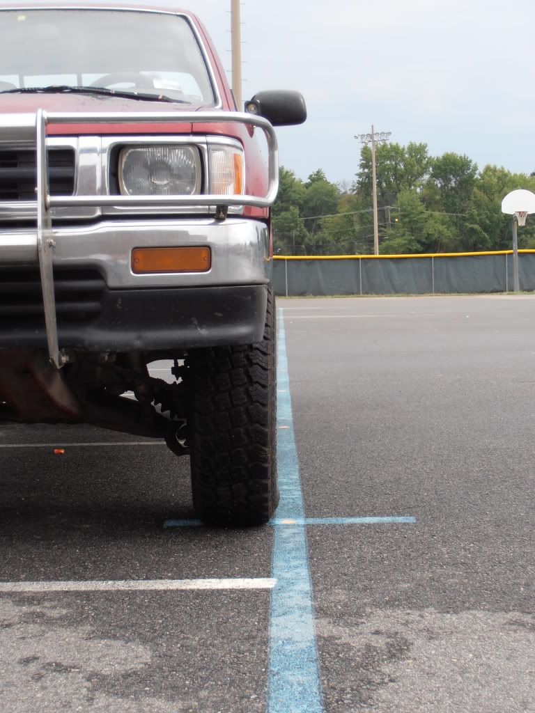

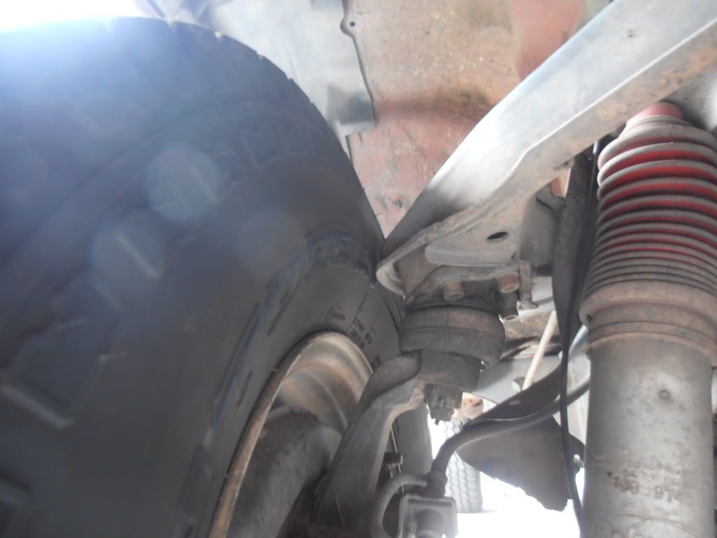

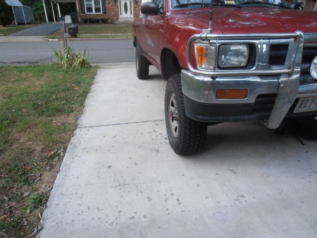

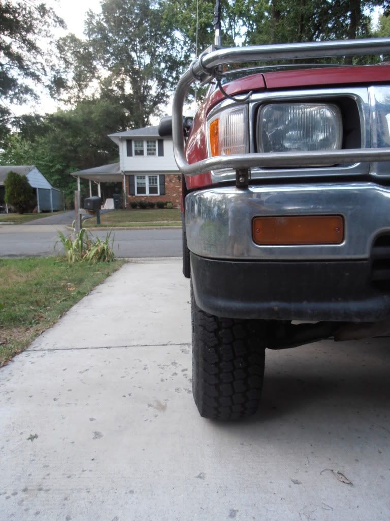

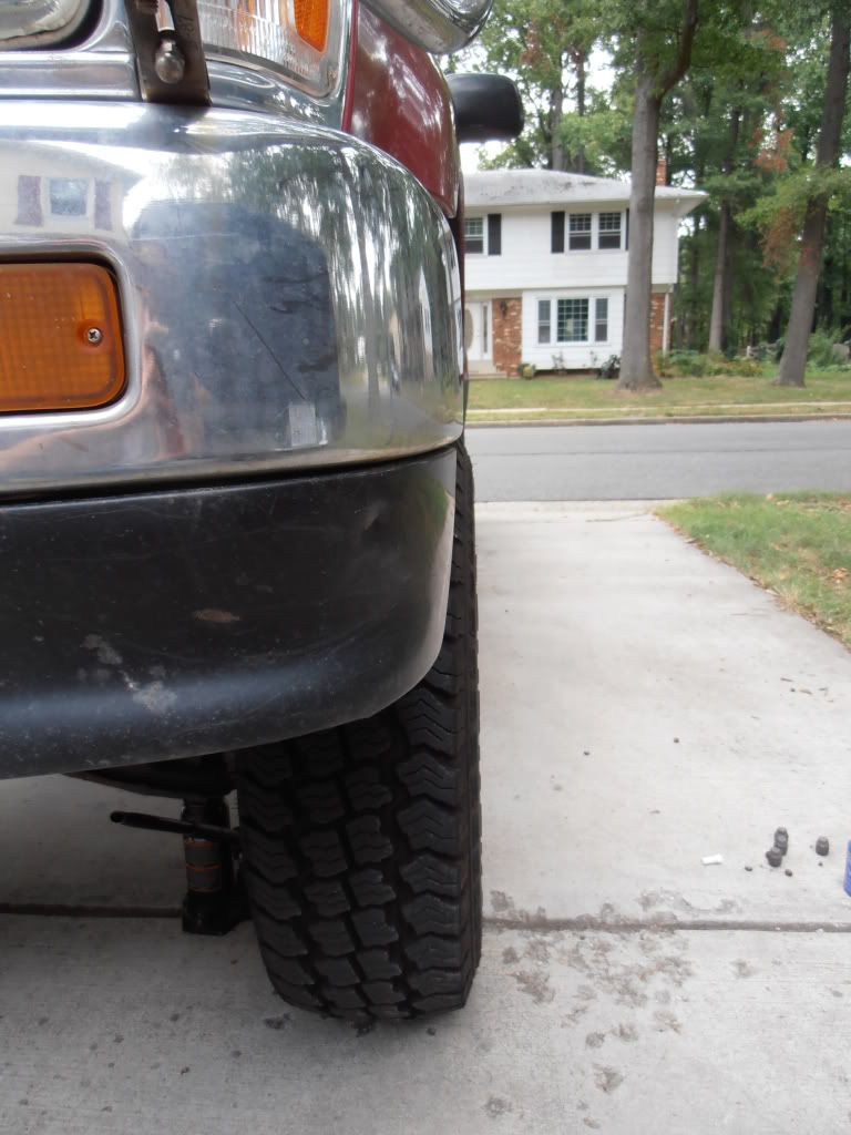

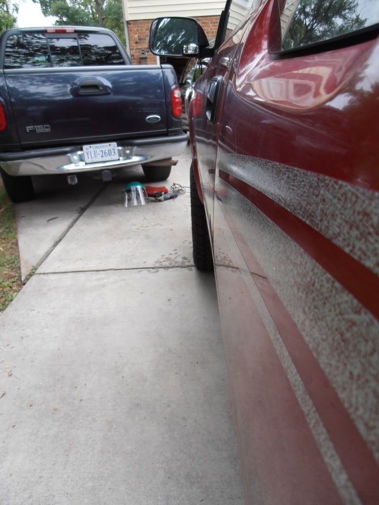

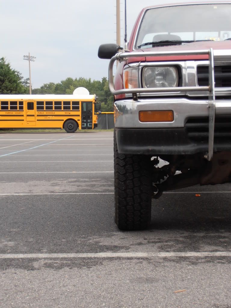

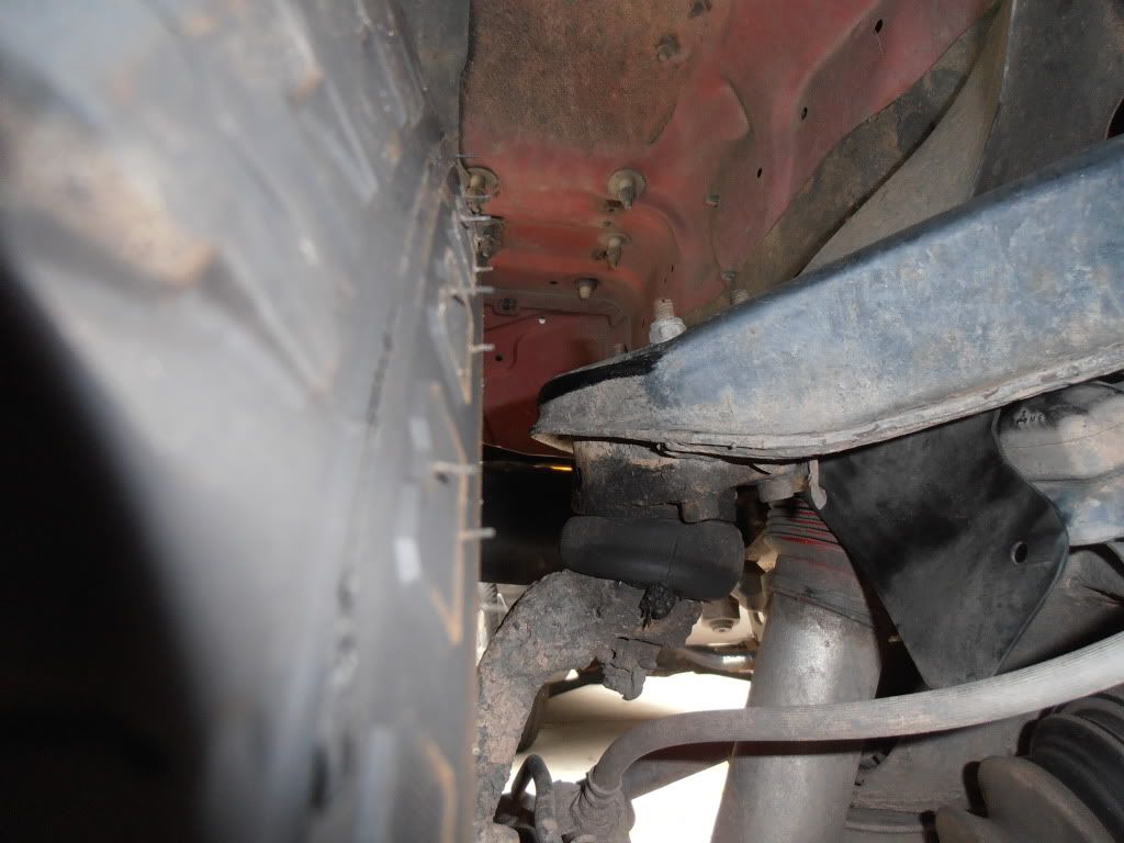

today's progress: front wheel spacers on before the rain
where it was rubbing
new nuts
new clearance. much better

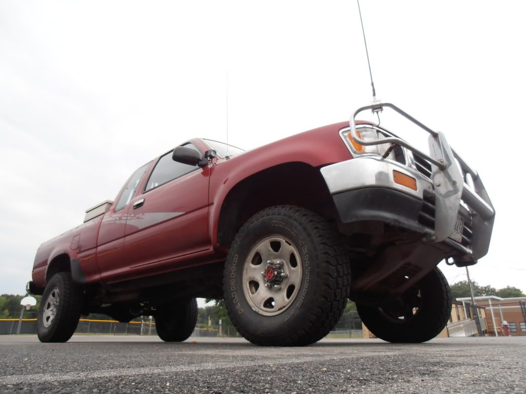

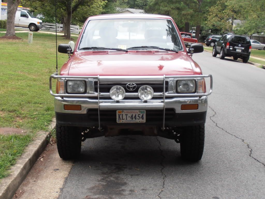

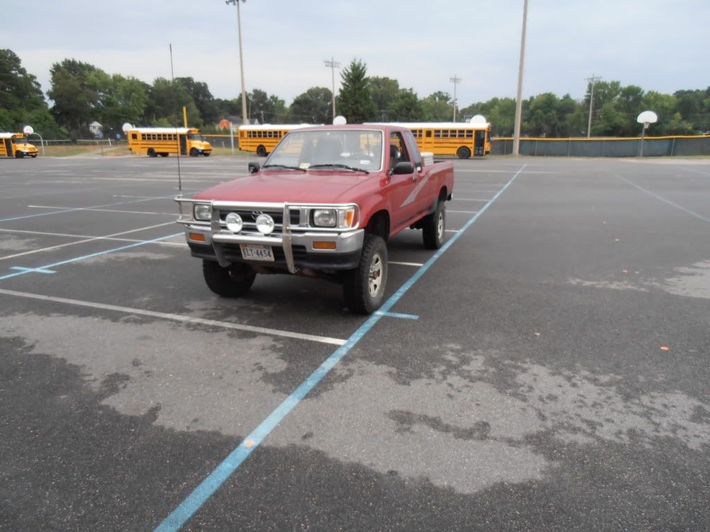

rears done, and some poser pics
and just to show you the awesomeness of 12.5x optical zoom:
normal (1x zoom)
full (12.5x zoom)
