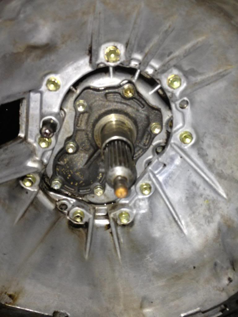

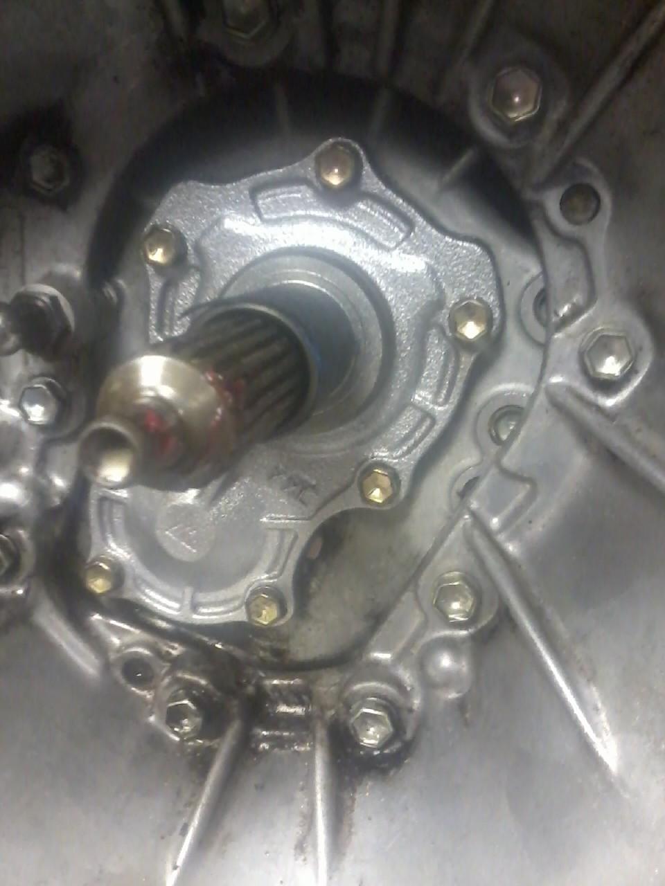

Size:  72.0 KBBeen stealing an hour here, an hour there to get the trans cleaned up. No sense putting it in filthy.
Terry...which gasket are you suggesting I replace? the front bearing retainer deal?
I used...engine degreaser...purple power...and eagle wheel cleaner for non clear coated wheels (thanks whoever posted that tip) the wheel cleaner reallt brightens it up.
Still have some more to do...but Im getting there.

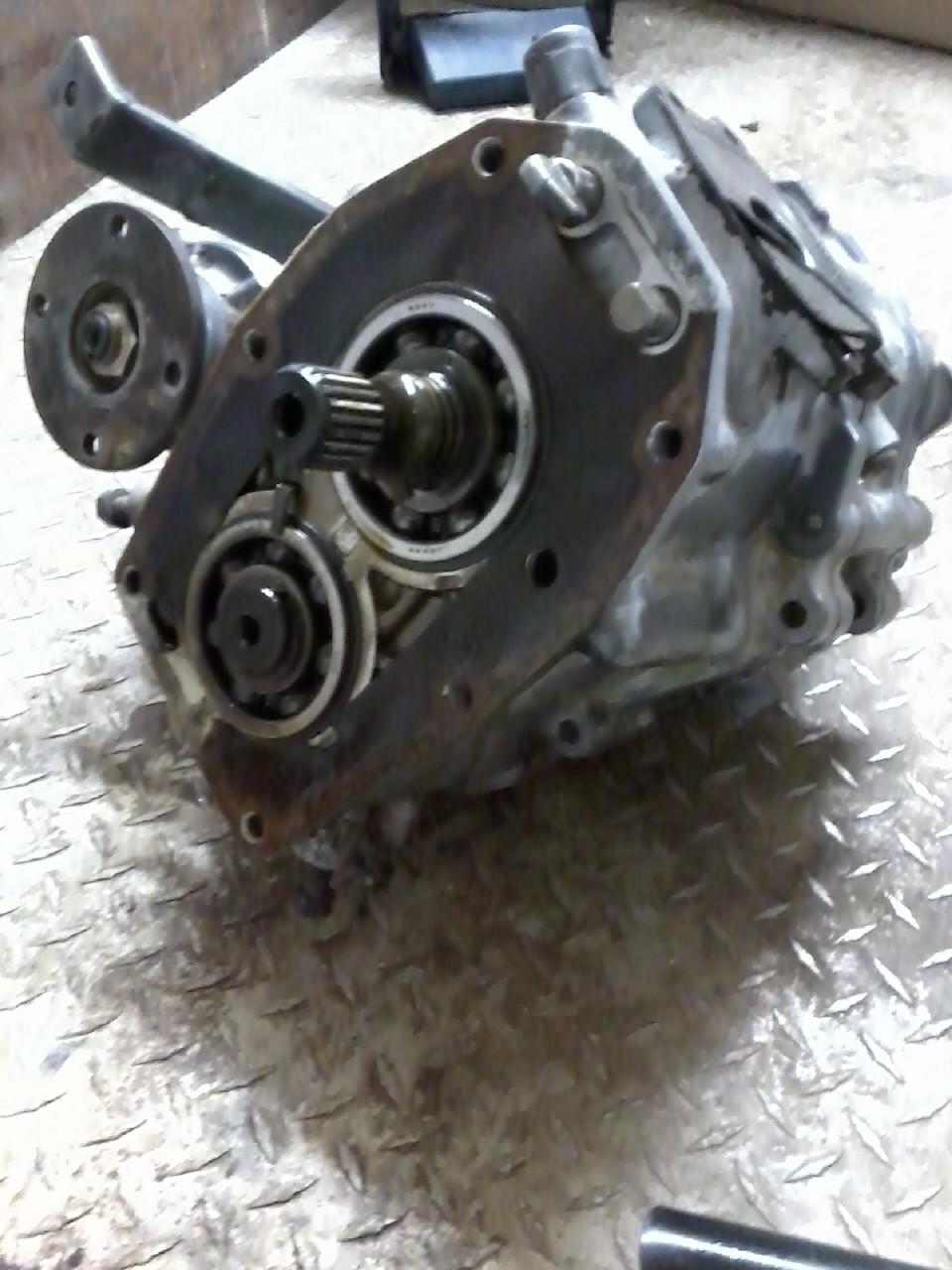

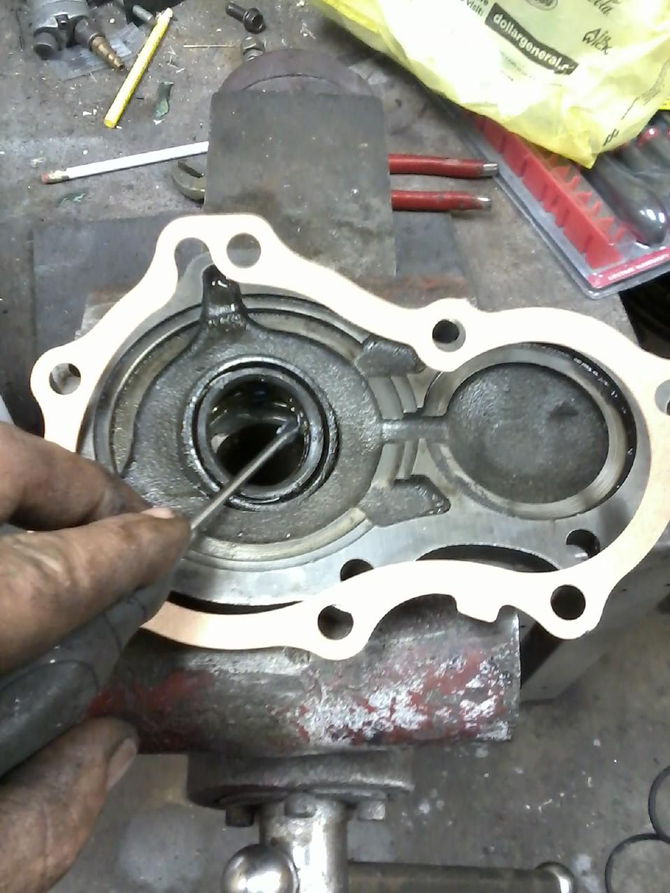

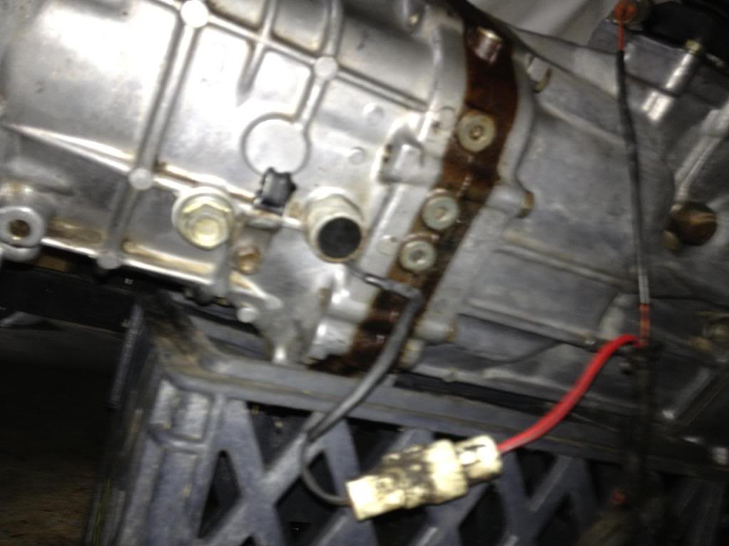

Here is the gasket number that goes inbetween the tcase and tranny. I see alot of them leak and is about $2.50 and is easy to change. I still put a little sealant on each side of the gasket. This is for a W56, I dont know if A,B, C matters.
When it get wet with gear oil, it acts and feels different them paper.
Yours looks good. The front paper gasket isnt much but the seal is a little pricey.

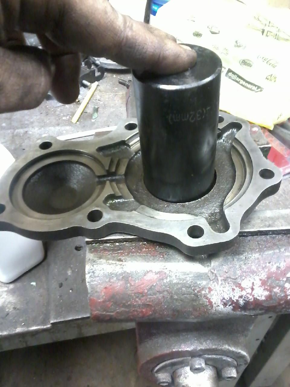

Transmission front seal and gasket it. Would suggest doing these when changing clutch. It was needed. Parts from Toyota was less then $20.
Greased and pressed seal in with 32mm socket.
How I poped it out and with gasket. I used silicon on both sides of gasket. ( Not Showing).

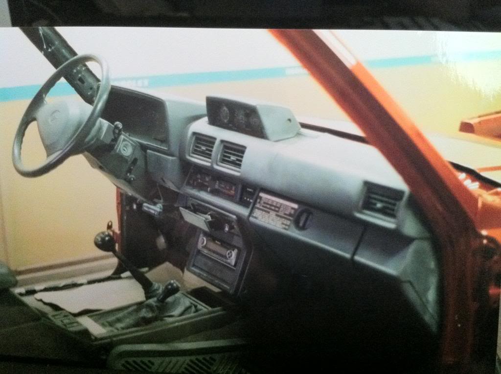

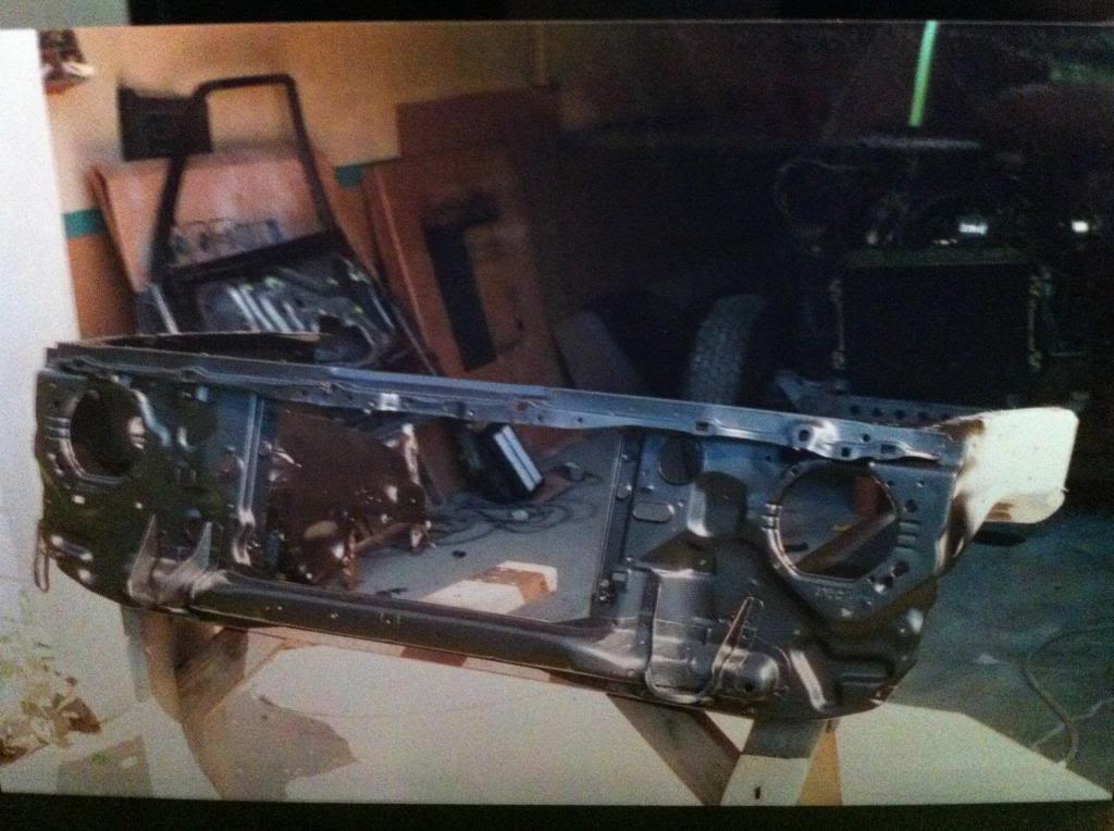

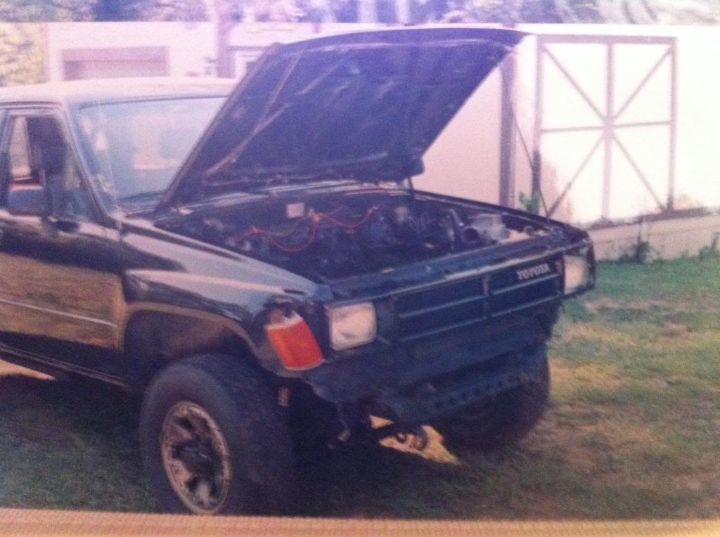

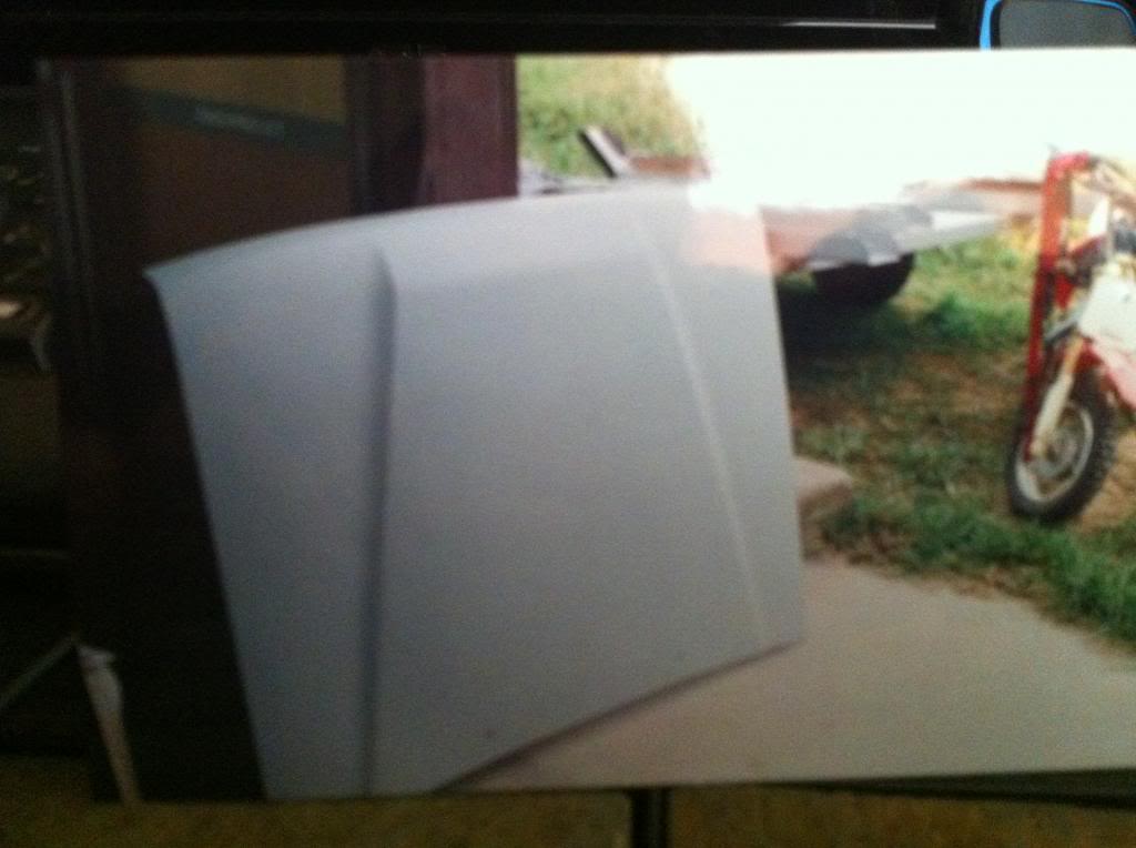

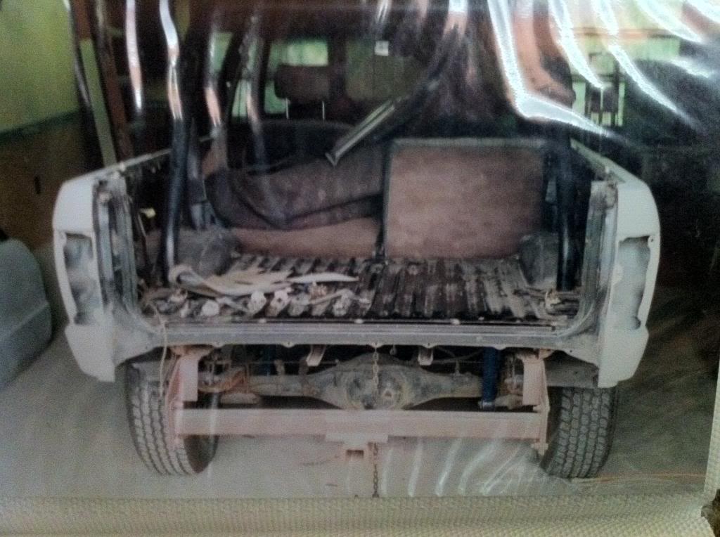

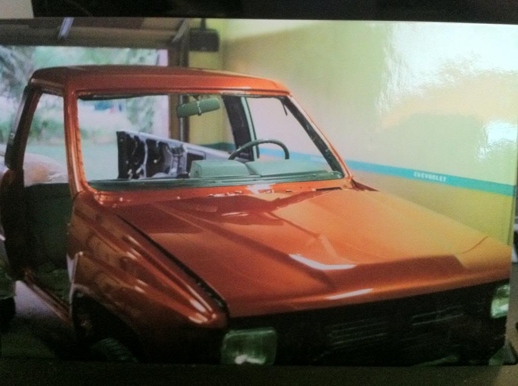

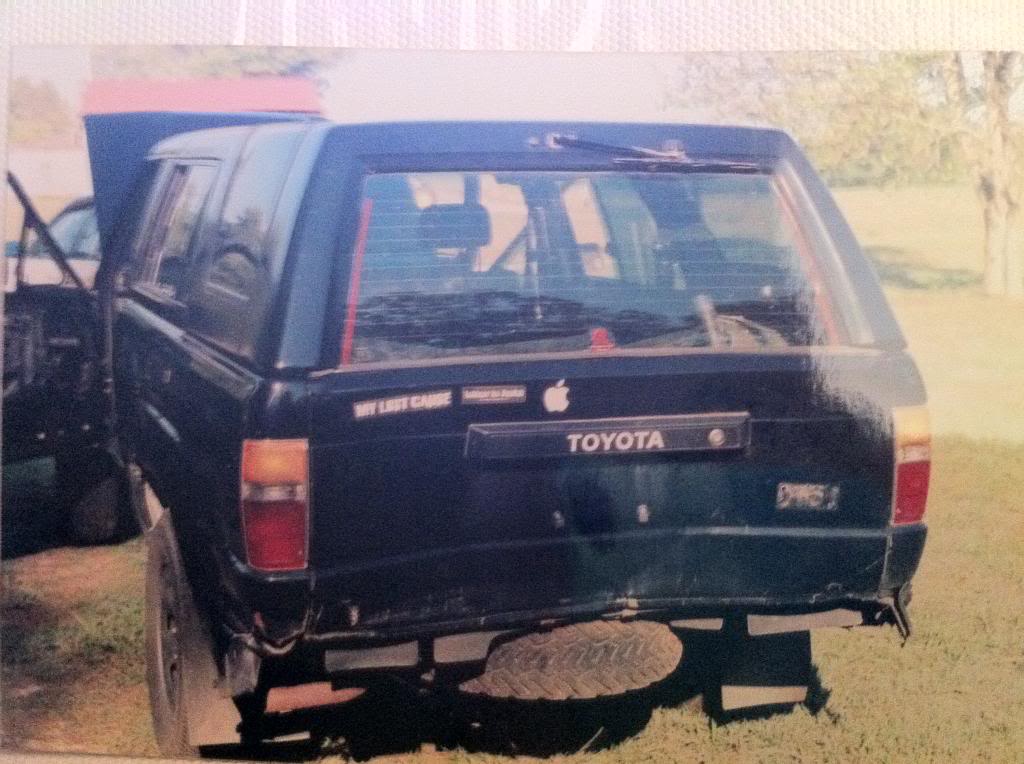

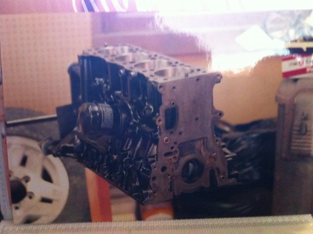

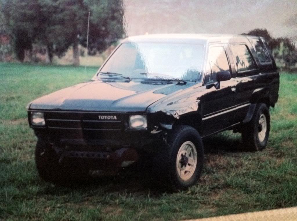

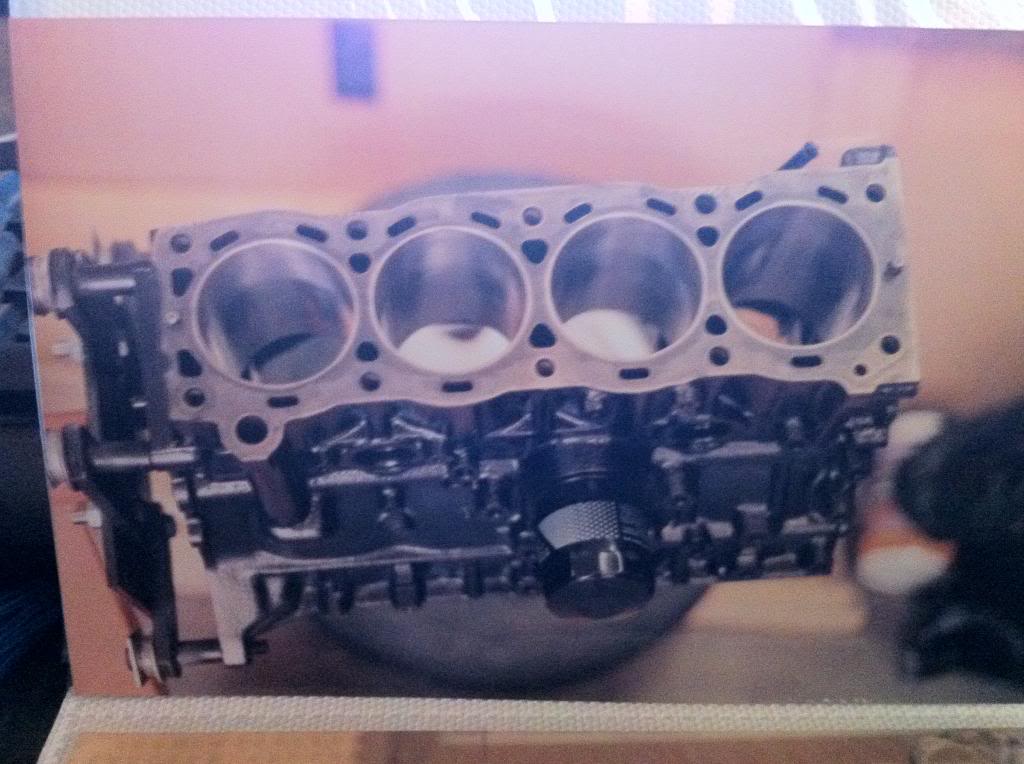

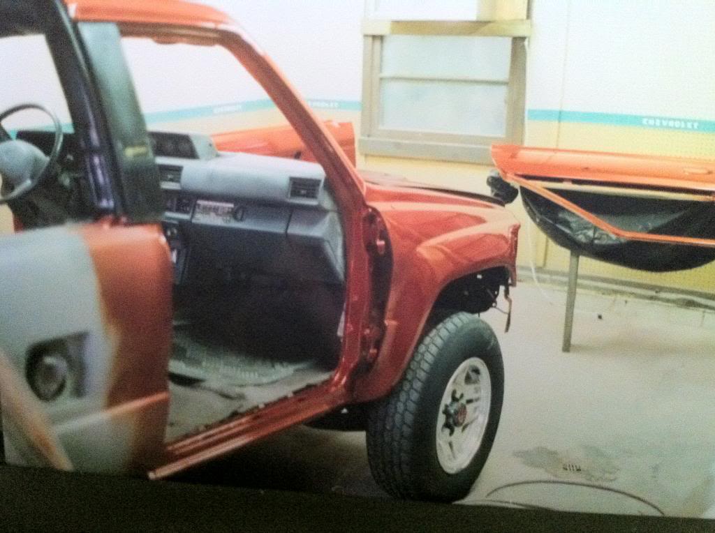

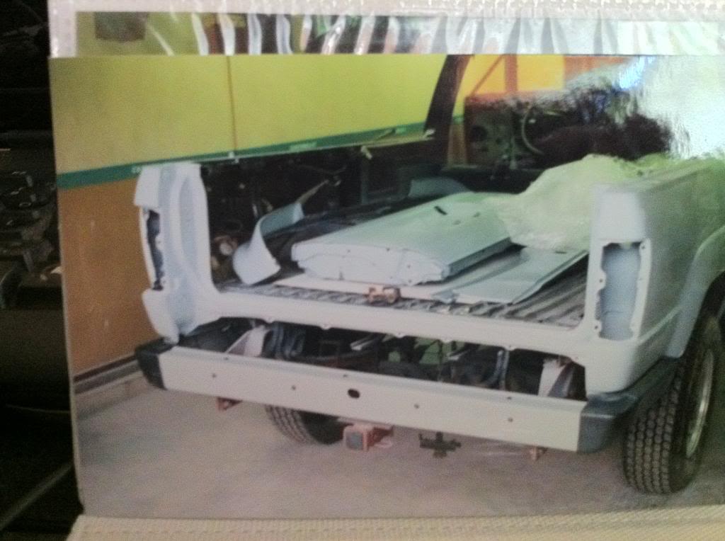

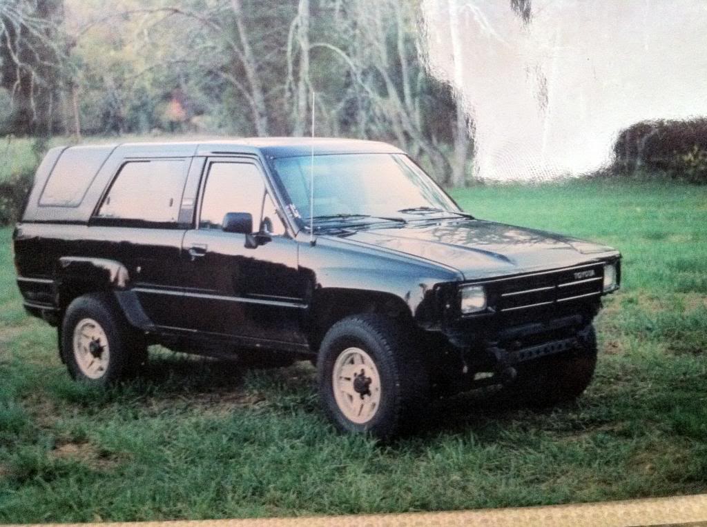

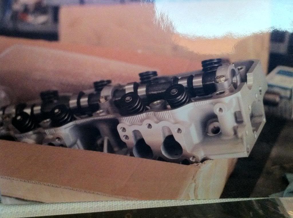

Was looking through some stuff and came across the pictures I recieved when I bought the runner. Father son build. I got such a deal on this truck.
My 4runners history. Kid owned her and drove her through a fence.
Insurance co totaled her. PO and son bought her to repair.
And here are my trucks roots.... sry for pics of pics.
