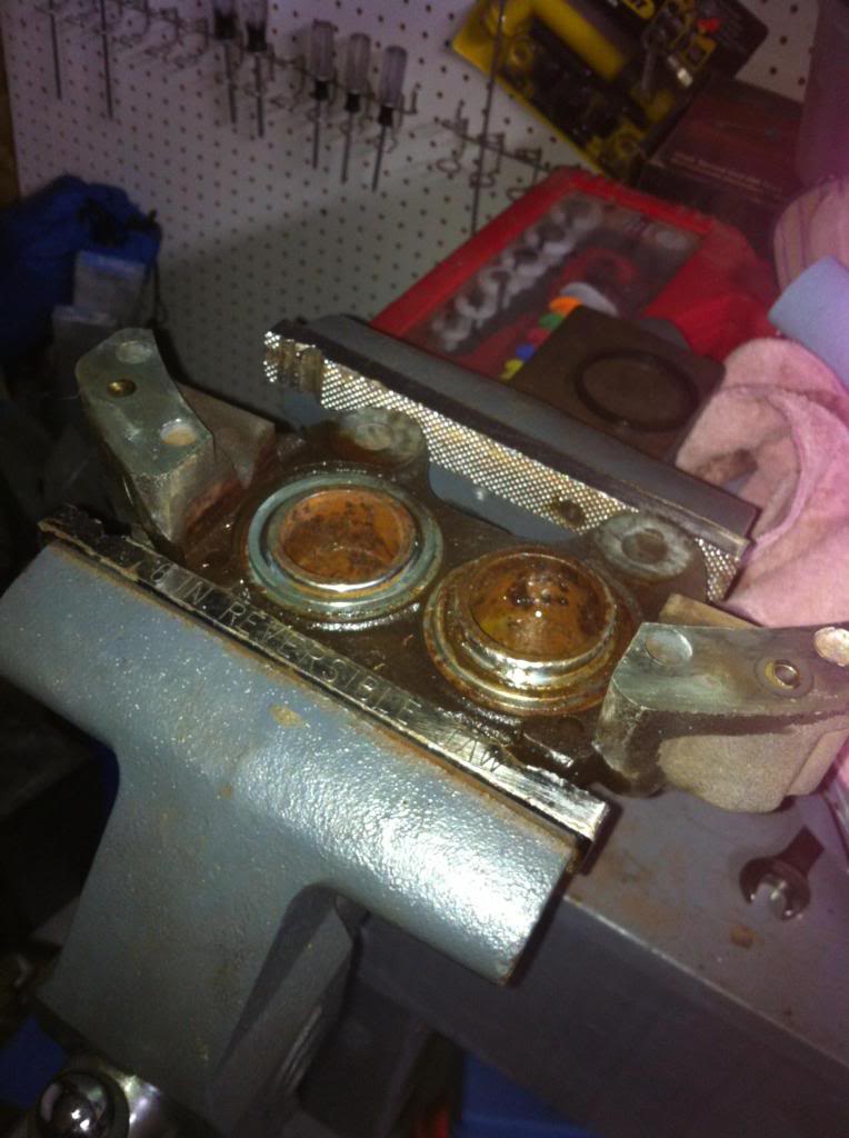

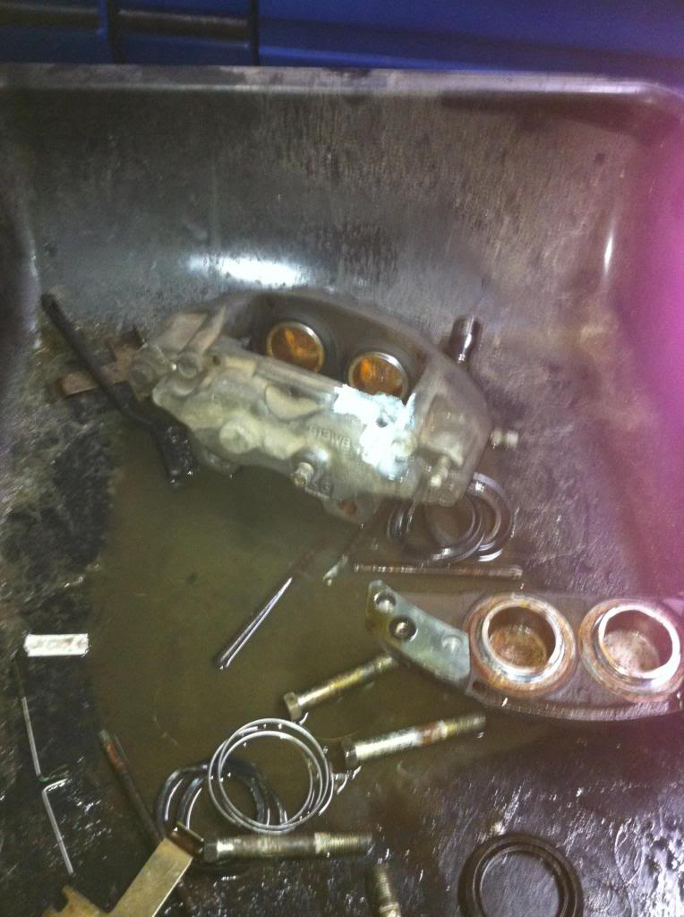

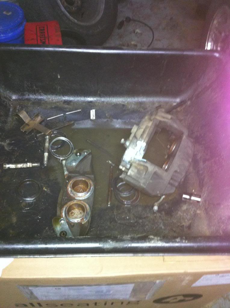

Got the calipers broke down for rebuilding/painting. Pistons are being a pain. Air not getting them out. I have em soaking.

Here. Pistons and bores look perfect. Inside of piston is rusty...but ill clean em up.

If I recall right, I used my air hose set at 20 lbs and the pistons come flying out of the bore. I was surprised that little pressure sent one flying across the room. It was a good thing I was not in front of it, it would of left a mark on me.lol They are easlily rebuilt for alot less then remans.

I tried air. I may have swollen the seals with pb blaster or something. Ill get them out if I have to dunk the things in carb dip and melt the seals out.
Matter of fact. Ill try that tomorrow.

It wont hurt anything as the kit comes with new seals as well for the pistons.

Yeah rock auto has the kits pretty cheap. I think they sat off the truck a little too long...prolly why hard to get out. The ones I have out are clean as a whistle though. Just the crud around the very front thats making it hard.
I have only really spent about 20 minutes total on them. Bout long as my neck can take.
