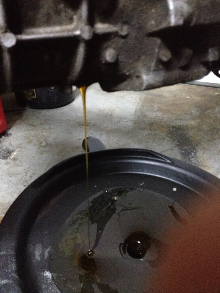

Carried it up to the garage. Man that was pretty heavy. Dont think Ill try that again.
Popped it up on some jackstands and drained the trans fluid. Started cleaning the rear main seal spray from the bellhousing.
Look how nice that gear oil was!! Thats a good sign!!
Old Feb 14, 2013 | 03:12 AM
  #120
Terrys87's Avatar
Posts: 11,787
Likes: 28
From: Anderson Missouri
You may have lucked out as that is some great looking gear oil. The paper gasket from Toyota is $2.14 and even though it is paper, when it gets soaked with oil, it seems to take on a completely different material. Also changing the seal and gasket on the front of the tranny is easily done if you decide to try and wrap that up as well.
