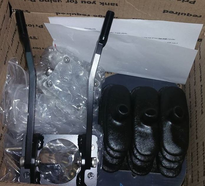

in an effort to keep the center console intact ordered one of Rory's Triple sticks.
I'll have to massage the transmission tunnel slightly with a hammer for a little clearance but this will help. I should have kept the triple sticks from the Trekker:der:
very cool. Can't wait to see this all put together
Heads-up on the adjusters for the levers: locktite or lock nuts. They vibrated loose on me going down the road. Not a hard fix, but easy to do when first installing them.
Thanks for the heads up Ian!
