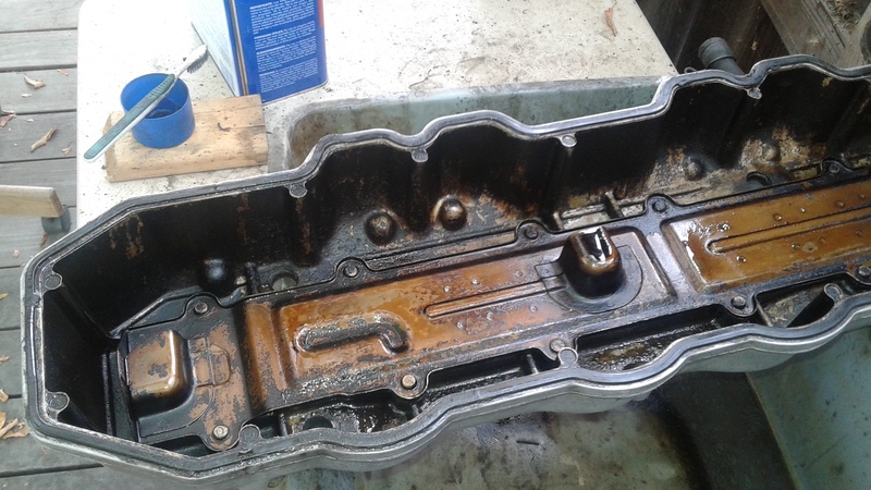

So, I hear valve chatter that needed to be addressed before heading to the smog station. I discover more neglect from the PO after removing the valve cover.
Some one missed a few oil changes would be my guess. The whole valve train was covered with carbon deposit buildup, which is noticeably visible on the inside of the valve cover.

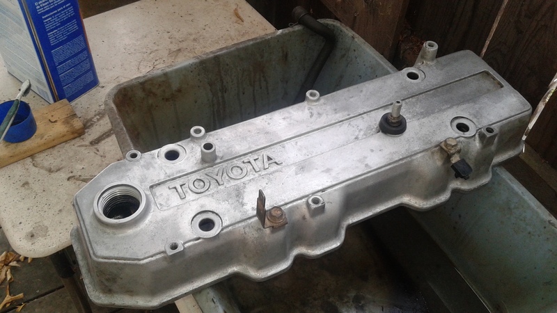

I also decided to clean up the outside because of an oil leak which is now mended with new gasket and grommets.

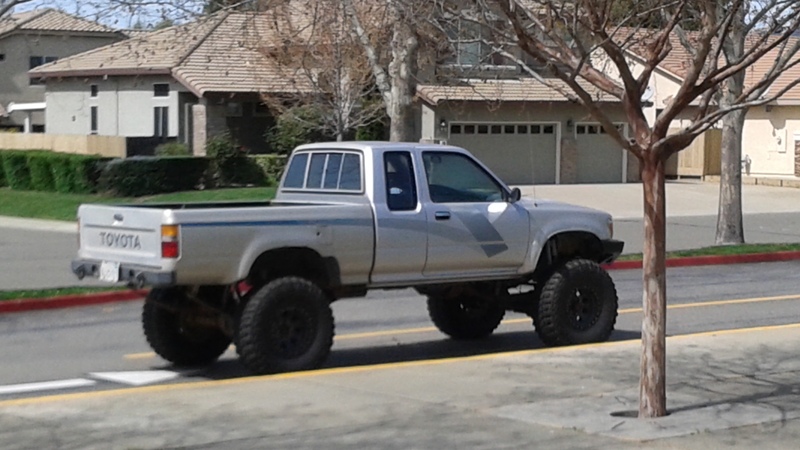

OMG, fellow yotatech'ers, I have a super awesome update for you. I have HI-PRA on the road. I have been driving to her to work for the past two days.
Here is the pic, so it really did happen.

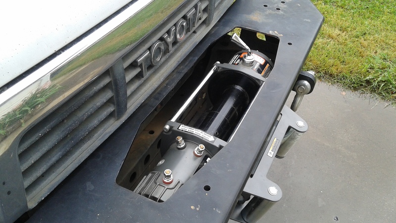

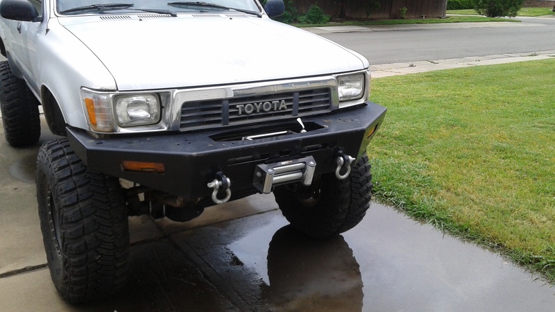

I did some work today while it is not raining. I have had a Badlands winch since 2010. I was going to install it on the 86, but we all know what happened to that rig. So today I bolted her up after having the winch sitting in the garage for many years. I have not done the electrical at this time, just bolted the thing in place. I will get a battery cutoff switch and possibly finish the install this week. Here are some pictures of my progress.
