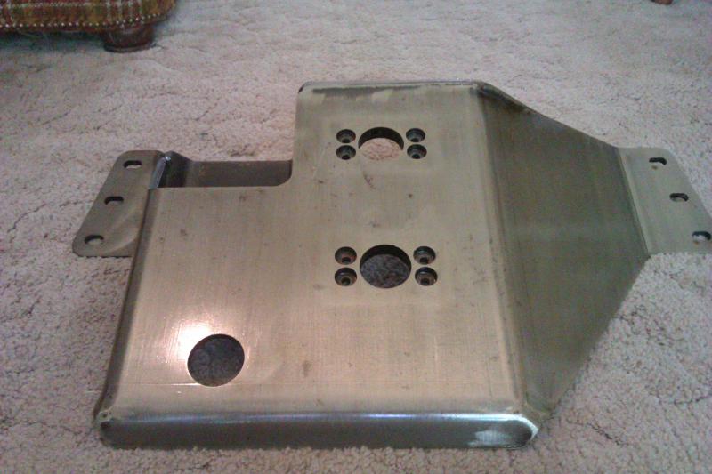

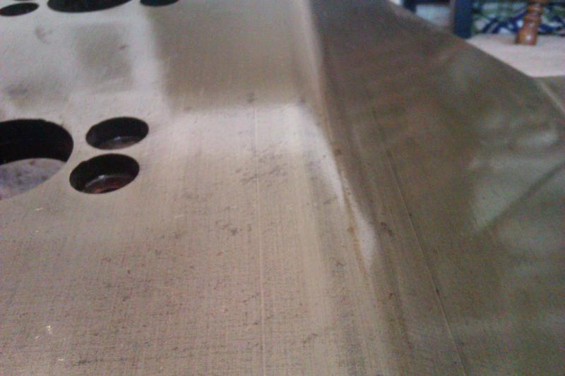

Thanks, I wanted to do something different that I have never saw, and started with the T-case crossmember.
My plan has been to do the same finish to every part I add to the rig. The bumpers I build will have the same finish as well.

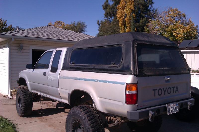

Well I am working on clearing out the garage, and decided to get the shell out of the way by placing it on the bed.
I bought the shell before I bought the truck, and the shell has been sitting in the garage since. The shell needs to be fully rebuilt so the shell will not stay that way, but now that the shell on; I can now see something I have added to the truck that make the truck seem more like it is my rig.

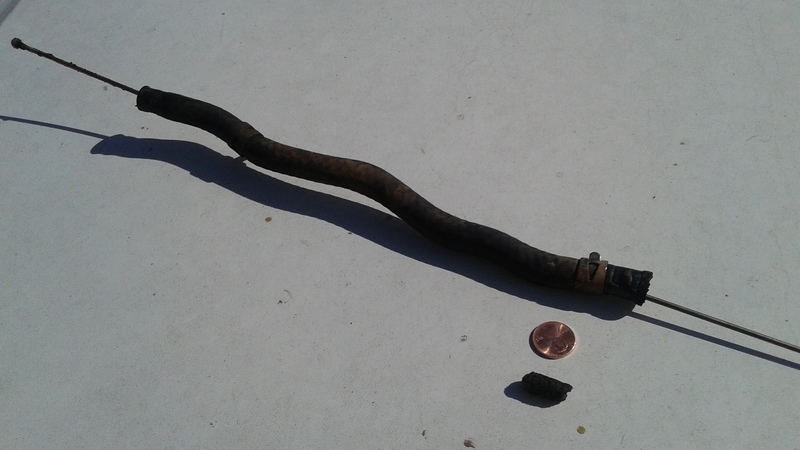

This past week I have the 89 all together, charged the battery, and cranked her over. I was super excited to hear it run again. But, there is a new problem now, the idle is high. I think its the idle air control valve, maybe there is an air pocket in the coolant line. I hope to narrow the issue down this weekend.
Once the high idle issue is solved I get insurance on her and go pass smog. I am damned ready to enjoy my investment.

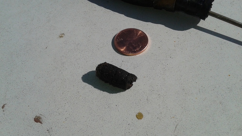

I solved the high idle problem. Turns out the coolant hose that runs from the intake manifold to the Auxiliary Air Control Valve was clogged with what looked like felt. The clog felt like really compacted dryer-lint. The clog is next to the penny in the picture.

I punched the clog out with an old CB antenna through the coolant hose.

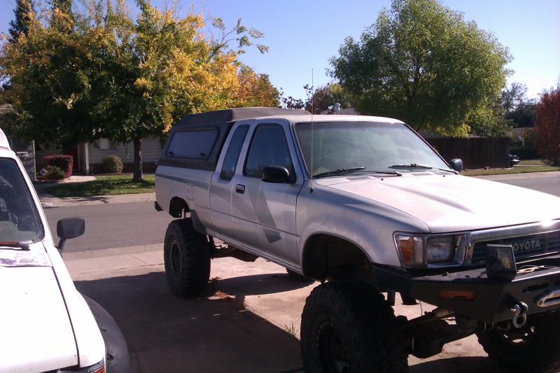

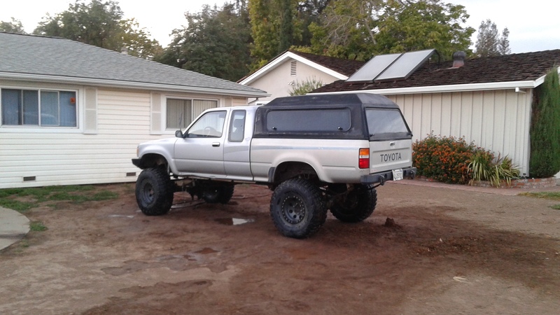

Here is a poser shot, I finally got too drive on to some dirt (my front yard ).
This is the first time the truck has moved since I bought it, and I decided to wash off all the dust that has accumulated over the past three years.

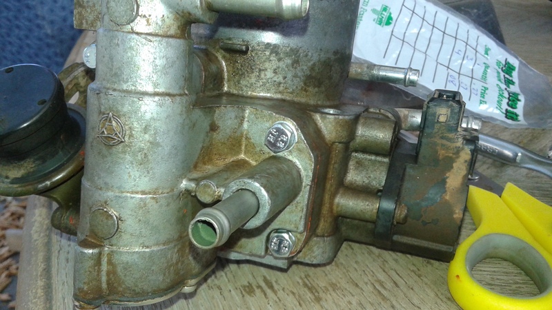

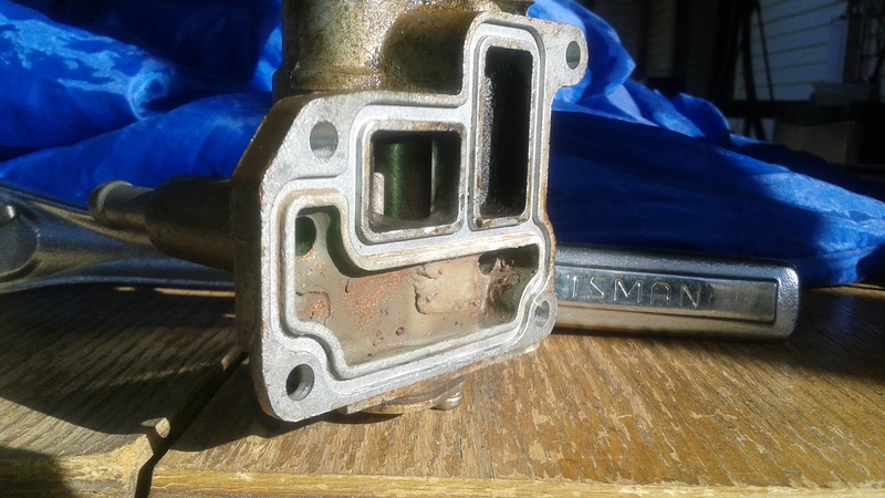

I got the entire coolant system fully flushed. When I went to remove the throttle body I discovered a second clog in the coolant line in the same location as the first clog, but this time the clog was inside the auxiliary air control valve. I then proceeded to take the valve off of the throttle body and found soot and buildup from the stop leak crap that the PO had poured in.

The buildup was thick enough that I could write my initials with a toothpick.

I decided to replace the phillips screw with 5mm hex head bolts with a thread pitch of .80 when installing the valve back onto the throttle body. The screws took on some damage during removal so I was not going to use stupid phillips screw again.
