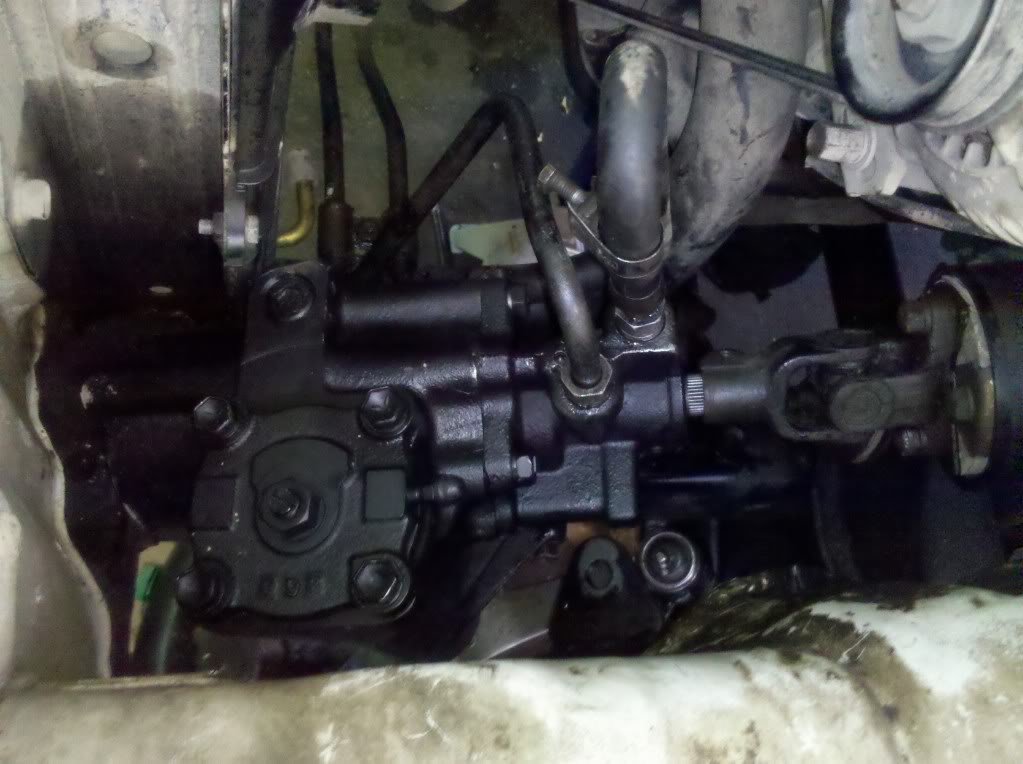

Well got my new Power steering Box Installed.
Here's the write-up: https://www.yotatech.com/forums/f116...ite-up-240190/

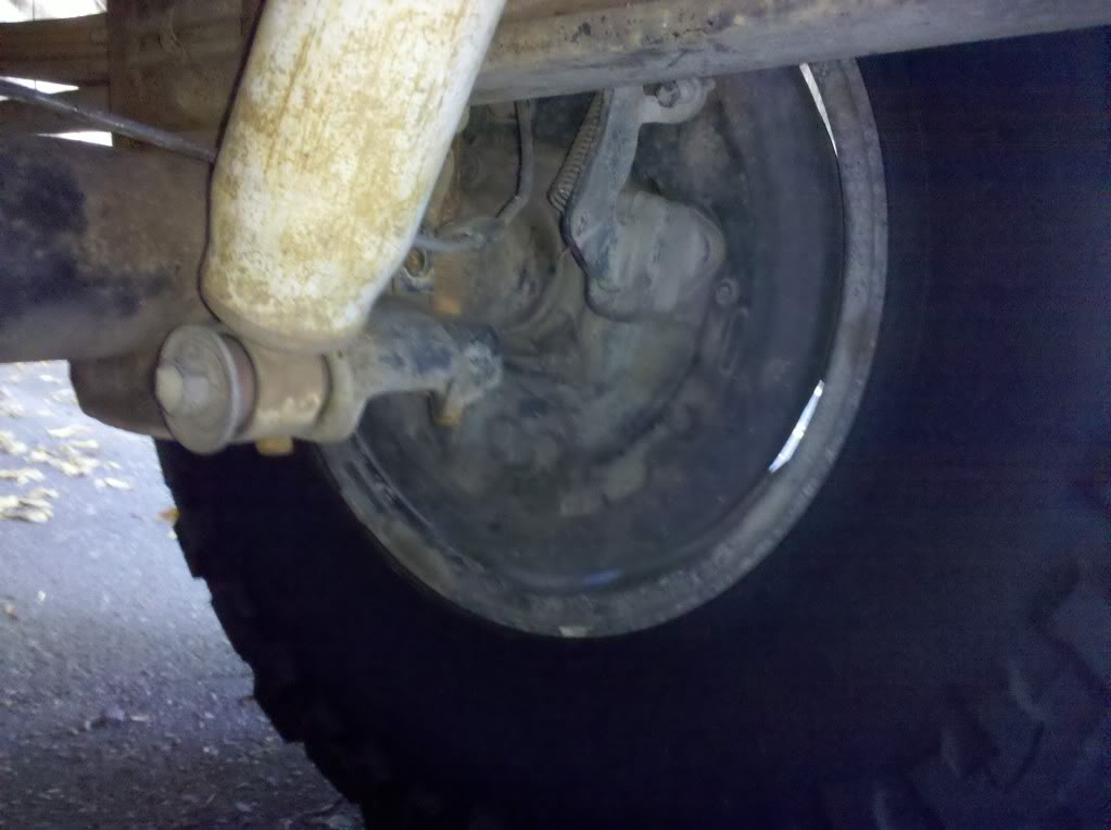

So I looked under my truck the other day and saw this.

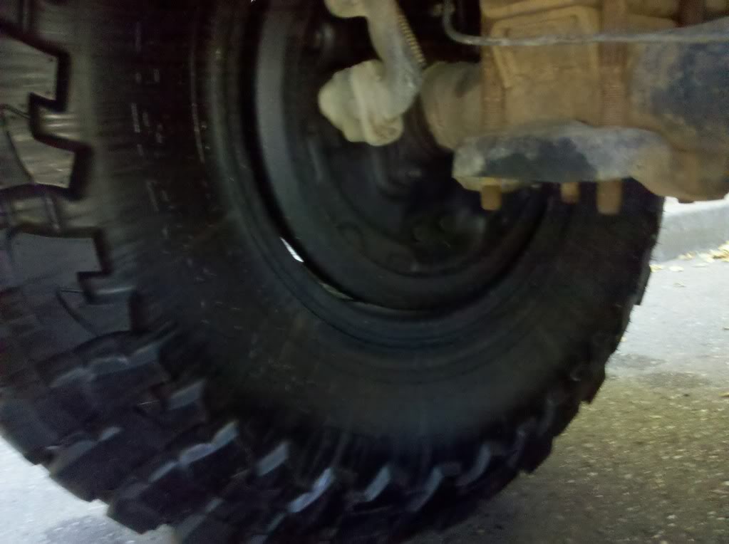

Yep, my rear axle seal is leaking. YAY!!!!!!!!!! -_-
Here's the other side for comparison

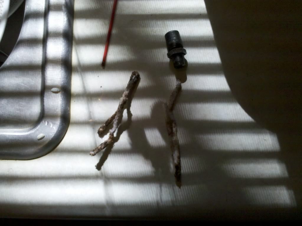

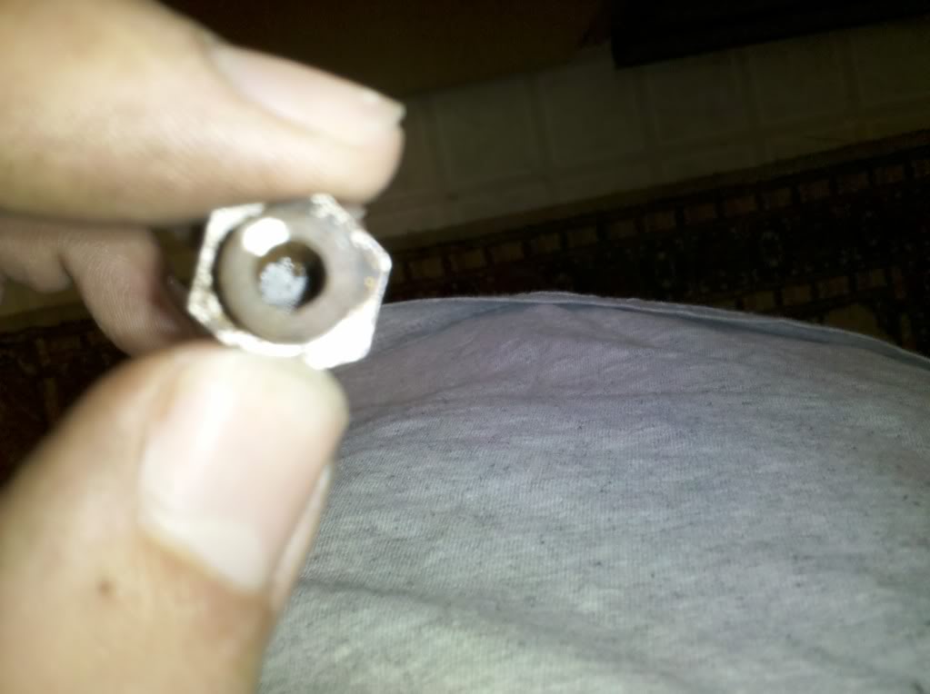

After some reading, I learned that the diff breather being plugged can cause pressure to re-route through the seals. I looked at mine and the cap moved up and down so I knew it wasn't rusted shut or anything. So I took some PB Blaster and a 14mm Wrench and removed it from the axle housing. The whole inside of the breather was completely filled with crud.
So I cleaned it out using PB blaster, used a couple of my roommates pipe cleaners (I'll give him a dollar when he gets back, he'll know its for a good cause), and soaking it in hot water.
All clean, and I can actually see the other side.

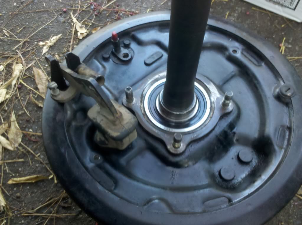

Got new new axle seal/bearings. Here's my write-up if anyone is interested:
https://www.yotatech.com/forums/f116/rear-axle-seals-bearings-write-up-250062/

How much diff fluid came out when you removed it? if you didn't run it dry, it should be fine for the diff bearings if it was still 1/2 full when you discovered the leak...
