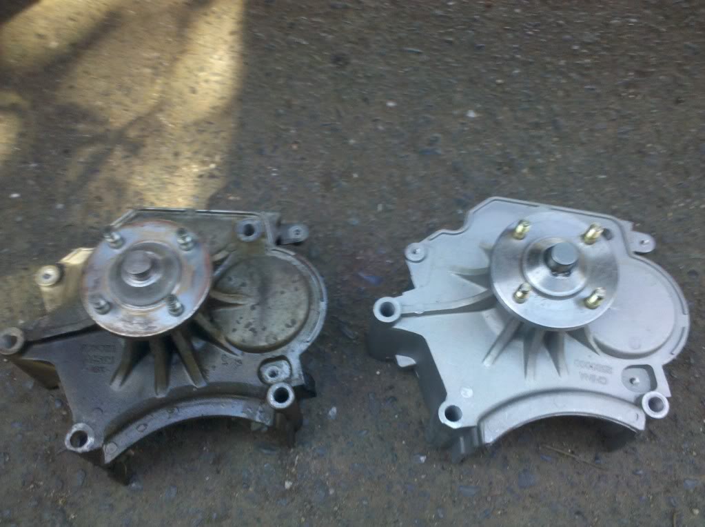

Uhh... your false water pump is failing. thats why you're having fan problems. You need to replace this as soon as possible before the shaft comes out completely and jumps into your radiator and grenades everything.
When you pulled your fan clutch, theres 4 studs it attaches to. that is the False Water Pump. you need to pull the radiator, hoses, belts, fan, fan shroud, fan clutch, timing belt cover, and you'll see the False water pump. all it is is a Cover for the water pump, with a few bearings and a shaft. its more of less used for a guide for the belts. ) but I can almost guarantee this is the culprit.

I've been researching about the fan bracket for the past couple days. The only reason I'm in denial is because the pulleys don't wobble with the fan. Looks like I'm wrong about it being the fan clutch, I'll replace it when I get a chance and see how it goes. Doesn't look difficult to do at all.

Better safe than sorry, The false water pump is like 60 bucks. better than having the fan grenade and launch large ABS plastic into your hood, radiator, and hoses. I have a NAPA one, and it seems to be holding up. the first one I bought had a defect and the entire assembly pulled out and knocked all my belts off.
I think AISIN ones are 130 ish from the dealer.

Okay, well I called up NAPA today and had them order me up one. I got the NAPA one which was around $114. I asked if they had an AISIN part but it was about $2xx. Money that I don't have right now. What sucks is I got laid-off a couple days ago, haven't been compensated as of yet. I haven't even got my student loan yet which makes things even worse. So if this doesn't work I'm just gonna run it, because I don't have much of a choice.

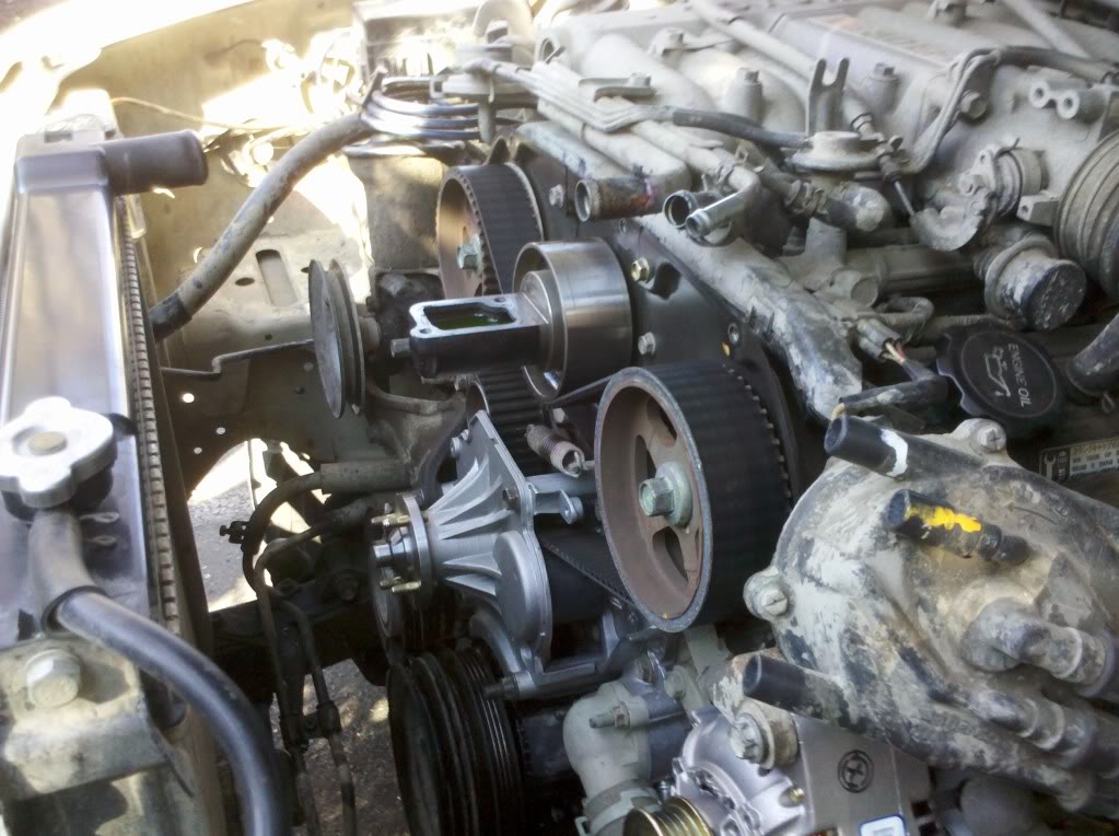

Got a new fan bracket, but it didn't fix the problem. I don't really know what it can be. Either I got a faulty part or something else is wrong. Either way, I've run out of funds for the time being, so I'll just have to run it as is for now.

Write-up on how to replace: https://www.yotatech.com/forums/f116...ite-up-250004/

Yep, I just went over to take a good look at the fan, and there's some weird bends to it as I was rotating it. I'd be really mad at myself right now, but it was kinda cool getting behind the timing cover. Who'd of thought that the fan would be bent, the last thing on my mind.
I'm just tired of dealing with it already, it will be the third time once I dive into again. Time to look at cooling fan prices.
