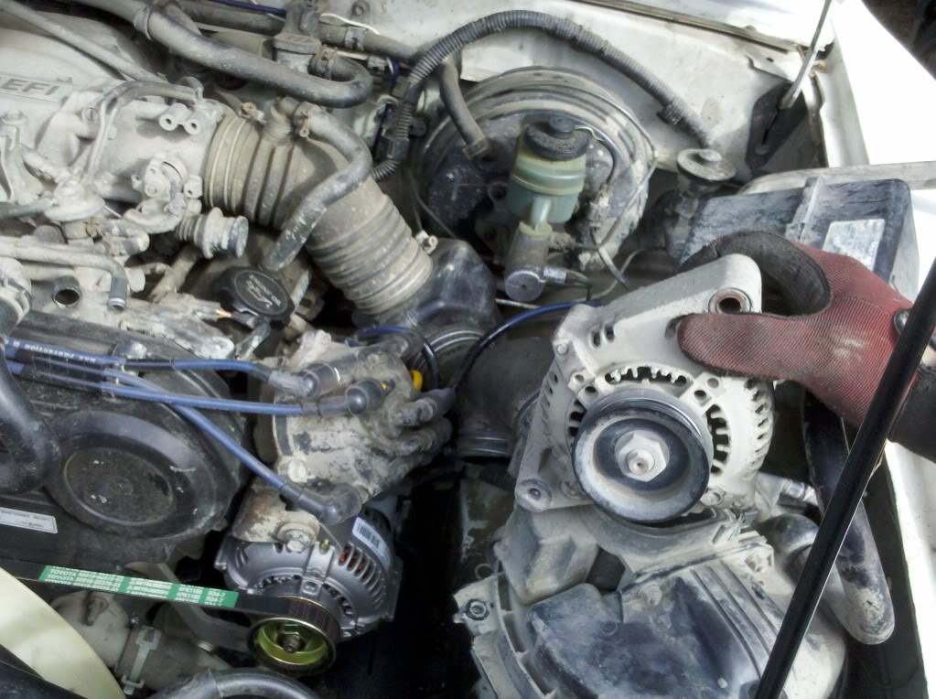

So at work, I went on a parts run and I noticed my Battery Light and E-Brake Light were both on. I was definitely worried, but my engine was still running so I got the stuff and came back. When I went on another drive, it went away. I read that both those lights will come on if there's a charging issue.
I figured it was just a wiring issue, but then it came on again today after school. It would go away if I had the engine rev'd up, but that only worked for about 10 min. So I was pretty sure it was the alternator going out. Luckily, even after getting some welding equipment for my class and getting an alternator at NAPA I still made it home. Only took about 25 minutes max to replace.

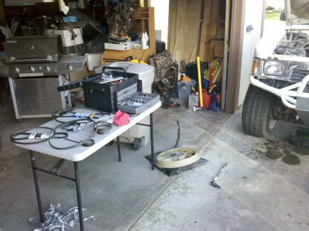

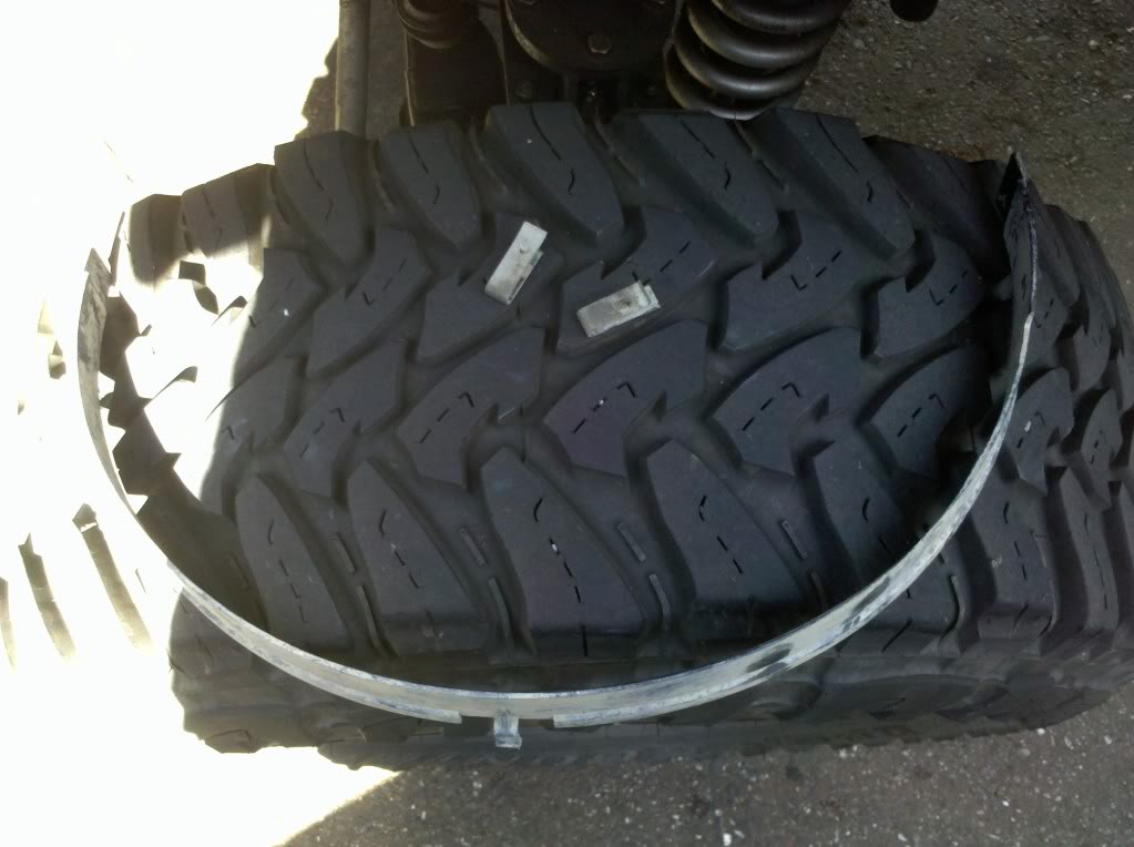

Here's a picture back in high school when I did belts for the first time. I thought the fan had to be removed to replace them. Looks like I wasn't able to remove anything without removing the upper radiator hose. Man, I made a mess, I probably didn't even drain the radiator from the drain plug first lol.

wow thats too funny. i know when i 1st started. i hated fishing the belts thru the fan. the coolant trick works. i do it all the time at work when i just need to remove the upper hose to do T-belts

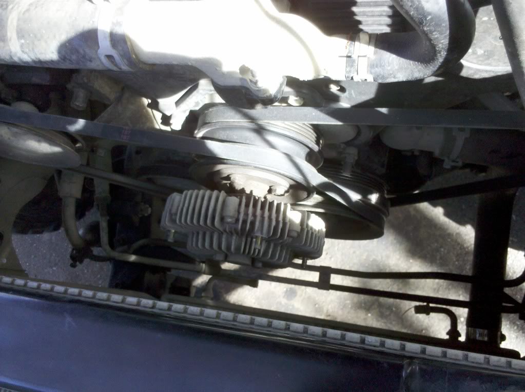

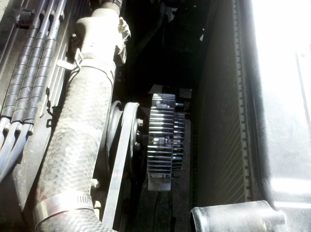

Well, I replaced my fan clutch. Unfortunately, it only fixed my fan wobble slightly.
Anyways, here's some install pics from today.

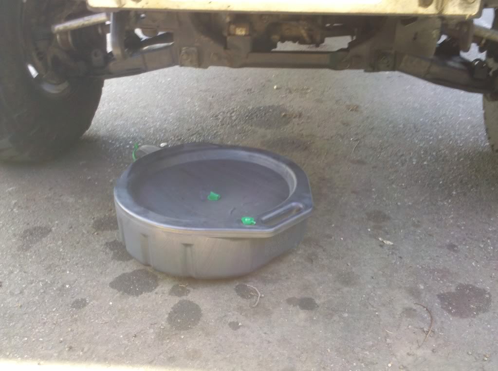

First I drained the coolant like ToyoTech suggested.

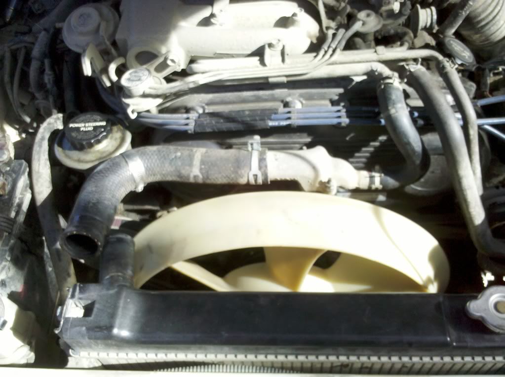

Drained coolant from the drain plug, I only drained it until the fluid level went below the upper radiator hose. Disconnected the upper hose from radiator and left it there.

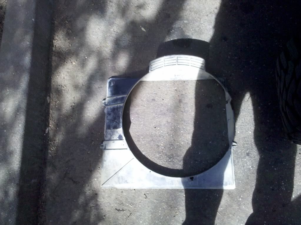

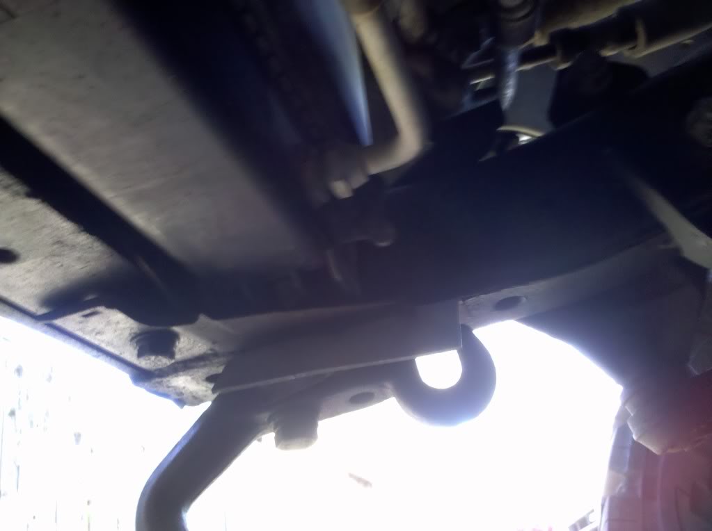

Took off the 2 clips holding the bottom half of the shroud
Then I took off the 4 10mm bolts holding the shroud to the radiator.

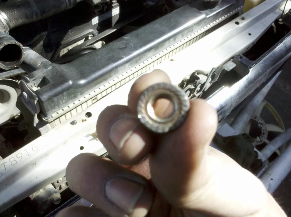

Unbolted the 4 10mm nuts holding the fan to the fan clutch. I was gonna thread-lock the studs, but when I saw the other side of the nut, I felt it was gonna be a little unnecessary if I did that. I had removed the fan and fan clutch once before and installed it without thread-locker and it had been fine ever since.

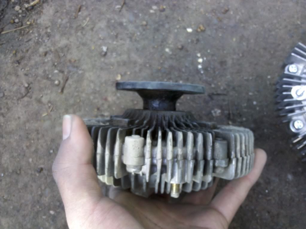

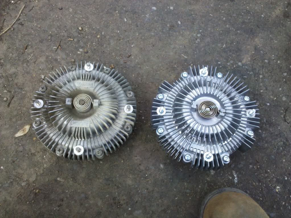

Side by Side, Old: AISIN New: BECK/ARNLEY.

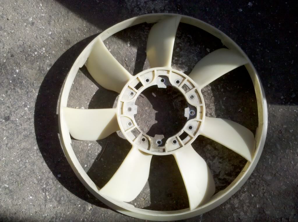

Here's a video of the fan still wobbling, I don't get it, none of the pulleys wobble at all. Not even a little bit, which is why I thought the problem wasn't the fan bracket. There were no visual cracks on the fan tabs that go to the fan clutch either. I'm stumped, I'm thinking about just ignoring it. I can't afford anymore repairs right now. Anyone else have similar fan symptoms?
Now about the squeak issue that I think are my wheel bearings. Many people have posted that they hear a growling sound when that happens. Mine sounds like metal to metal, or like when brake pad indicator makes noise. It's intermittent though, and what's worse is I'm not even sure where it's coming from. Could be my rear brakes being low, but I don't know. Any thoughts? Warped Rotors?
