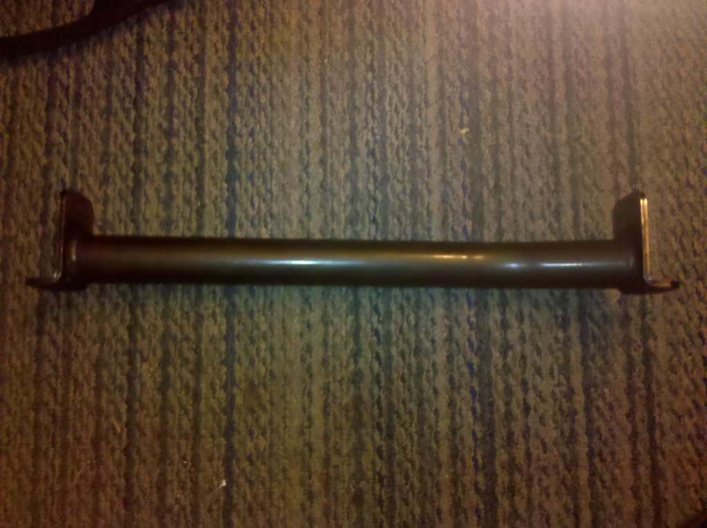

When my truck's frame gets straightened from the shop this total chaos truss is going in.

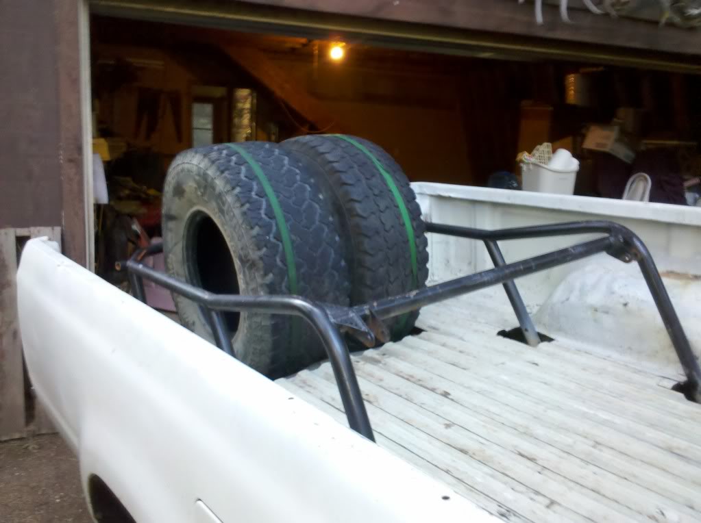

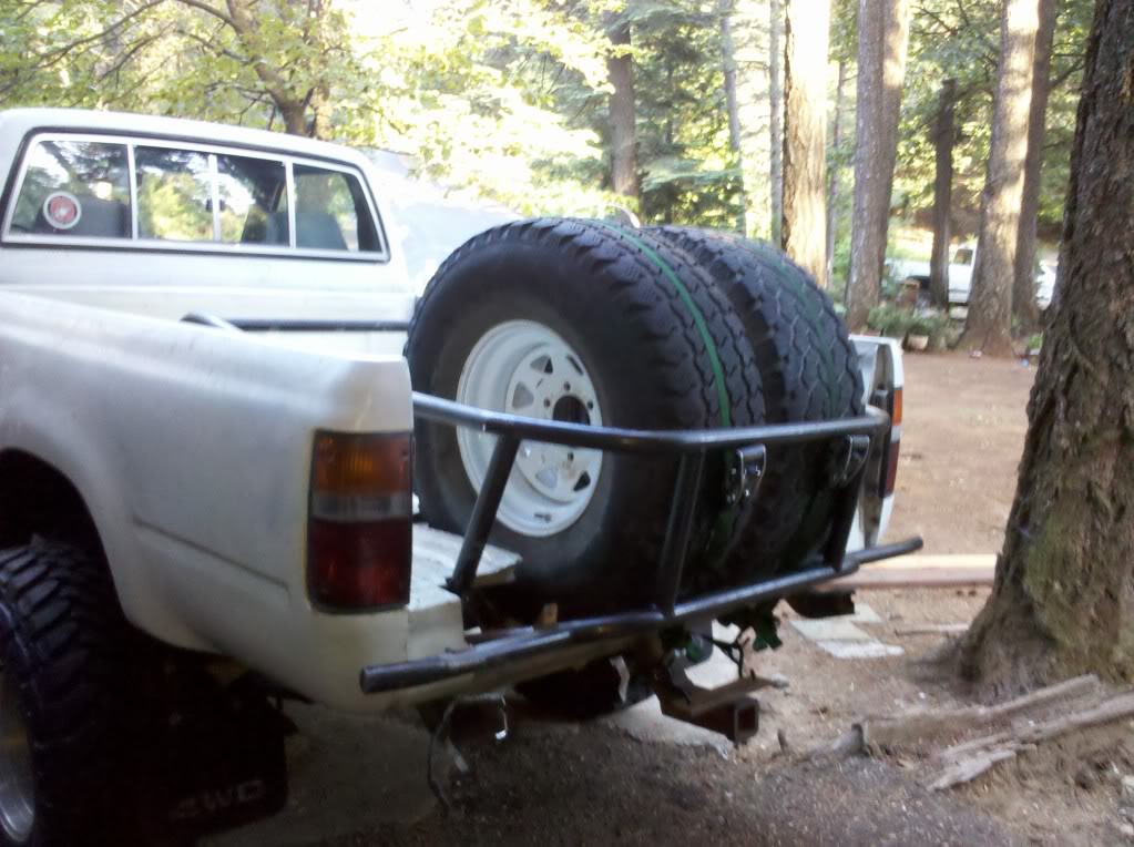

Bed Cage
So I got a bed cage now. Still needs some work, I didn't have time to finish welding because I just moved in to a new place, but it's good for now.

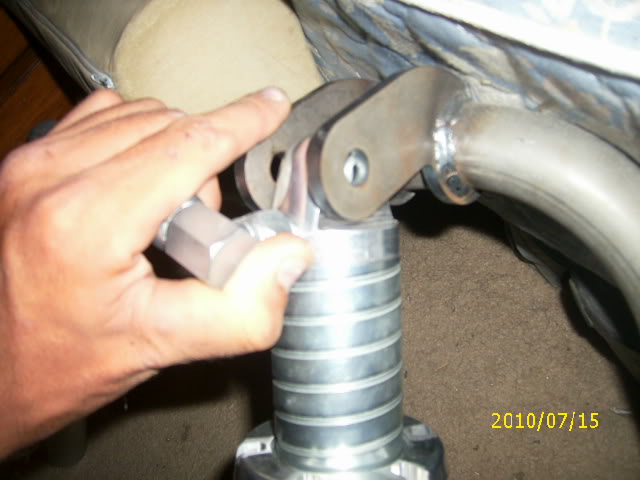

Just had a quick question for you, did you have to grind the shock mount in order to get the shock bolts in on the shock hoop? And if so, how much did you grind off? I just about have everything to put my blazeland kit w/ coilovers on and noticed that the shock doesnt quite have enough room. Again, thanks for the help and your truck is awesome!

I didn't have to grind the shock mount, I had no trouble getting the bolts in either. I don't really get what you mean though, can you give me some details?
Heres a pic of the shock and mount. At all angles the shock eyelet is about 1/16th of an inch off from the bolt hole on the shock hoop.

Oh I see. It looks to me that the mount hits the shock body before the eyelet matches the hole correct? I never ran into that problem. I would either grind off a little bit to make it fit, or have a talk with Nate about it. It may even be the shock manufacturer error too.
First off though, I would try everything like, did you get the misalignment spacers all the way in, what is the mount width of the shock (ie 1.25" or 1.5") and does it match the width of the shock mount on the hoop, try even a 90 degree angle, try matching my pictures and see how high the shock gets before it can't go up anymore.
I know it must be a little frustrating, but at least you caught that early. Sorry I can't be of better help.
Also, is that a 2.0 or a 2.5 shock? Maybe that might be a factor on how the shock is built as well.

This is the 2.0 coilover from f-o-a with the 1 1/4 width mount. The spacers are fully in and the mounting width on the shock is perfect at exactly 1 1/4. I think ill just have to do a little grinding to make them fit right.

Try to grind some material off the shock tabs. The 2.0 FOA must have slightly different specs on the machining of the top cap. Its hard to make universal fit with so many shock variations out there.

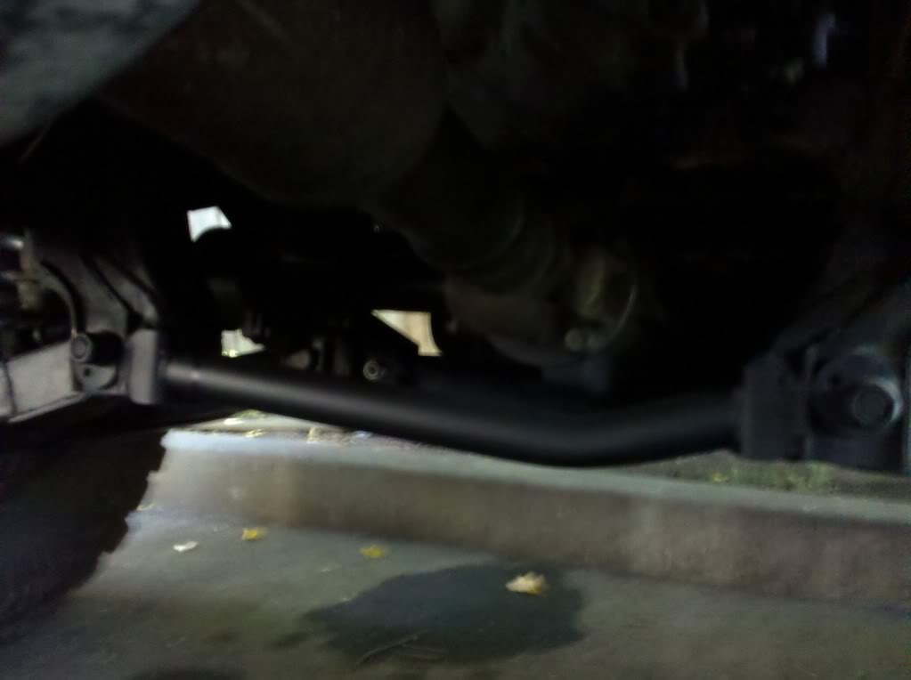

Pic of total chaos truss, for those who were wondering. Special thanks to a friend of mine for welding it in, same guy who welded my shock hoops. I had a go at it with his welder, but ended up dropping beads on the ground lol.
