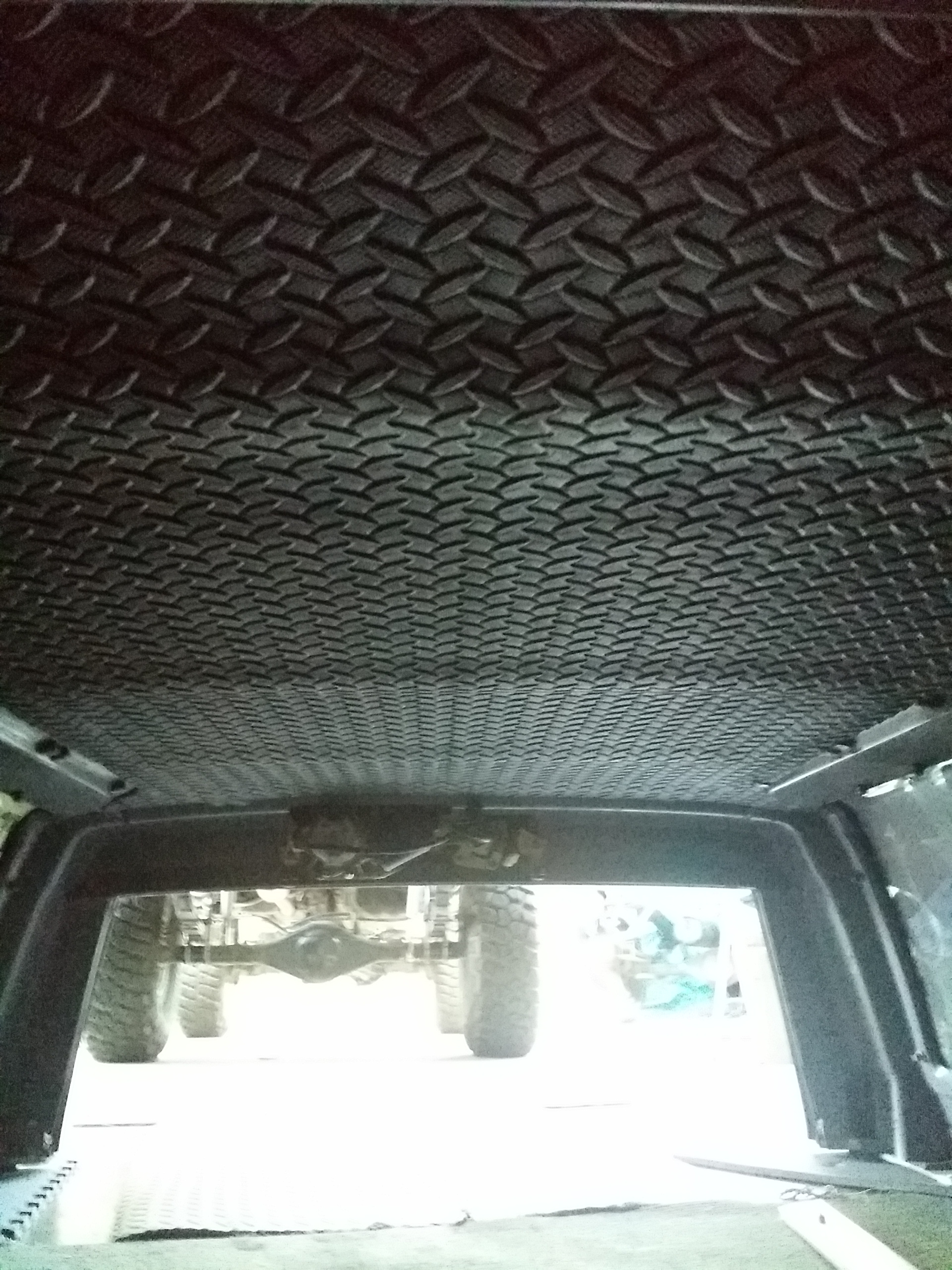

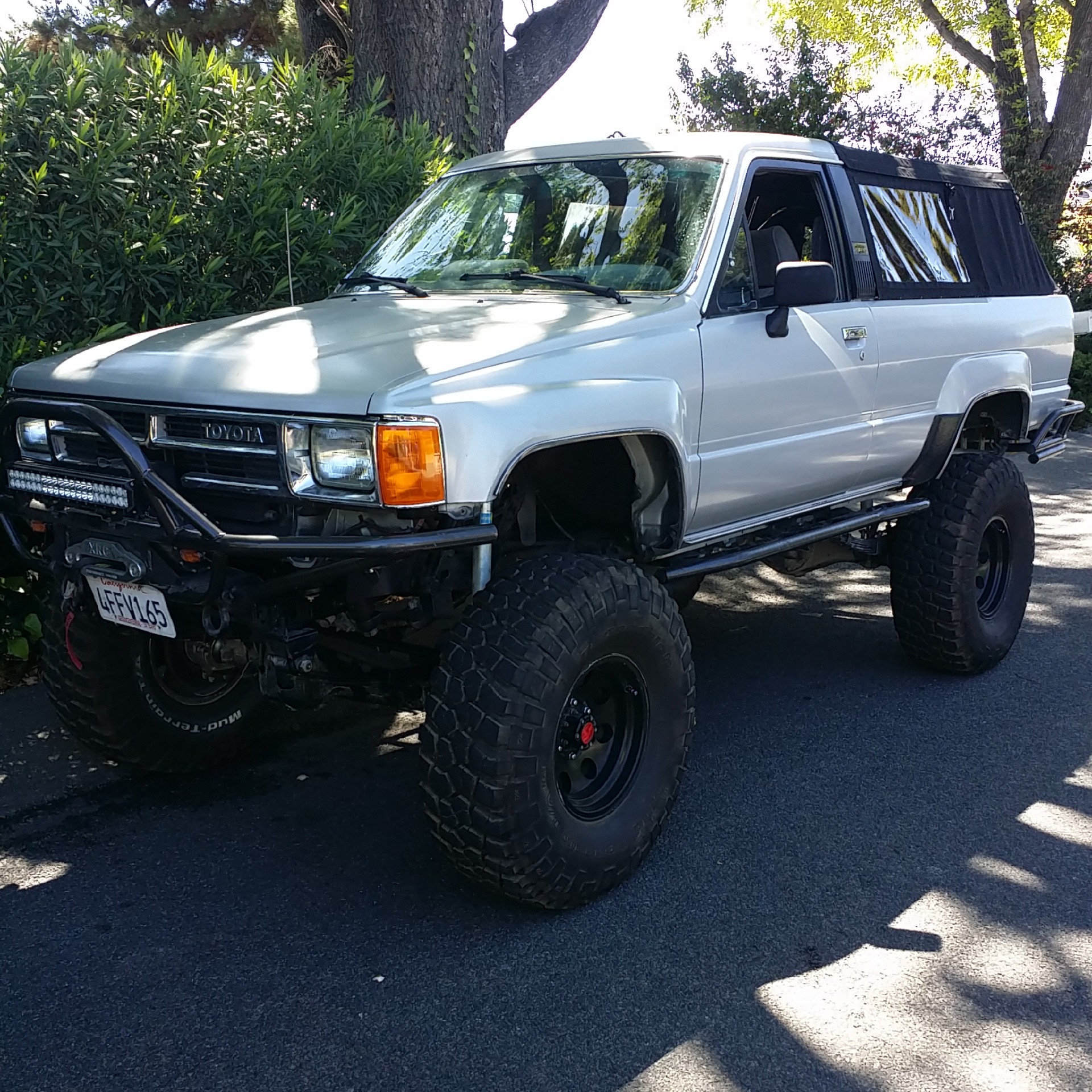

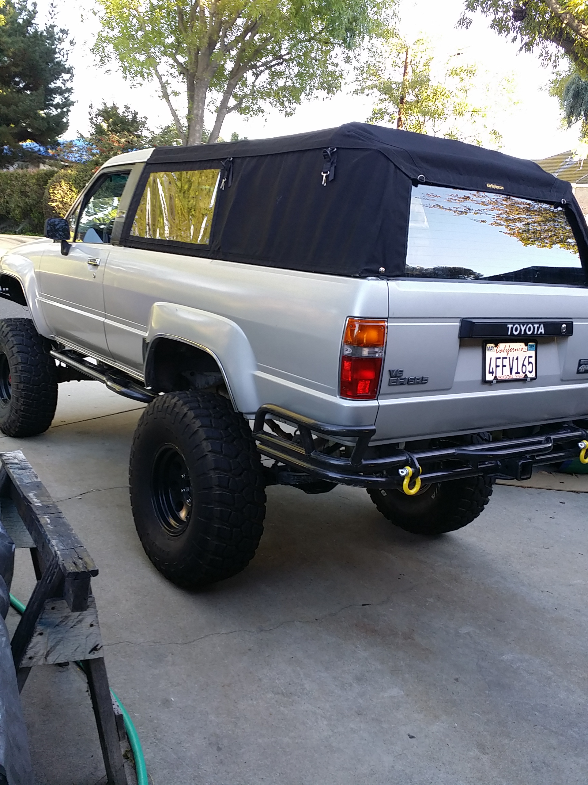

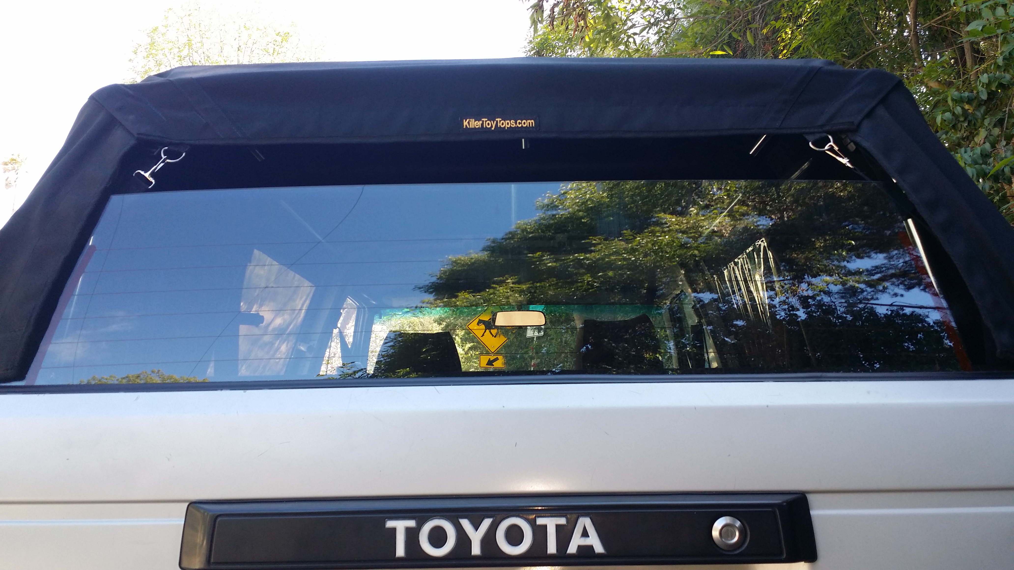

Finally took some time to get this on because we were expecting rain and I had to redo the headliner and I'm about to do the roof rack install on this fresh new-to-me shell.

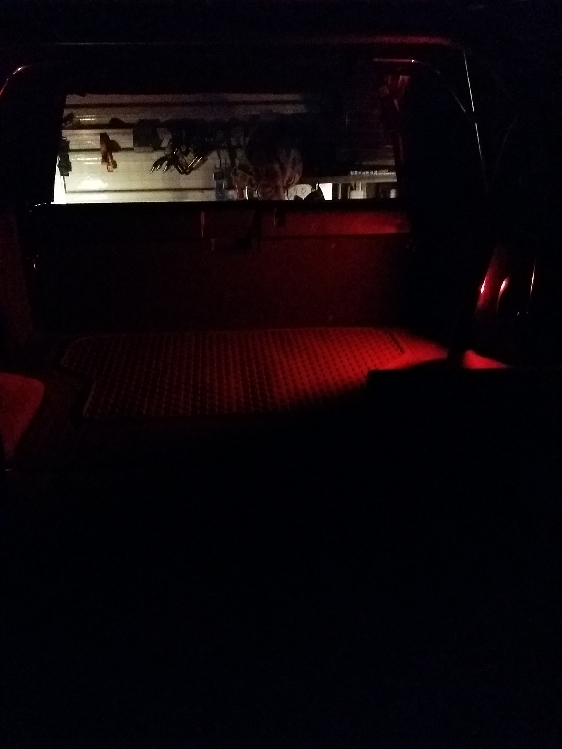

Got the RED LED going.....
Redid the shell headliner, using 3M-90, after stripping it down completely, what I had put on there, using acetone and then denatured alcohol.....
LOVE IT!
Now, ....on with the nerve racking part!....lol....

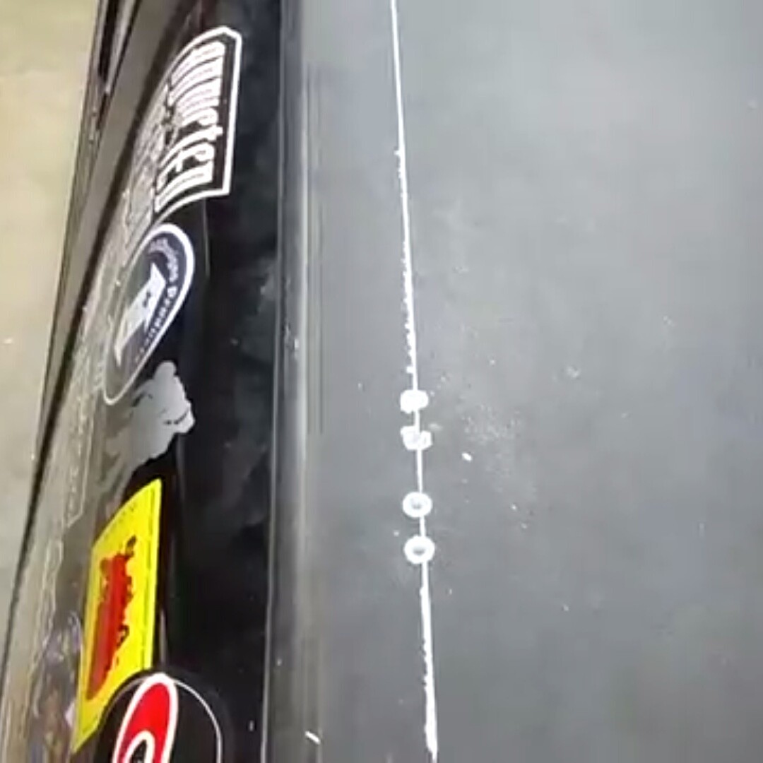

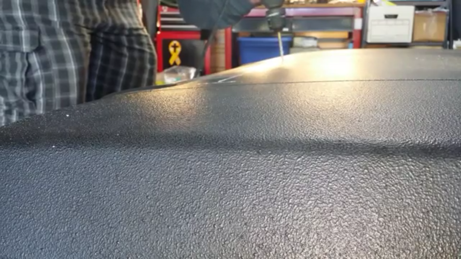

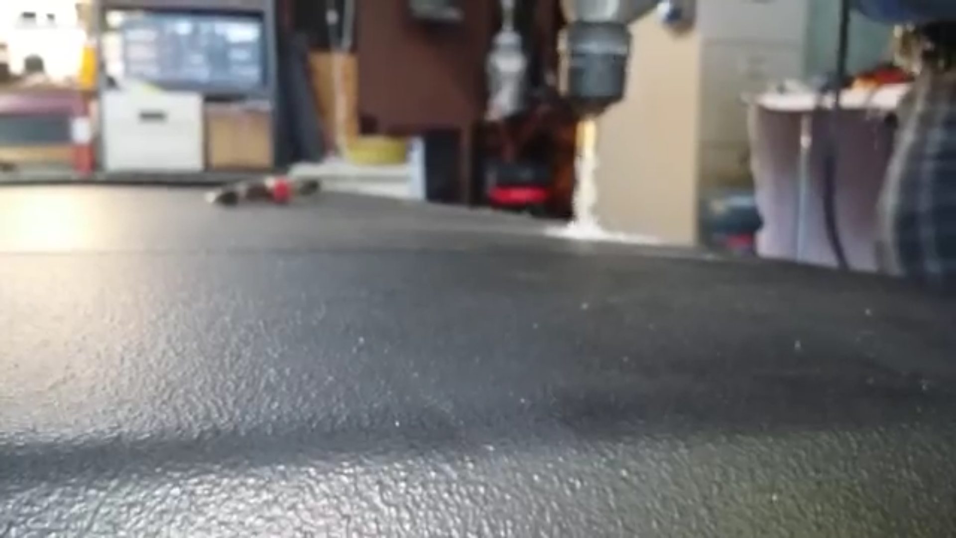

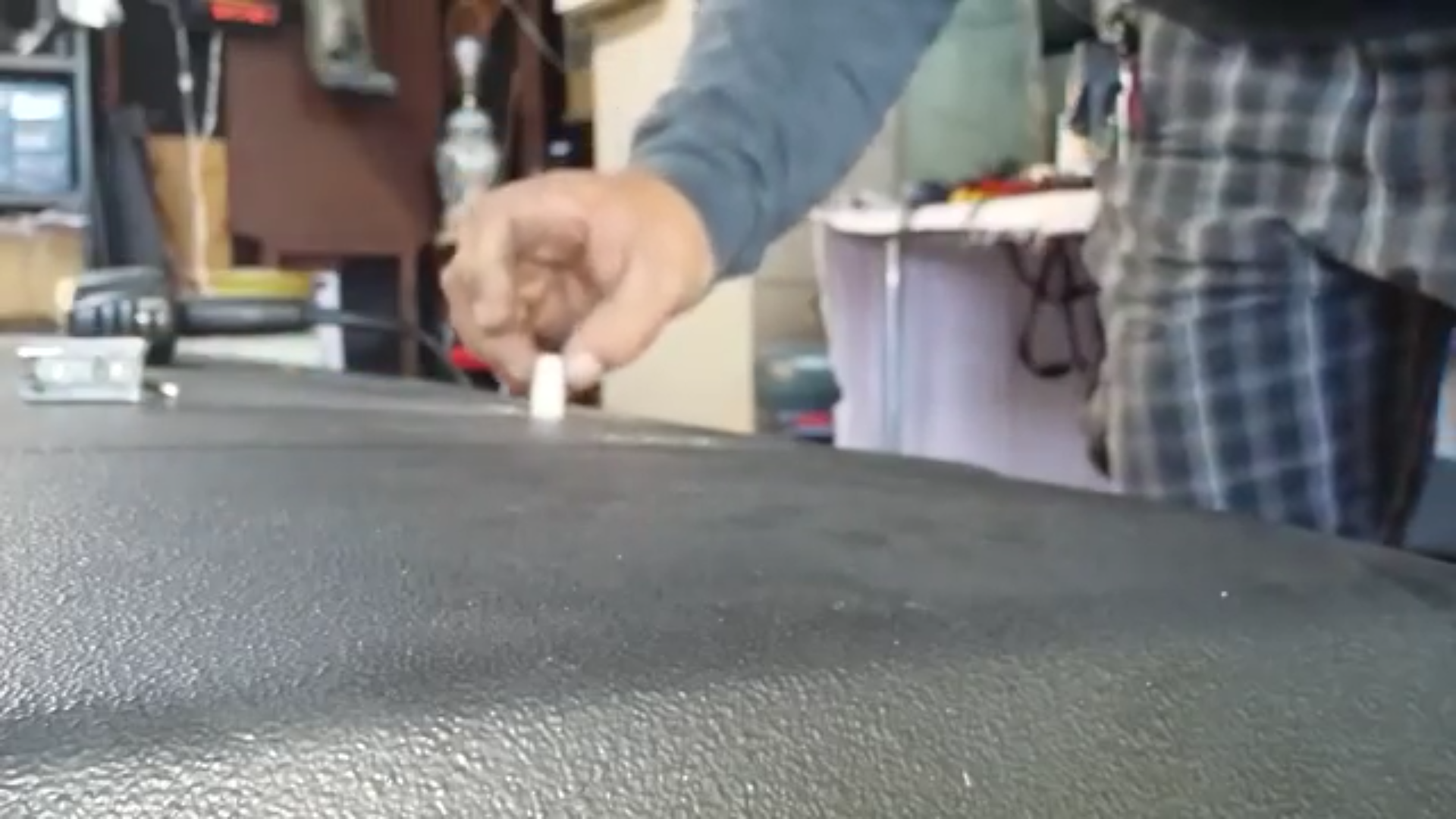

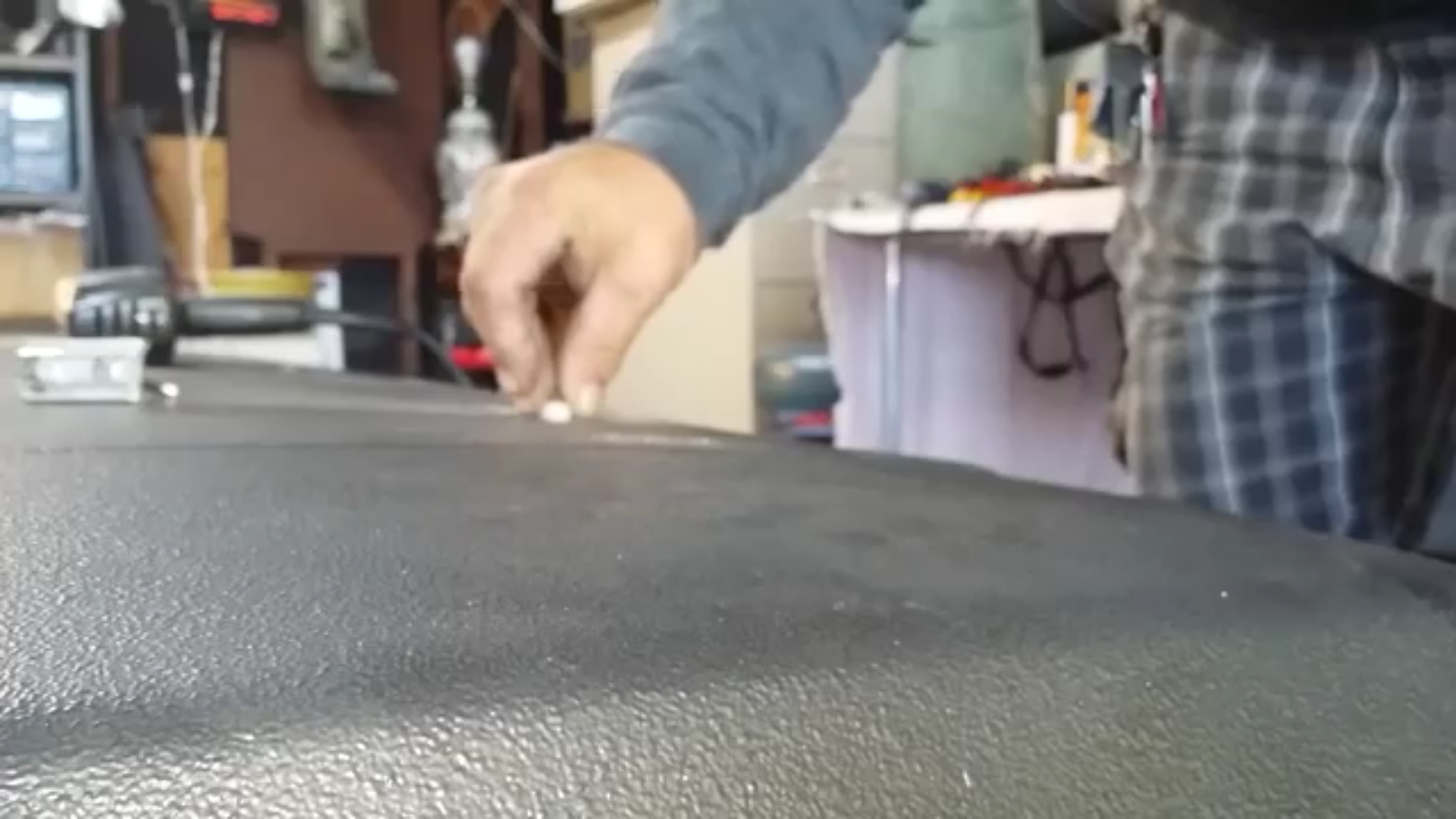

"Zombie Apocalypse", Roof Rack and Lights Project, NEAR DONE! ......
Very excited to be bringing another "Chef Marcus Mod" over to "Suzy-Q the Silverback"!
Pilot holes.....

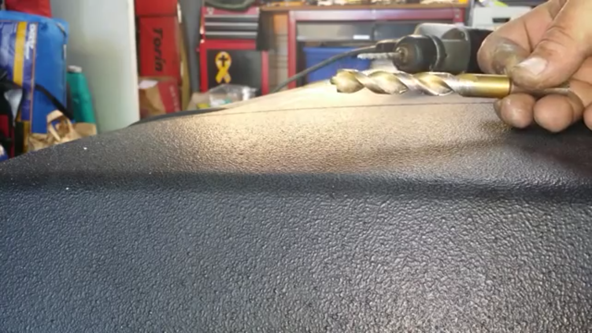

For 0.5" final holes for 0.5"/.257"/1" nylon spacers. ..

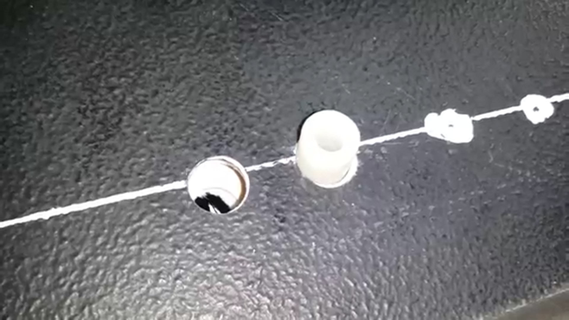

Inserting nylon spacers...
Excited!

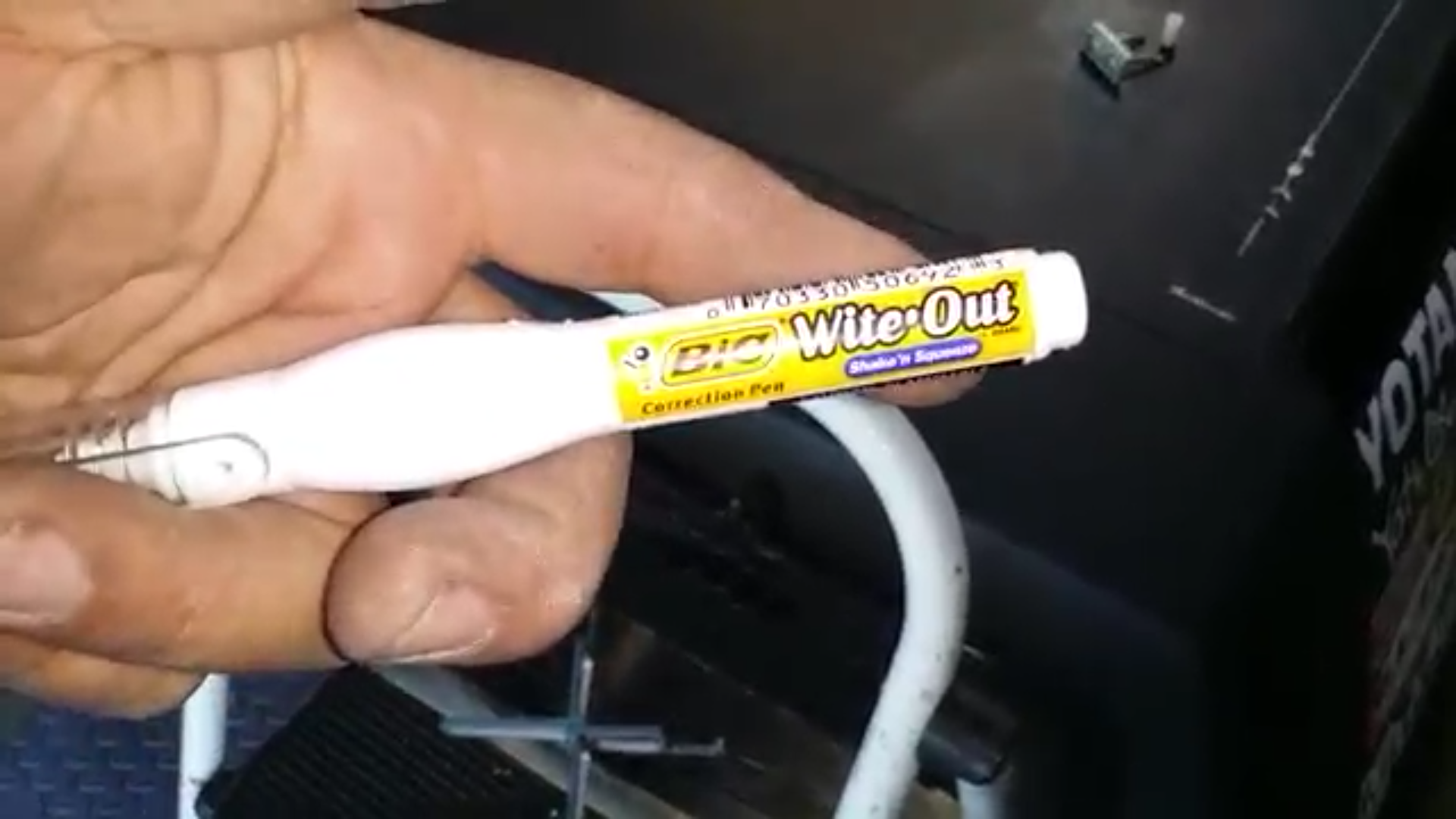

Hers what I use to mark the black top before drilling....
Ready to seal it up!...
Sorry it's long, but meh! Lol...

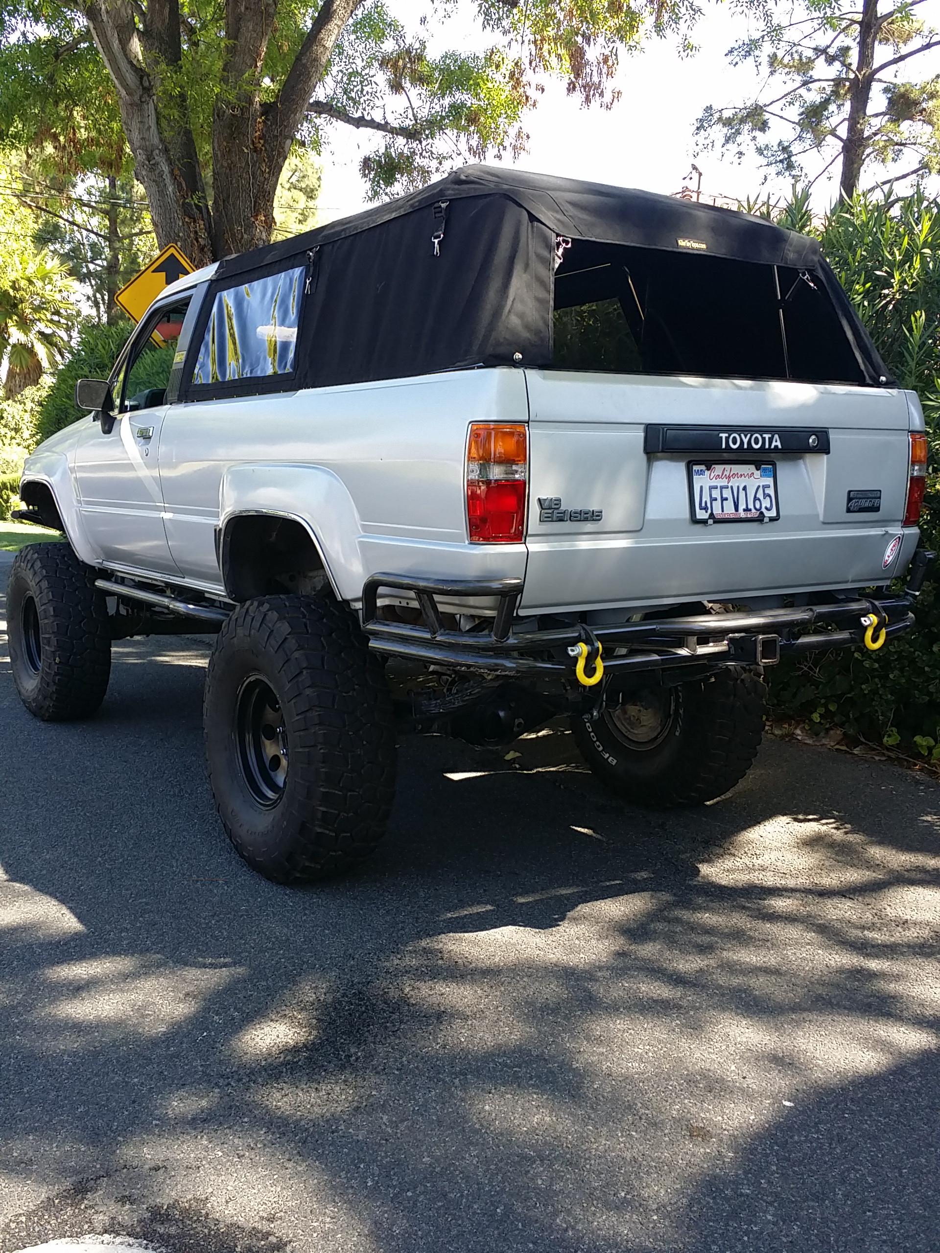

Got a bit more done on the "Zombie Apocalypse Roof Rack and Lights" Project...
Came other SUPER clean and I couldn't be happier! Can't wait to get my lights back up and working. Been missing having the rack as well.
