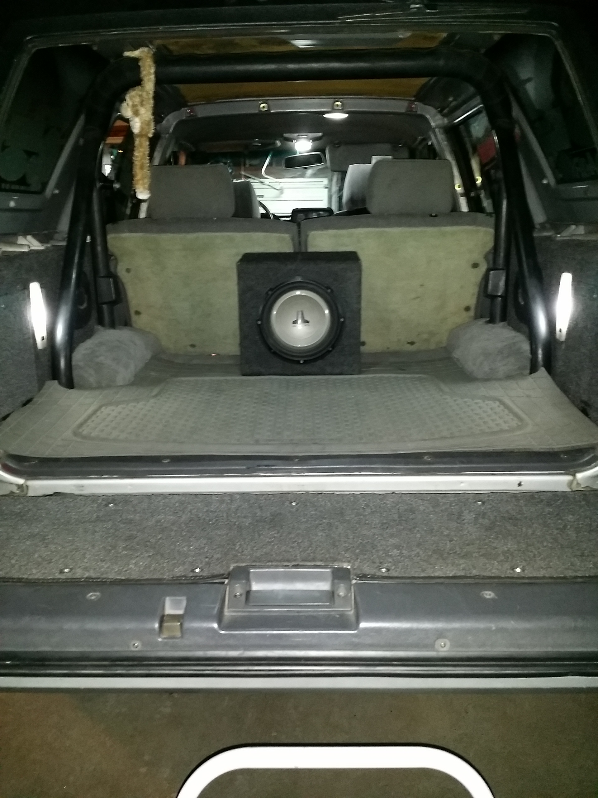

Lots of updating to do, later, when I have time. .....
.... Did a couple new things... But, mainly, it's ready to wheel!

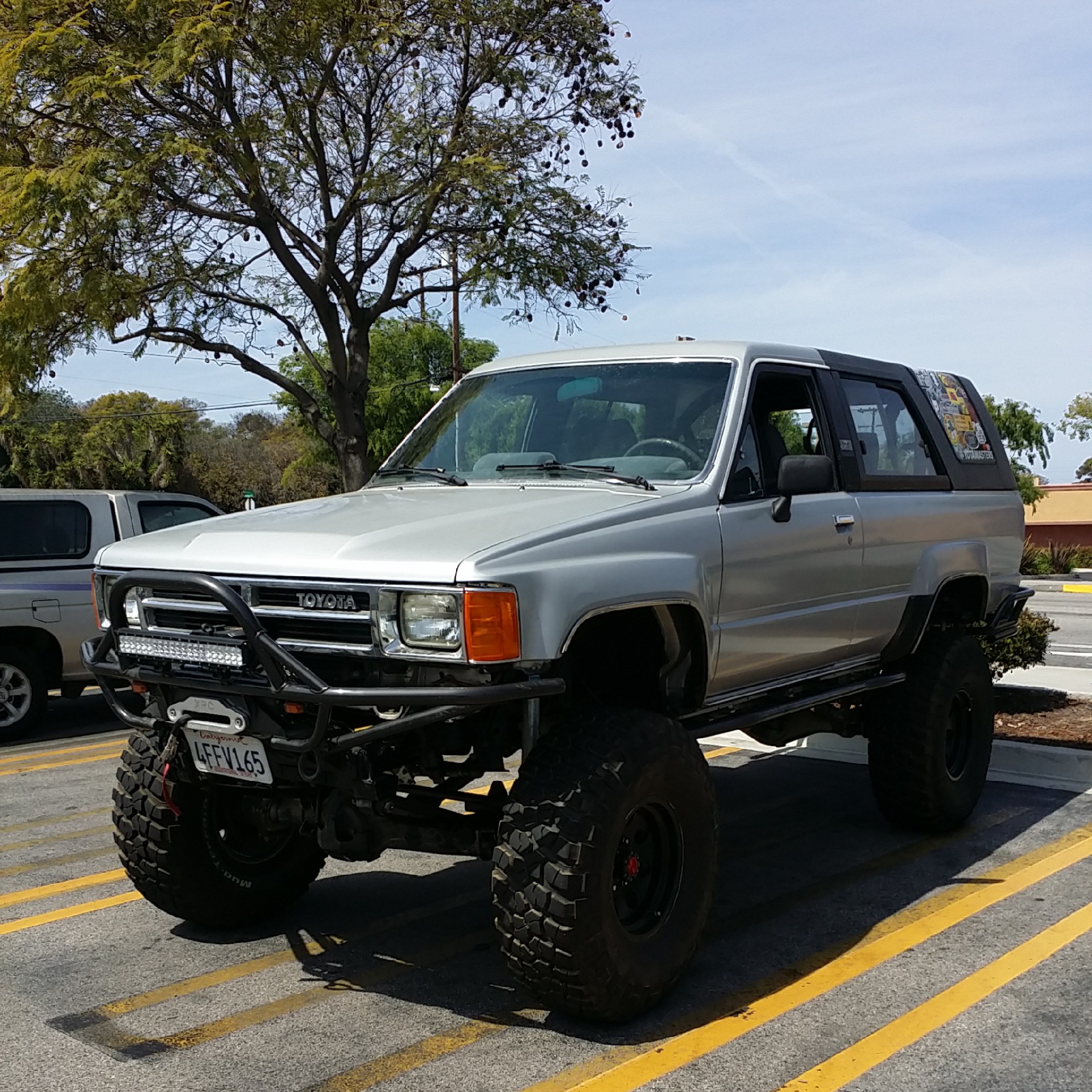

Out and about.....

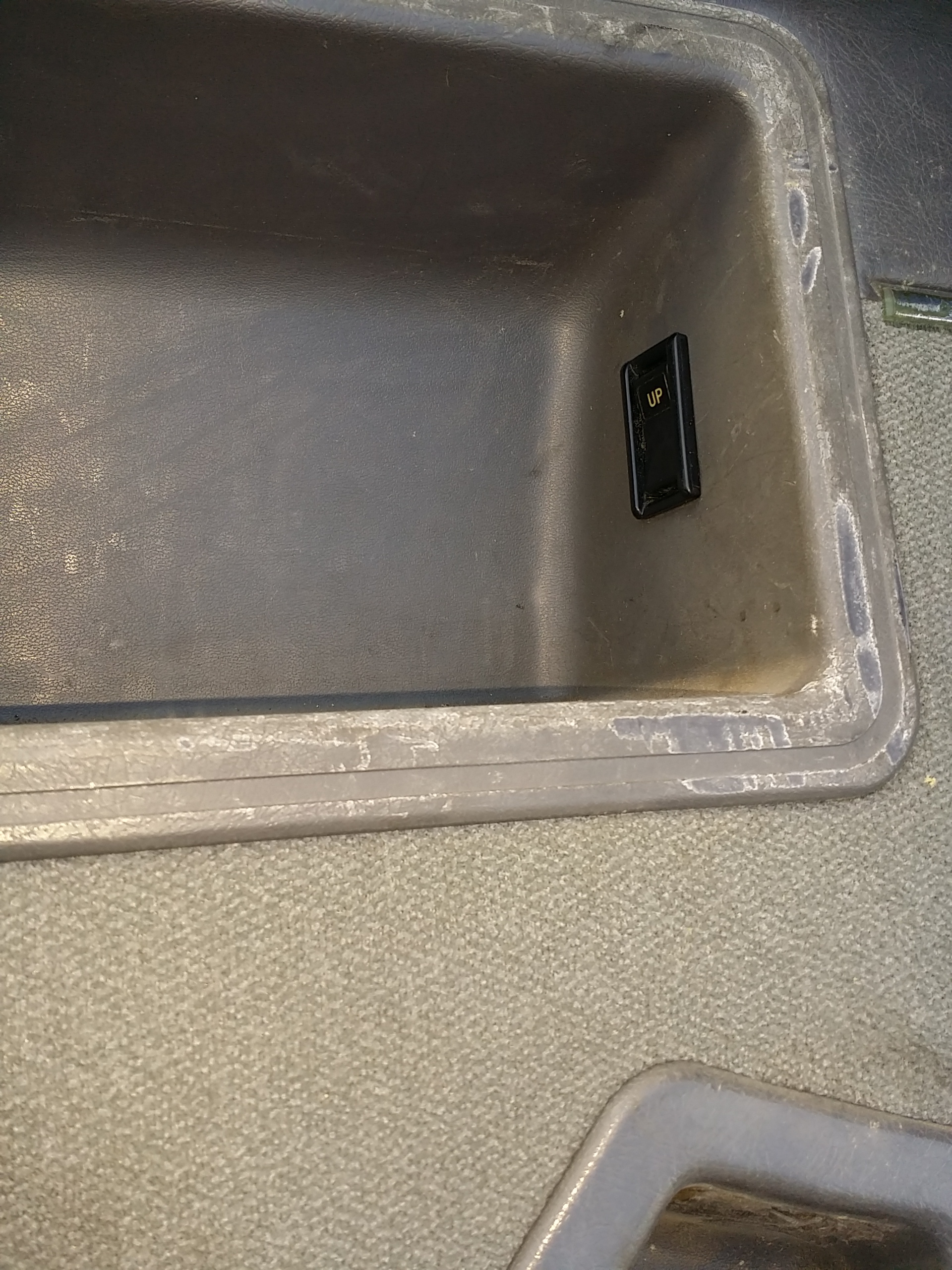

Why aren't myself A, "DARN, I GOTTA GO!"- at 3am-MOD Switch for the back window ....lol. ...

CB run... Just need to weld on a bracket to mount my fire stick to the bumper this time. I like it in the tailgate area but the problem is it is not staying secure and once the back out and not to mention I have to put holes in this perfect chassis in the rear. I'm going to do what Jonnyboy did...
Installed the rear seats...
Swapped over my weatherstripping for the back window glass, from the red tail gate......
Widow almost got me! I'm not sure if it could fight through 9 mil rubber gloves... But it still freaks me out as I am fairly allergic to spiders, anyhow!
Pulled the Topper, solo, so I can put in new headliner and redo my roof rack...
Little cruise last night to pick up food , and I forgot how much I enjoyed rolling without the topper!.... Look at that monkey holding on for dear life! Lol.
That's it, for now. I will try to give you a more detailed video of how I do this topper to prepare for the side rails.

Hahaha, it will come in handy! Just put it in, first time. Looking forward to not having to reach over....Hated that!

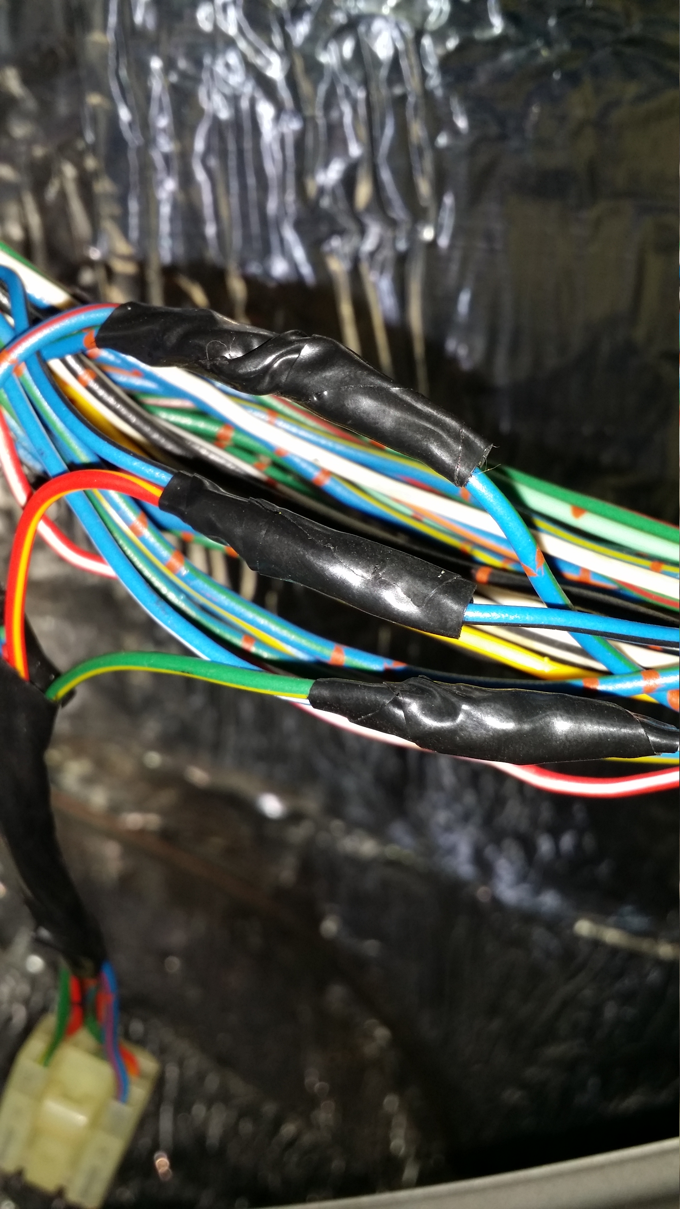

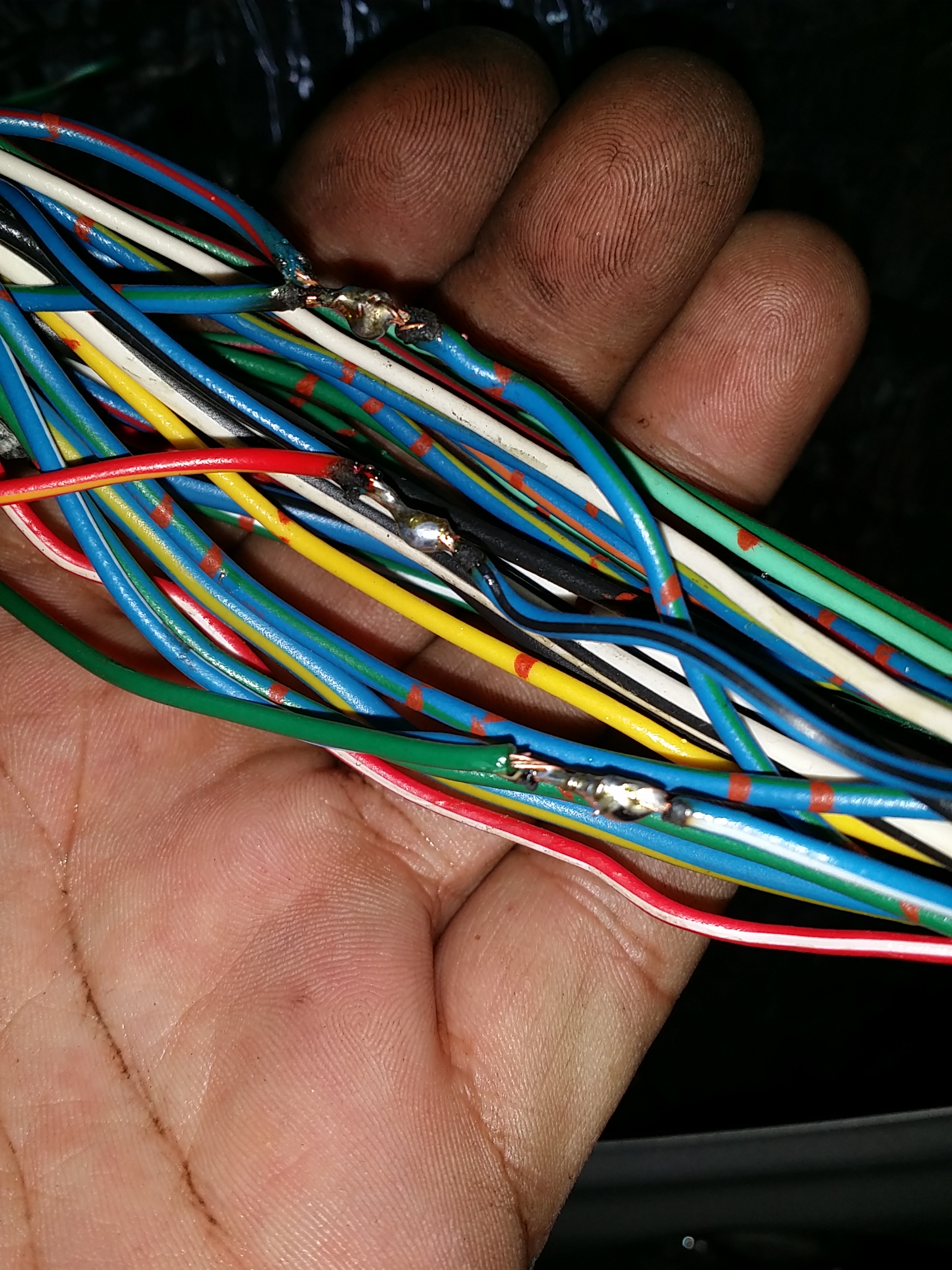

Enjoy the rear switch mod! Thanks to RAD4RUNNER and Bryan89... The did the R&D, I just changed the location a little bit.. The right up the Ray did was just great! Same with Brian... After reading it I fully understood how all of that works and how it was routed. I don't discourage anyone from doing something like 12voltguy.com has available.... Getting rid of all that crap is always an option. I should say bypassing it, because removing it is something I would not do... I think in case I had too many problems right direction, I might like to have it there. However, it's also an option to remove. However, the tail lights and such for the driver side also run down that harness.... So you'd have to pull it all apart, completely, all the way down. Wouldn't be that big of a deal.

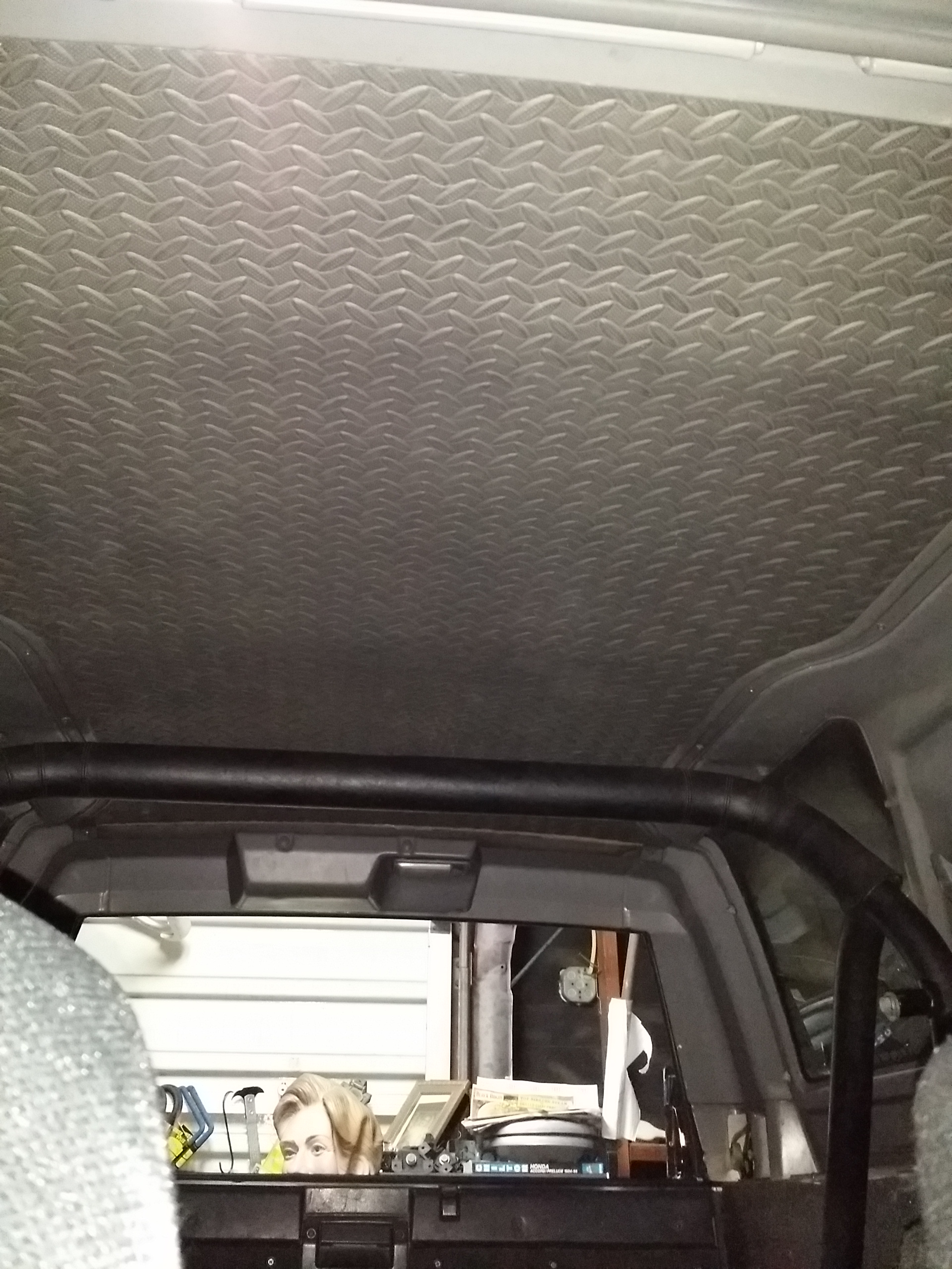

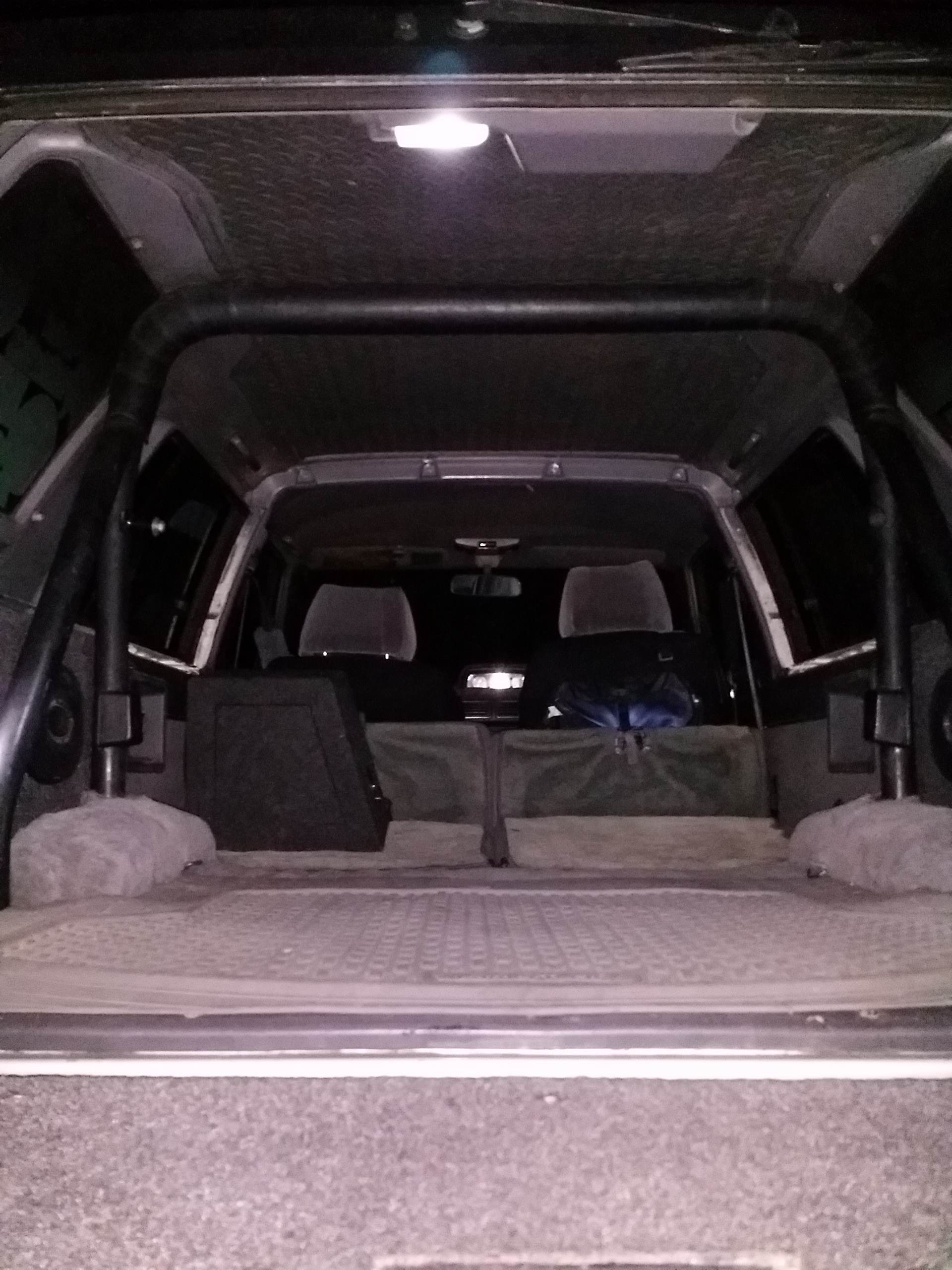

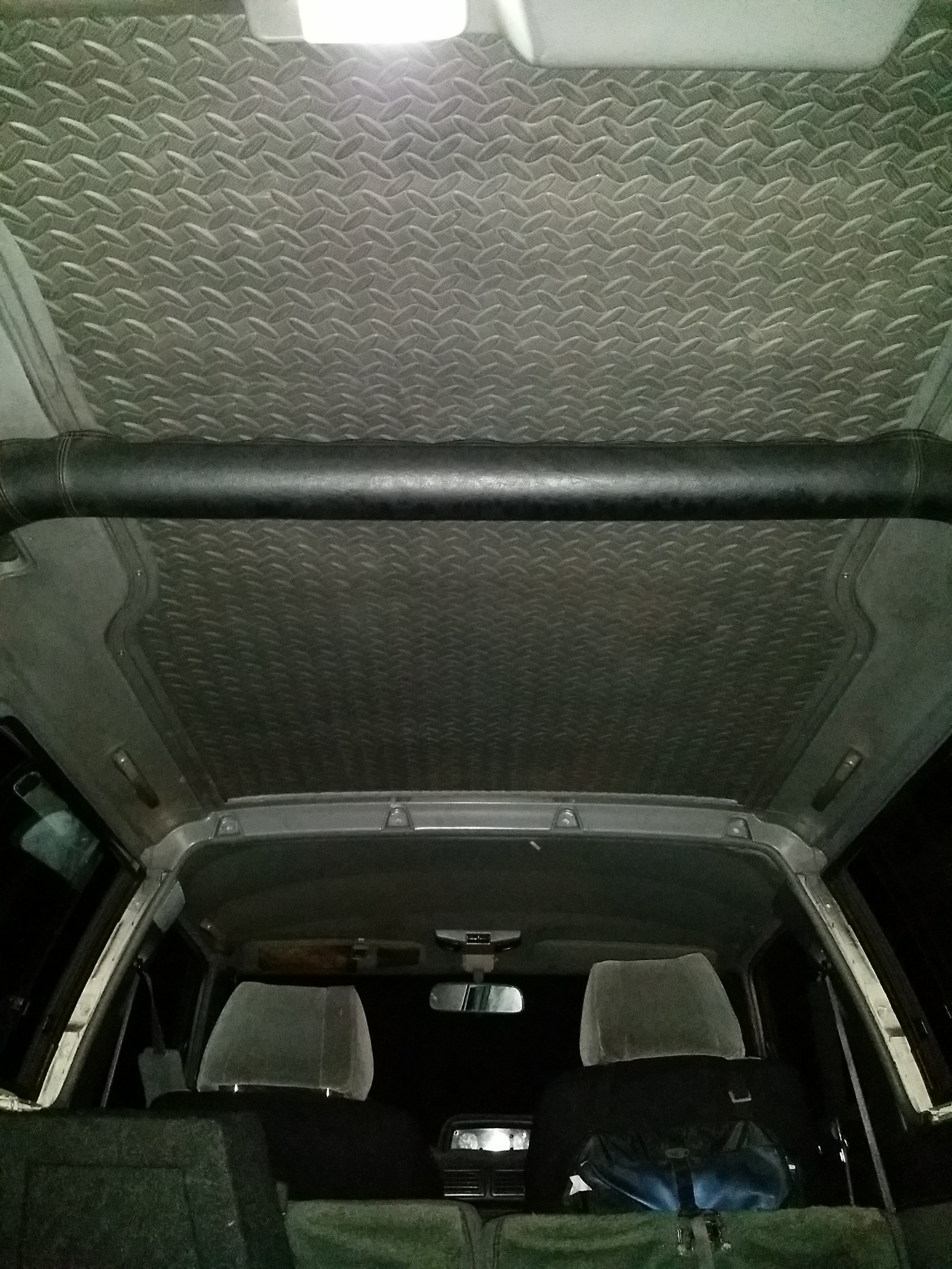

New Headliner....

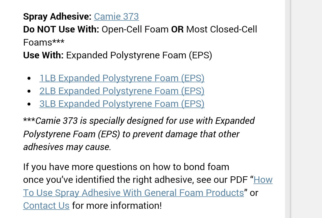

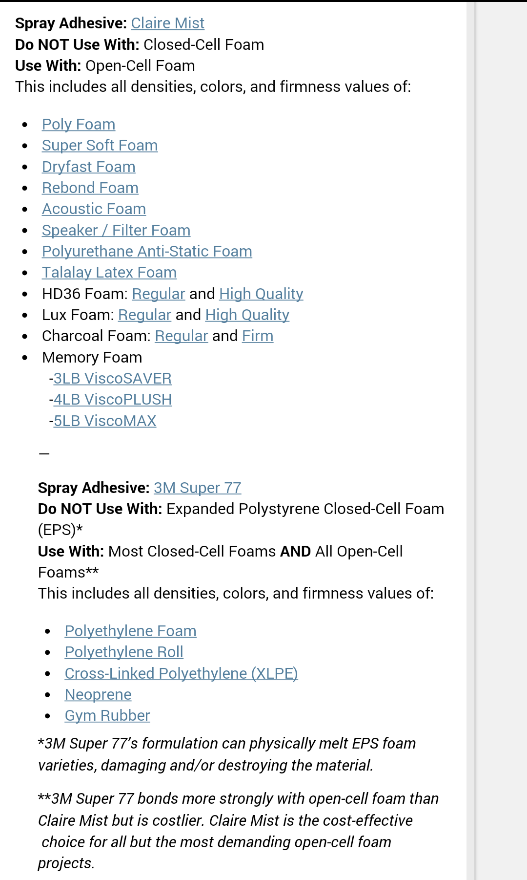

I could be having a problem with that. I was told to use contact cement with the E.V.A.-Closed cell foam.... A lot of very complicated Chemical composition and compatibility issues arise when you're dealing with different types of foam...
http://www.thefoamfactory.com/blog/i...r-bonding-foam
I will pull it out in the Sun and see if it does the same thing as yesterday. Basically what happened was I think it wasn't fully cured yet and he Incredible heat we had yesterday bake the roof and created gas is between shell and the foam. It caused a couple of bubbles to appear. I pulled out of the Sun and they went away. I quickly put pressure using rolls that pushed from the floor back up to the roof, and then, I put it back in the garage. I will try again today. Because it seems to hold everywhere else, I'm hoping that I don't have to pull it off again. But, I am determined to use this as a headliner and I think it's very cool. It should insulate fairly well and make for a little bit less vibration.

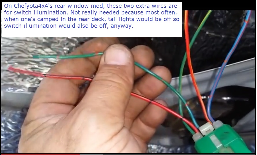

Yeah, guys, rear window control from the rear deck, makes great sense, so that was one of my first mods.
The two extra wires from the connector are simply for switch illumination...
My write-up's here.
