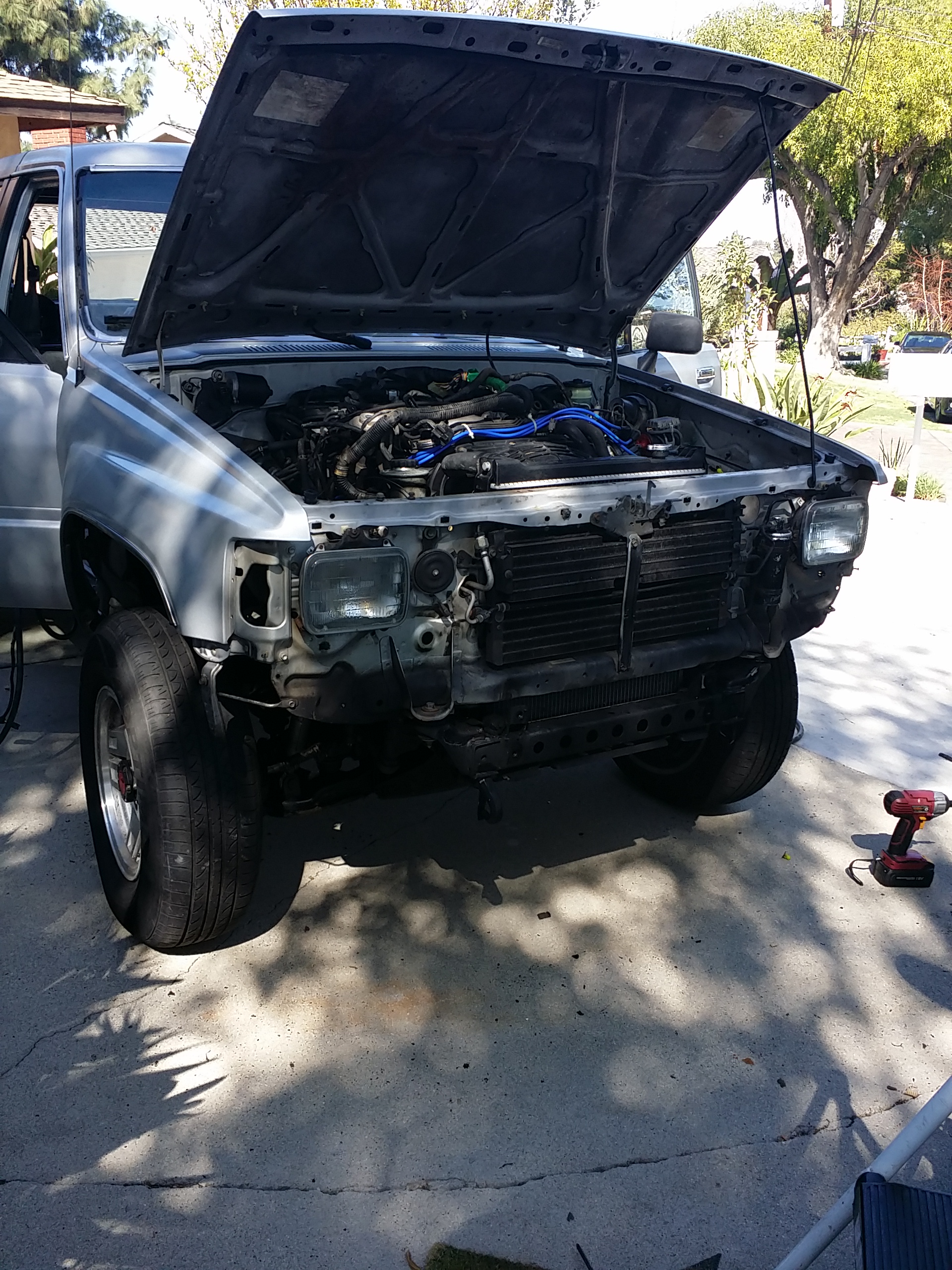

Today was huge and I went from 8am(6 am starting to plan)... till 10:45pm... Pretty sure I am pretty much ready to pull the silver one....
Jonny came down and we got a good chunk done on old Ruby...

I consider it a 40 hour job when all is said and done. Stripping Silverback down will take the longest and lifting the bodies off will to. After that, it will start to move fast for you as you will know what steps need done and how to go about it.
We are going to make a body man out of you yet, after fixing your daughters front end and your roll over. Did not like to see Ruby get rolled, but after this, you can truly say you Built, Not Bought your rig. You will have had your hands on every piece of this new rig.
Good call on the fuel pump bracket, those are hard to find and something most don't think to keep when parting a truck. I know when I was in California, they removed the fuel tanks before putting a truck in the yard. If you have a place to store it until it sells, store it upside down. I have wound up selling every fuel tank that I have come across. I had to sit on them for a few days.
I have a Dr. appointment but should be around the house around 11 pm your time if any thing comes up. You are making progress and it will start to get easier soon.

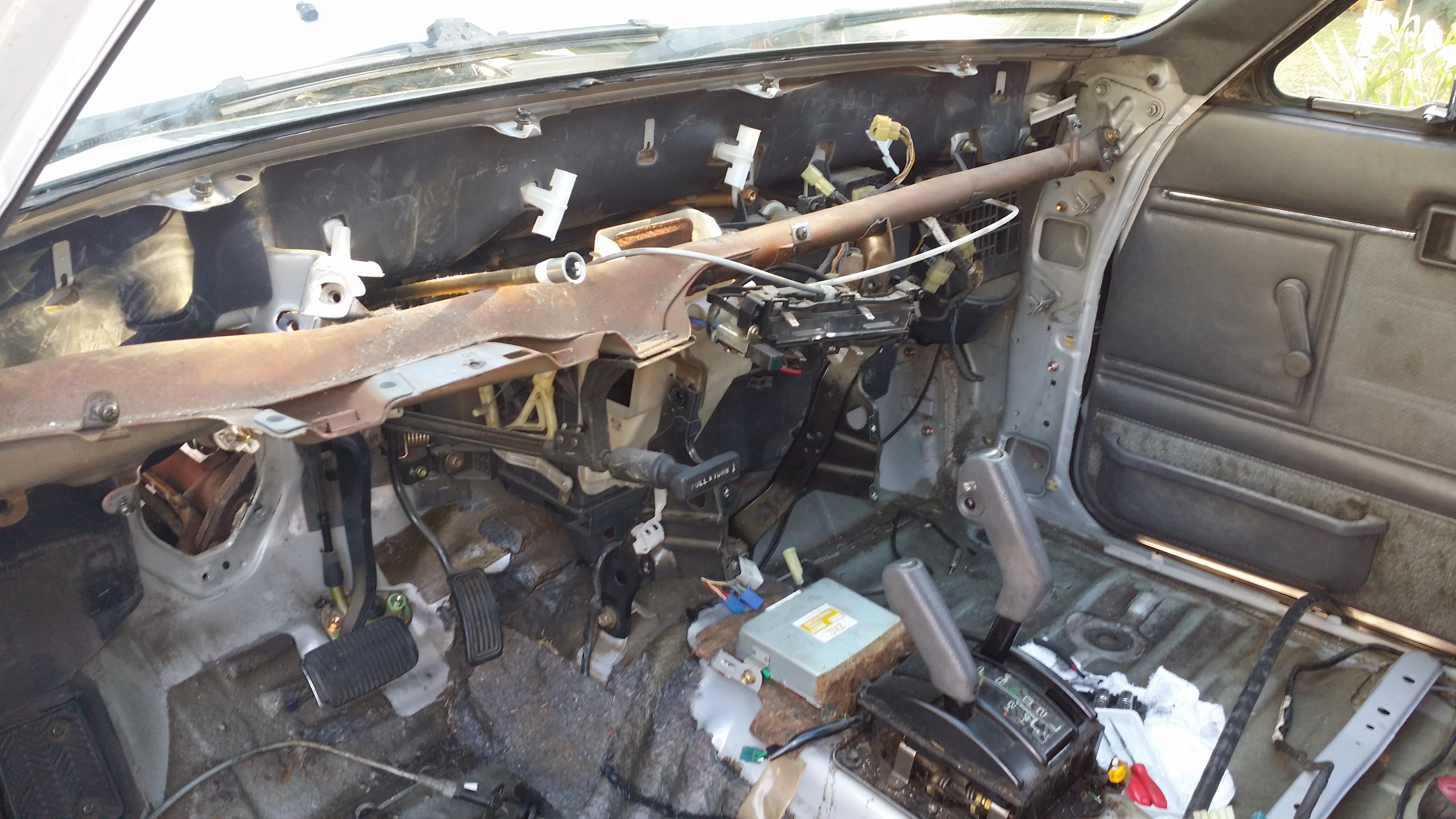

Thanks again for the kind words, everyone. Very pleased with the progress so far and its speed. Unfortunately A rain storm coming that just started is not too great at all! Most of it had been done by myself so far, but I have been very grateful to get the help of Jonny & Albert, and not forgetting to mention Terry! THANK YOU, GUYS!
The last few days I've fully removed the 89's harness and pretty much everything else. Also pulled my 87 harness and now have fully installed it and I am in the process of finishing up the firewall for the clutch master cylinder... And also the removal and installation of the pedal assembly mounting bracket from my 87 over to the 89. The 87 manual transmission pedal assembly bracket is ALMOST exactly the same except for one thing... There is no where to mount the button for the clutch start cancel that is closest to the floor... They are absolutely not the same in that manner. Someone could weld a tab on there fairly easily but it is not the thickest metal... So just be careful.
I will get pictures tomorrow of something else, but I wanted to mention that I just noticed how when flipping, the triple shifters and transfer case took a ride over and hit the tunnel so hard that it ripped it, heading from front to back for about 2.5 inches! Ó.ò
I will also do a little video tomorrow explaining how I'm going to have a little bit of a challenge with this transmission tunnel. It is actually higher nearest the floorboard and firewall Union, but that is really irrelevant and doesn't help me at all... I will have to cut liberally and then find a way very securely mount the shifter boots, especially if I ever want to get my Bezel back in the way that I had it.... I want to fully install the harness and such, and then I will install all of my aftermarket mods. I still have a little bit of work to do in the engine bay of the 87, including pulling the odd In N Out steering hardline that comes out of the core support and does a horseshoe around 10 inches towards the passenger side and then heads back through the core support. Grrr. It's actually fairly simple to deal with, and the cutout is also on the 89. So apparently, they were still doing that for the 89- 22 re.

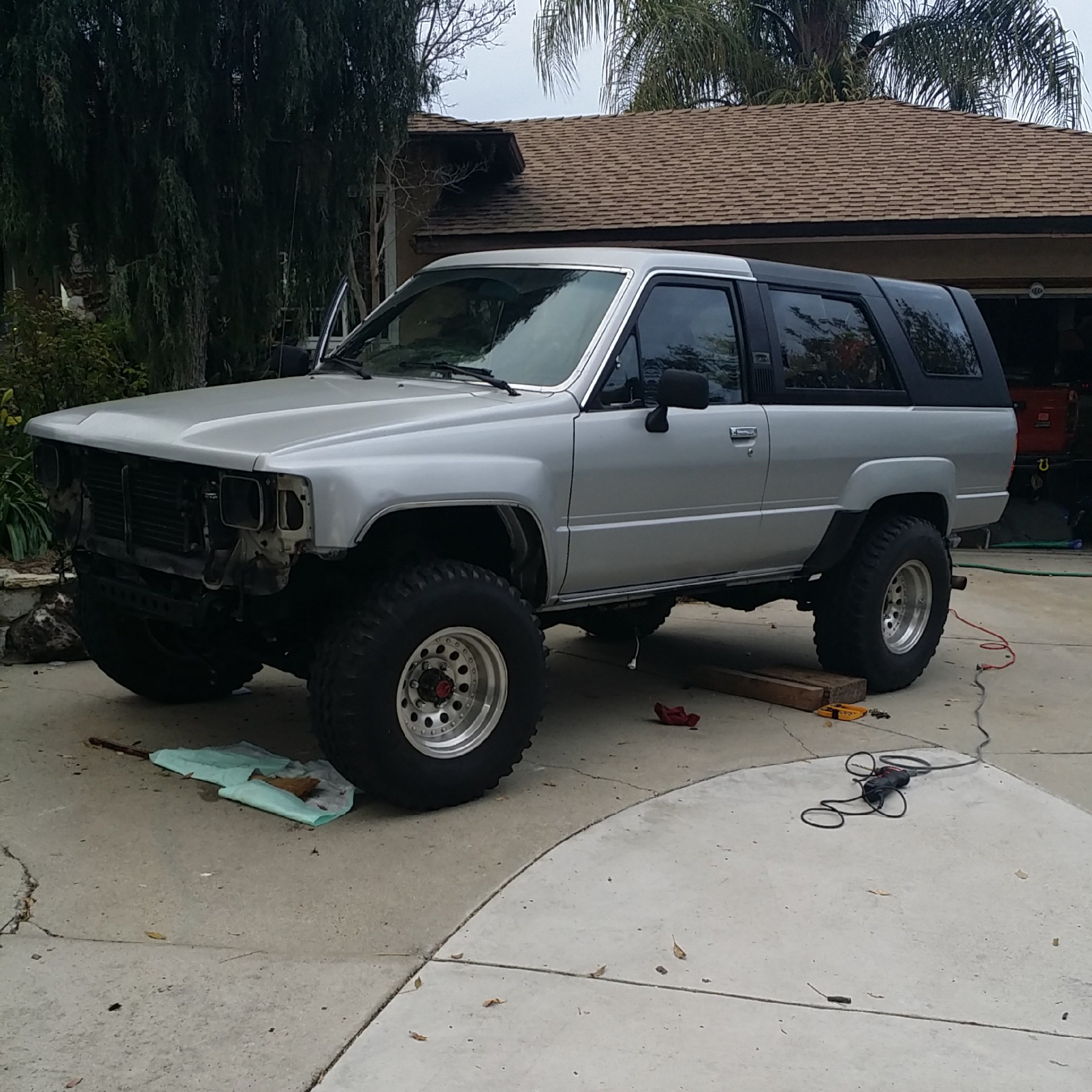

Another day lite look it's the Silverback, for the sake of you're out city... I really like these wheels on that paint. I'm sure the black will actually look good with silver... And I will leave those for now, but I'm just curious what you all think...

I am biased to the chrome wheels, just not a big fan of the black out trim. Normally when I see a runner with the top black and the body color is some other color then black, I think of a pickup with a camper shell. I actually like the black top and chrome wheels on Silverback.
Half will like chrome or black and the other half wont. That is where you just go with your insticts. That is where I wish I could use paint or some other program for a better idea.

What wheels are those? They look really good!

Hi Mark, Just thought I would add my two cents worth to the discussion about what to do aesthetically to Suzy-Q; Do what you like! In past threads you said you really like the Outlaw II wheels, go with them and keep the black wheels or SR5 wheels for spare/different tire combination or sell them. If you like all the time and effort put into Ruby's Tailgate, use it (you could have it sprayed Silver while you work on the body swap details, shouldn't be very expensive). Basically do the things you want the way you want them. As with all things in life some people will love it and some won't. At the end of the day you are the one that needs to be satisfied with what you have built. Don't worry what others think about the cosmetics as you have a good eye for things and are very adept at making things look great. Suzy-Q will look awesome when you are done if you just go with your heart and what's in your head!
