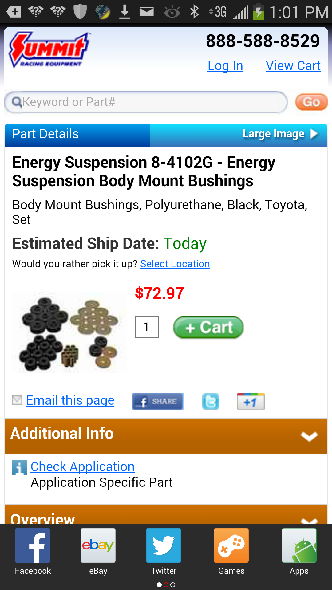

Body Mounts.....?????? Not sure whether I should do polyurethane or rubber....But poly is definitely able to grab at local stores.

If you go with poly make sure you lube them with some anti seize or that liquid wrench white lithium grease.

Not sure about radiator or which bushings is best. I will be getting bushings at a later time myself. Complete kits are not to bad in price.

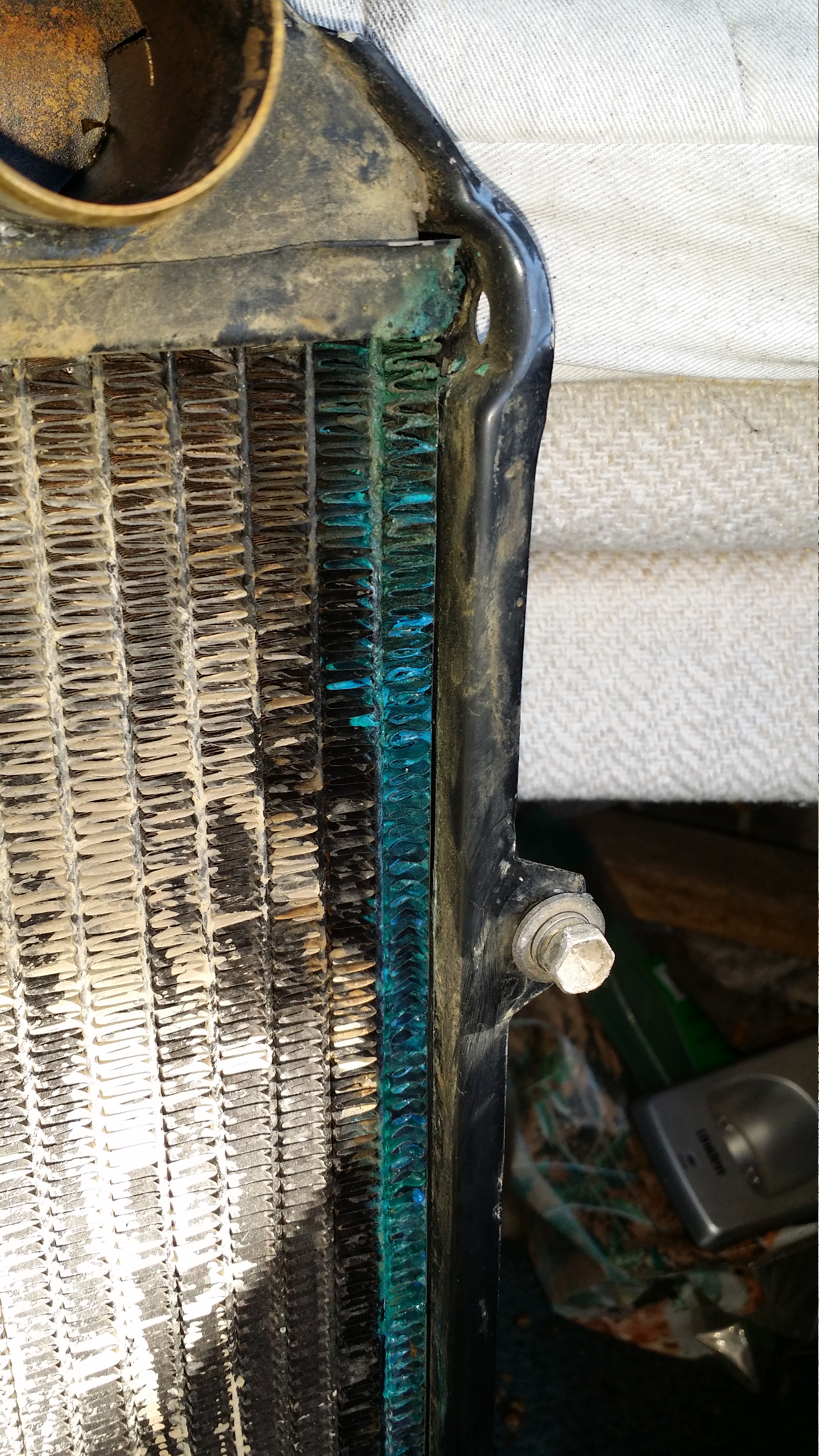

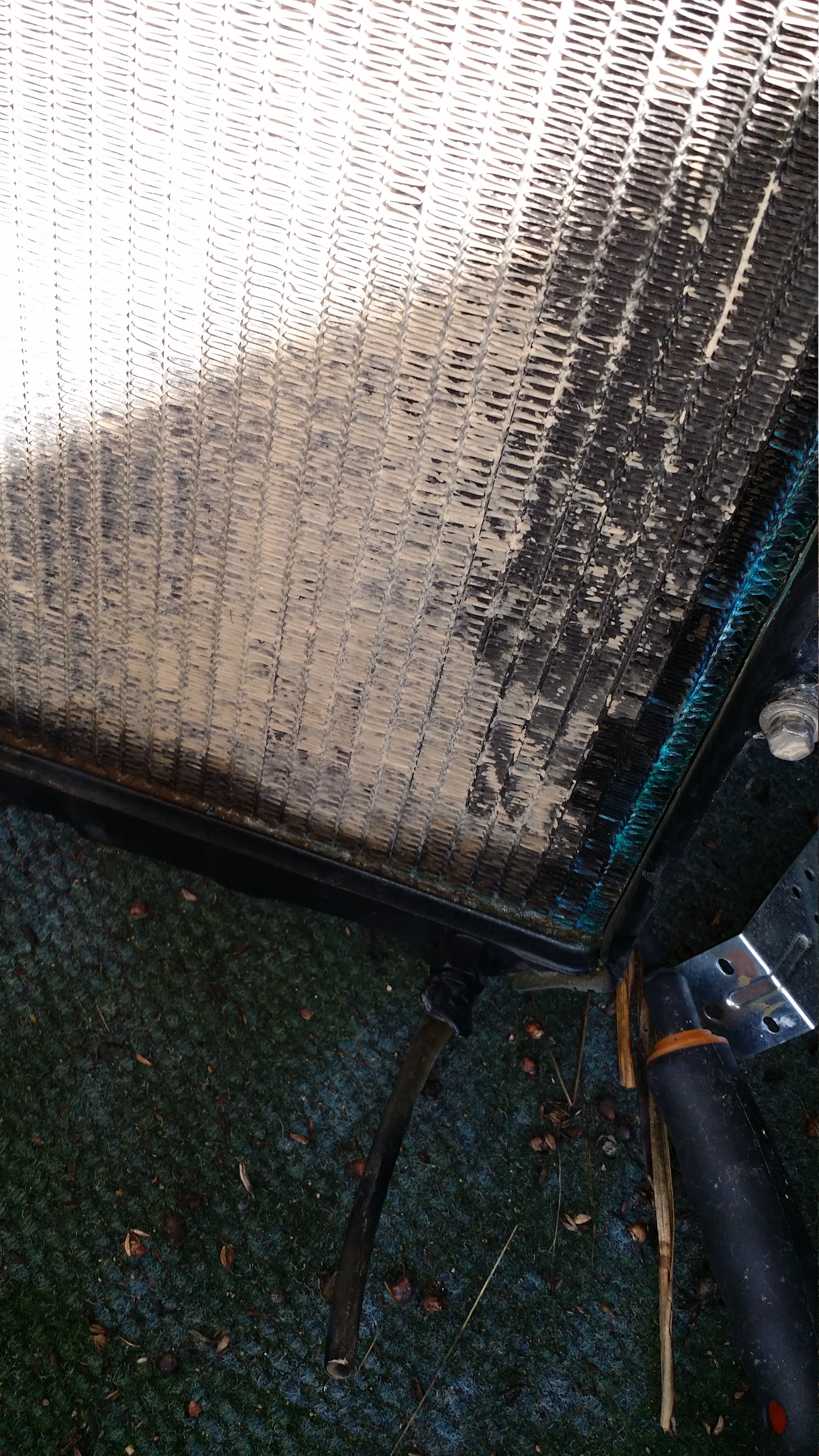

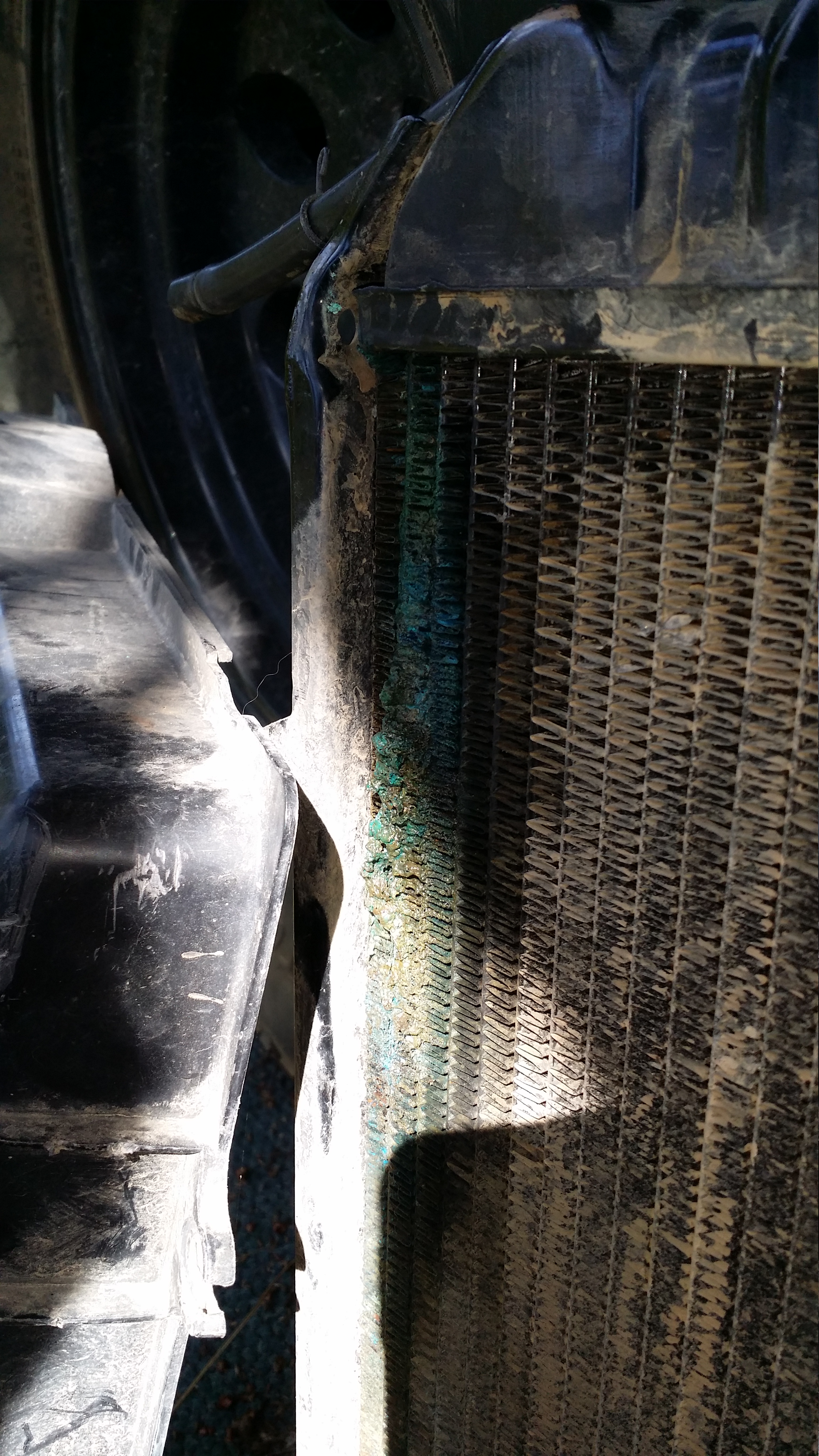

Here is why I am questioning if something happened to the radiator. I can't imagine this is caused bye radiator fluid from the reservoir or any other fluid... It seems to be coming from the cap and running down the rods and side... I want upon my driver side, which is where the overflow is. So I don't think it would make sense that that was the culprit.....

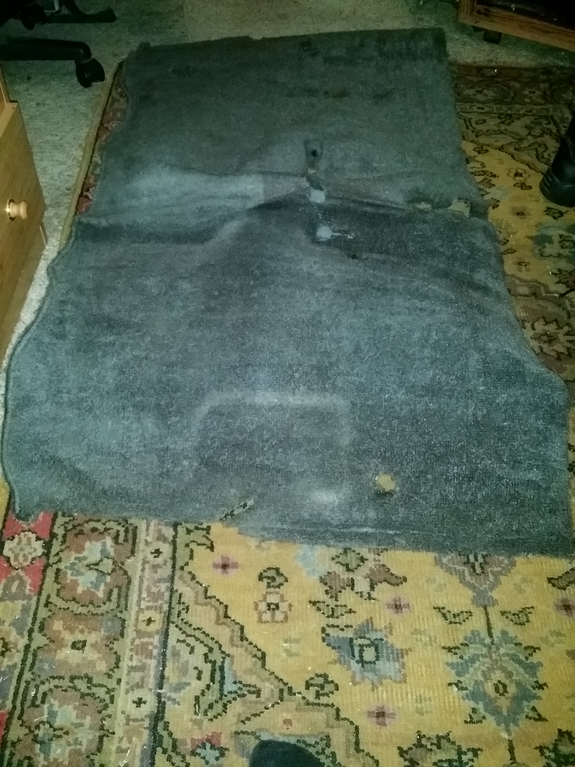

I might have already posted this but here is the midsection of carpet that I fully and thoroughly cleaned. I'm honestly totally shocked and so glad how in this came out! If it was going to remain a garage queen as it was a few years ago, I would probably eventually get new carpet. But honestly, I didn't expect it to come out this clean... This factory carpet has lasted twenty seven years and is still in full integrity conditions!...

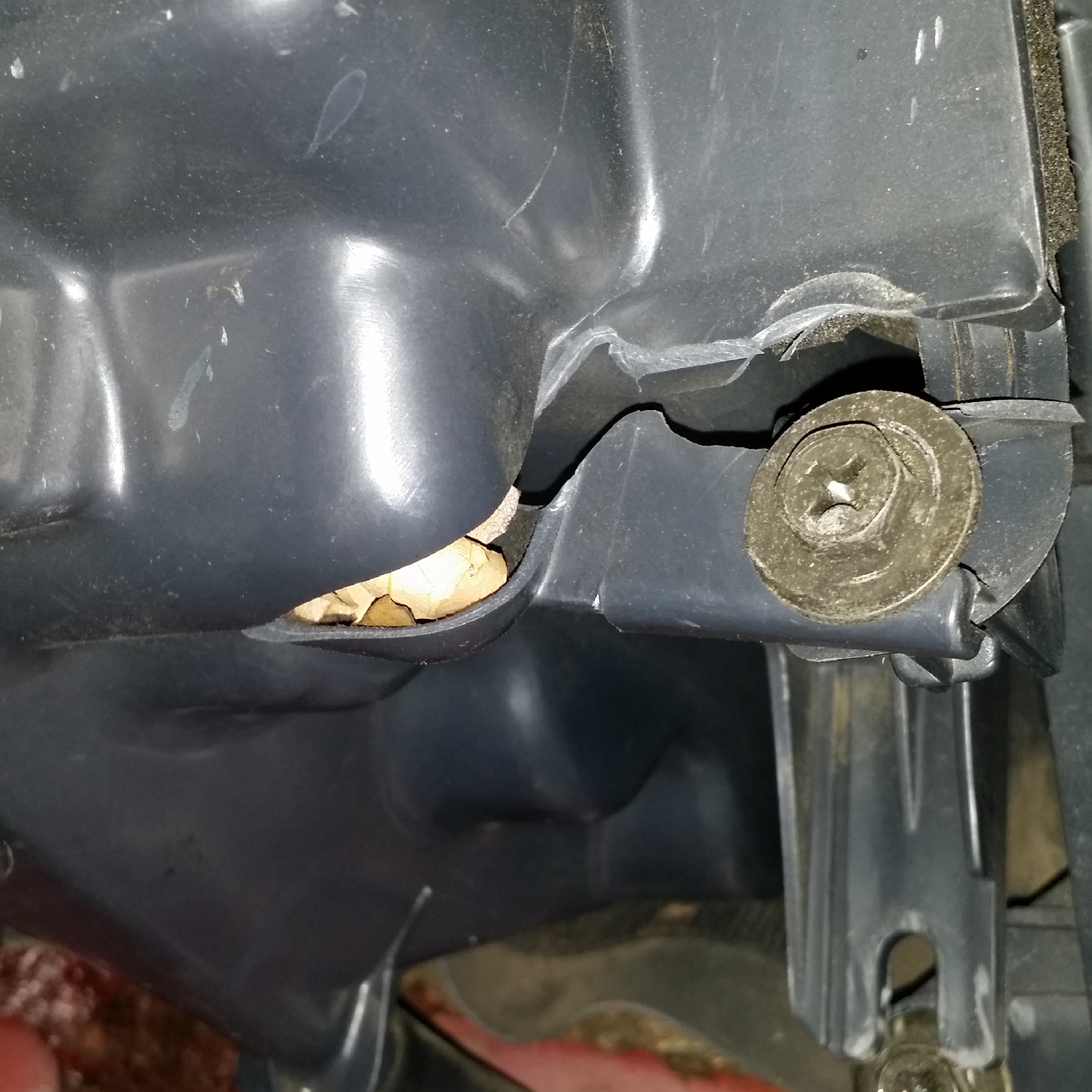

Here is another example of how things by chain reaction of damage most likely irreparable in the end. This is the evaporator box where it joins with the blower motor...

I had to junk out a radiator that did the exact same thing that you showed. Not sure what caused it to do that. I see I missed your call. I will be around till Friday then have to go to St. Louis if you want to call. I will be checking in on Saturday to see your progress.
