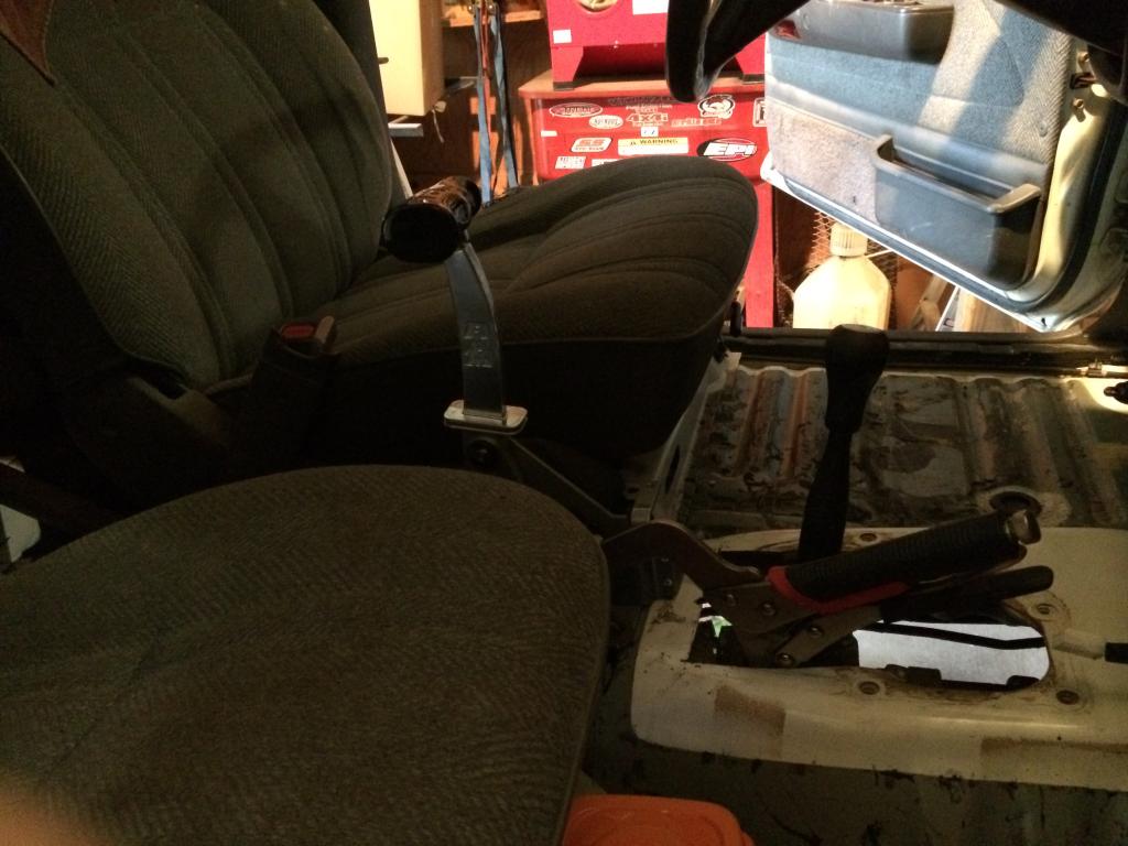

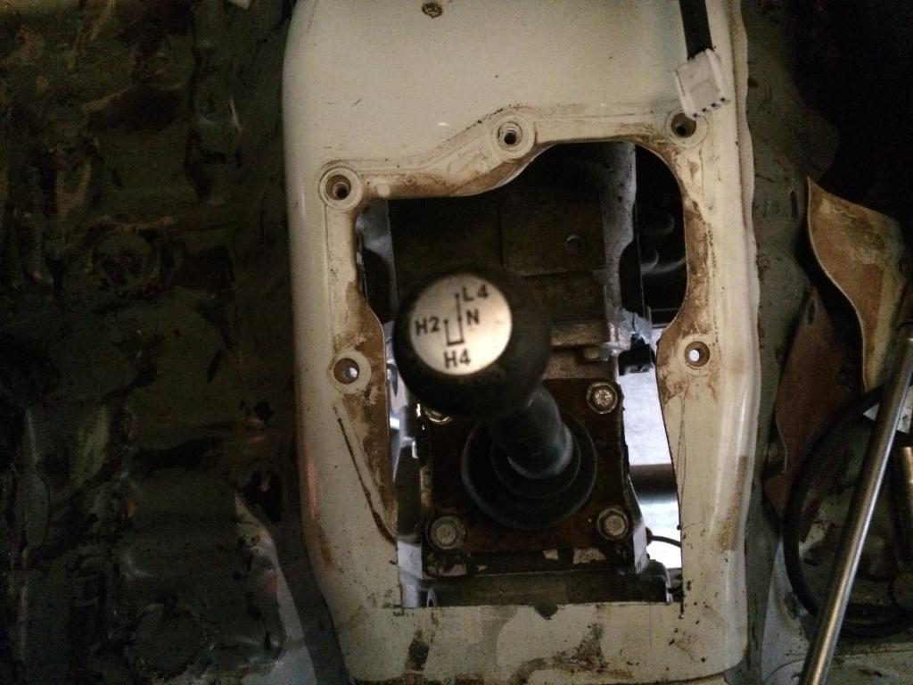

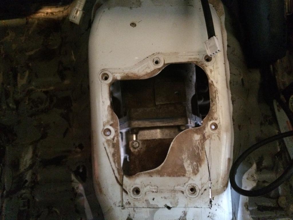

Didn't get a lot done but I did remove the rear heater and cut the tunnel for the tcase shifter to fit. I also found a problem. Doesn't look like I'll be able to fit the trans shifter in front of the tcase shifter. I may have to mount it behind it. I'll know more tomorrow when the shifter makes it in. Here are some pics for those that like pics
I have a pic of the shifter installed but it's not uploading to photobucket for some reason. I'll add it later.
I may have cut the hole a little too big but that's okay. I'm gonna make a cover for it.

Here is the pic of the tcase shifter installed that shoulda been posted earlier.

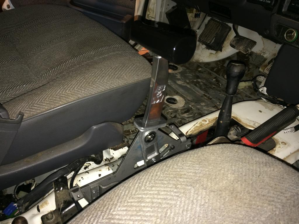

Well I got the shifter in it's sweet spot. Ended up mounting it behind the tcase shifter. Messes me up for duals but I'll worry about if I do it. I'll either swap to a top shift case (I think I can fit the shifter in front then) or I'll do forward triple sticks. Not sure that's been done but I don't see why it can't. I actually like the position of the trans shifter. It's comfortable. If I move it any more forward it starts to become a uncomfortable.
I started looking at the radiator mounting and realized I needed to have my steering box mounted. So I'm working on cutting the core support now to get it forward enough. I'm trying to keep the cuts clean looking so it's taking a little longer.
Here is a couple pics of the shifter

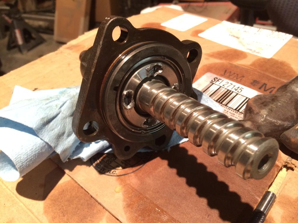

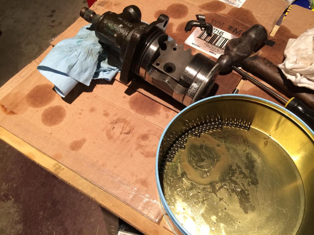

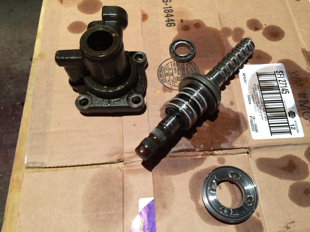

Well I finally got that nut off, change the input seal, and put that assembly back together. I even got all the balls back in, which was nowhere near as hard as ppl make it out to be. Still have to drill and tap the case and then put it back together. Planning on that Saturday morning.
Got it the input assembly apart and cleaned it up in the parts washer
Got the nut back on. Notice how butchered it is from the punch. I'll never do that again. I'll either buy the correct tool or have it done lol

This one is before I put the balls back in. I just worked them thru the holes where the little tube goes. Not too hard IMO. Let's see how long the box last tho lol

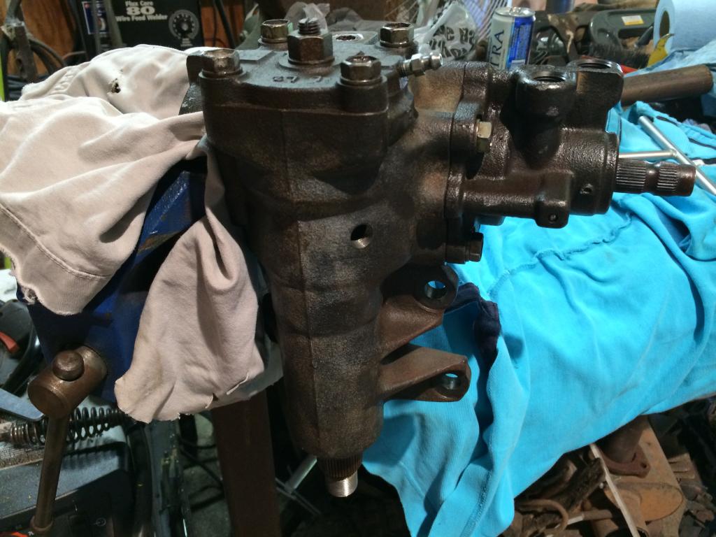

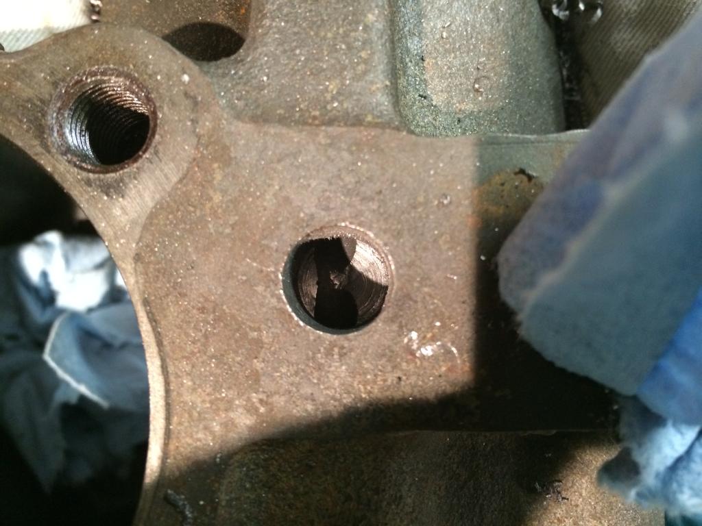

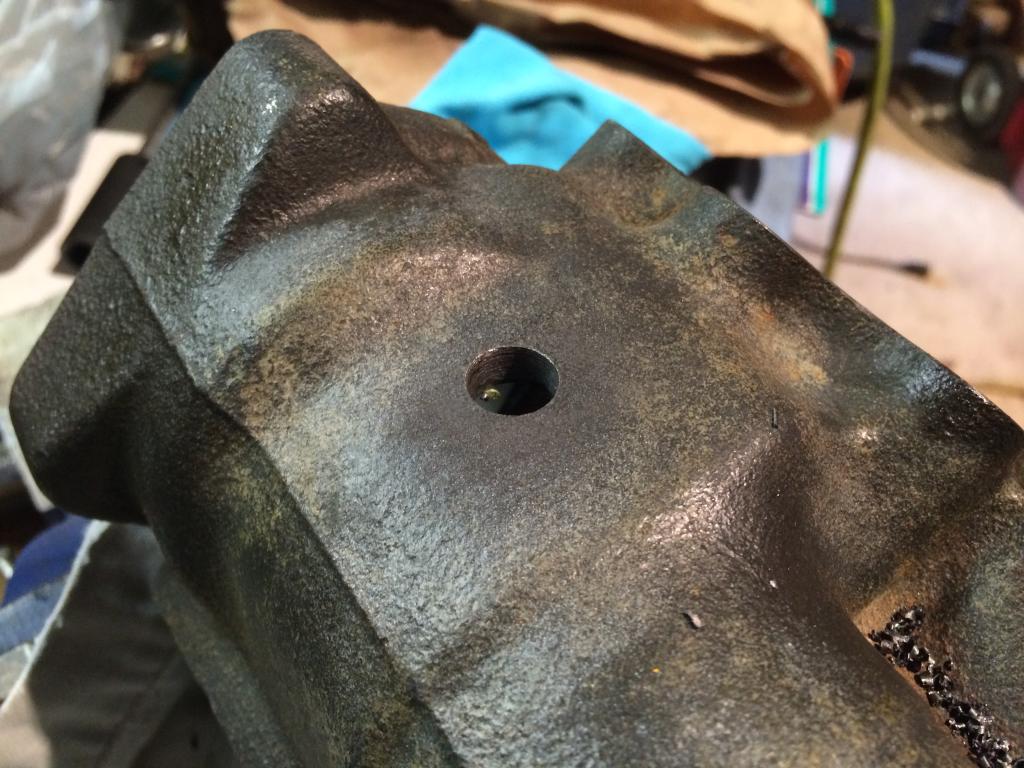

I got the steering box back together and the new pitman arm installed. Tomorrow I plan to build the mounting plates and finish cutting the radiator core support.
