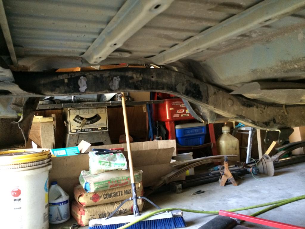

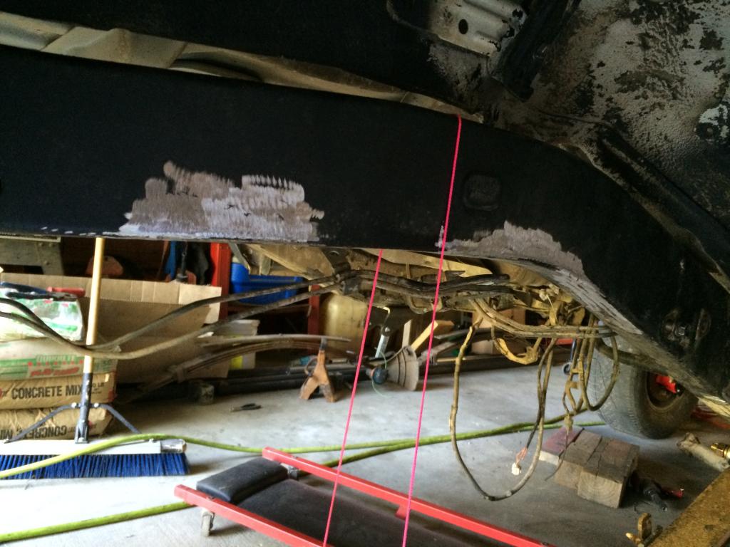

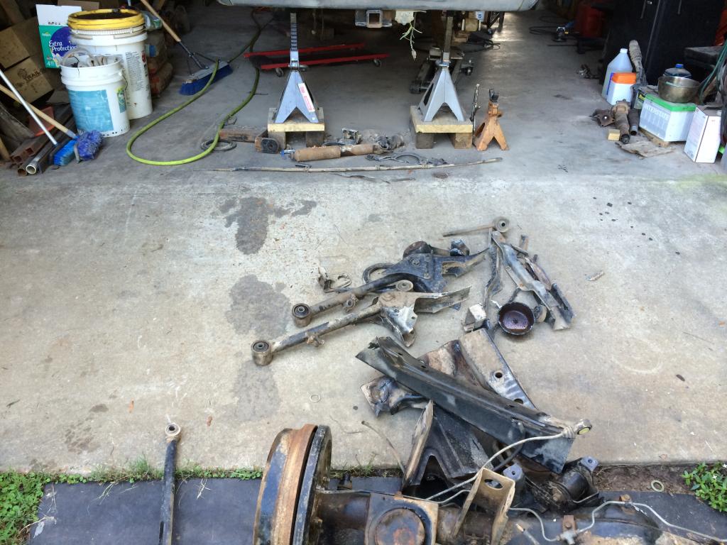

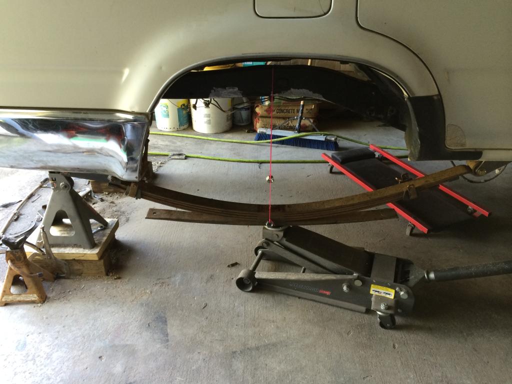

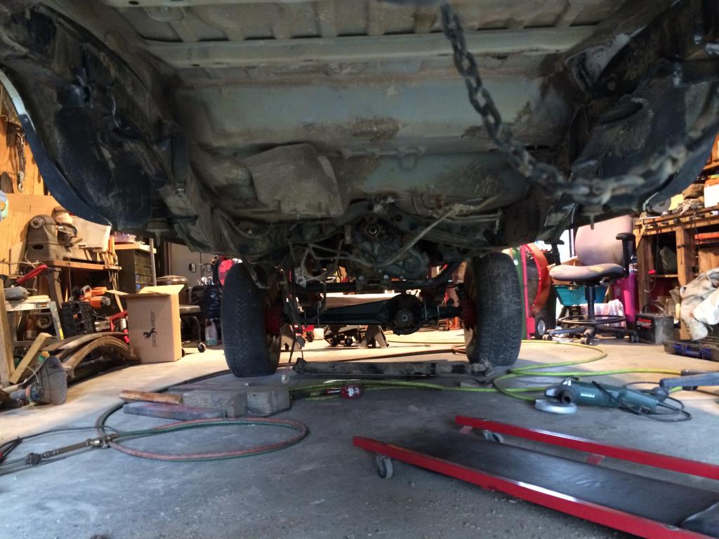

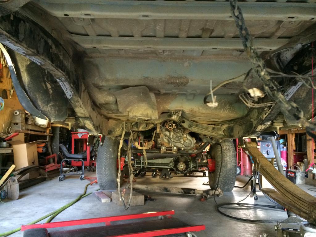

I made some progress on the rear suspension. I cut out all the brackets and and crossmembers. Ill have to make a new gas tank rear mount, but I figured it would look better that way then trying to cut part of the crossmember out. I tacked on the front spring hangers but I think they are too far back. As I went to line up my shackle hangers, I found that with the hanger at the end of the frame, I still had about a 20 degree slope on the 7" shackles I made. I plan to cut the tacks on the front hanger and move them forward some. Hopefully get that done this evening.
Here are some pics of the progress.
Brackets rough cut
Couple pics after all the grinding. I still need to run the flapper wheel over it and paint tho.

All the crap that I cut out
Springs mounted to the front hanger
It looks like I marked the center of my fender a little too far back too. Nothing that cant be fixed tho.

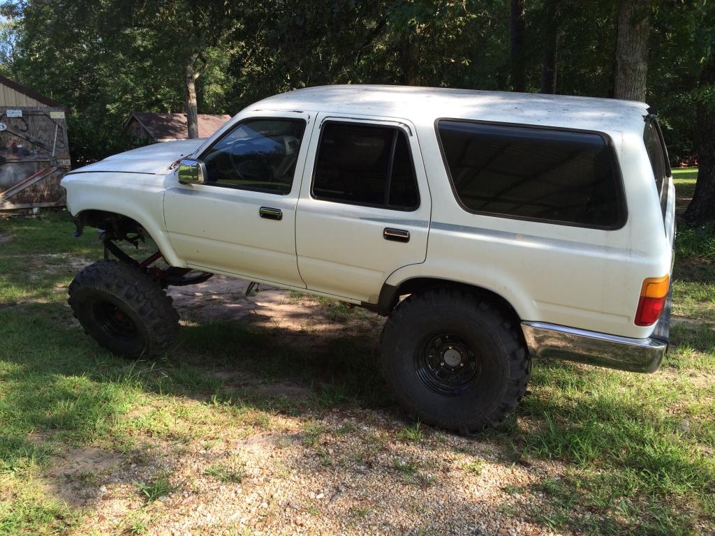

I'll let the pics do the talking here
It's finally on all 4s and on the 36s. The rear is a little low and a little too far back. I'm gonna order a AAL tomorrow. I'll move the spring hangers forward when I pull it apart to install the AAL. This has been a long time come. I'm excited.

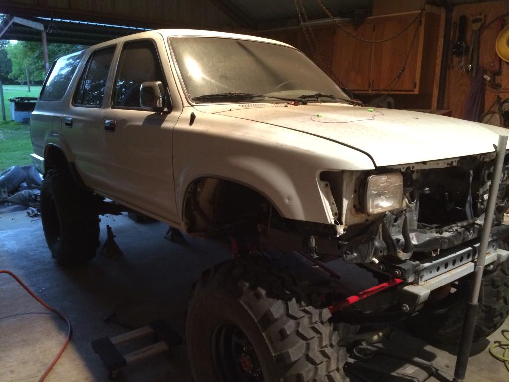

Well even after getting the rear end almost level with the front, my front shackle angle is still horrible. Now I have to decide if Im going to remove a leaf and/or push the spring hanger back some. Currently the spring hanger is mounted 3/4" forward.
Here's a pic of how it sits now
I think I may wait to do anything to it until I get the motor running and get most of the stuff back on the front. I figure I have about 250lbs to add to the front (winch and bumper included). I had a buddy about that size stand on the front with little movement.

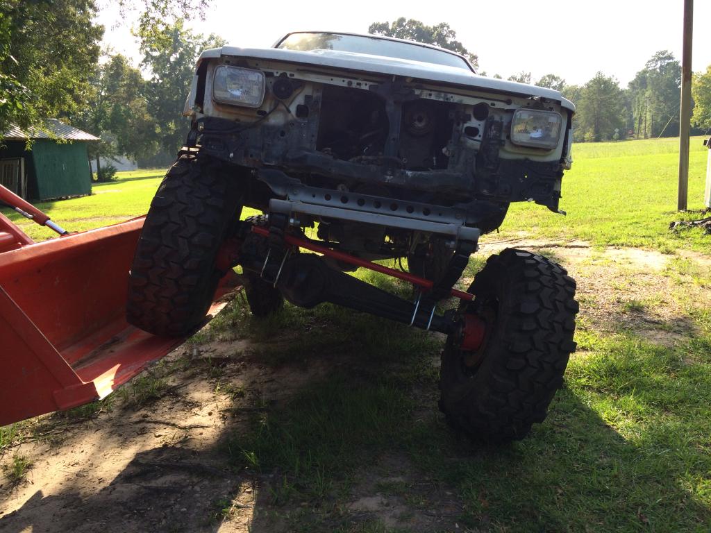

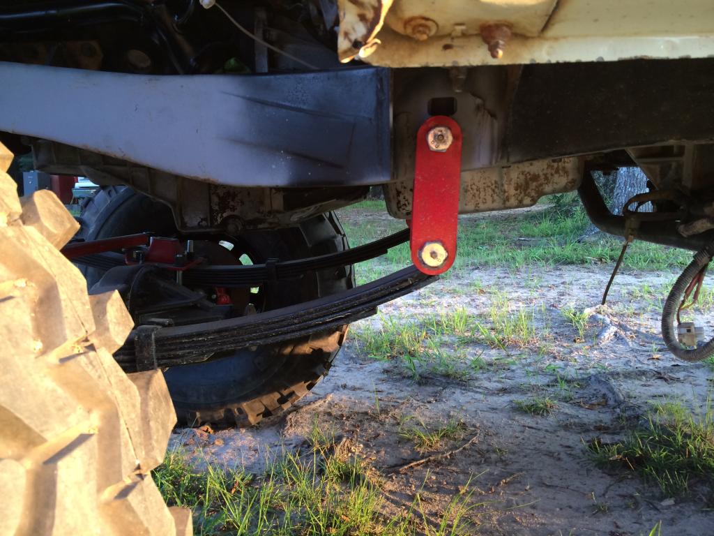

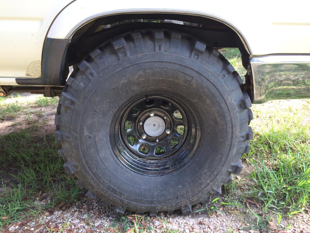

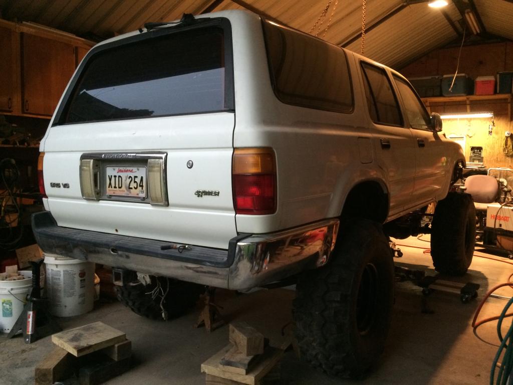

Well after doing some looking at my 4runner I noticed that it looked like I was gonna have a clearance issue between the drag link and crank pulley since my drivetrain is low. I've come to realize that a body lift is helpful when using an auto trans.
So I decided to pull out the tractor and do some test flexing.
I coulda picked it up more but we stopped there. Looks like I will have enough clearance. So we pushed it inside and set to work on the front shackle angle. I decided to move the front hanger back from 3/4" forward to 1/4" forward. That put my shackle angle completely verticle, which I think will work fine seeing as how i still have some weight to add to it. I didn't take any pictures but I will later.
