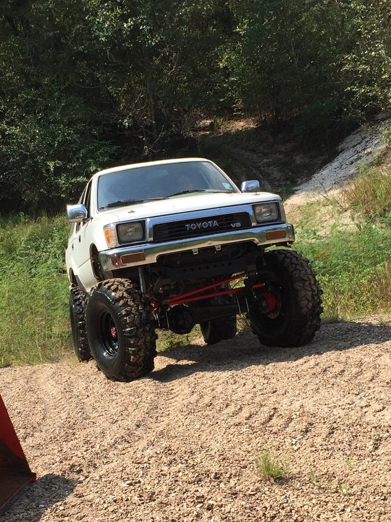

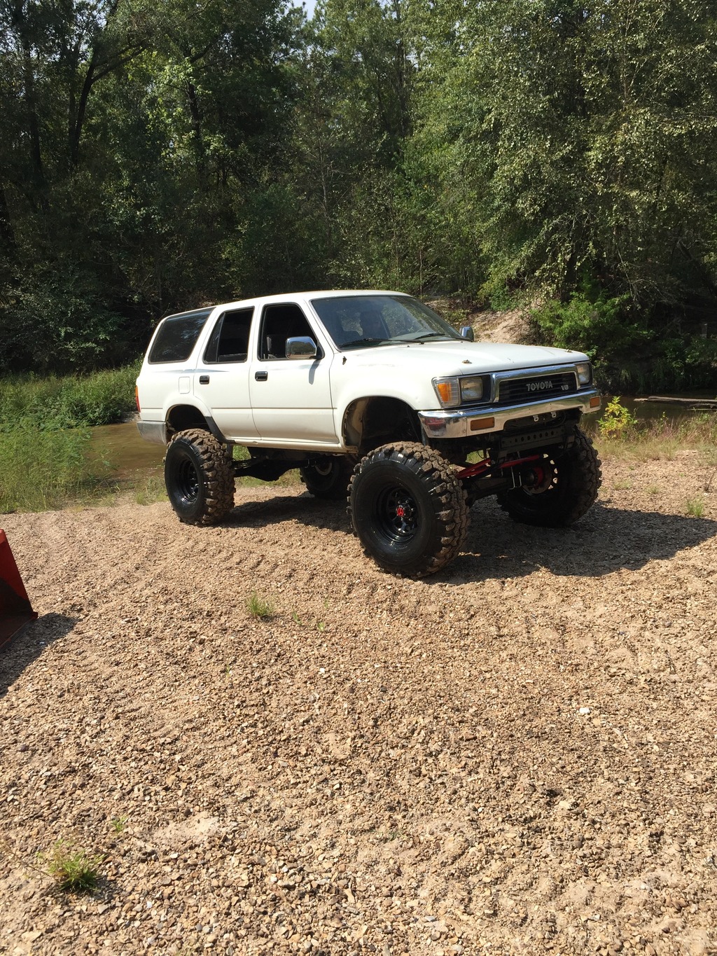

I got to do a little off-roading in the 4Runner Saturday.

  #324
wberry85's Avatar
Joined: Jun 2014
Posts: 229
Man that thing is sexy. What size/type of tires are those?
Old Sep 29, 2015 | 04:38 AM
  #325
bump530's Avatar
Joined: Apr 2013
Posts: 478
From: Louisiana
Thanks. The tires are 36x12.5 Super Swamper TSL.

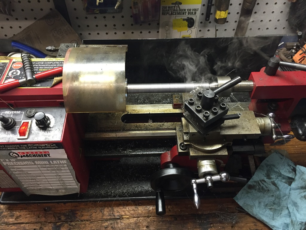

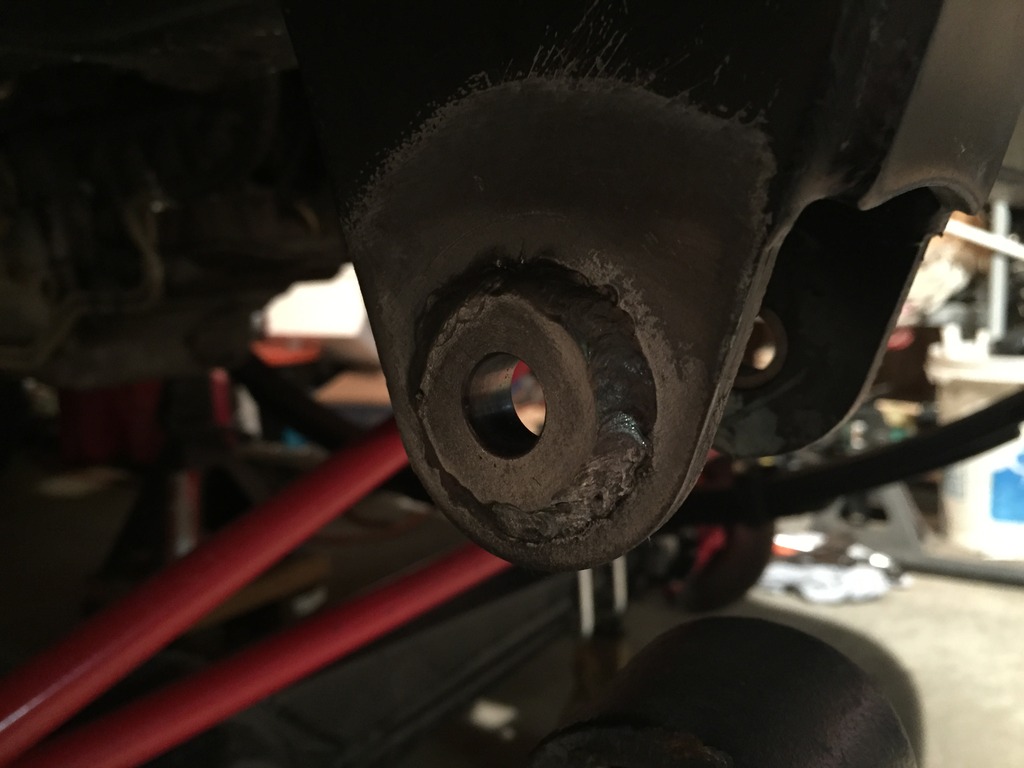

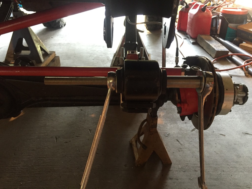

Well I finally fixed my front springs bushings. I used some energy suspension bushings (made for the frame tube, but they just need to be cut down in length to fit leaf springs) and some fix-it washers from RuffStuff. I used a piece of 3/4" DOM with .120 wall as sleeves so I could use the same size bolt as the Davez shackles use. I ended up turning to OD of the DOM down just a little on a lathe to better fit inside the bushings.
TG bushings or whats left of them

Turning the OD of the DOM down

I used some all-thread to get the sleeves inside the bushing

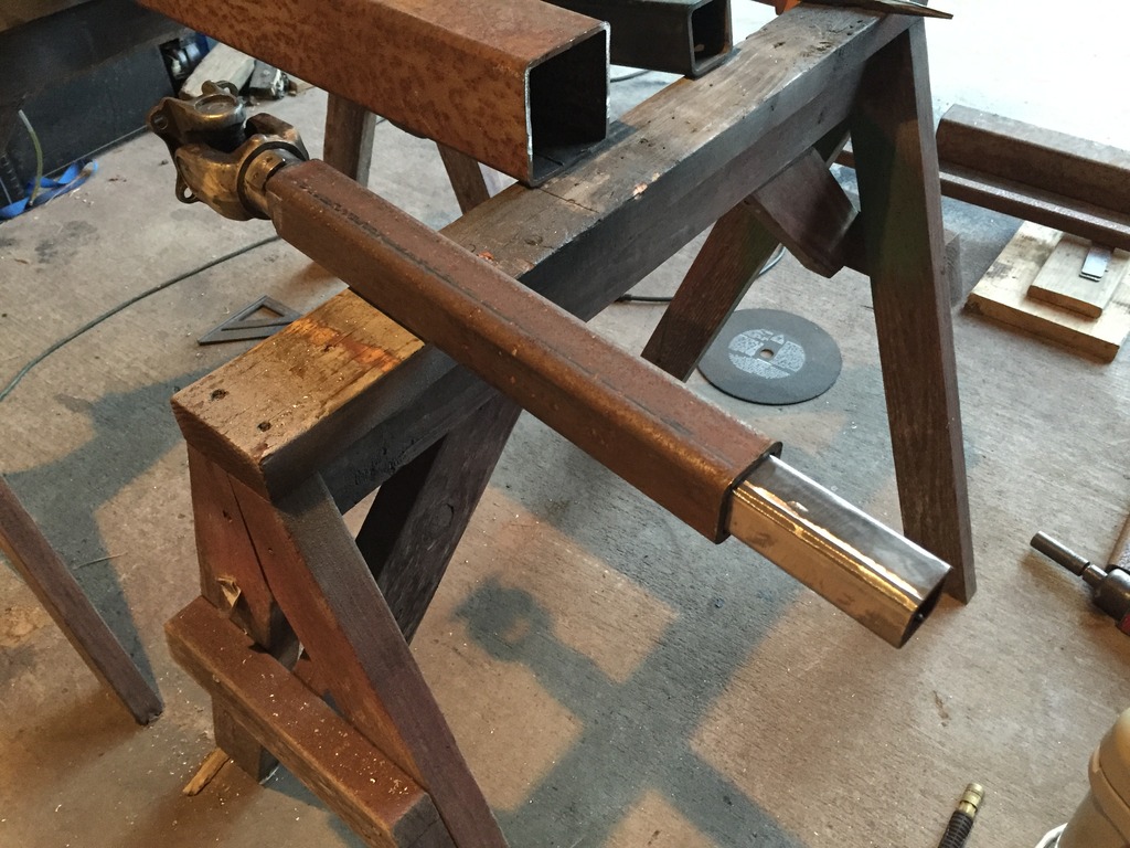

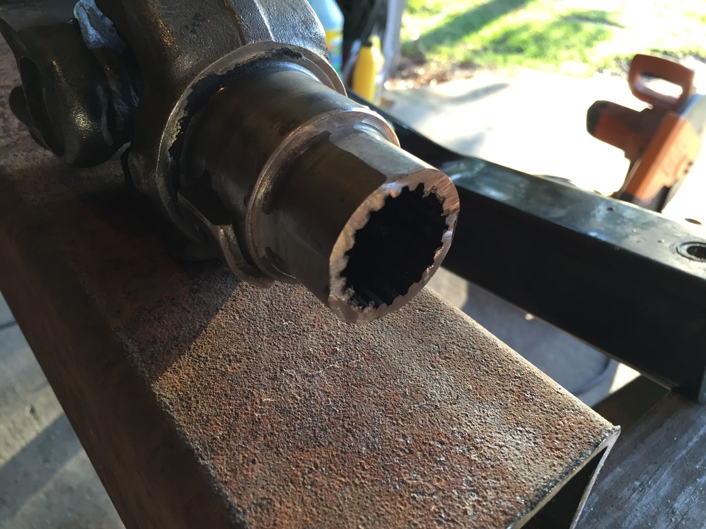

I finally got the front driveshaft built. I built it out of 2" and 1.5" square tubing, both 1/4" wall. I did have to grind a groove on the 1.5" tubing and run a flapper wheel on it to fit inside the 2". It was a tight fit.
I used 2 female ends to build it. I cut the splined section down to 1" long and used a grinder to make 4 flat spots in it. I had to take off about .020" off each spot to fit it inside the 2" tubing. I just used a short piece of 2" to fit the 1.5" on the ujoint.

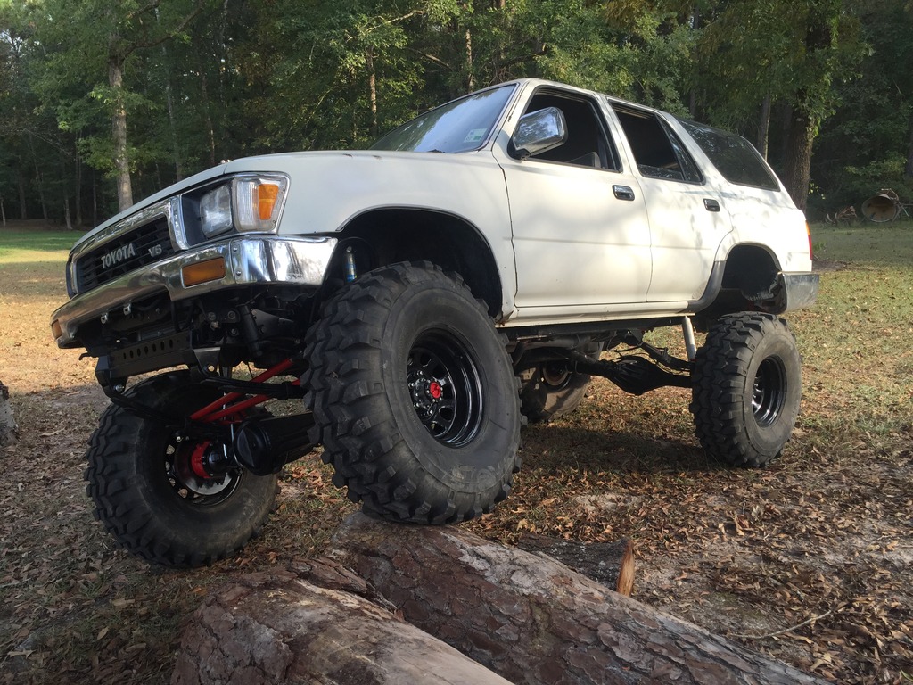

After I installed it decided to flex it out on a log at the house. It was the biggest thing I could climb on at the time lol.

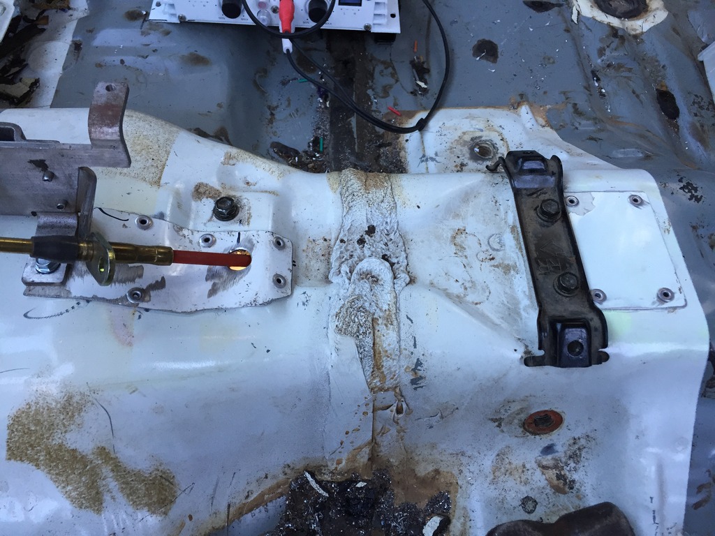

I finally got around to fixing the holes in the floor from the rear heater and where I ran the shifter cable thru. I also got an amp installed so I can have some music.

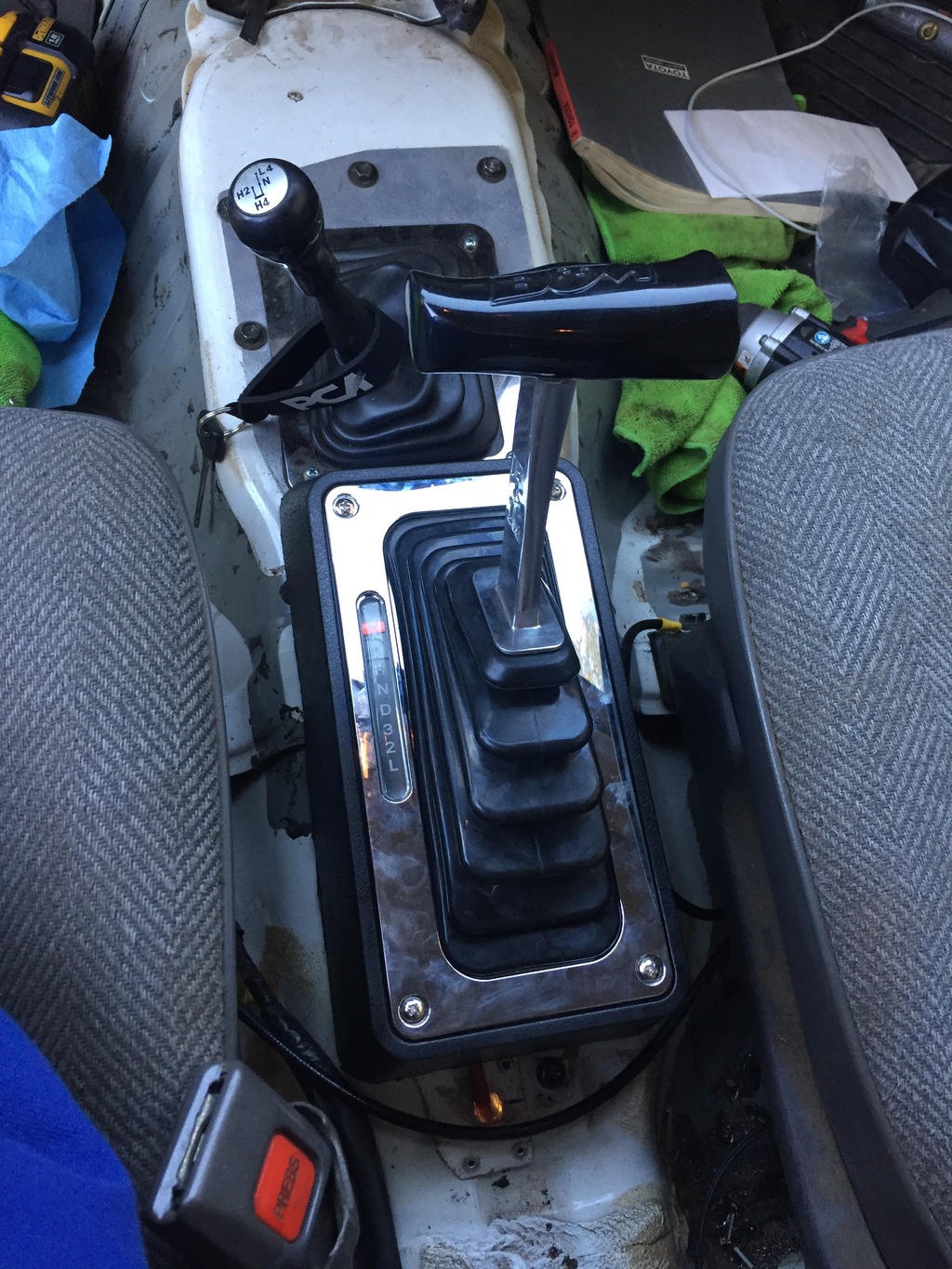

I installed the shifter cover which cleaned up the look a little.

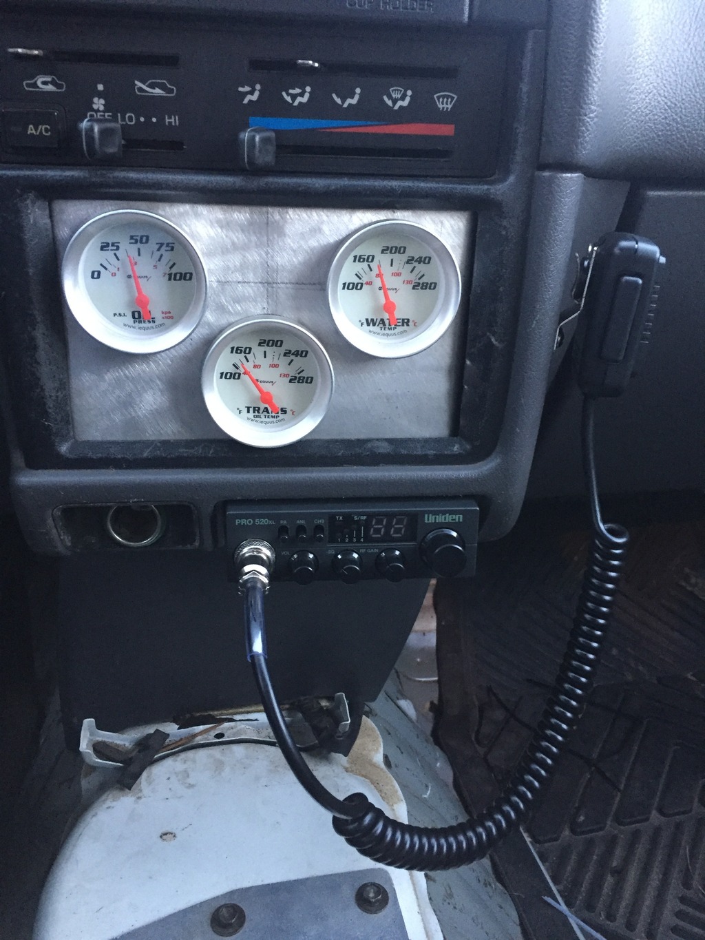

I added a Uniden Pro520 CB

I like the B&M shifter, looks really good. That CB looks really compact, you'll have to give us an update on how you like it, I want to get one someday, and that one looks like it would fit just about anywhere! Did you mount it where the ashtray used to go? Look forward to the bumper build and winch install, are you going to go with tubing, or build a plate bumper?
That's definitely in the ashtray hole, lol.
Thanks. Yea its mounted where the ashtray was. Just a little trimming and it fits like its suppose to be there. As far as the bumper, Im building a tube style bumper. I got a small start on it yesterday but nothing worth posting pics yet.
