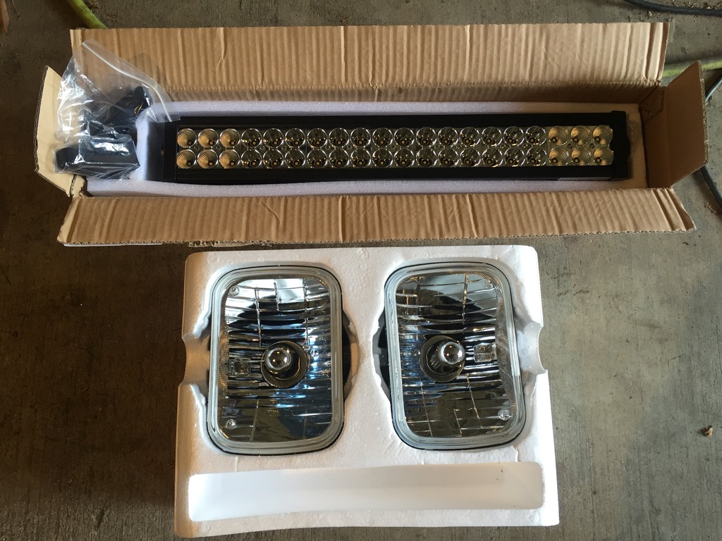

New lights and light bar

Old headlights

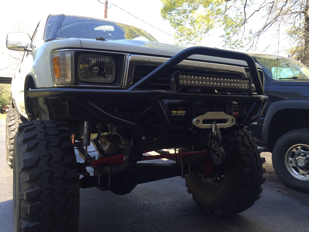

New headlights

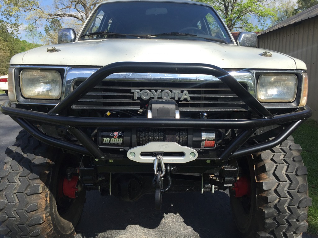

This is with the light bar mocked into place.

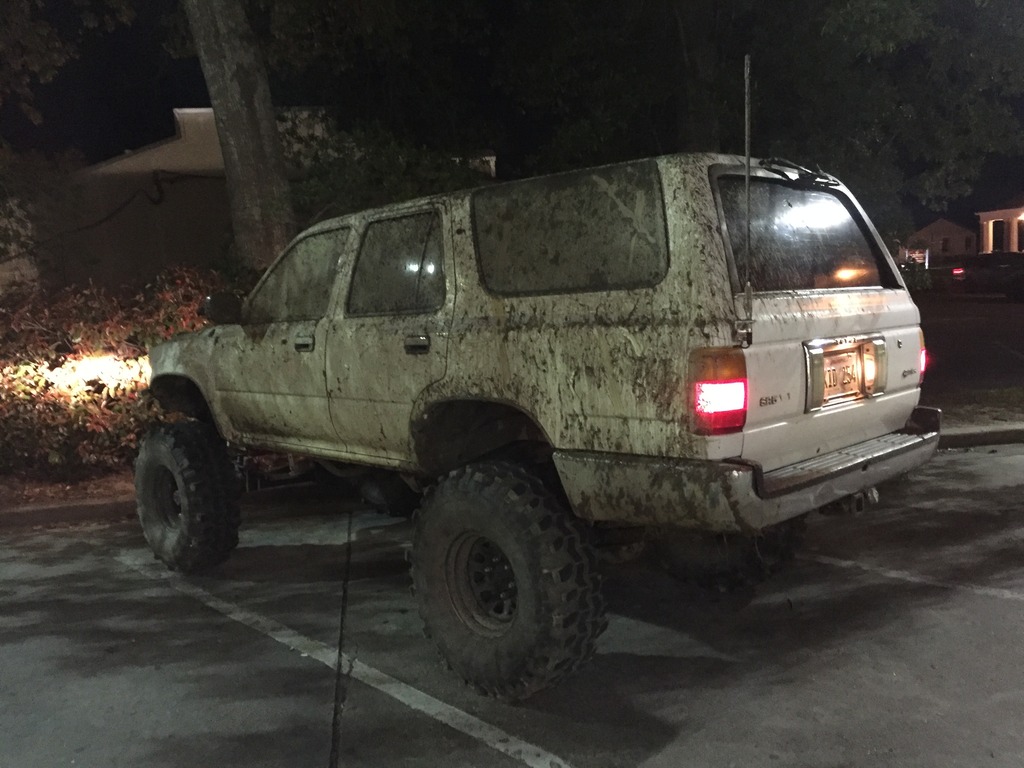

I did get it a lil muddy on my lease one night after a big rain storm we had. Prolly wouldn't have been bad if I had actually used 4wd lol.

The new headlights work 100x better than the old. Definitely worth the money. I also just ordered a Bluetooth receiver to hook to my amp for music. I daily drove the 4runner for about 2 weeks and I got tired of hooking up the aux cord to my phone lol.

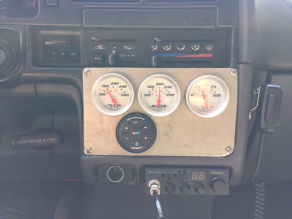

I decided to install a Bluetooth receiver. I got tired of hooking/unhooking my phone everytime I got in and out. I had to redo the dash piece I made for my gauges to fit it tho.

Whats going on with your radio? Is it mounted elsewhere and you just have that button pad to control it remotely?
Old Jun 14, 2016 | 05:48 AM
  #371
bump530's Avatar
Joined: Apr 2013
Posts: 478
From: Louisiana
Been awhile since i seen your rig...looks awesome!!How do you like the 4.3??Im sure i will be bothering you in the future cause im still in the process of finishing my 87 truck with the 4.3
I like it. Of course, there is always times I wish it had more power lol.
I don't have a radio. That pad is a Bluetooth receiver. I use my phone for music. The Bluetooth receiver is hooked up to an amp mounted under the passenger seat to power the speakers.

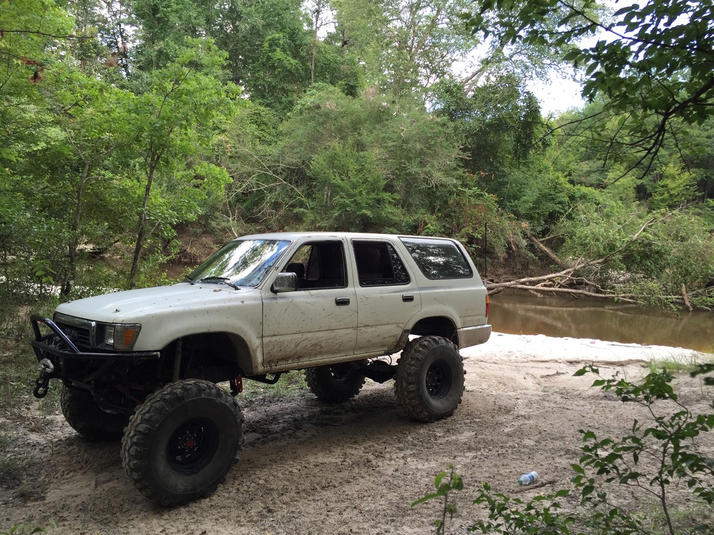

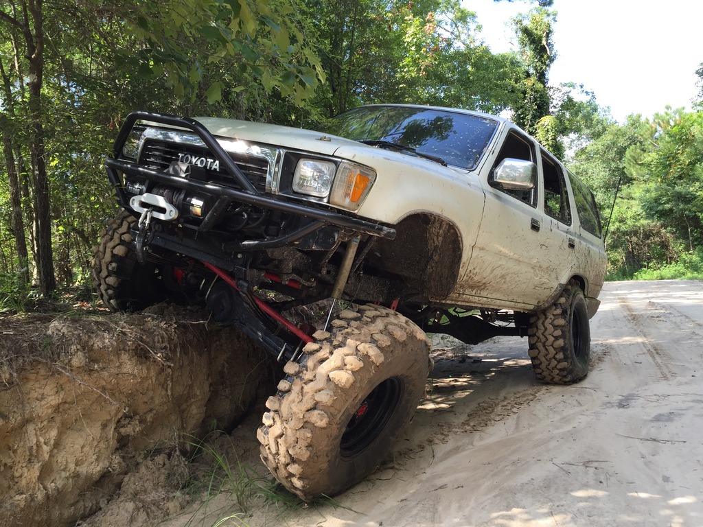

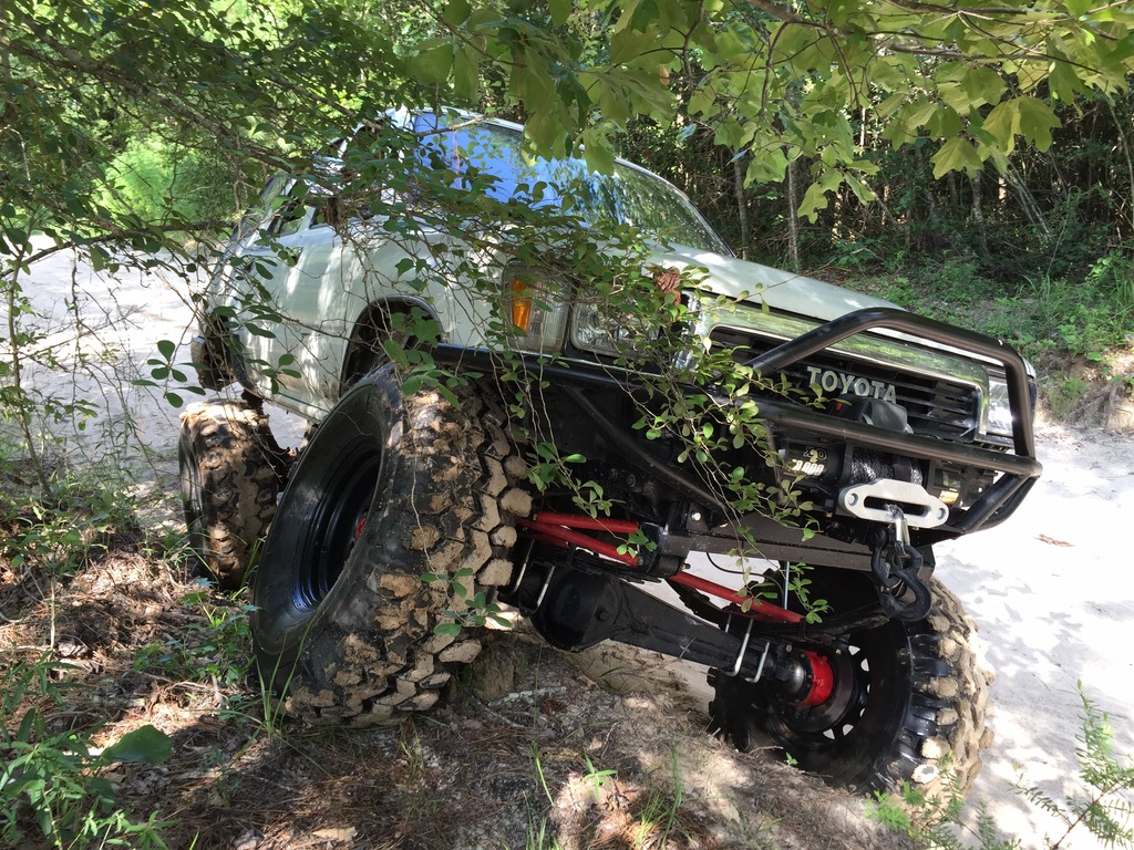

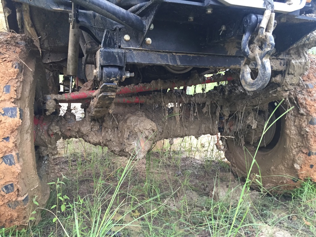

Well I took the 4runner out last week for a little cruise. Went down to a creek by the house and found a place to flex a little.

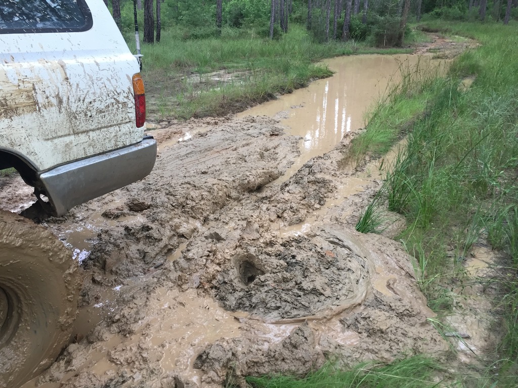

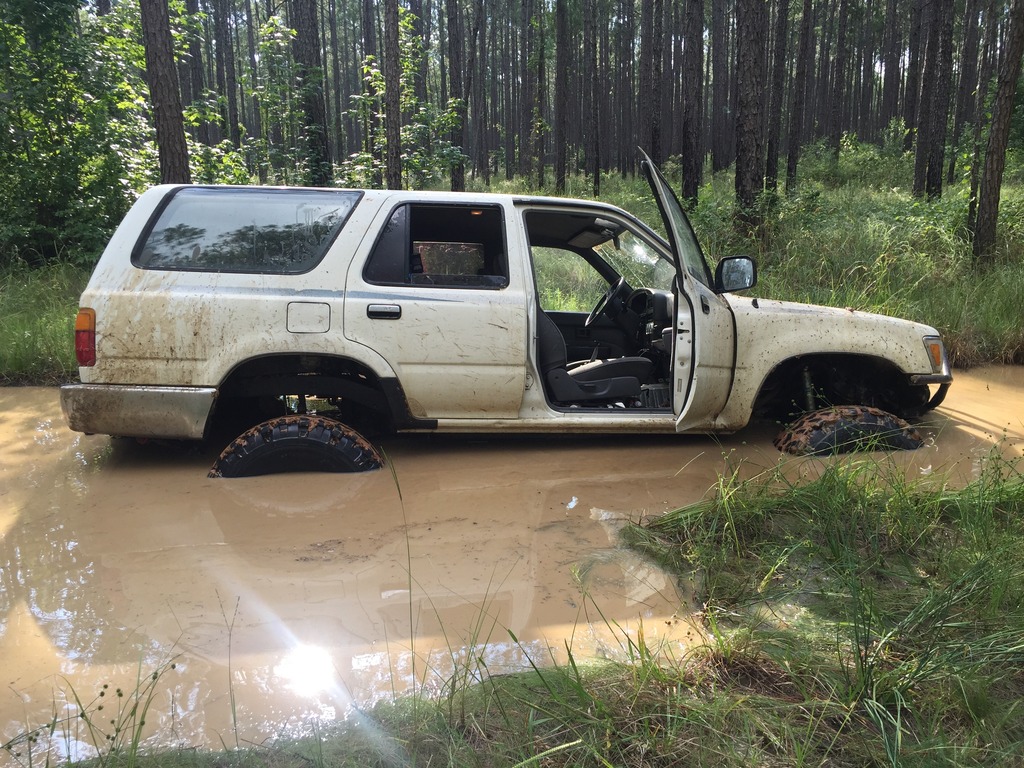

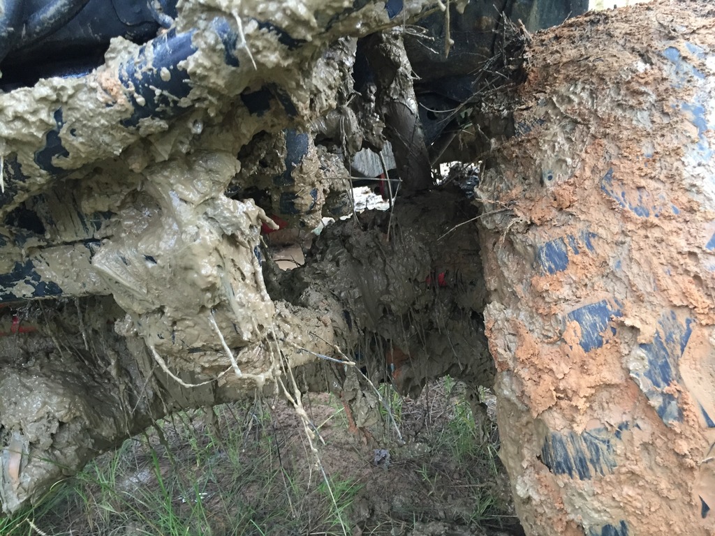

Then we decided to make a trip to another place. I didn't realize this was as bad as it was.
The good news is the winch and bumper work great. The bad news is water got in the transmission and I didn't know until a little while later. I believe the vent was underwater and as the trans cooled it sucked water in. So a trans rebuild will be happening soon. Also got water inside the cab which found the amp that powers the rear speakers (which I could never make work). Now I just have static coming out the rear speakers and no music in the front. The front diff is also full of water(leaking pinion seal). The starter got wet and is acting up too. I will also be doing some kind of snorkel set up as the belt throws water directly on to the air filter.
Not sure when ill be ordering parts to rebuild the trans, but the 4runner is down until I do.

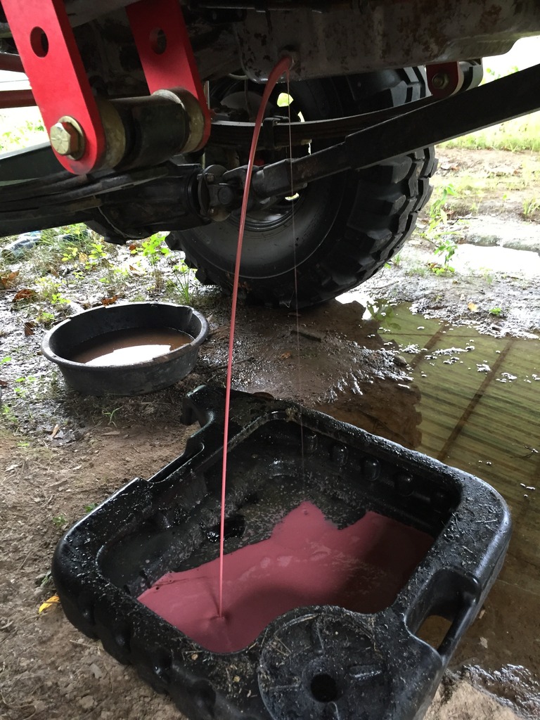

I thought I would share a pic of what my trans fluid looked like when I drained it yesterday.
Strawberry milkshake anyone? lol
