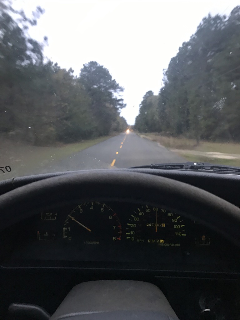

Well after 5 months, the 4runer is running again. I installed the rebuilt trans this weekend. It felt good to finally drive it again. I still have to go thru the front axle tho. The pinion seal was leaking and let water into the housing. I'm putting in a fresh 4.88 third in I got from a buddy with a Spartan locker.
I even replaced the speedo cable while I had it apart.

what gears are you replacing with the 4.88? Same ratio?
I was looking at your picture and with 33's and 4.88 gears my 60mpg RPMS is a bit higher than yours... I think it's about 2500.

Yeah I have 4.88s already. Well ours will be different. I'm running a GM transmission. I'm gonna check my speedo with a GPS, but I think its pretty close.

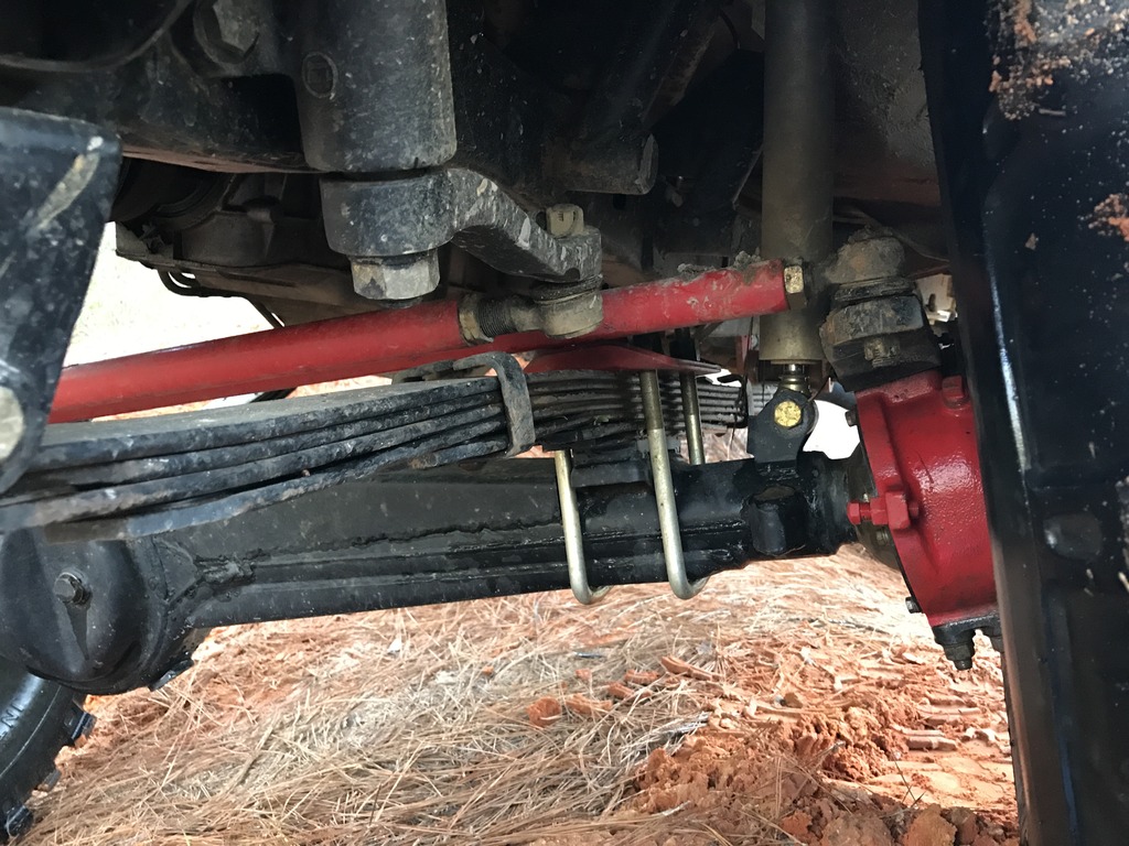

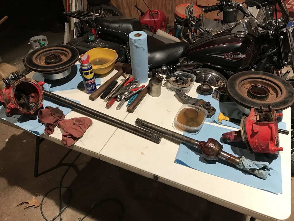

Front axle is apart. Time to clean all the parts and put it back together.

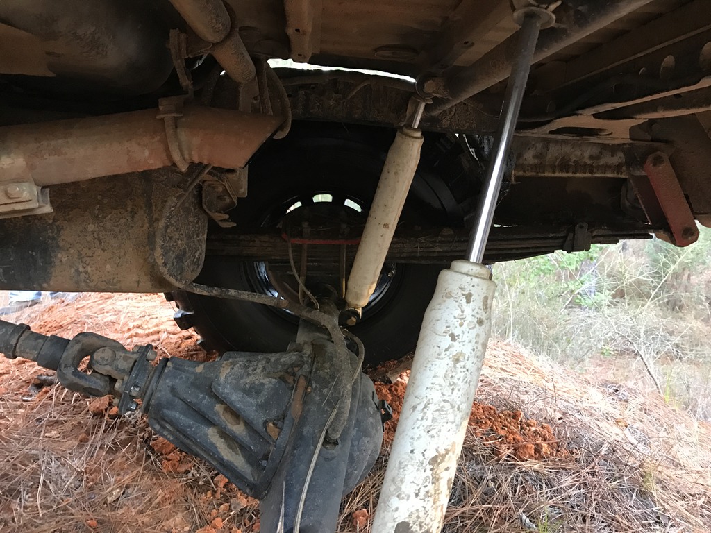

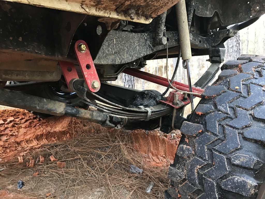

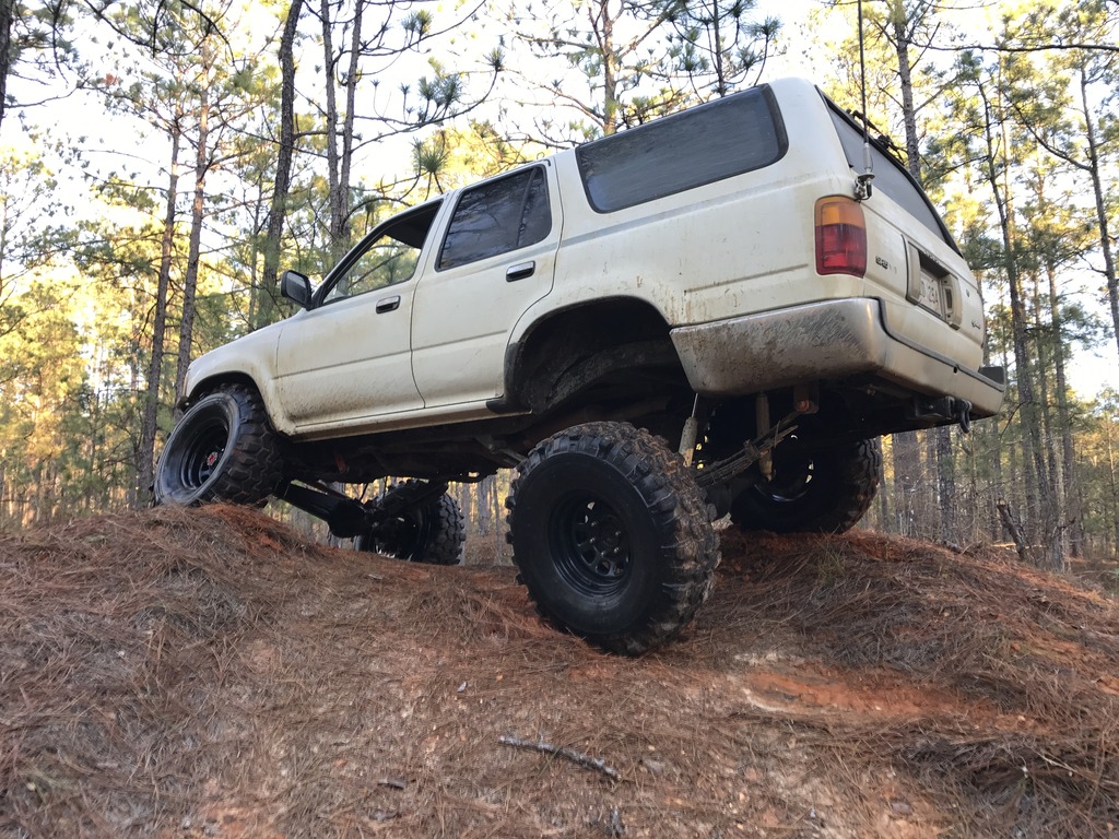

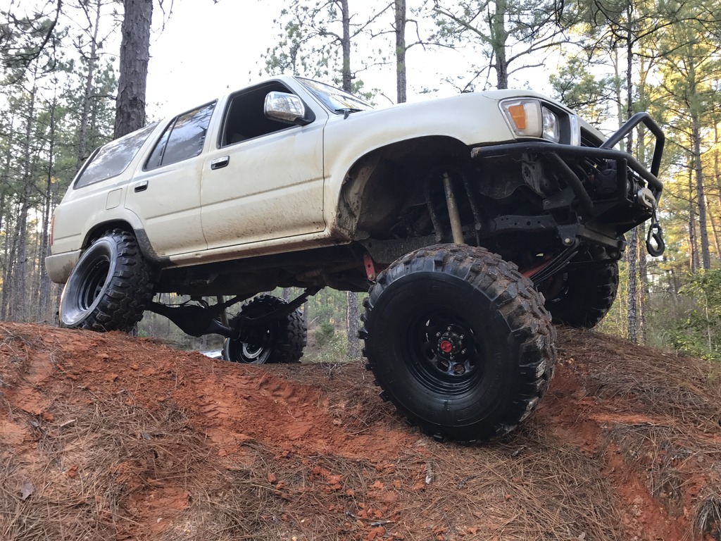

Well the 4runner has been back together for a few weeks now. Ive made driving it a lot. Feels good to have it back going. I did start hearing some whining coming from the rear end. I checked the fluid and apparently I got a lil water in it back in June. Ive drained and refilled it. I'm gonna keep checking it for a while to see if I didn't mess it up too bad.
Yesterday me and guy from work went on a lil ride. I found a pretty good spot to test the flex. I now know where I need to set my front bump stops lol.

The locker in the front really helps out. Glad I finally have it lol. I need to trim the rear bumper big time lol. I actually just need to build a new one, but that may have to wait a lil bit.

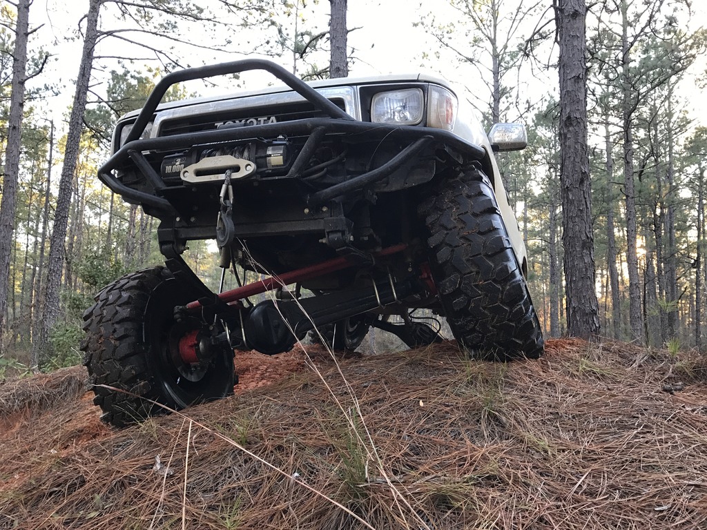

Its been a while since I updated. Havent really done much to the 4runner over the past year. I installed a light bar, ammo can center consule/cup holders, and fixed a few things. We are planning a trip to Colorado this summer, so Ive got some things I want to do first before going. Im hoping to build some sliders and rear bumper, replace front square driveshaft with a balanced one, try to get the heat down inside the cab and some other things.
Center Console
20" Light Bar
Front Doorless. Helps alot with the heat. I may build some half doors with a spare set I have or may build tube doors.
Hood vents. Not sure where I want to mount them yet. Im thinking like they are in the first pic.
As you can see I painted the grill black, but the love bugs decided to remove some of that paint for me lol.

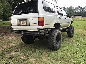

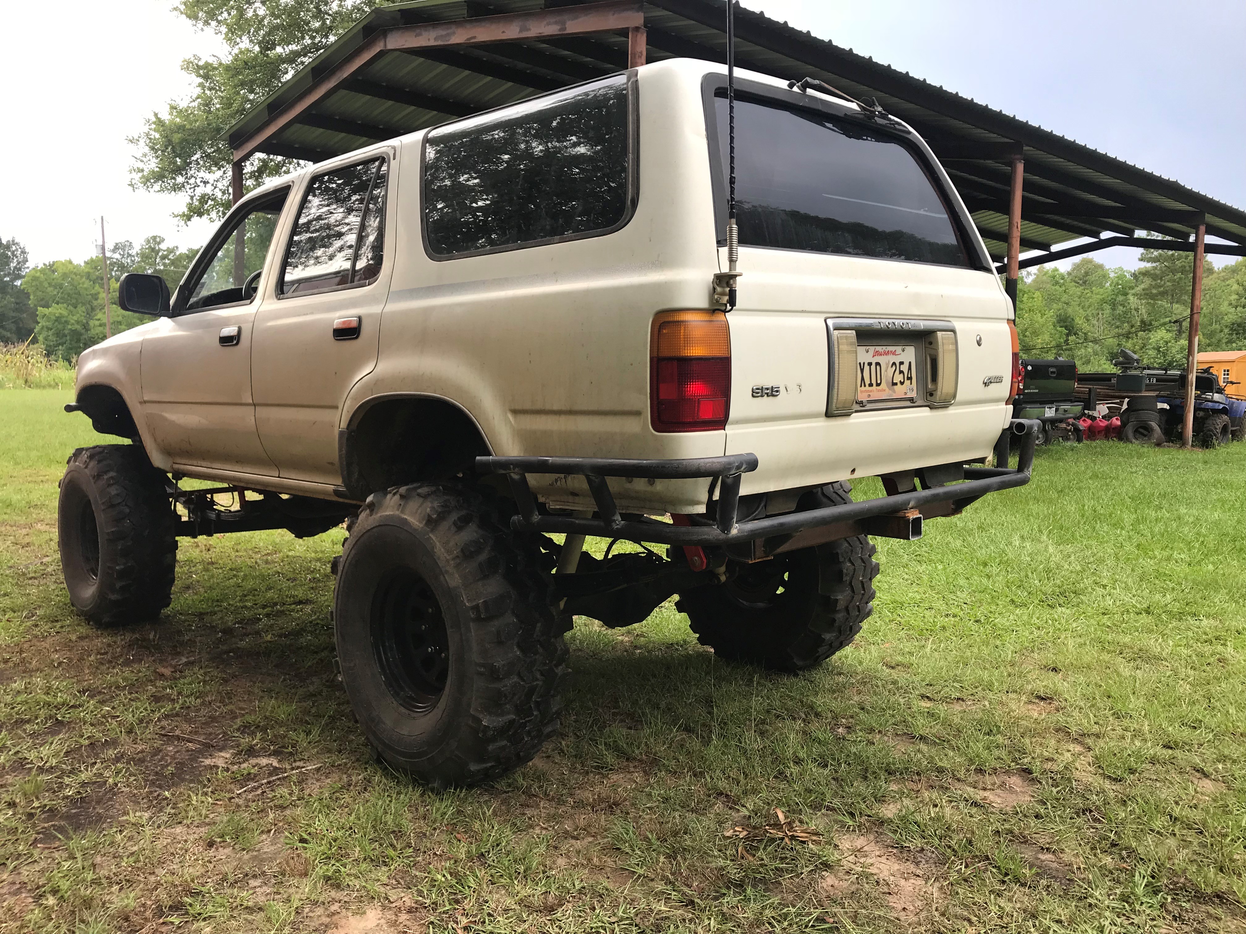

Been a little bit since an update. Im currently getting this thing ready to go ride some trails in Colorado at the end of the month. Im finishing up my rear bumper build right now. Ive also got a Marlin front driveshaft kit and AC parts on the way. I dont know if Ill have the AC installed before we go, but I dont really think I will need it in Colorado, but I sure do need it down here in Louisiana lol.
Couple pics of the bumper. This is just it tacked together.

Rear bumper is done and painted, just needs to be installed.
