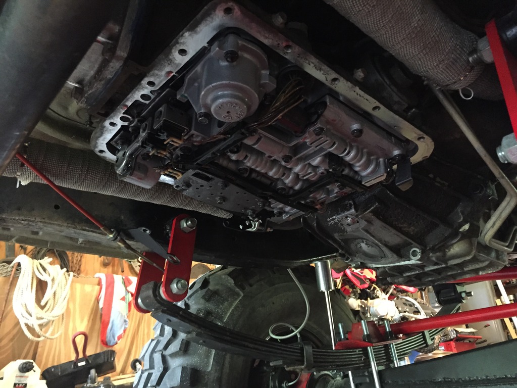

So after doing some reading, I decided to pull the valve body and servo out of the trans and see if I could fix me issue.
Well my untrained eye didn't see anything. So I put it back together yesterday hoping something magical happened and it fixed itself. Well that didn't happen and I managed to screw it up even worse. Now I have no movement from the trans at all. Not sure exactly what I did. So now Ill be pulling the trans this evening and taking it someone have it gone thru. Hopefully it doesn't take too long and/or cost to much.

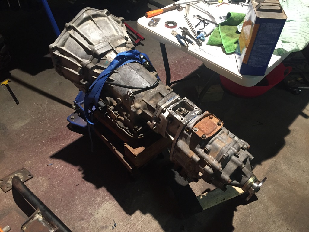

Well the trans is out. Ill be dropping it off tomorrow. The guy is suppose to get on it next week. Hopefully its something minor and its done quickly.

I went and picked up my transmission yesterday afternoon. The guy that worked on it said I had a valve backwards. Hopefully everything works like it should now. Hope to get it installed this evening. I also ordered a new trans dipstick but it wont be here until Friday, so Ill throw that on Friday evening, fill it up with fluid, and test it out.

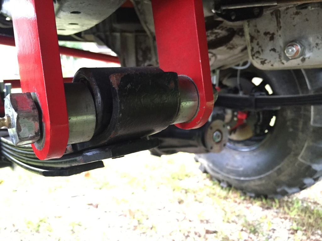

After I got home yesterday, I was checking it over and noticed this...

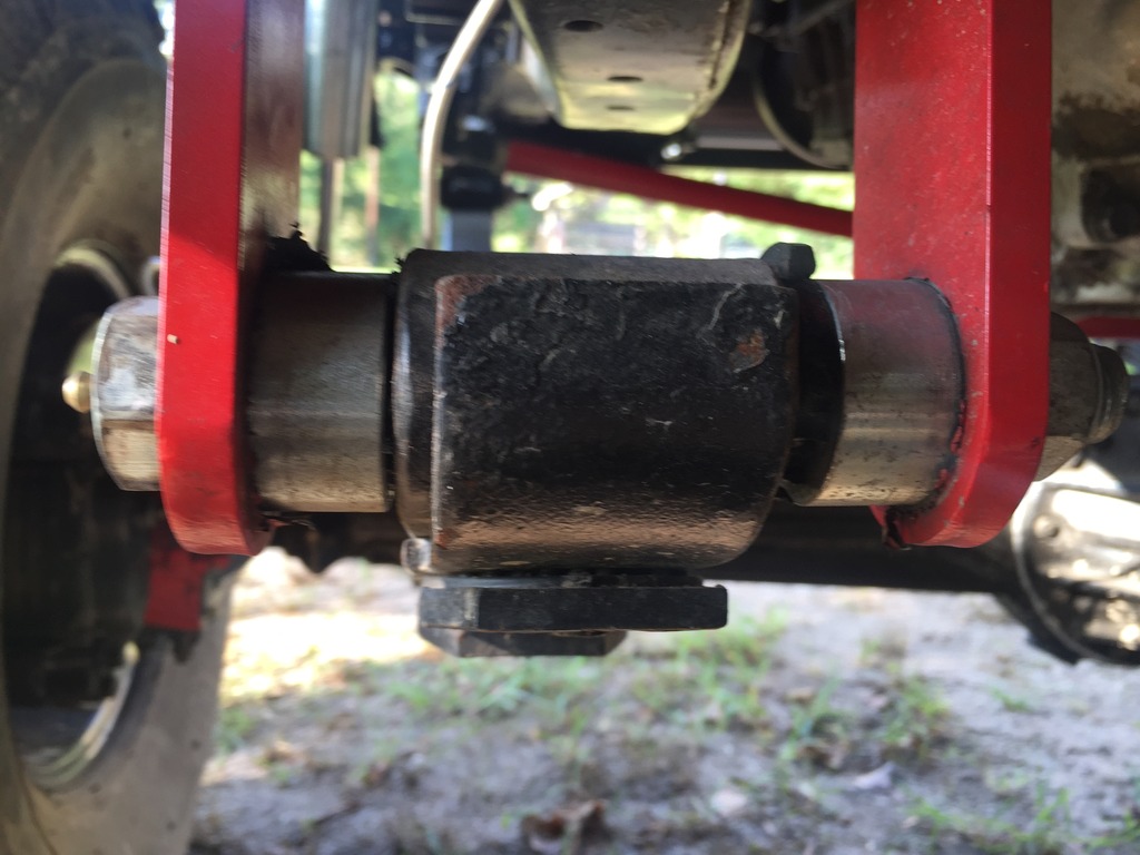

Those TG spring bushings suck. The shoulders on them actually started splitting even before I had the motor running. Im not really a fan of how there is no sleeve inside the bushing anyways, so I ordered up a set of Davez shackles to replace all that. I think I could have built a set a lot cheaper, but decided to take the easy way out. I think I may go after work sometime this week and try to pick up some square tubing to build a front driveshaft.

You got that right on the bushings!!!! Mine look the same as yours and I havent even wheeled it yet.

pretty sure it is the shackle spacers that do that to them. I could never keep a pair together very long either.
Yeah I think the TG spacer being a smaller diameter (looks like it may fit inside the spring end) than the OD of the bushing flange kills it. But I also think a sleeve in between it all would help too.

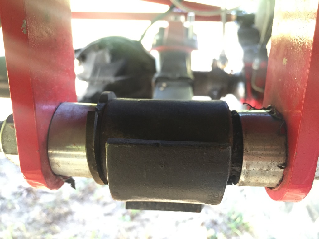

Heres a pic I took of the bushing on the front springs. They are completely destroyed now. Still waiting on my davez shackles to come in.

Is there a reason you got all new shackles instead of just new bushings?
Old Jul 29, 2015 | 04:03 PM
  #298
bump530's Avatar
Joined: Apr 2013
Posts: 478
From: Louisiana
Because I wanted shackles made to use a sleeve inside the bushing. I could have built some but wanted to just buy and install lol

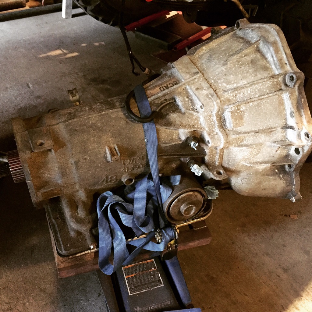

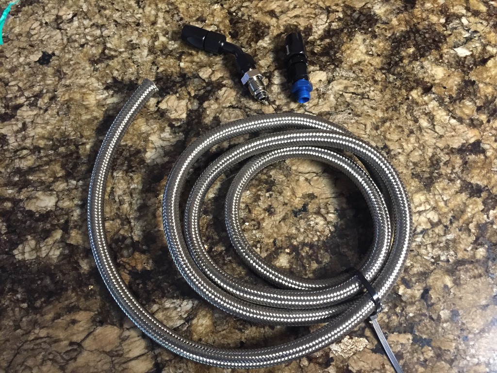

Fuel line parts came in yesterday, so I pulled the 4runner back in the shop to start installing it. After looking closely at the fitting I bought to go into the Toyota fuel filter, it seems I ordered the wrong part. So I did some digging and I think I found the right part. Unfortunately it probably wont be here until the middle of next week, and Im flying to California next Wednesday for a friends wedding. Plus I still haven't received Davez shackles. So Im down for a couple more weeks lol.
