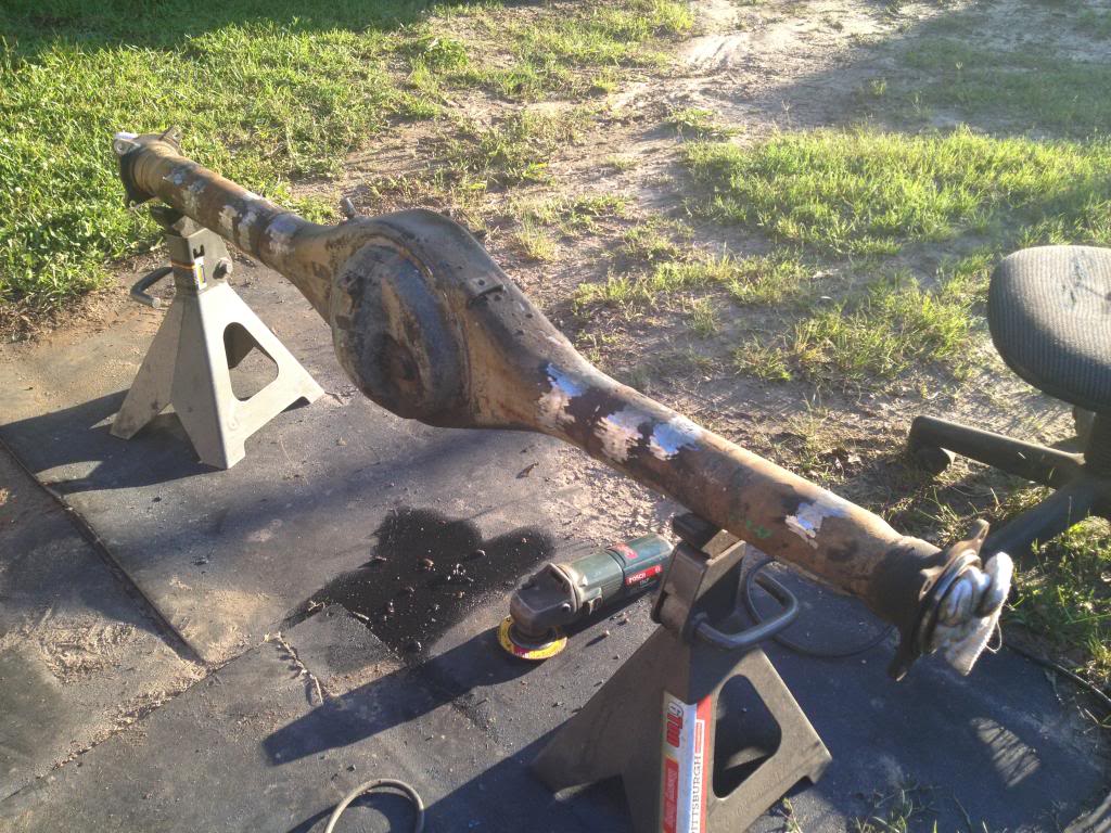

Originally Posted by Red Wagon
Did you arch the frame?
Sorry but I'm not sure what your talking about. Only thing I've done to the frame so far is cut off the ifs brackets and cut holes for the shackle tubes.

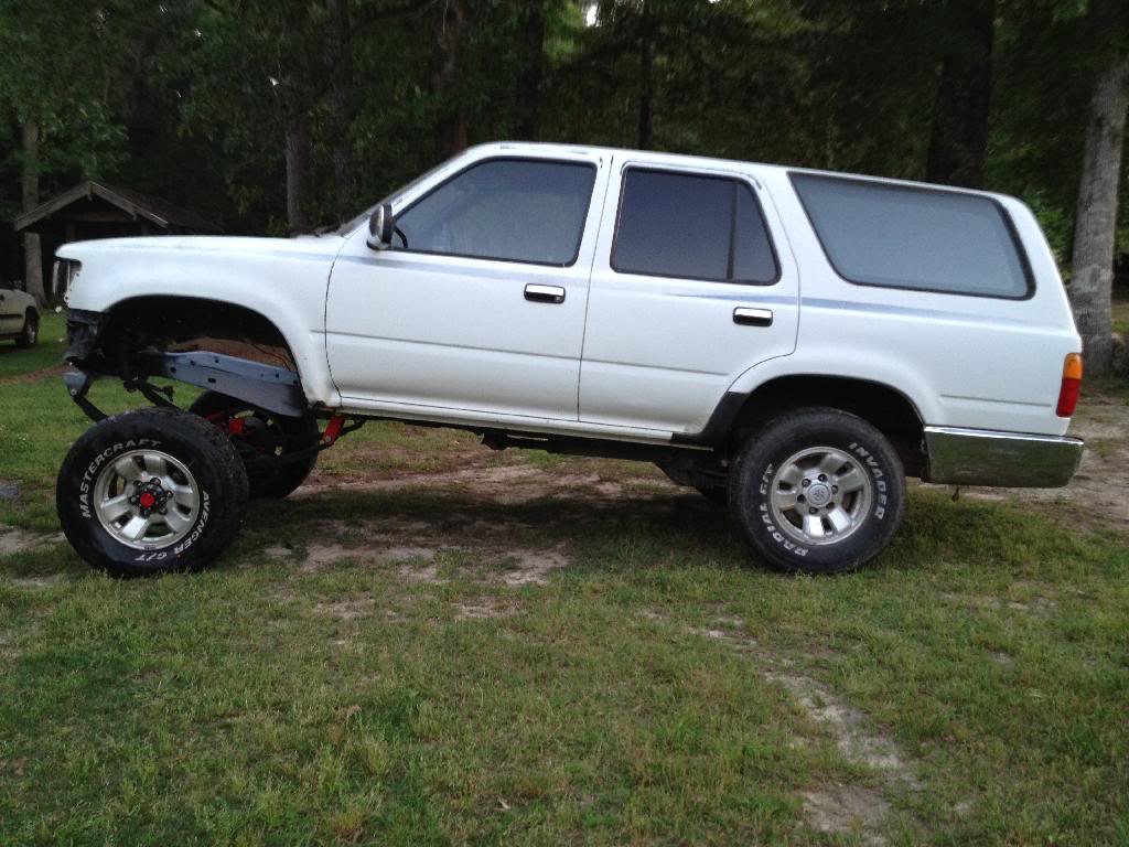

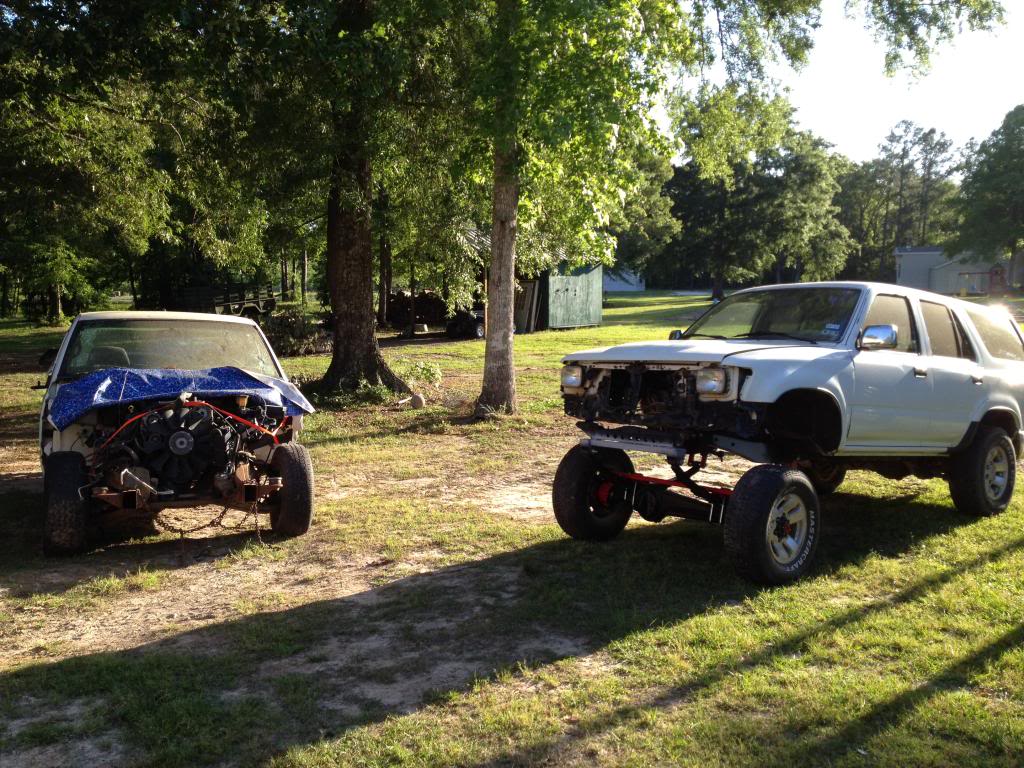

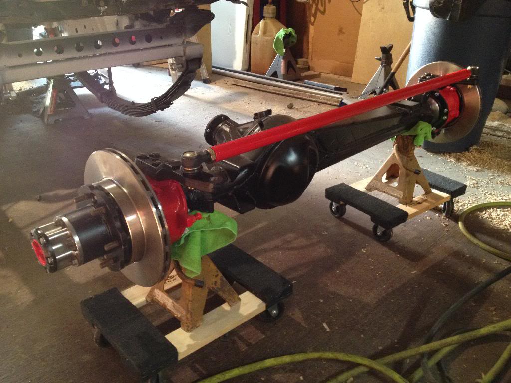

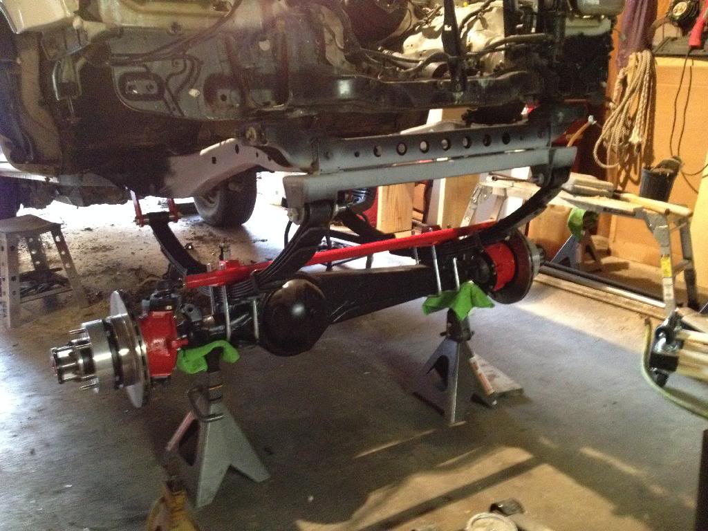

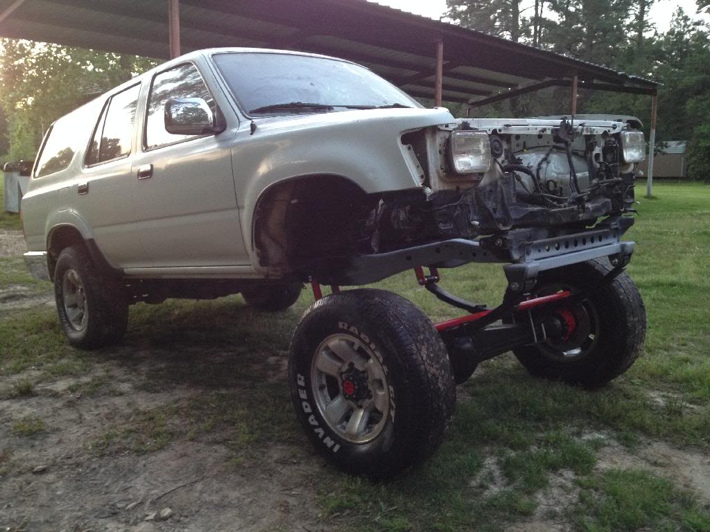

Well I finally stopped being lazy and this happened...
Its finally sitting on all fours again. Its really tall in the front right now mainly cause there isnt any weight up there. After I get the drivetrain in, I will be able to set the front hanger to its correct position. Next is the gettin the new motor/trans out of the donor rig and prepping it to go in. Id like to get the drivetrain set, then finish welding the front spring hanger, then do the back suspension. After that will come the fun part of wiring the 4.3 lol.

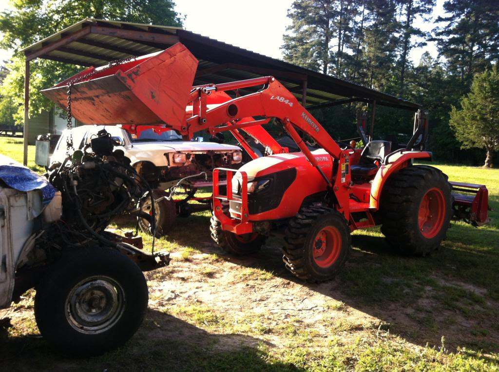

Well the 4.3/4l60e is finally in the shop. Me and buddy pulled it yesterday.

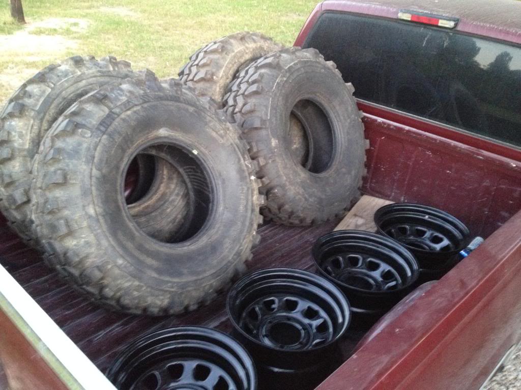

I also dropped my tires and wheels off yesterday to be mounted. I went to pick them up afte work and he was closed already (after telling me he would still be open). And just because I like pics...

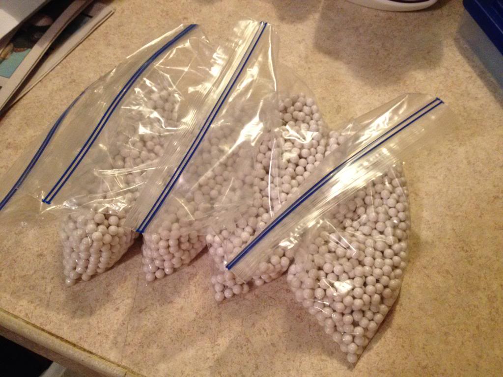

This is 8.75oz of BBs for each tire for balancing(Thats a 5000 pack split evenly between the 4)

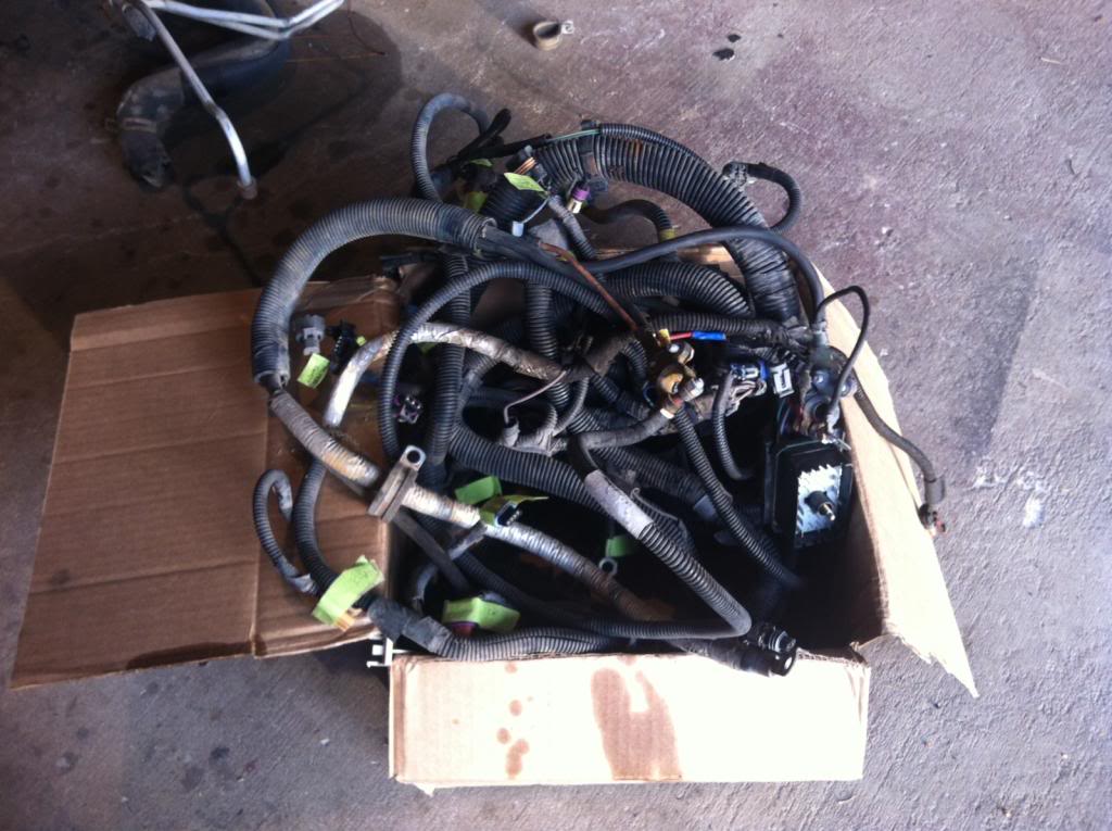

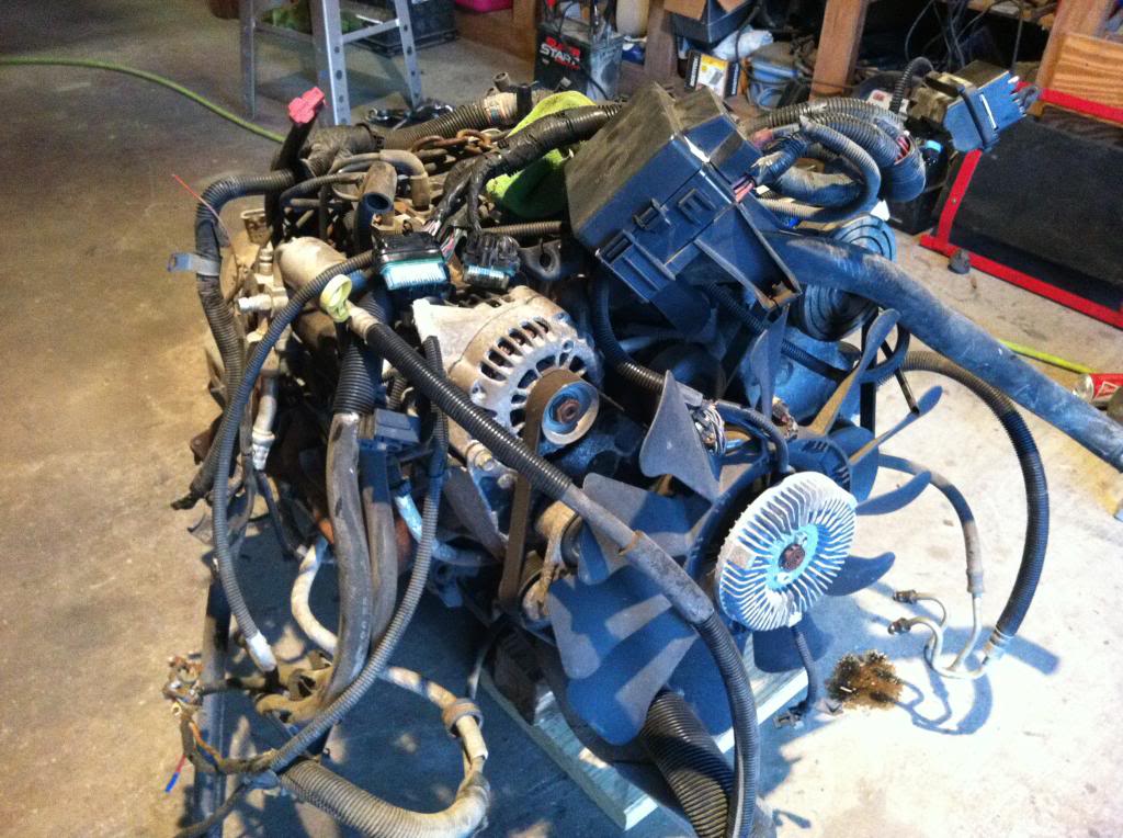

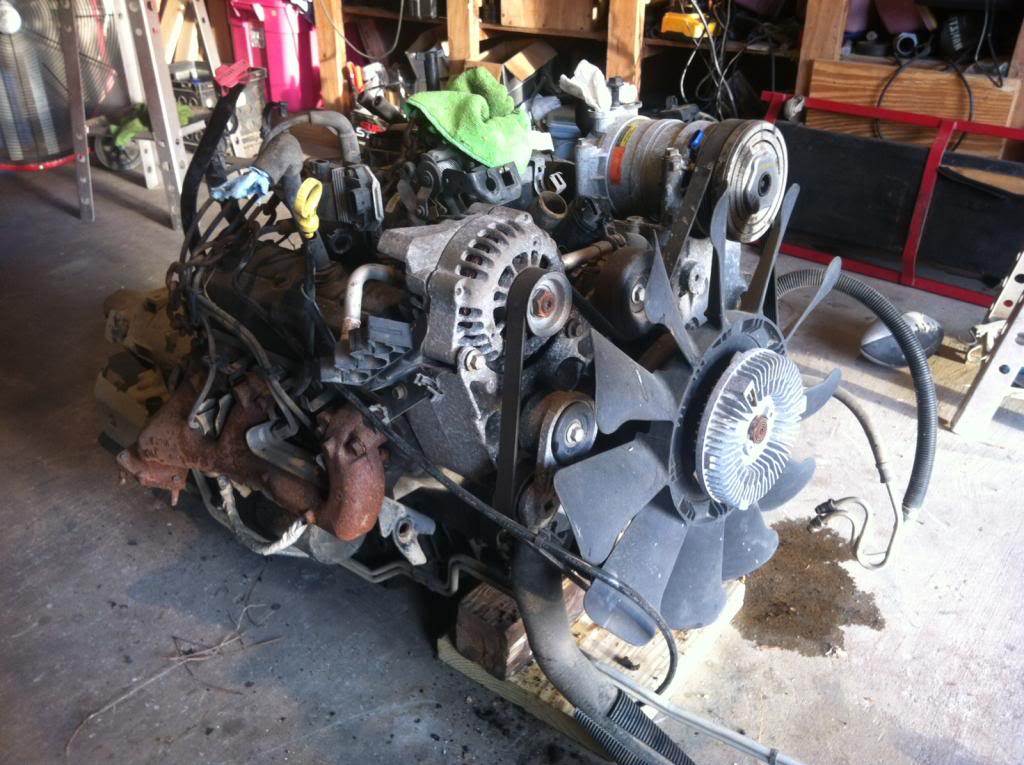

Pulled the harness off the motor and trans yesterday evening.
Motor looks a little less cluttered

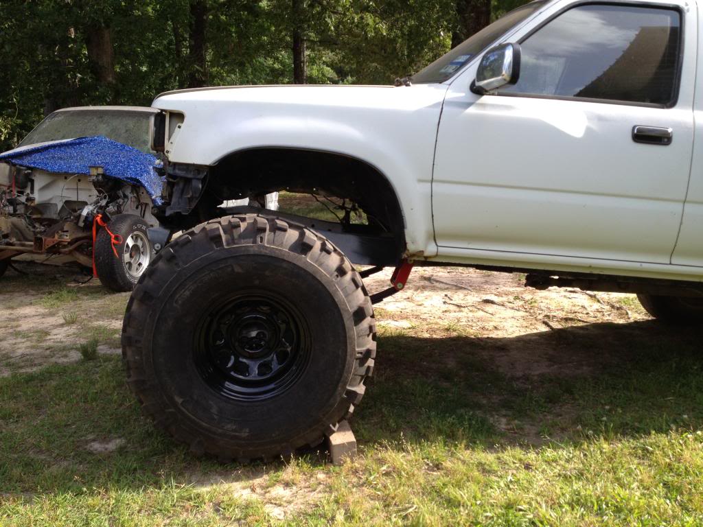

Got my wheels and tires back from being mounted and I mocked one of them up in front of the 4runner

Tires look awesome! and Huge!!!!!
I am very intrigued by the balancing bb's How well does that work? How do you know how many/much you need?
Old May 8, 2014 | 01:52 PM
  #96
bump530's Avatar
Joined: Apr 2013
Posts: 478
From: Louisiana
Thanks.
This will be my first experience with balancing tires like this. I've seen it done a lot over on pirate. Most use the chart on this link to figure out how much to use.
http://innovativebalancing.com/mobile/chart_spec.php?4x4=1
The beads I got are just airsoft BBs from Walmart. I'm hoping it works out good but I won't know for a couple more months lol

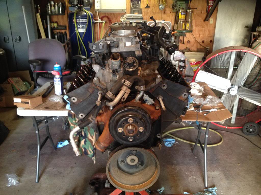

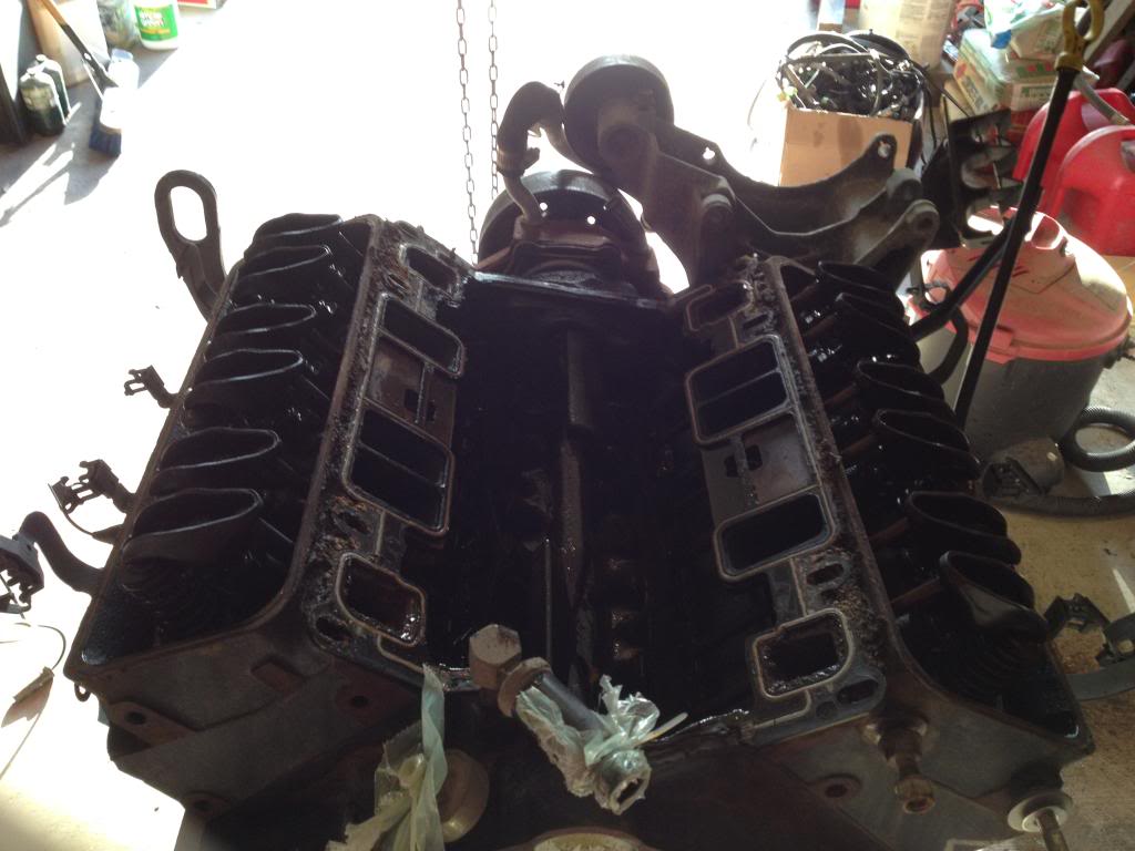

I got the motor cleaned up pretty good and I tore the intake manifold and heads off of it. I hadnt planned on doing head gaskets but I figured I might as well since I was that close. Heres a pic of the motor before I pulled the heads off.

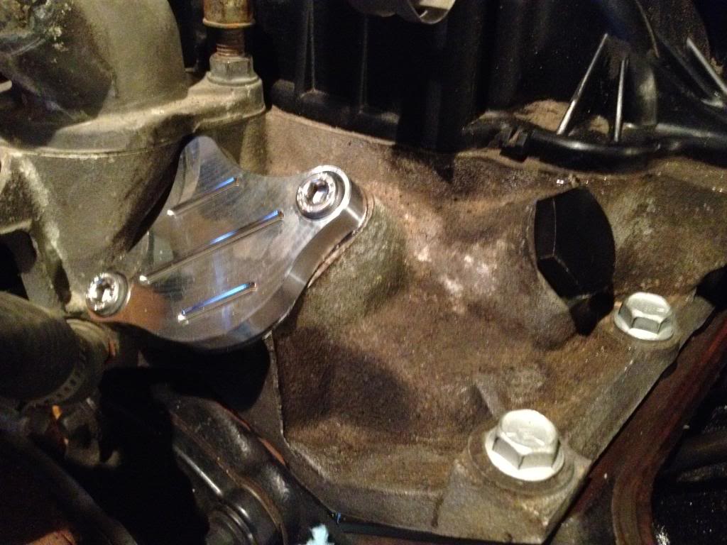

I installed the push rods, rocker arms, valve covers, egr delete, and new front main seal on Saturday.
EGR block plate and plug

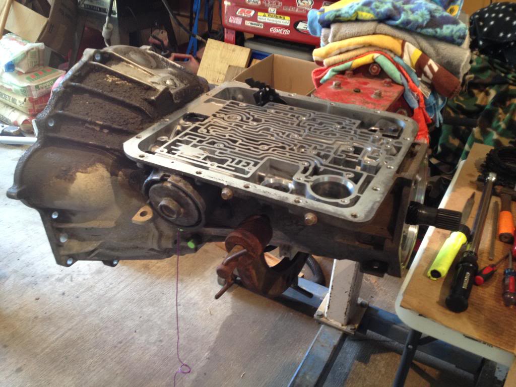

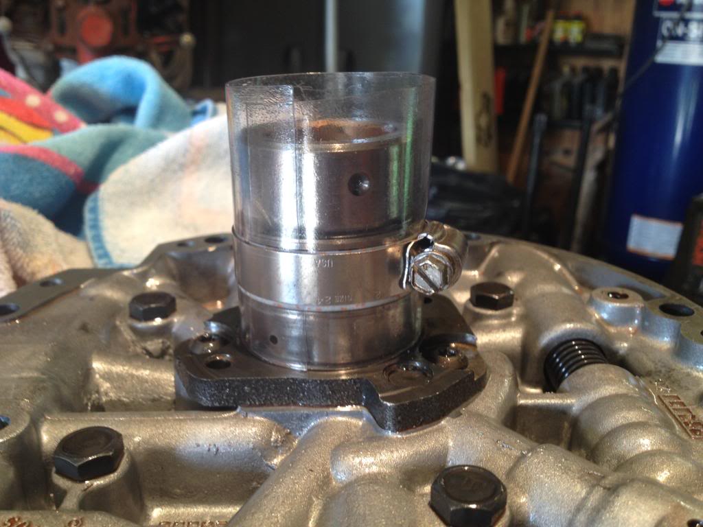

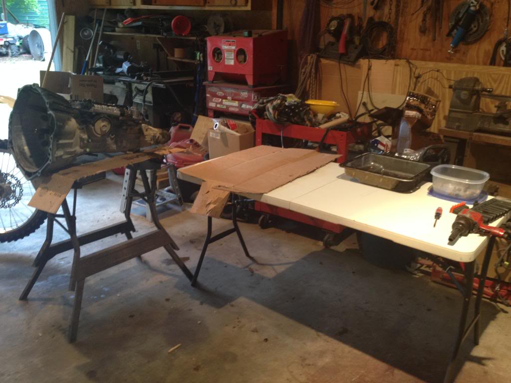

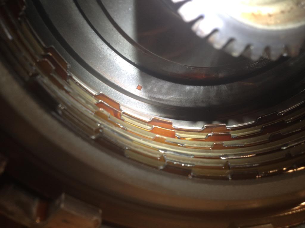

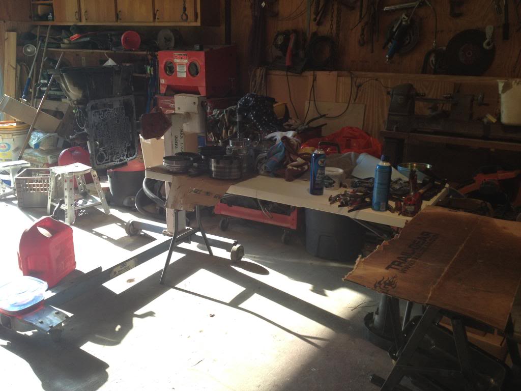

Yesterday I decided to tear into the transmission finally to change the output shaft. I got the new output shaft installed and then realized my clutches were no good. So hopefully picking up a rebuild kit today from a guy at work and I can finish the trans up tomorrow.
Trans work station
Bad Clutch Teeth

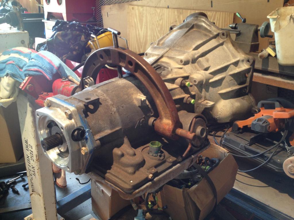

Well I've got a small update. I got the trans rebuilt and both trans/tcase adapters installed. Now I just gotta work on getting it all installed in the 4runner. I sold one of my dirt bikes so I have some extra money to help finish this thing. Now my hold up is time, not time and money lol
Here are some pics of progress
