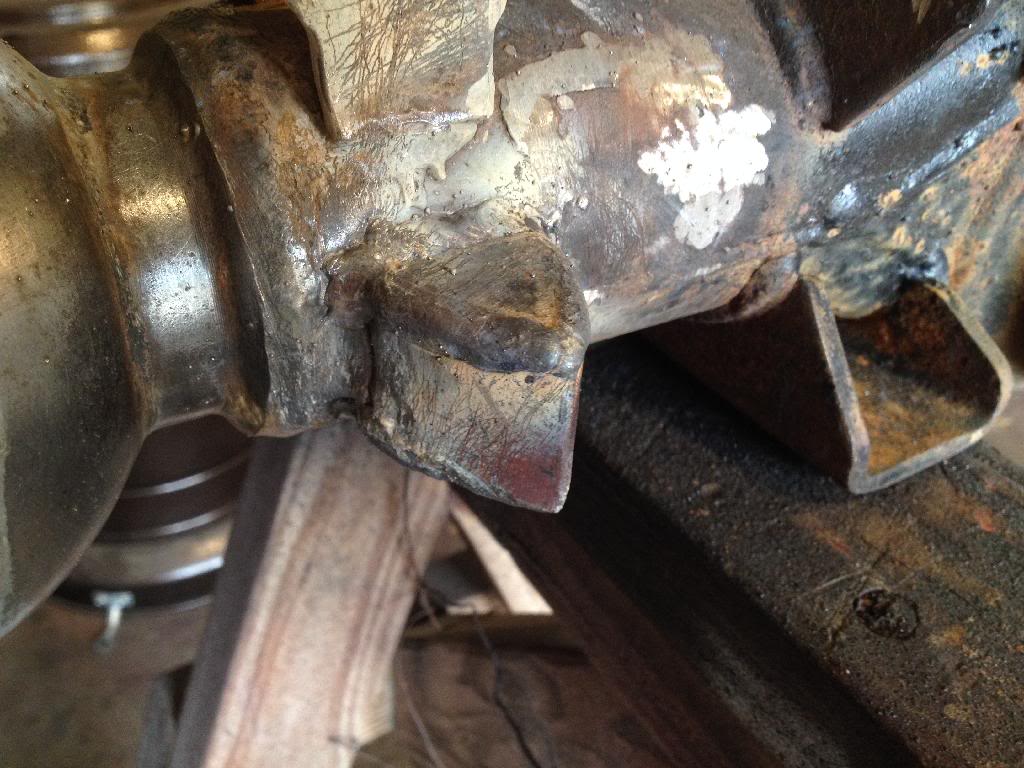

I capped my steering stops

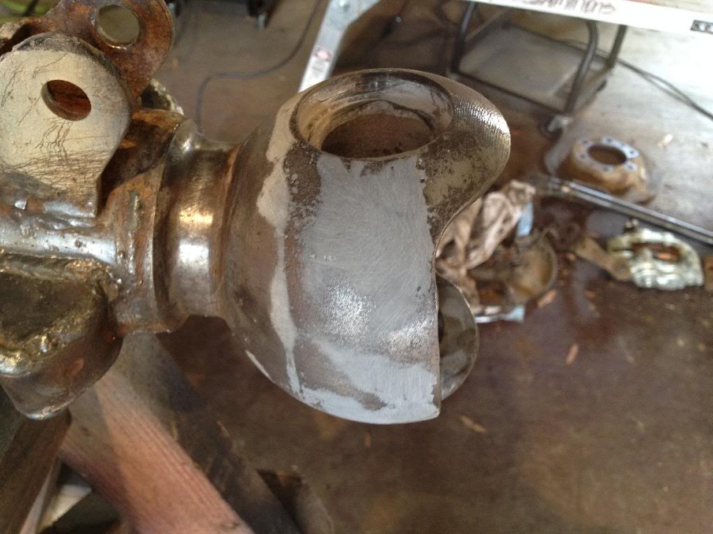

I sanded down the JB Weld on the knuckle balls (but I ended up hitting it with the wire wheel on accident so I have to do some touch up)

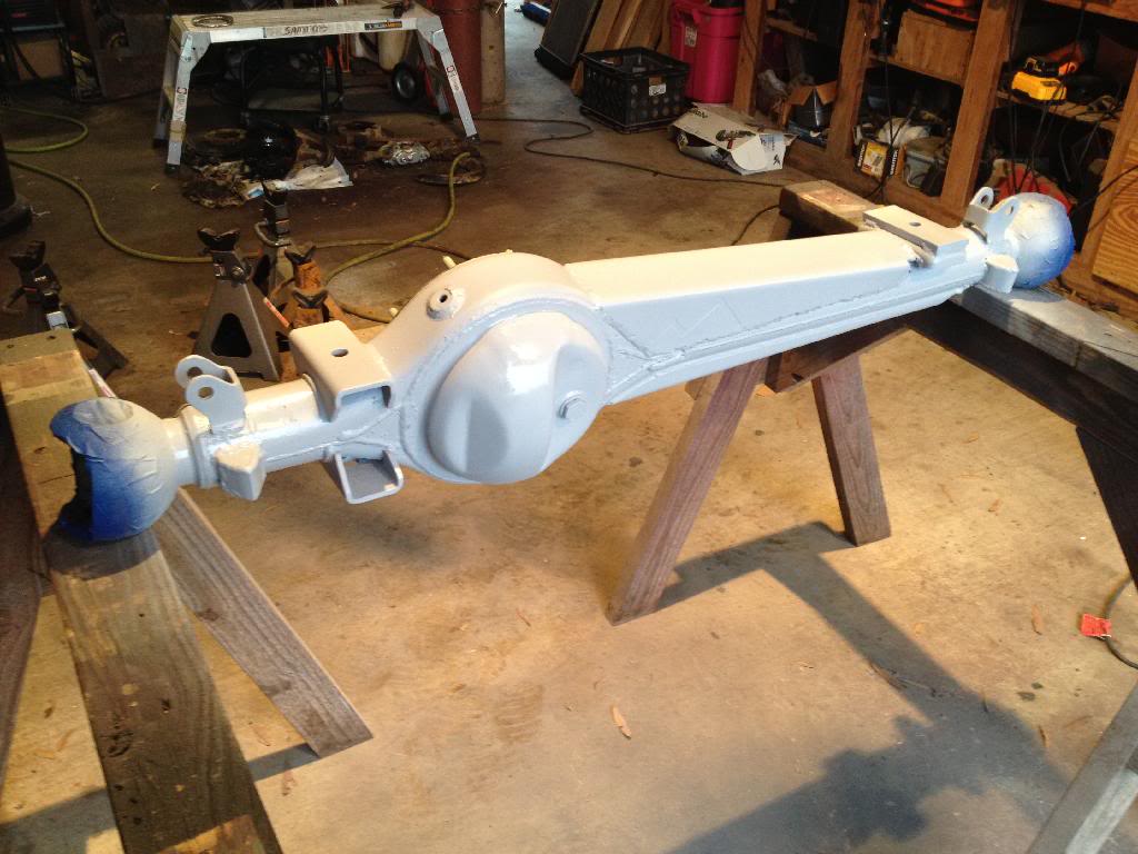

I also primered the axle

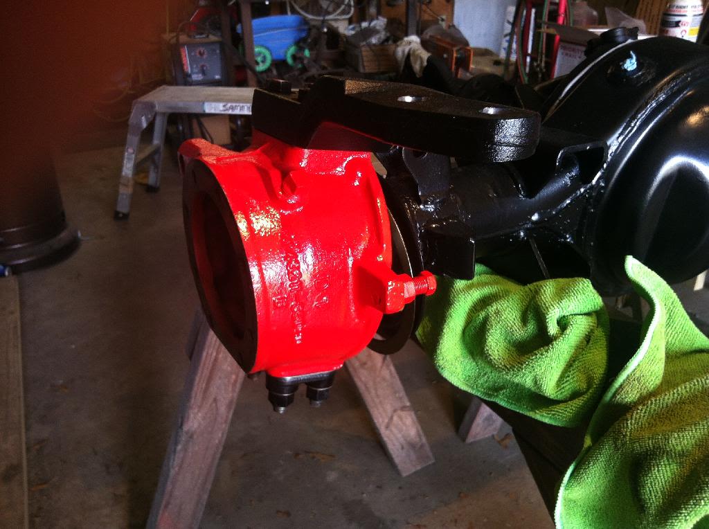

And I added some color (it looks orange, but its actually bright red)

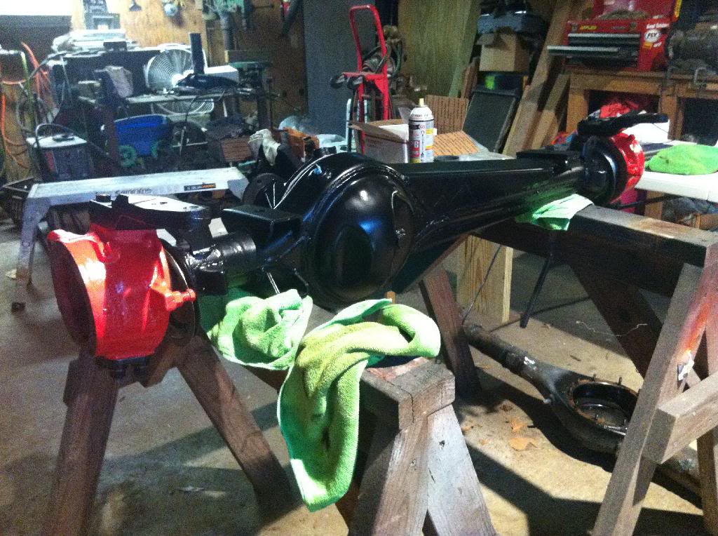

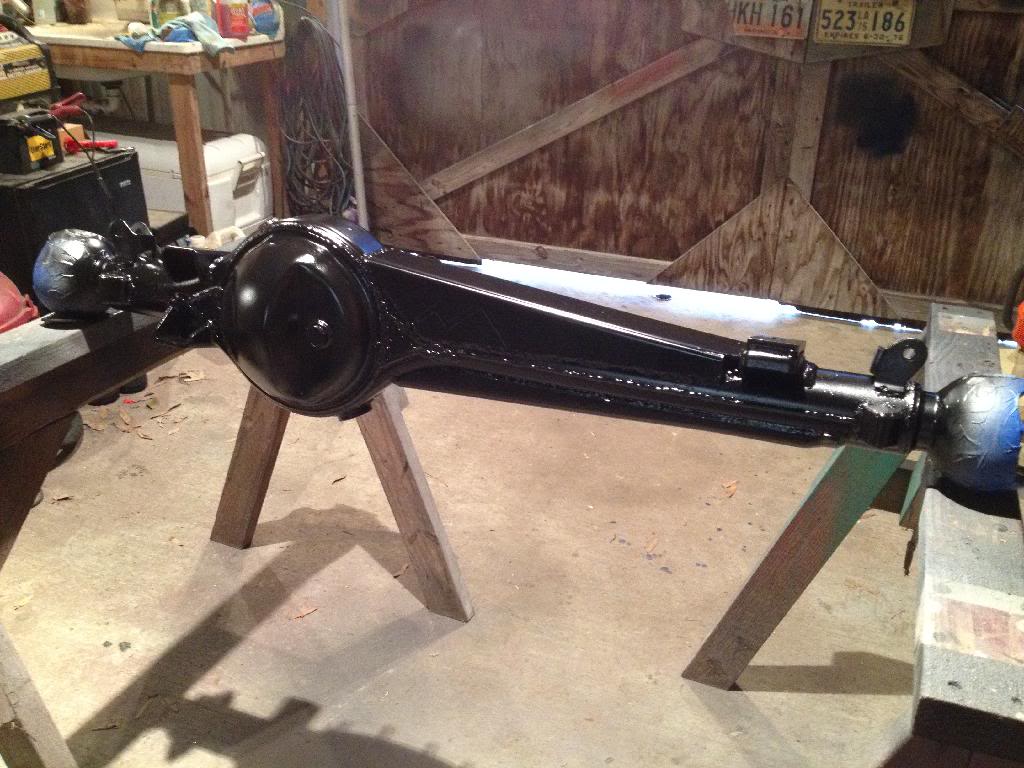

Well I managed to get some work done last week.
Finished painting the housing

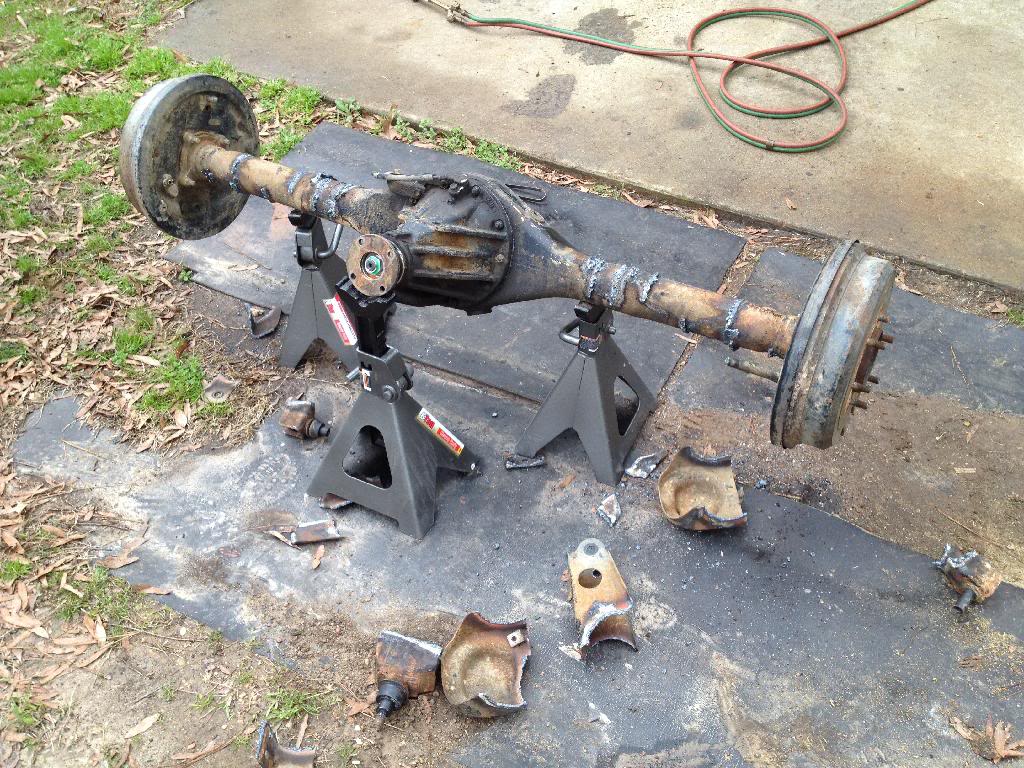

I made my first trip to a U-Pull-It Saturday and got this..

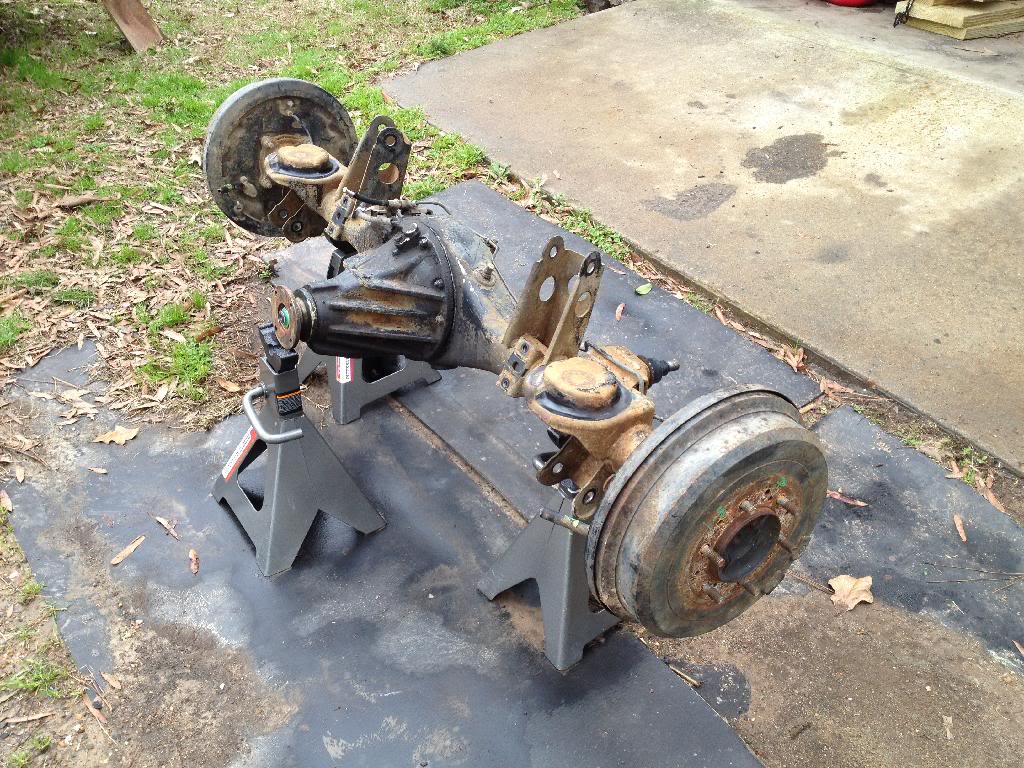

Its a rear end out of a 4runner with 4.88s. Now I need to find one more or order some 4.88 gears and regear a 3rd myself.
I cut the link brackets off (I did manage to nick the housing a couple times, nothing a welder cant fix tho.)

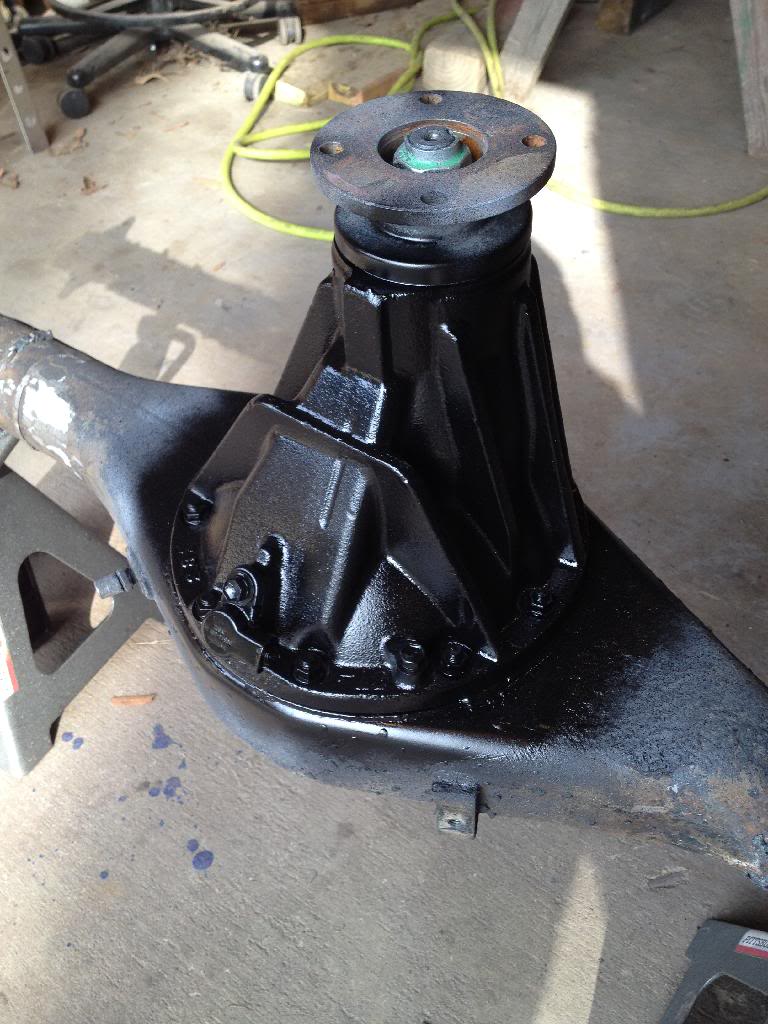

I then decided I would paint the 3rd in the housing so I could transfer it over to the front axle to finish it up. I will put another 4.88 in the rear axle after I find one or I regear one.

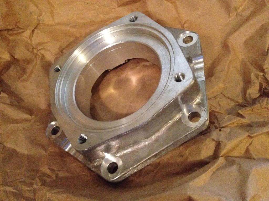

Not really an update but I did get in one of the adapters needed to go from the gm trans to the toy tcase. I also ordered a Spartan locker today. I'm only going to run one in the rear for now. I'll put one in the front later. I haven't been out in the shop any this week. It's been cold and we had an ice storm yesterday and had no power from the majority of the day.
Here's a pic of the adapter just so I can post a pic lol.

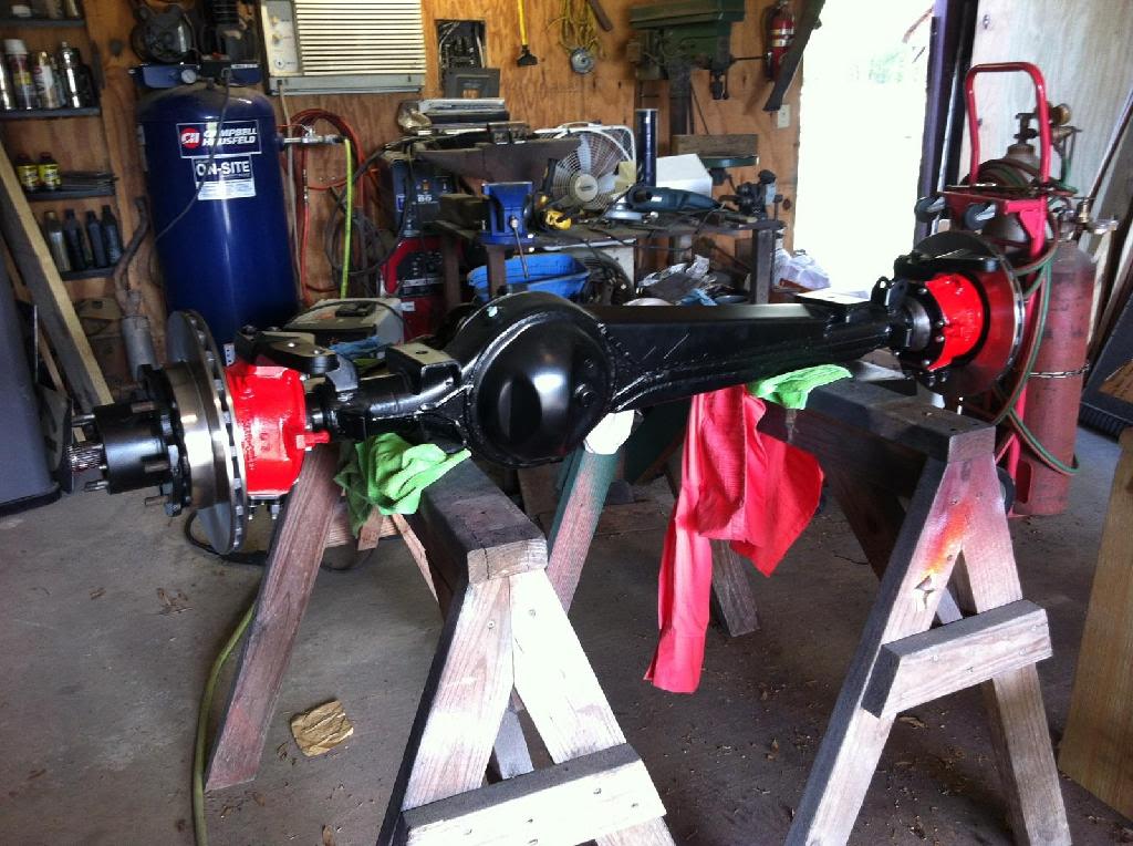

I have started to put the front axle back together. The 4.88 third is installed. I was setting up the knuckle shims yesterday evening and I got called back into work. Im going to try to do that today, but today is the first day my lil boy can ride his brand new pw50 after his heart surgery so I might be busy doing that lol.
Here is a couple pics of the axle as it sits right now.

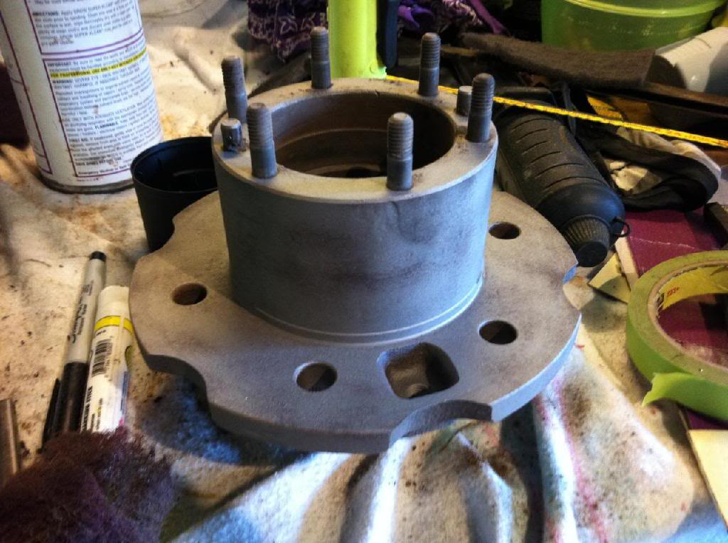

Well I was able to get the front axle done except for the locking hubs. They just need to be reassembled and installed. I had a small set back on Saturday. After installing the axles, I couldnt get the spindle to bolt up the knuckle. After both sides done the same thing and both had about the same gap, I figured out it must be the Martacks I did on the axle. I did the Martack with the original 4cyl 3rd member. So I pull the axle back out to check and sure enough, the Martack didnt allow the axle to go all the way in on the v6 3rd. So I had to do some adjusting, but I got it. I also finally set up my small blasting cabinet to blast my wheel hubs (Ive only had it for about 2 years now lol)
Heres a pic of the hub fresh out of the blasting cabinet
