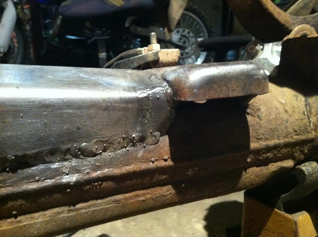

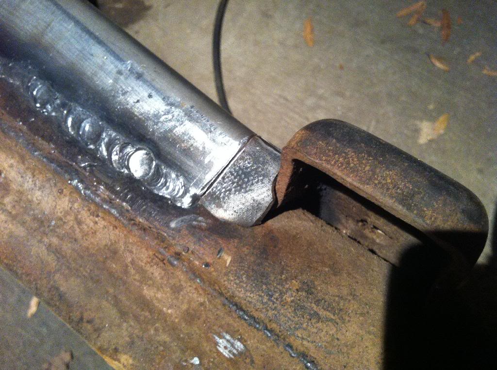

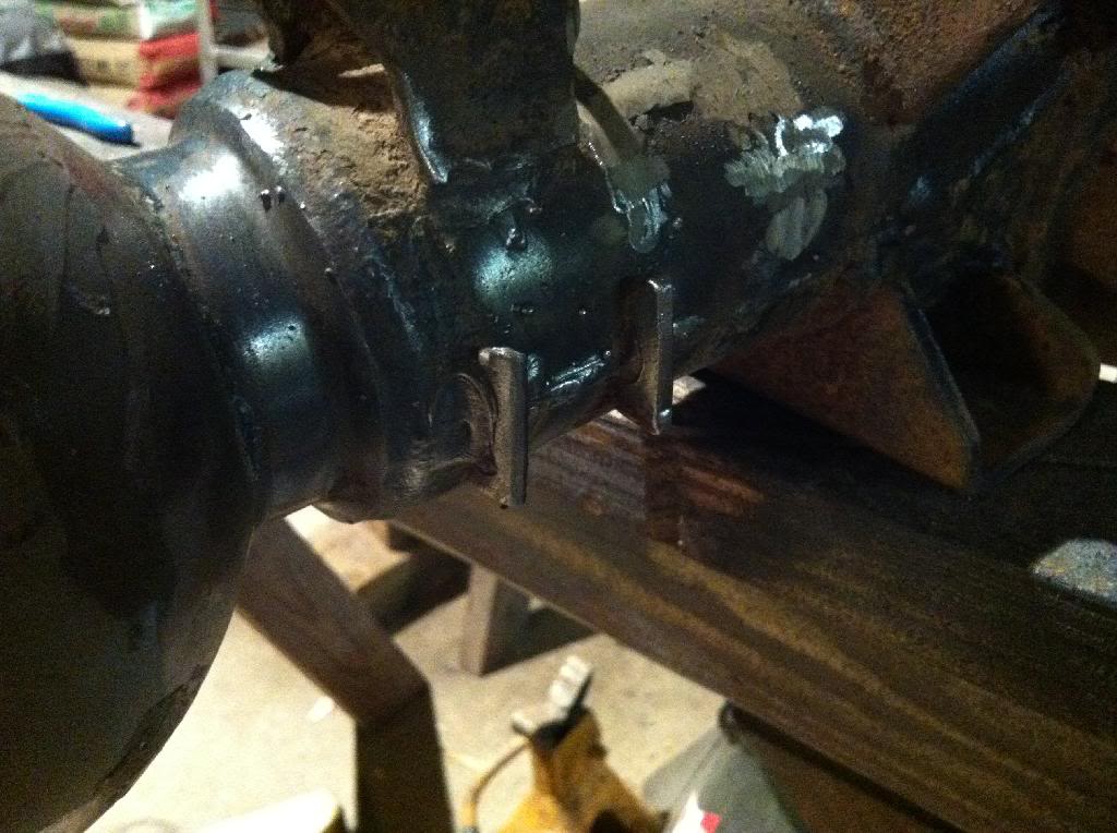

Not much of an update, but I did finish welding the truss on yesterday evening... ONE inch at a time lol. One thing I didnt like about the TG truss is it doesnt seal up on one of the corners. Since this will see some mud from time to time, I didnt want any openings to allow mud/water to get in there. So I made this little piece to seal it up.

Well I apparently didn't look hard enough at the ubolt location before adding that piece. I looked and didn't think it would hit but I was wrong. Looks like I'm gonna have to cut it out. Oh well lol.

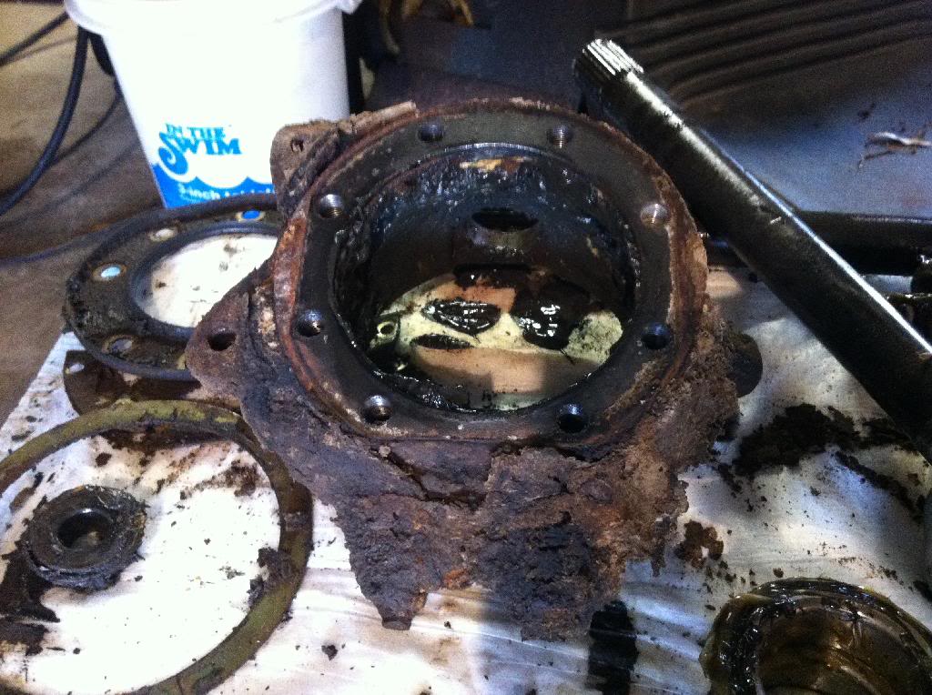

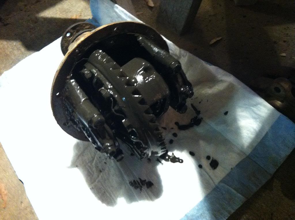

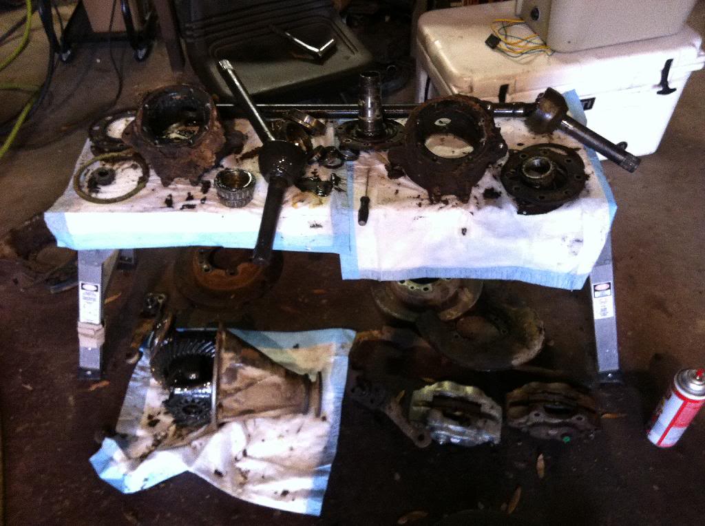

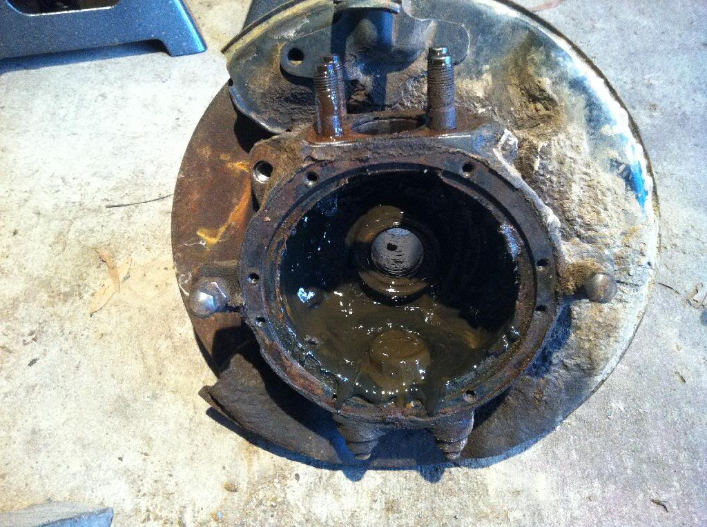

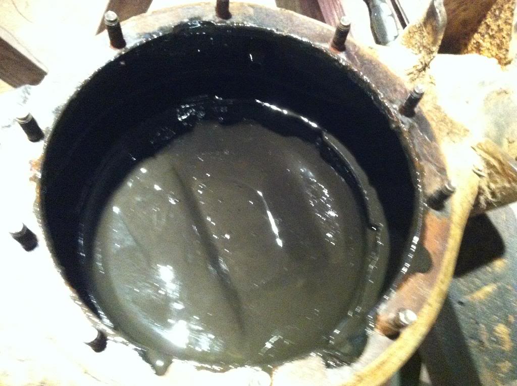

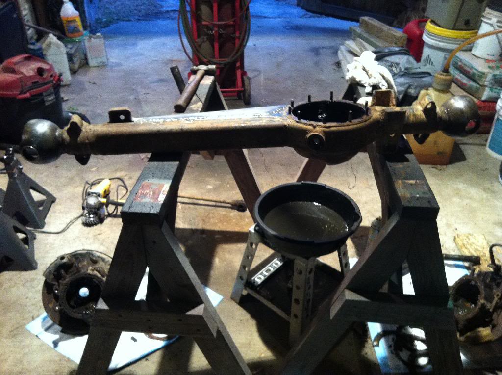

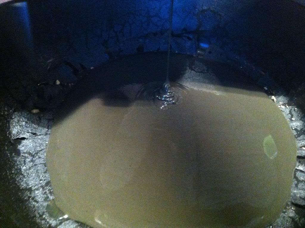

Since I like seeing pics in a build thread (even if everyone has seen this kind of stuff before), here are some pics of the axle tear down.
Now comes the fun part of cleaning all this stuff up and preping for paint and reassembly.

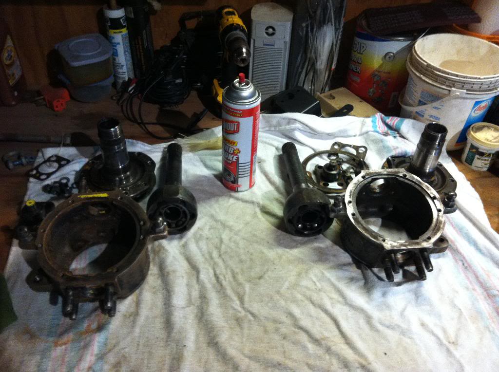

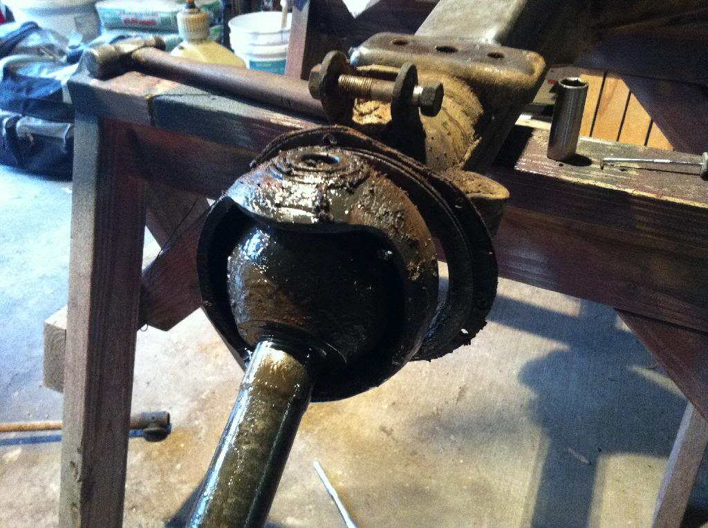

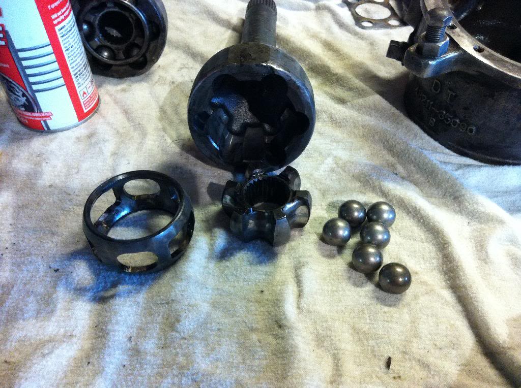

I got a little bit accomplished this weekend. I was waiting for my 54mm socket to come in to dissassemble the knuckles, but I decided to go ahead and use the hammer/punch trick and take them apart.
This is what I ended up with after dissassembly.

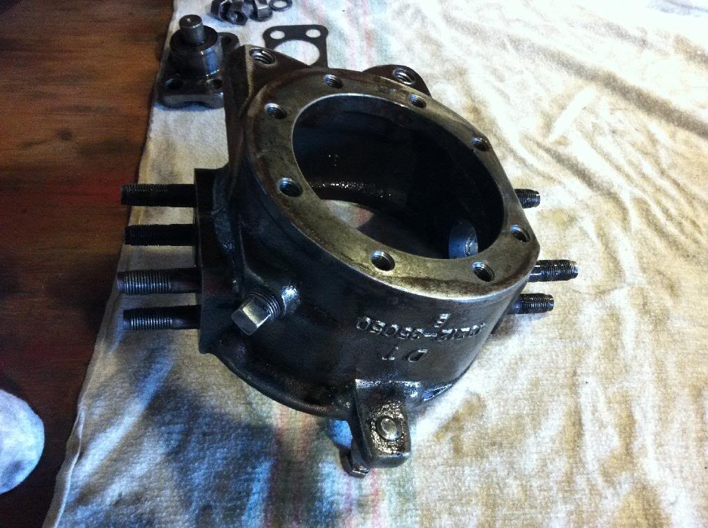

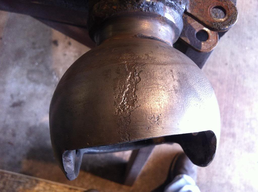

One of the knuckles cleaned, just needs paint now

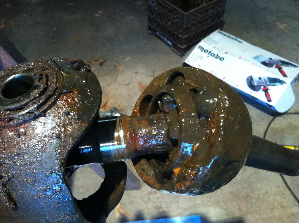

One of the birfields dissasembled and cleaned. Done them one at a time so I could make sure I put the cage back in correctly

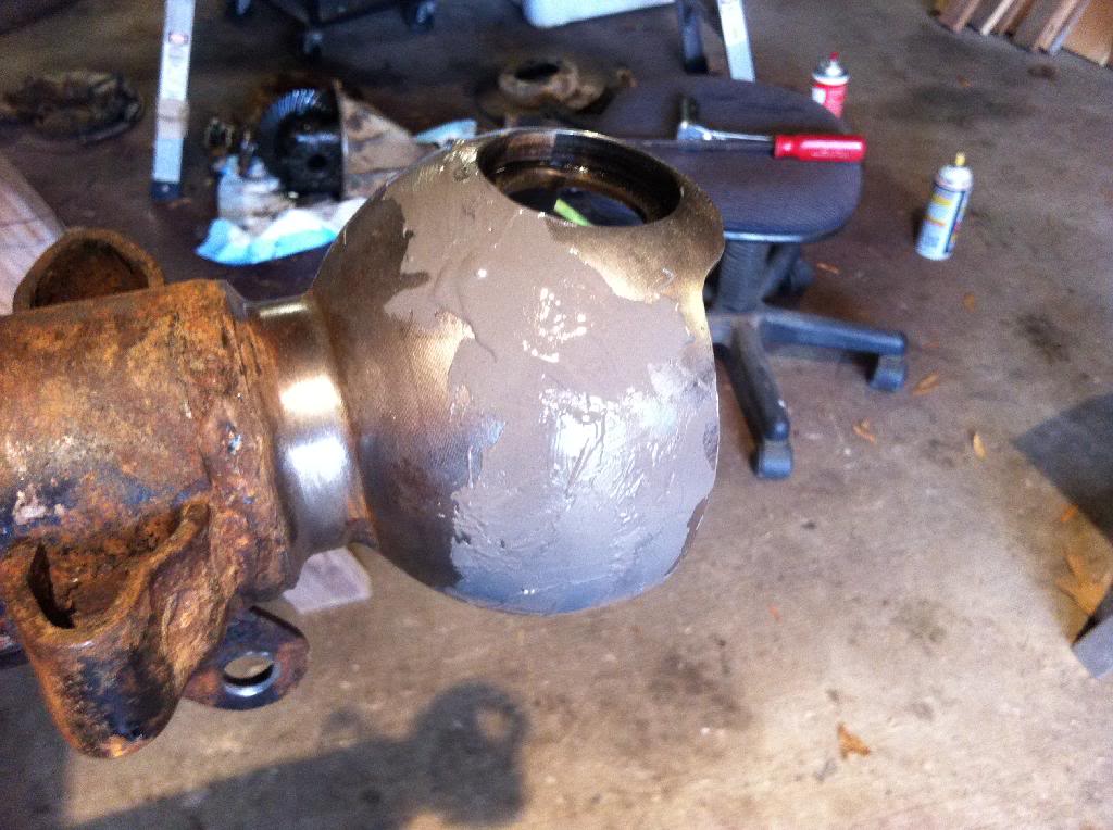

My knuckle balls had some pitting...
So some JB weld was needed
My first thought when I saw those pics. Tear down and clean looks good!

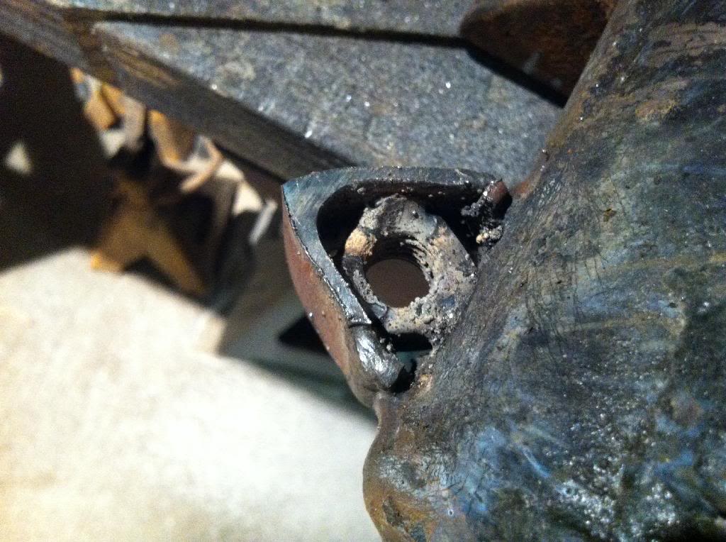

Not much progress has been made. Ive been busy with everything else. I did manage to rebuild 3 of the 4 steering stops. I cut off the majority of the original stop, bent some angle iron to the correct shape, and welded it up. I used some thinner metal than original due to thats what I had, so I also added in some nuts to give it some added strenght. I also will be capping the stops.

I also did some sanding on the JB Weld on the knuckle balls, but didnt take any pictures. I had to add some more JB Weld, so I will get some pics after I finish sanding.
