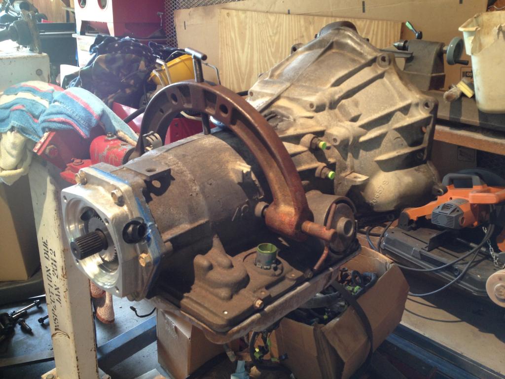

Yup. The computer needs the signal to shift the transmission. My VSS is in the AA adapter on the 4l60e.

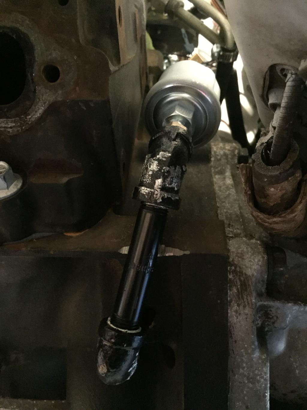

I also got the sending unit installed for the new oil pressure gauge. I had to do some plumbing to get it to clear the header. I think it turned out okay. It needs some touch up paint.

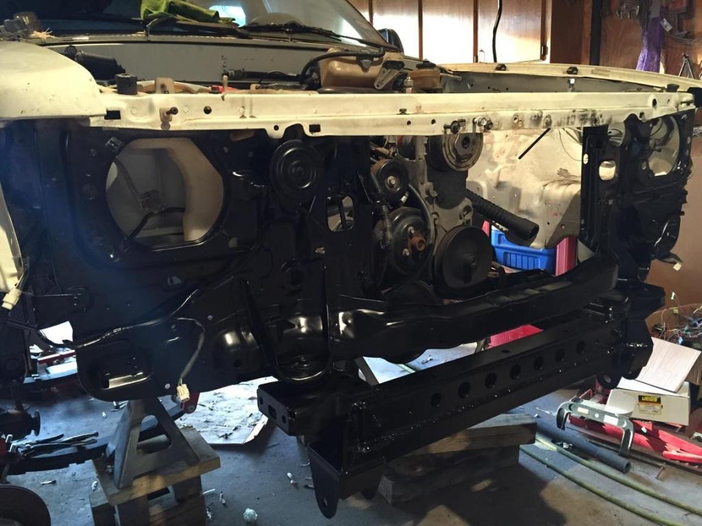

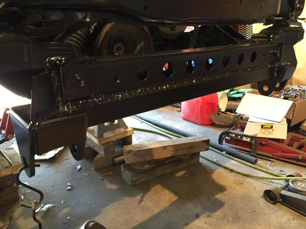

Well I finally took the time and welded up the front spring hanger. And I also did a little painting. Ready to start bolting stuff on for good.

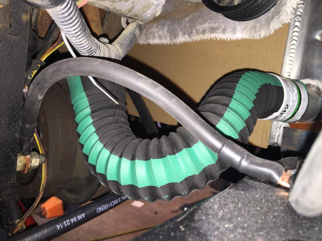

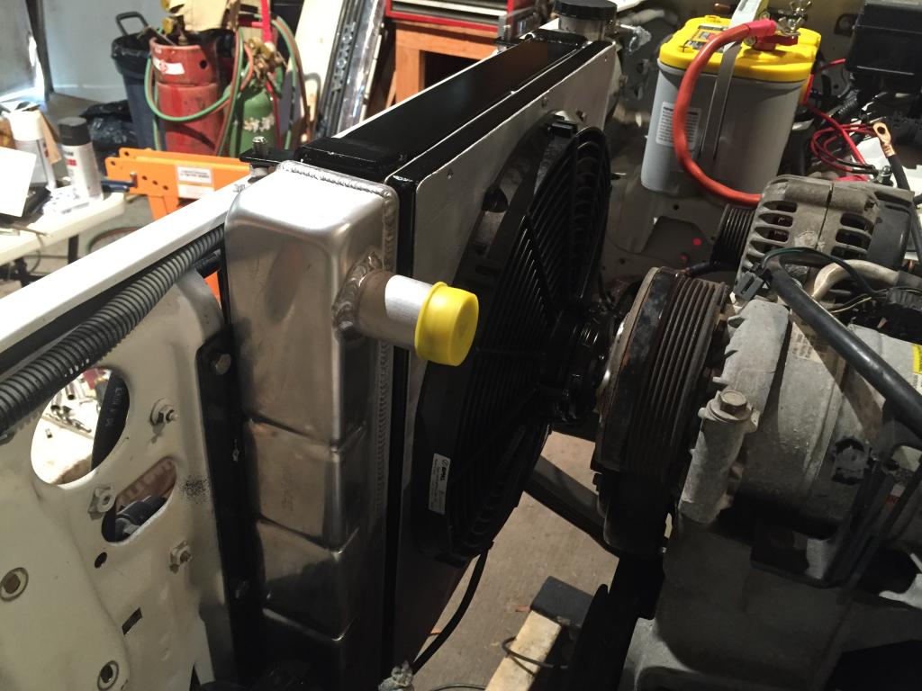

I picked up a longer radiator hose for the bottom and it seems like its going to work. The real test will be when I actually get to drive it. Hopefully it doesn't kink after getting hot.

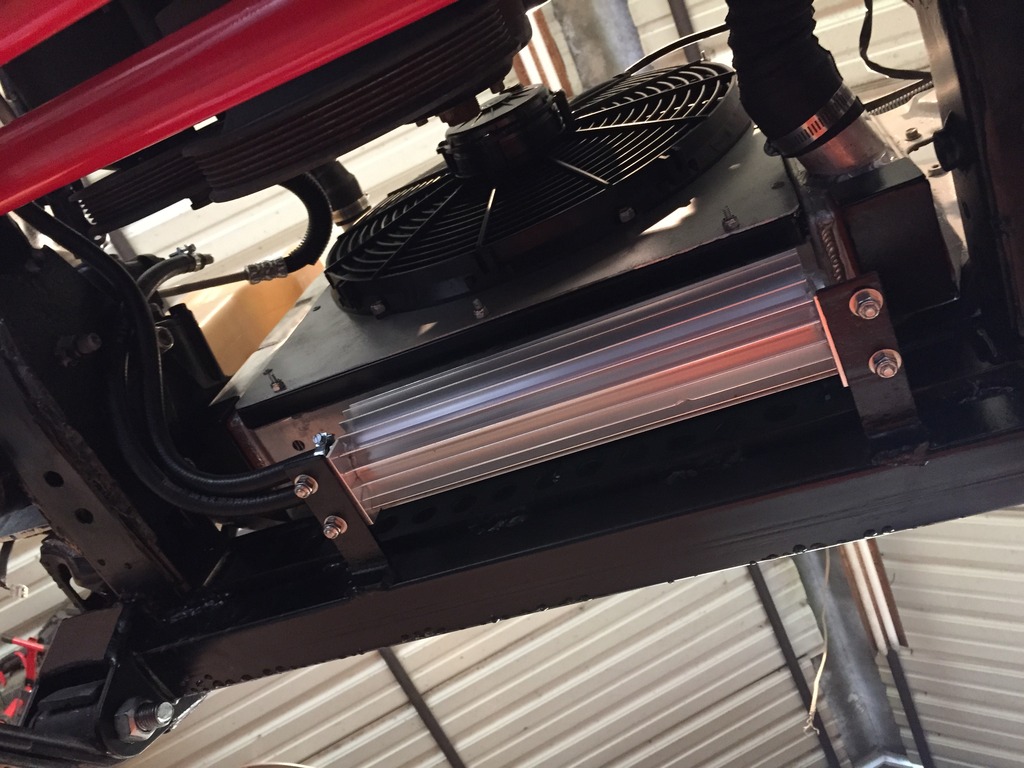

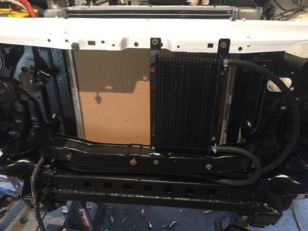

I got the transmission cooler installed.

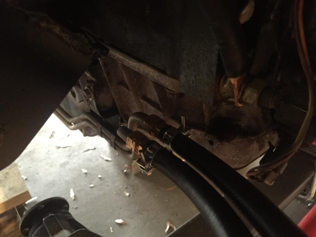

Heres where I tied the new rubber hose for the trans cooler into the factory hard lines

I spent a lot of time trying to figure out how I wanted to do the shroud, until a buddy showed me his on his buggy. Its a simple design. The frame is 3/4" thin wall square tubing with a sheet of aluminum covering it. It has a layer of weatherstrip foam to keep the square tubing from rubbing the radiator core.
I also installed the headers, did a little welding on the exhaust, wired in the OBDii port and the torque convertor relay. Im getting pretty close to running out of things to do before I fire this thing up. Unfortunately things are about to get really busy for me until the middle of march, so I probably wont make too good of progress until then.

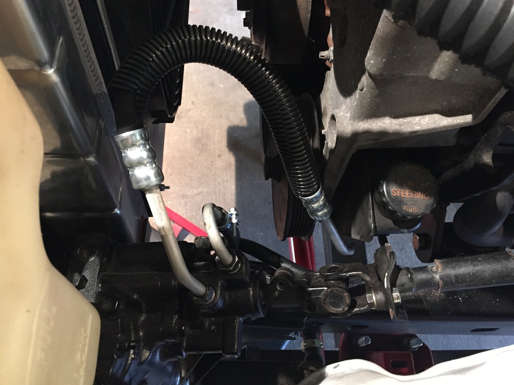

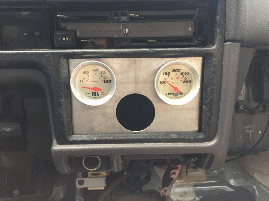

I finally made a little progress today. I build a panel for my new gauges. I'm still waiting for my trans temp gauge to come in, it's backordered. I won't be using a stereo head unit, just an amp and my phone or iPod.

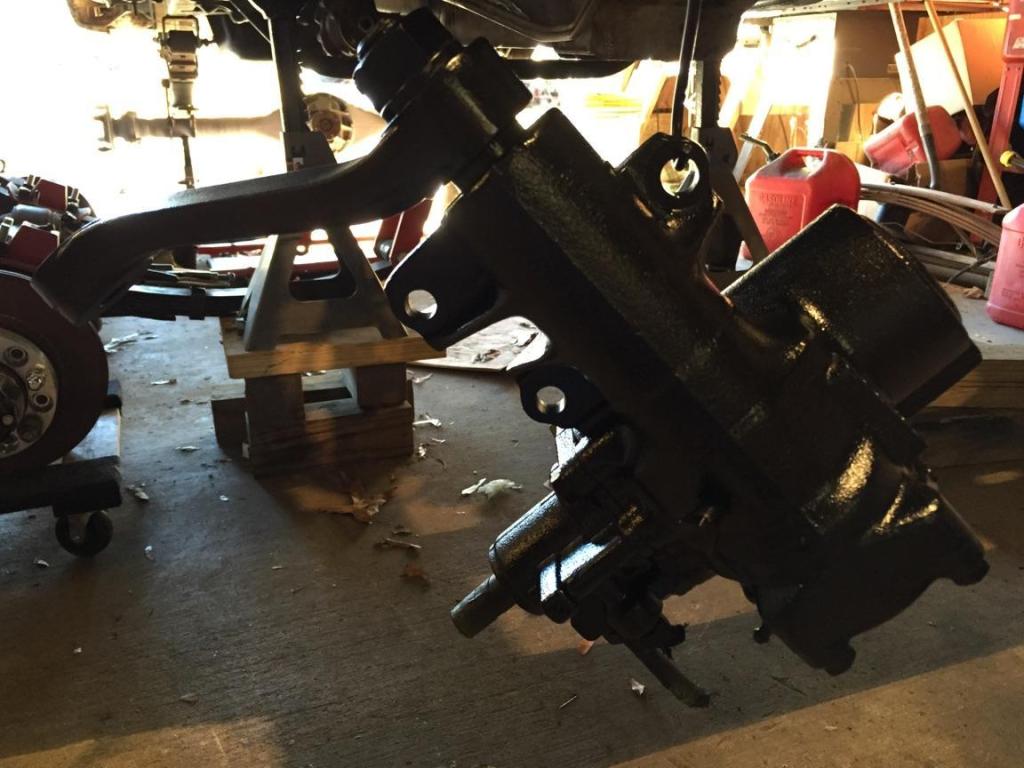

I also finished up the install on my steering cooler and the high pressure lines. I just bought a new GM hose and flared the toyota fitting on it.
