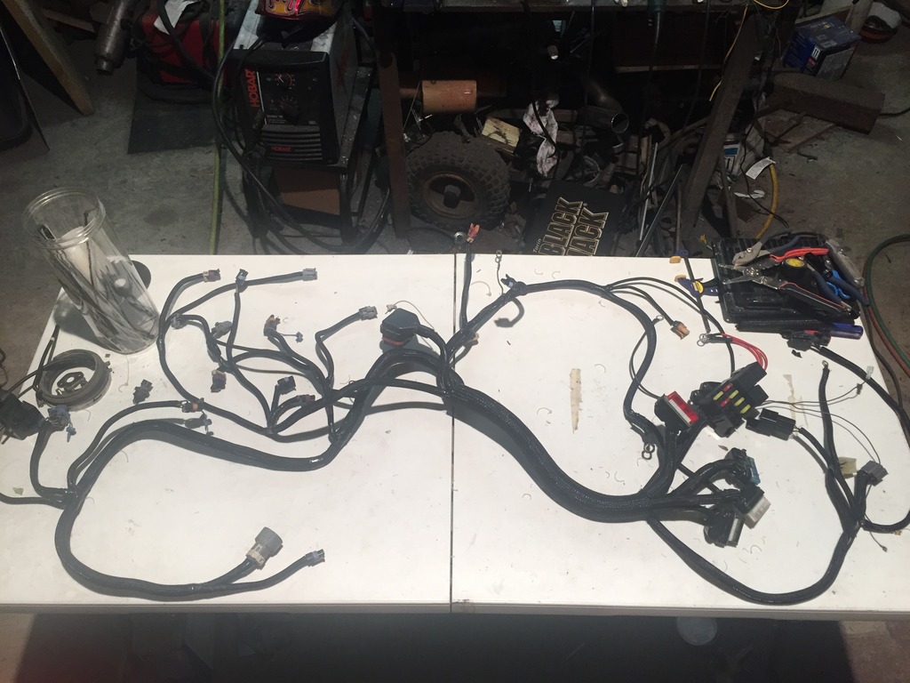

Well I managed to pull the wiring harness out and get the braided loom mostly installed. I need to pick up some more tape to finish it up.

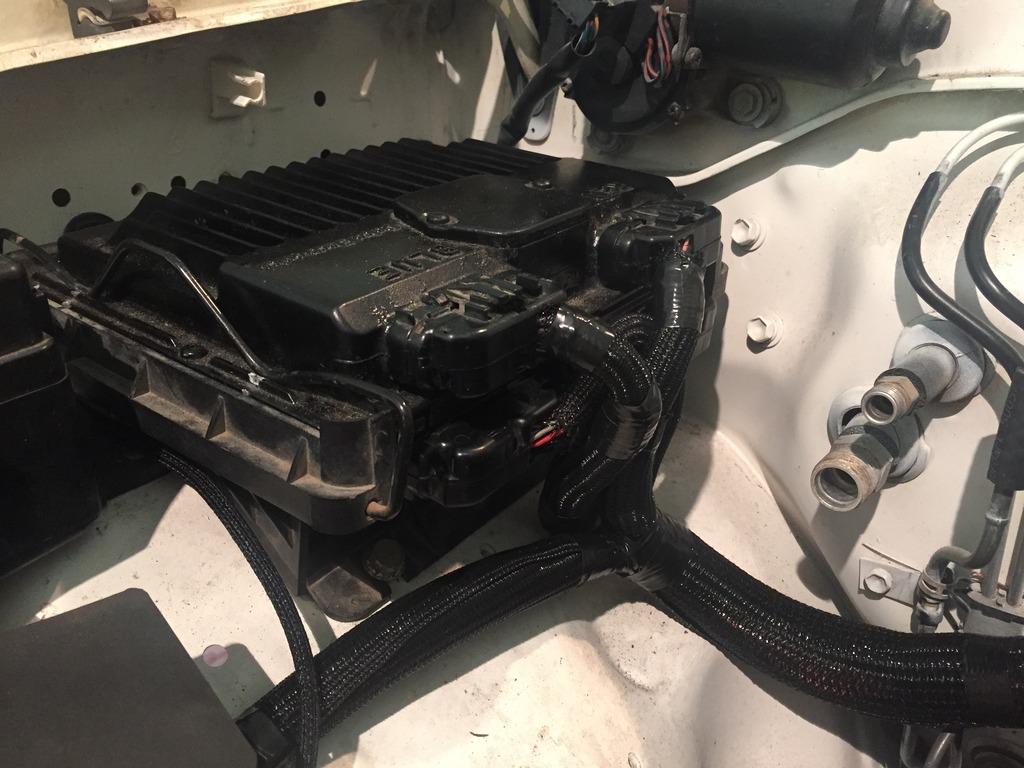

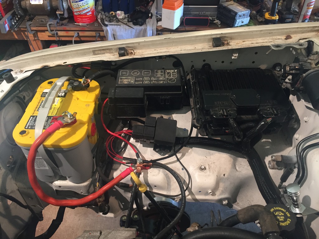

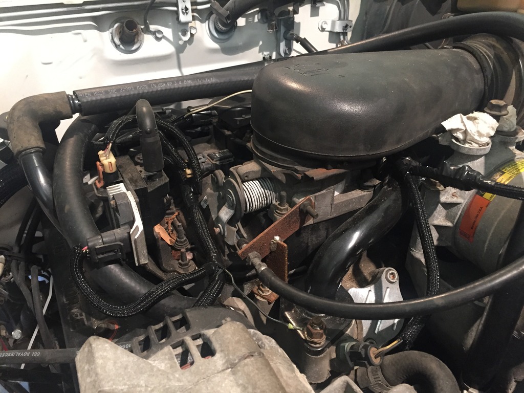

Here is a few pictures of the loom in the engine bay

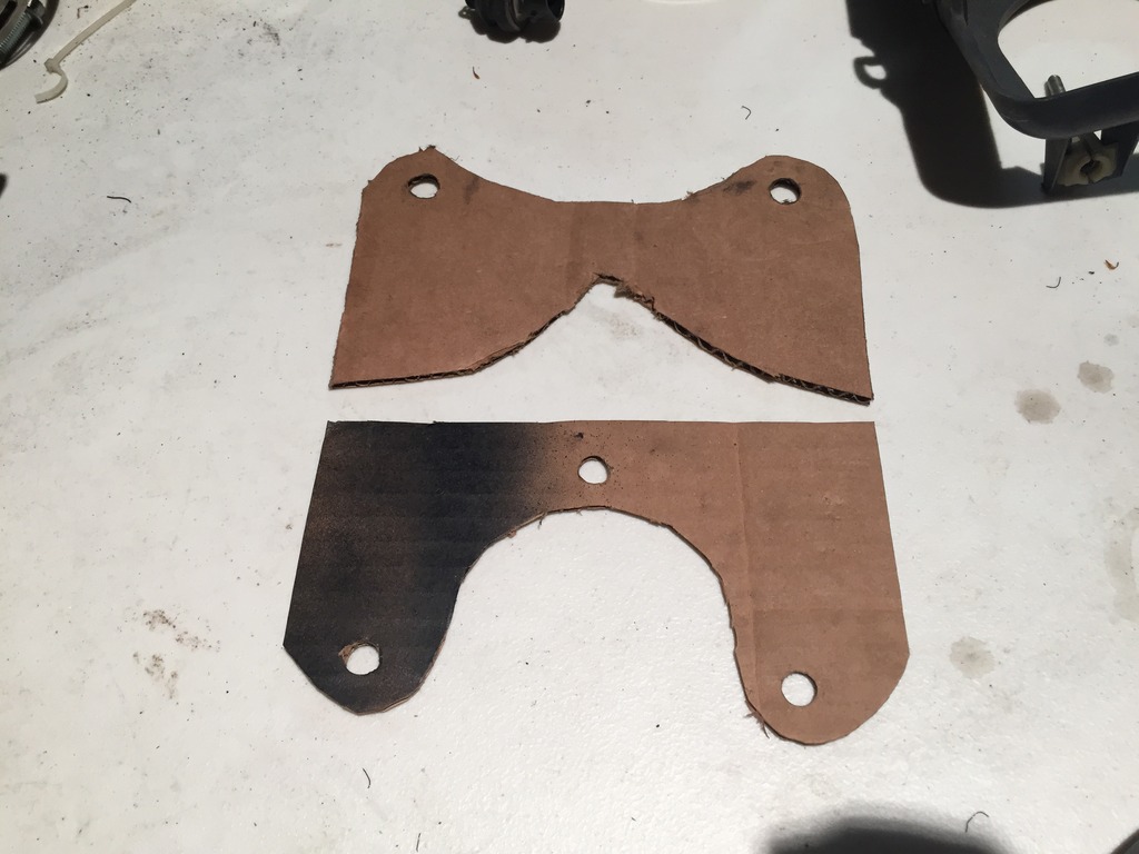

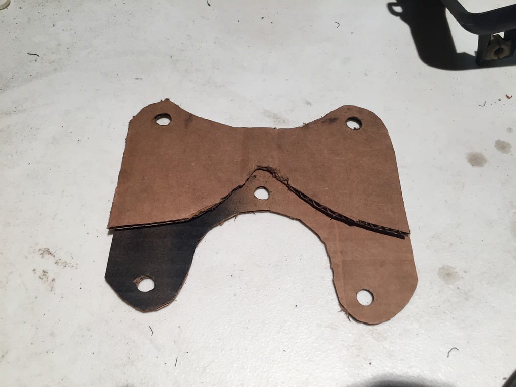

I made some rough templates (gonna tweak them a little when I cut them out) for the rear disk brake conversion. There needs to be an offset so I will weld the two piece together. I'm going to try to get them cut out tomorrow.

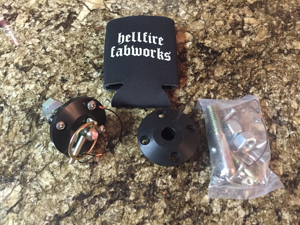

And then my hood pins came in today. I'm pretty excited about these for some reason.

Nice! That wire loom looks professional

^X2, the wire loom turned out really nice!
I like the security cable that came with your hood pins so that somebody can't jack them...wish mine would have came with those!
Thanks. I'm guessing you mean the loom itself and not the job I did putting it on lol. That was my first time looming a complete harness. It wasn't too bad but I think I probably could do it a little better next time.

Thanks. Yea I like the cable too. I think it would be easy to add tho. I dont think it will stop kids from pulling the pins off but hopefully they don't cut or try to jerk them off lol. I'll still keep a few spares handy lol

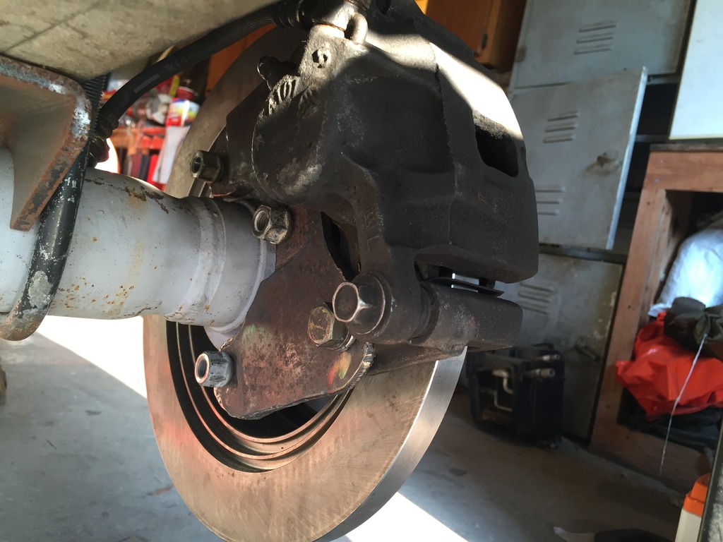

I cut out the rear disk brake brackets out of 1/4" plate. That didn't provide enough offset to center up the calipers without shimming, so I will be cutting some of the brackets out of 3/8". That should eliminate any need to shim. Hopefully get those cut out today and start mocking them back up for welding.

Heres the test fit of the passenger side caliper after welding the bracket up.

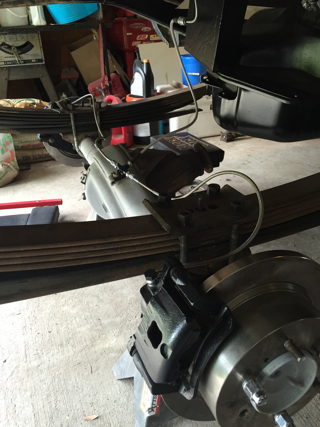

Here's s pic of my rear brake lines. Still need to secure the lines but that won't take long.

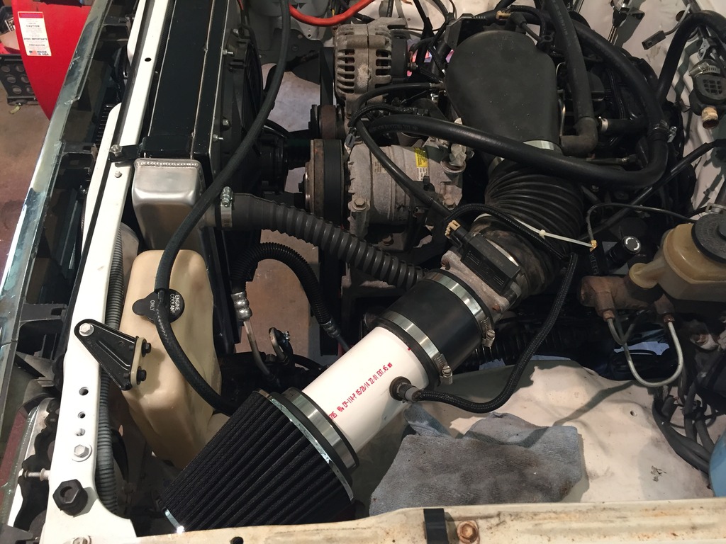

I mocked up my intake. Good ol 3" pvc. I painted it black tho lol. I just need to build a support bracket for it.

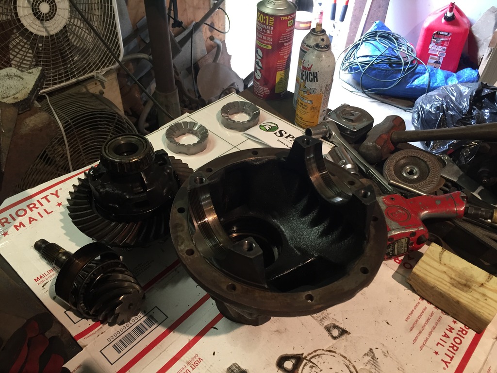

I also started the tear down of the rear third member. Didn't get too far but it's a start.
