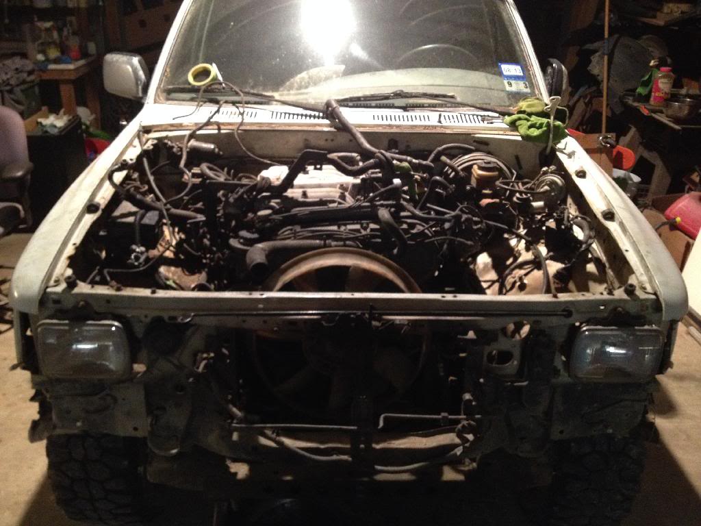

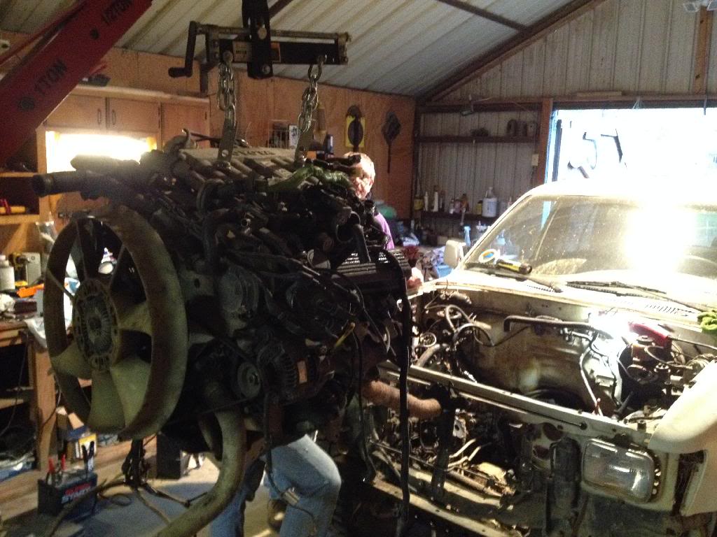

Well the tear down of the 4runner has begun. I cleaned the shop up a little yesterday and pulled it in. I think I only have the bell housing bolts and starter left to pull before the motor will come out. I didnt take many pictures, but here is what I have.
The last pic of a complete running 3.0 in this 4runner
Heres were we stopped.
Im so glad I dont have to worry about hooking all those vacuum lines back up. It was nice to just pull them loose and not worry about them lol.

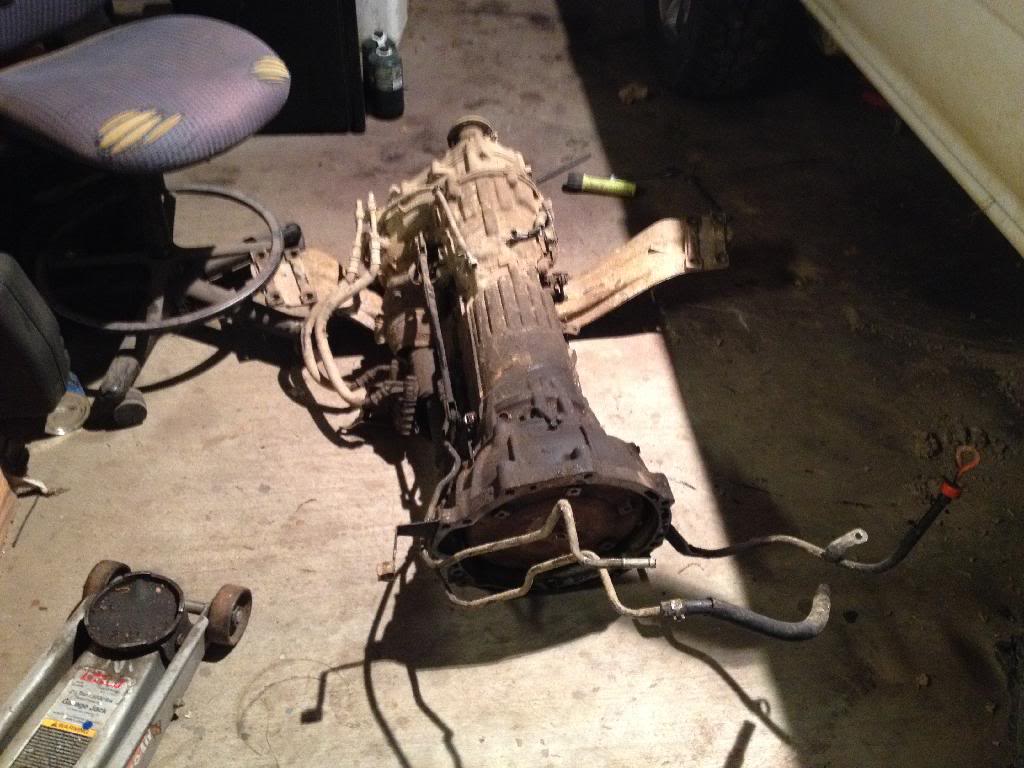

Well I had another successful night in the shop.
The motor/trans/tcase is finally out. My next move is to clean up the 4runner and then start of the suspension swap.

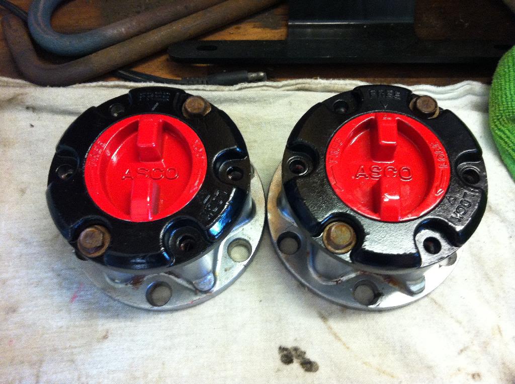

I dont really have much to update, but I did at least get my locking hubs rebuilt. Just need to install them. Other than that, Ive just been doing some studying of the 3.0 wiring to see what I need to cut out of the motor harness and cleaning up the 4runner a little.
My plan to is to some more this evening after work. I MAY pull the 4runner back into the shop this weekend and start on the SAS.
Heres a pic of the hubs for those interested, I plan to get some stainless bolts for the hub face...

ASCO! Old school hubs! Nice!
Yup. My axle only had one hub on it when I got it and the inner hub gear was broke in some areas where the clip holds it on. So i got these from a axle my buddy picked up. I almost painted them back to the original blue, but decided to keep with my red theme lol.

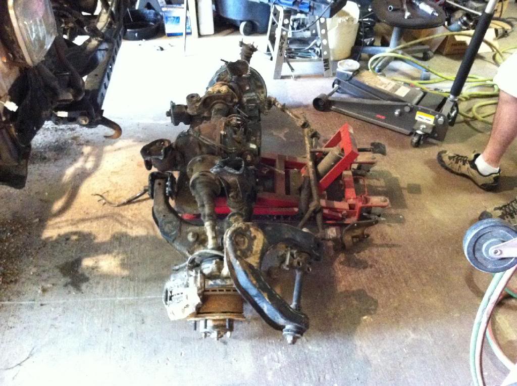

Well I didnt get everything done, but here is a pic of what happened...
The IFS fell out lol. I still have the frame to clean up tho. Also here is pic of the clean 4runner right before surgery.

Nice!! IFS fell out hahahaha.. Cant wait to see this with the SAS done!

It did fall out, but it was assisted by Victor (the torch) and a BFH lol. Im definitly ready to see this thing sitting on the front axle. I ordered the SAS kit back in October. Ive had it way too long lol.

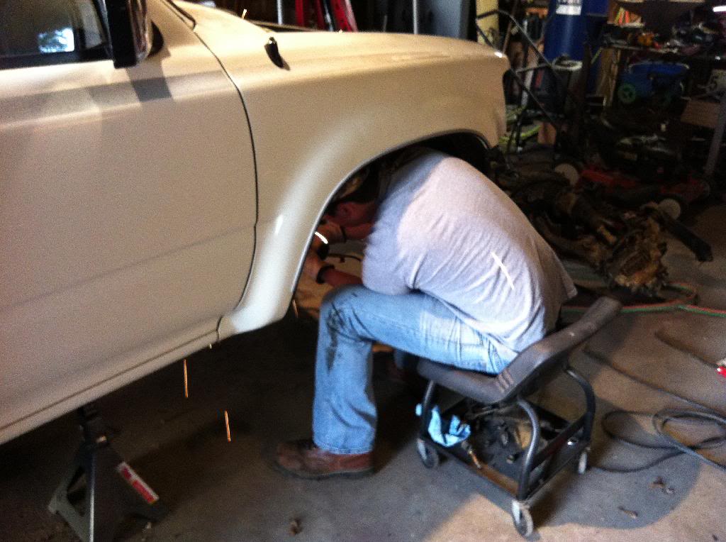

Well me and a buddy went at the front frame rails last night. We got the passenger side about 95% done. The driver side still needs alot. I ran out of acetylene on my torch so I could finish torching the brackets off that side. This part of the build sucks lol. Im glad I have the motor out so I can clean all the brackets off at one time tho. I doubt I have time to do anything this evening, but Ill be back on it Thursday evening. Hope to get this part done lol.
Here is a picture of my buddy grinding on the passenger side

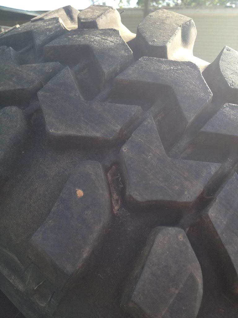

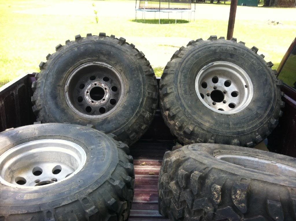

I did pick up something for the 4r today... TIRES!!! I picked up a set of like new 36x12.5x15 TSL Super Swampers. I wasn't looking to spend the money right now but it was a really good deal that a friend posted on Facebook this morning, so I jumped on them. The wheels aren't right bolt pattern but they should sell easy and for more than enough to buy some steel wheels. Here are a couple pics.
Hopefully I'll have something good to report.

Making good progress!! The grind in and cutting of the ifs is the worst of it. I recommend using a hole saw to cut out the holes for the frame tubes. I just used those on the SAS I'm doing for a friend. Made life a lot easier.
That's a nice score on the tires. I love deals like that. Especially when you can sell the rims to offset the cost of another rim purchase.

Yea the grinding sucks lol. I was planning to do the rear suspension next, but now I'm gonna start on the motor swap next lol. I was planning on torching the holes. If I have the right size hole saw I will try it.

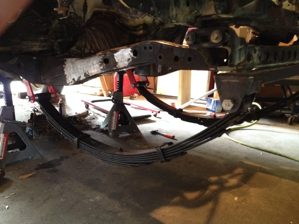

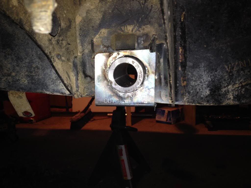

Well I got the frame rails cleaned up and then...
The springs are hung. I used a piece of 1" EMT to square the frame tubes with one another and get the in the right spot. It's slow progress but it's progress lol.
