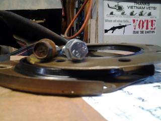

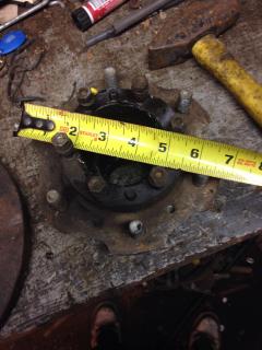

So the pics are of the Tacoma brake plates from fror, and the outer seal that I trimmed compared to the stock one and the stock bolts compared to the longer kit bolts,also I massaged my ifs hubs for the Tacoma rotors fit.6.680 inches courtesy of my metabo and a cutting and grinding wheel.

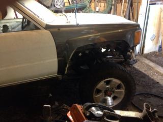

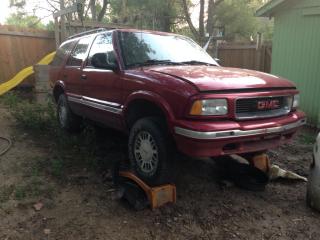

First pics the donor for the engine swap,I finished the hubs and brakes minus the brake lines. I have some 17s off a newer runner on 285s,it could easily take 35s,it also looks like I might have my front spring hangar a lil forward more than I thought.shackle angles look good and it looks like its setting nice and straight(other than an alignment).by the way ifs hubs don't fit in straight axles...DUH.
