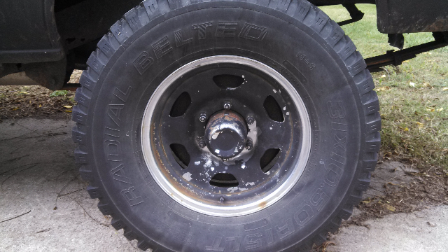

I had rust holes in 3 of the wheel wells. And the 33s definitely won't rub now. Lol. Probably could fit 35s now. Lol
Okay, so thats the clearance you have with 33"s right?(you can just see the fender edges in the pic). 35"s would fit yes, but you couldn't hit a mole hill let alone flex. Atleast from what i can see, but you know your truck and i'm sure it will turn out awesome whatever you do.
Old Sep 28, 2013 | 12:47 PM
  #191
bone collector's Avatar
Joined: Nov 2009
Posts: 2,025
Likes: 40
From: Northen Indiana
That picture is the rims I cleaned up to put my truck. The truck on the picture is my old 87. Those tires are 31s.

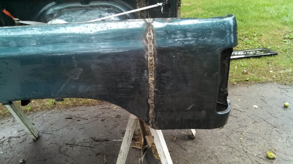

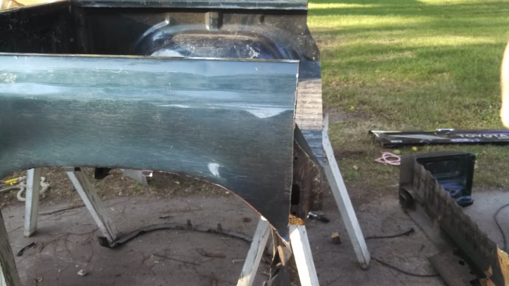

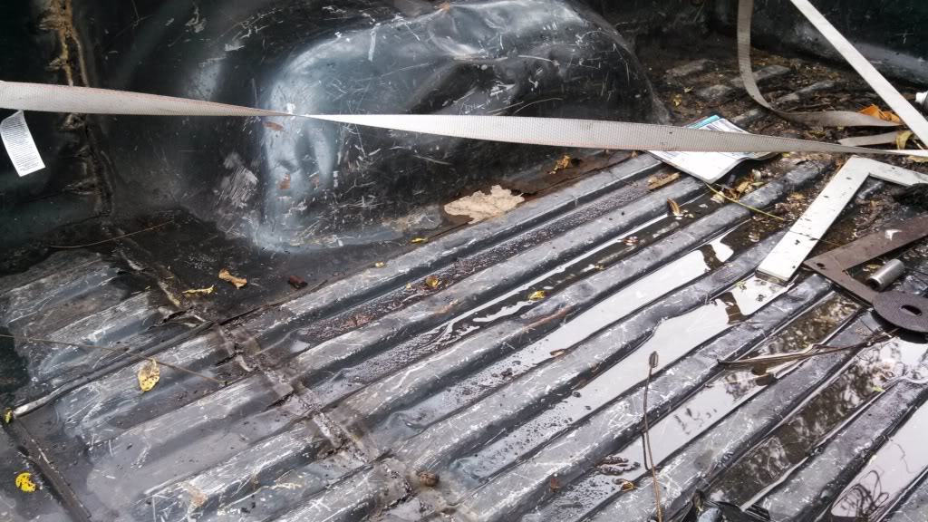

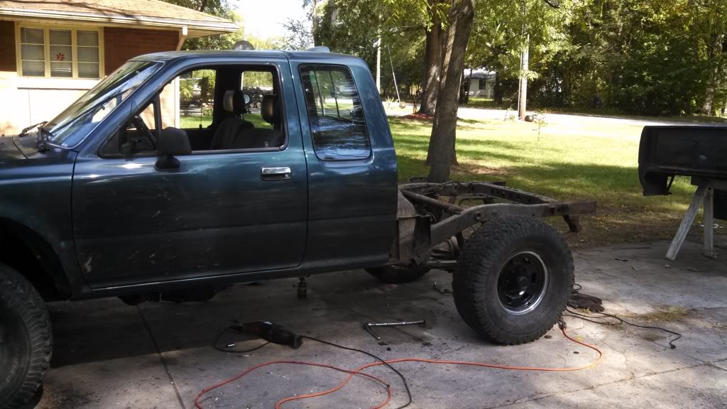

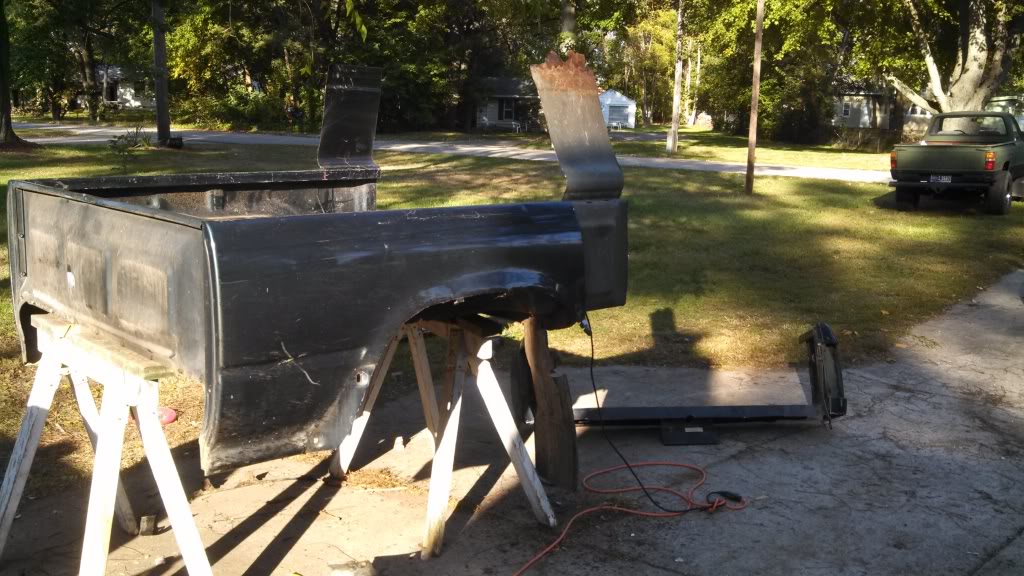

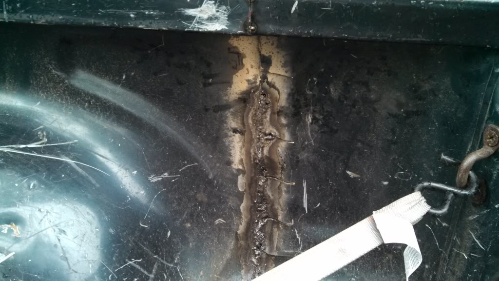

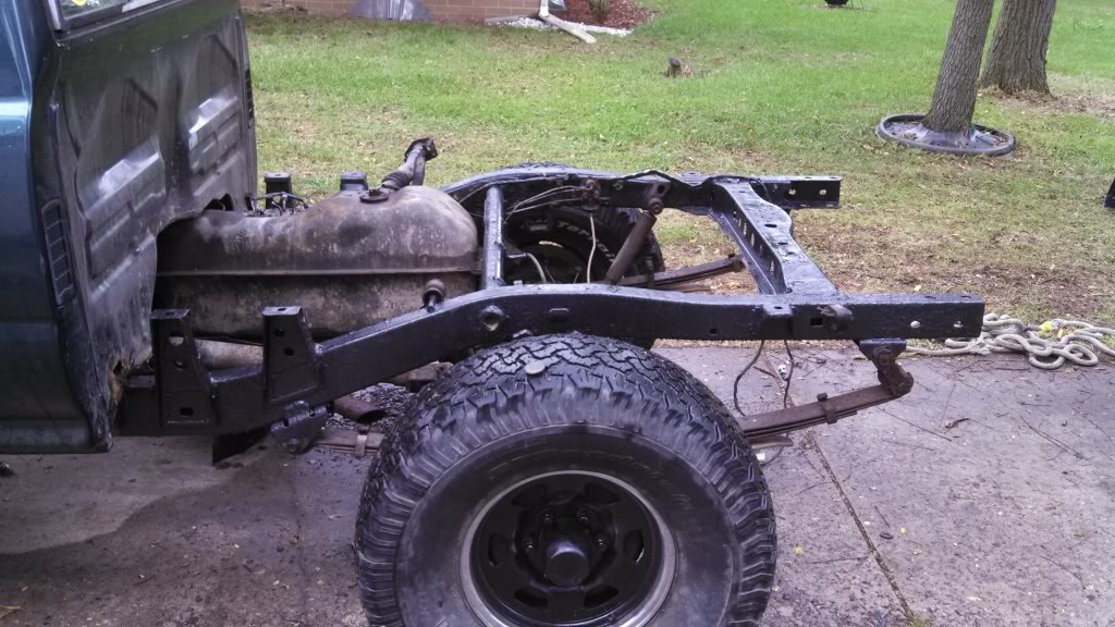

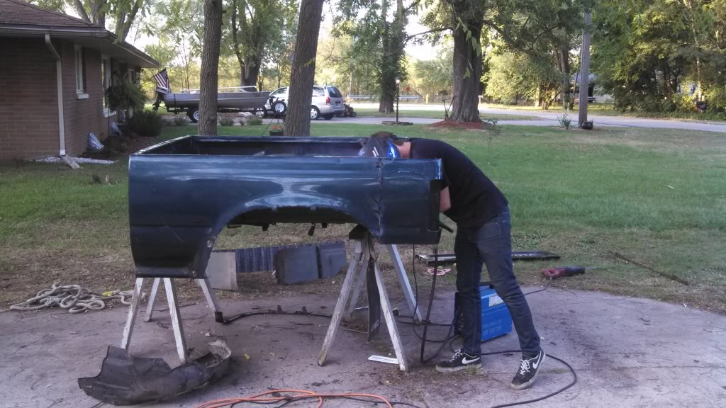

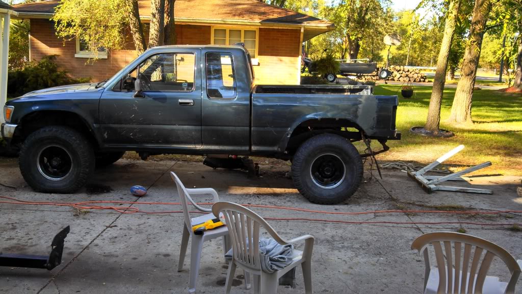

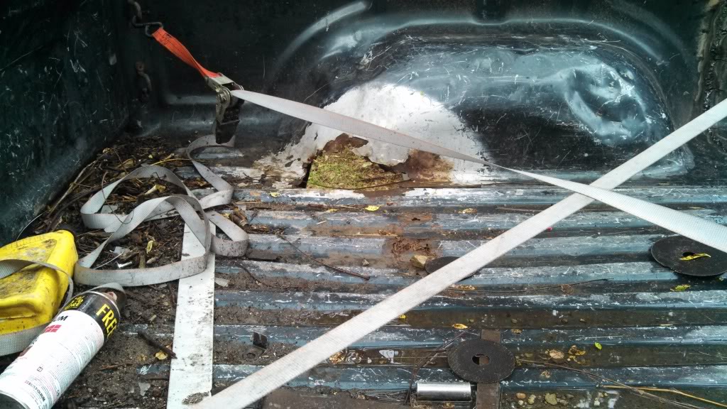

Well I have a lot done. But a lot more to go. All of the fenders have been trimmed 2 n half inches. I cut 2 inches off then " rolled" the last half inch. I cut 12 inches out of the bed and it's welded back together. A friend of mine came to help with the welding duties. We also scrubbed the frame down and painted it with bed liner. Tomorrow I will grind down the welds, put on some bondo and reassemble the truck. I will also cut and patch the 2 big holes that are in the bed. If I have time, I will apply a layer of bed liner to the bed to help preserve the bed for the long term. Lots to do!

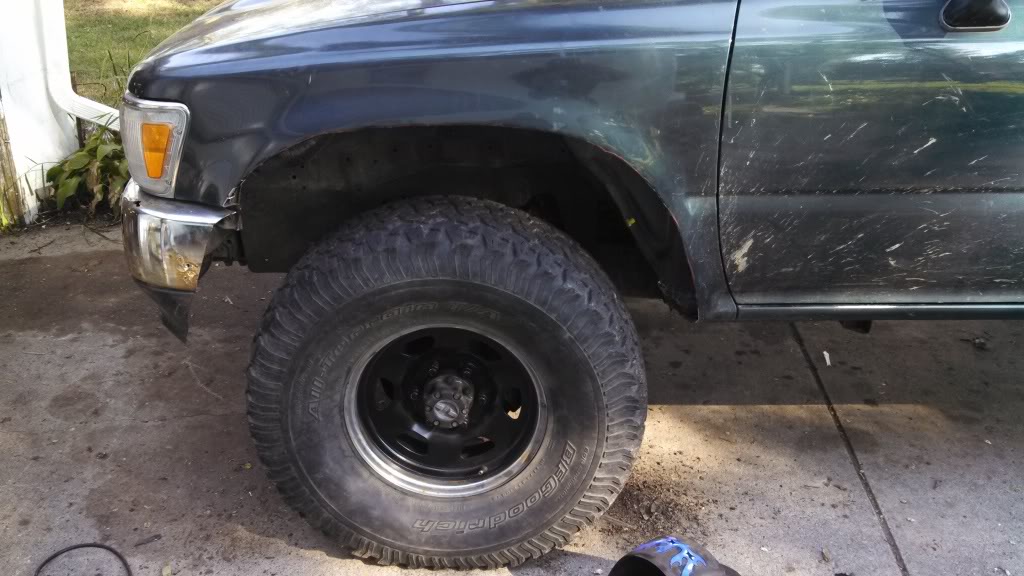

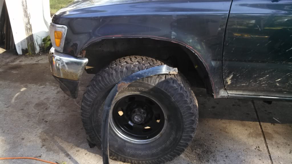

I realized where i was misunderstanding you, i read bob and 2 inches out of fenderwells. I thought you were narrowing not extending... derp.

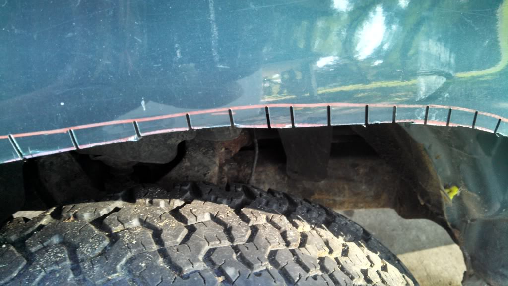

What you did looks solid, how did you roll the edge?

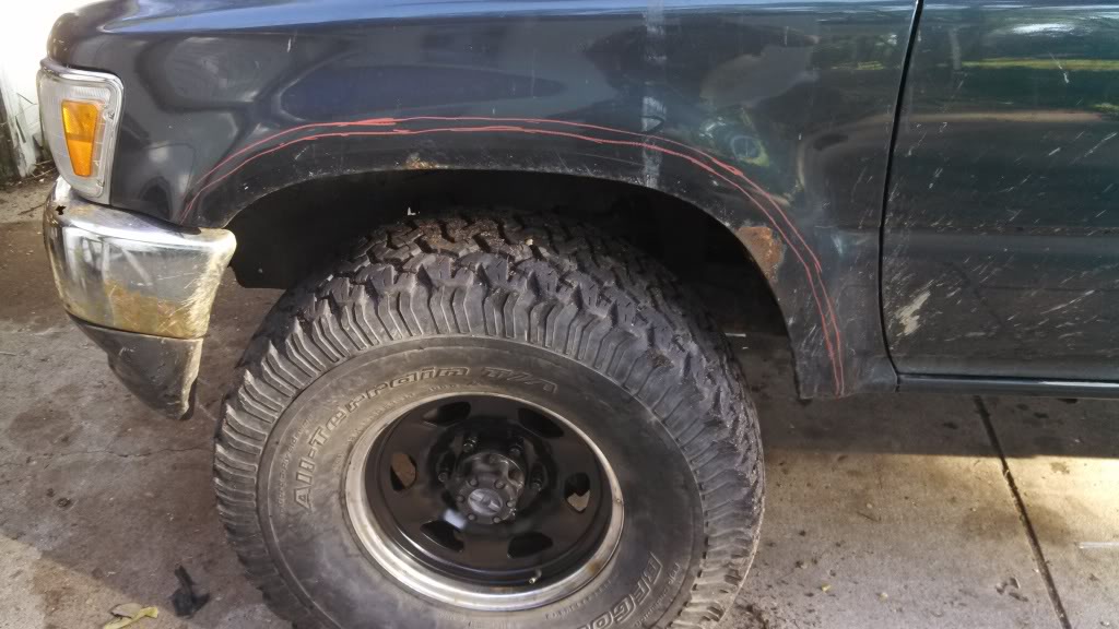

Mark fenders at 2 and 2 n half inches
Cut off first mark
Cut many vertical cuts up to second line
Fold over tabs and tap with a hammer to smooth it out. Trim bumper and valance to match

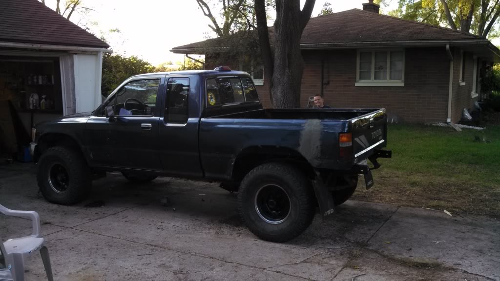

And done for now!

I still have to do the bed liner and sand down the bondo. But for now I am done. I am exhausted. I will try to finish it up by next weekend
