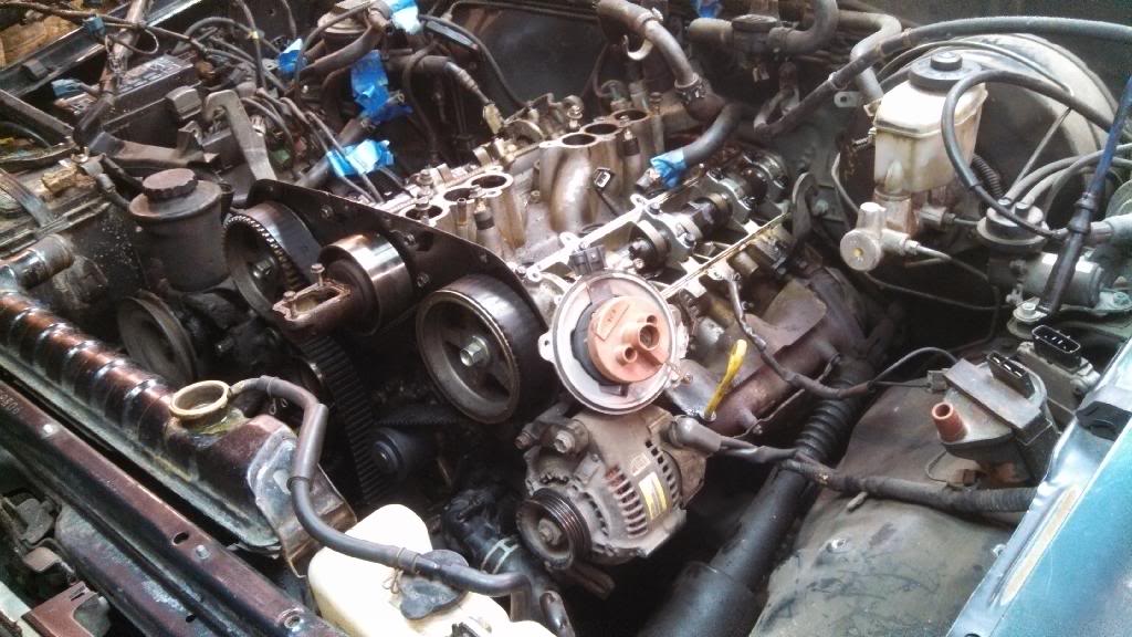

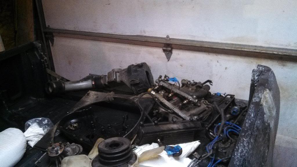

Well, I finally got the cruiser in running order. I still need to burp the cooling sytem on it but it is running and driving, with no leaks....
It took longer than expected ( as usual ) because my wife needed to do some shopping and running around while grandma had the kids. Oh well, it was a fun lunch date.
I finally started to tear it to my truck around 4:30 - 5 o clock. I got the upper intake off, timing cover and the fuel rail. I have a Toyota mechanic buddy coming over to help out for a bit, since he missed all the fun last weekend. he should be a big help.
I soaked everything down with PB blaster before I called it a night.
here is the current state of the truck:

WHOA!? I thought u were just replacing a thermostat housing??? What is that???

The thermostat housing was for the cruiser, not my truck.

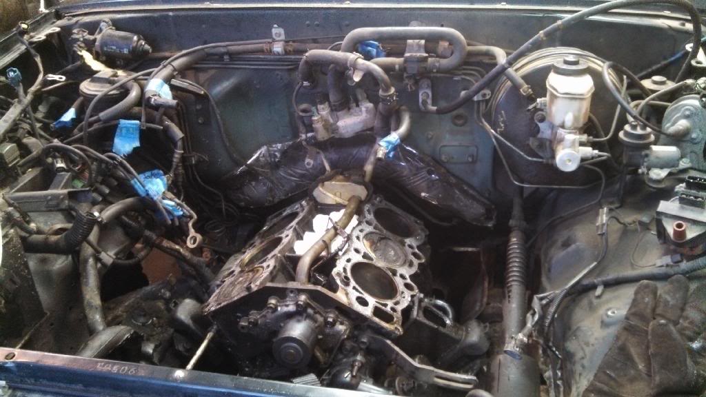

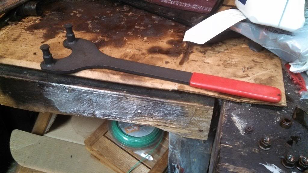

I got the heads off and cleaned up. The cam bolts are definitely a pain in the A$$. I was using an impact gun on them with no luck. I went to look at the auto parts store for a harmonic balancer puller and found this :
well worth the 30 dollars. it made cam bolts a breeze.

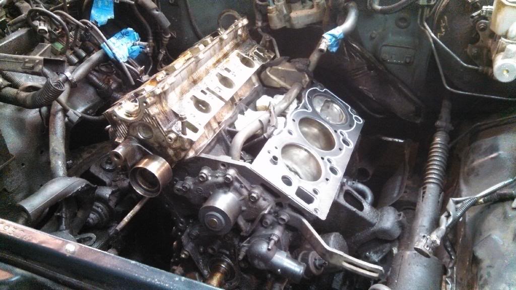

I finally got the heads off:
I got the passenger side head cleaned up, all the valve seals replaced and back on the block. After I cleaned the block of course.
Im really glad I tore into the motor when I did. It seamed like EVERYTHING was leaking. intake, valve seals, and a possible head gasket. The number 3 cylinder was partially steam cleaned like the HG was slowly leaking. All of the pistons had a lot of carbon build up from the valve seals leaking into the combustion chamber. IM just glad I got to it before it was a huge problem.

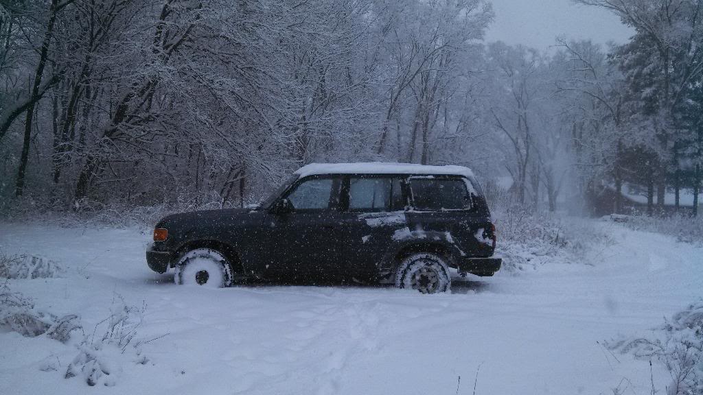

well we did get a LOT of snow as predicted. there is probably 10 inches of snow on the ground with more coming all night. There is a huge system of snow coming from the south and then when that ends they are predicting another 6 inches of lake effect snow. The bigger deal is the temperatures and windchill that are supposed to happen. the high on Monday is supposed to be -5. Yes negative. the windchill is supposed to be around -30 to -40. should be a fun time.
So in light of this news I spent the day weather proofing the house and getting the house wood burner in working order and brought a small load of wood into the house, instead of working on my truck. Just in case the power goes out or something. I did take the cruiser out back to pick up the firewood. there is over a foot of snow on the ground and the cruiser did great. never even slipped a tire. this thing is a beast!
