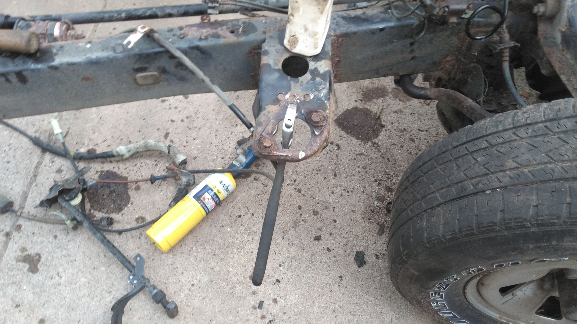

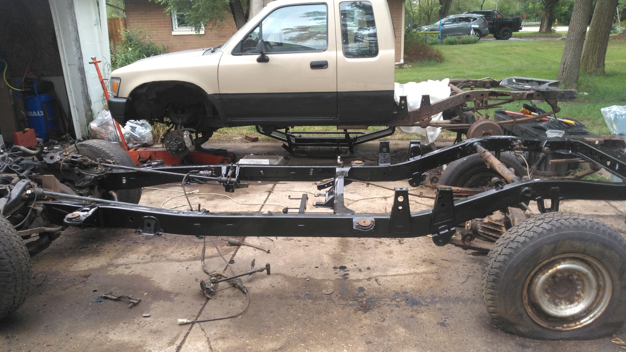

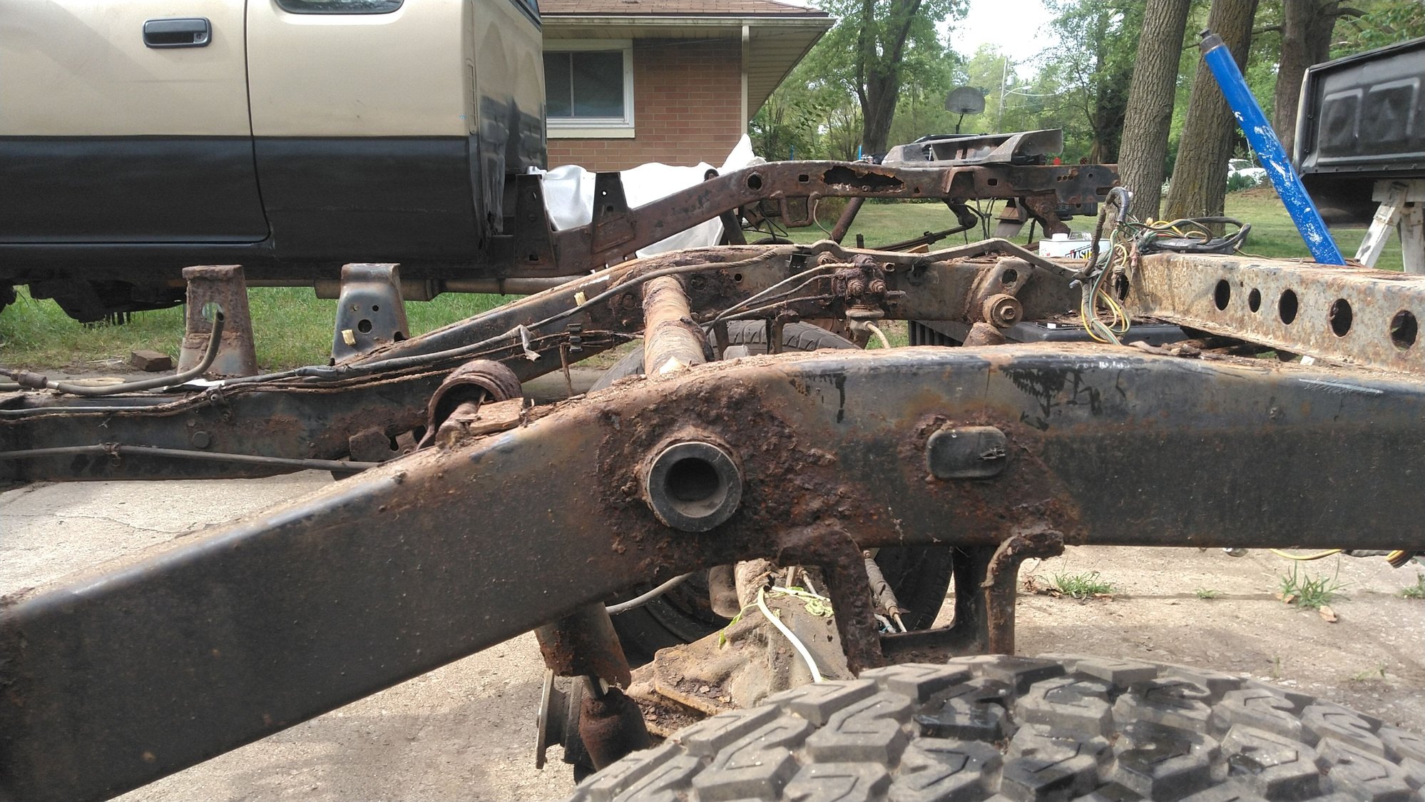

I made good progress today. I was able to remove the old body and bed from the parts truck and sent it to the scrap yard. I made about 25 dollars for the old body. So I seeeped up the rust, trash and other things from under the frame so I can get the engine hoist under the truck. It was dirty!

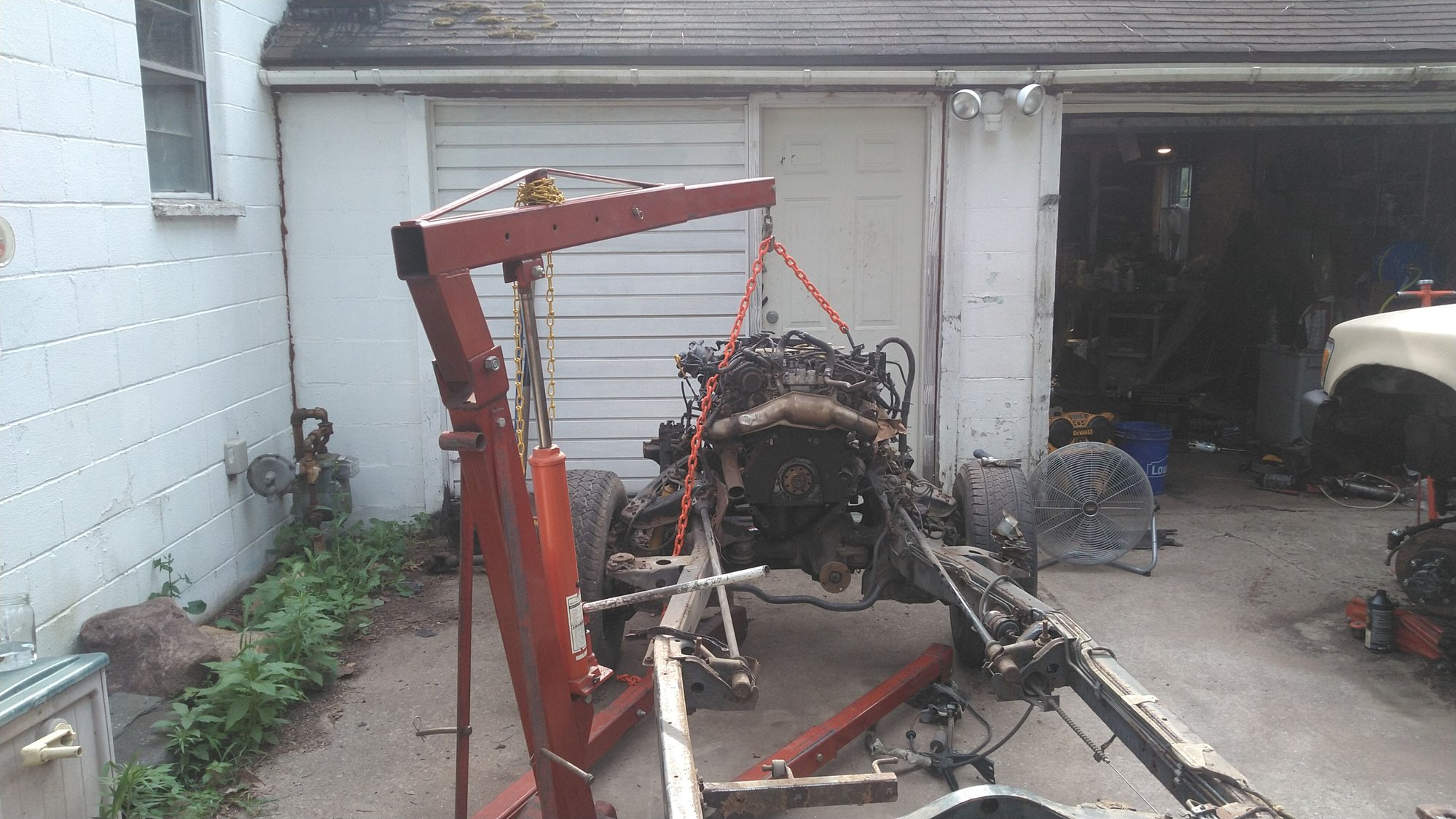

I was then able to get the hoist under the truck for the engine.
After the engine was out, I started comparing the 2 frames. I can't believe the difference between the two.

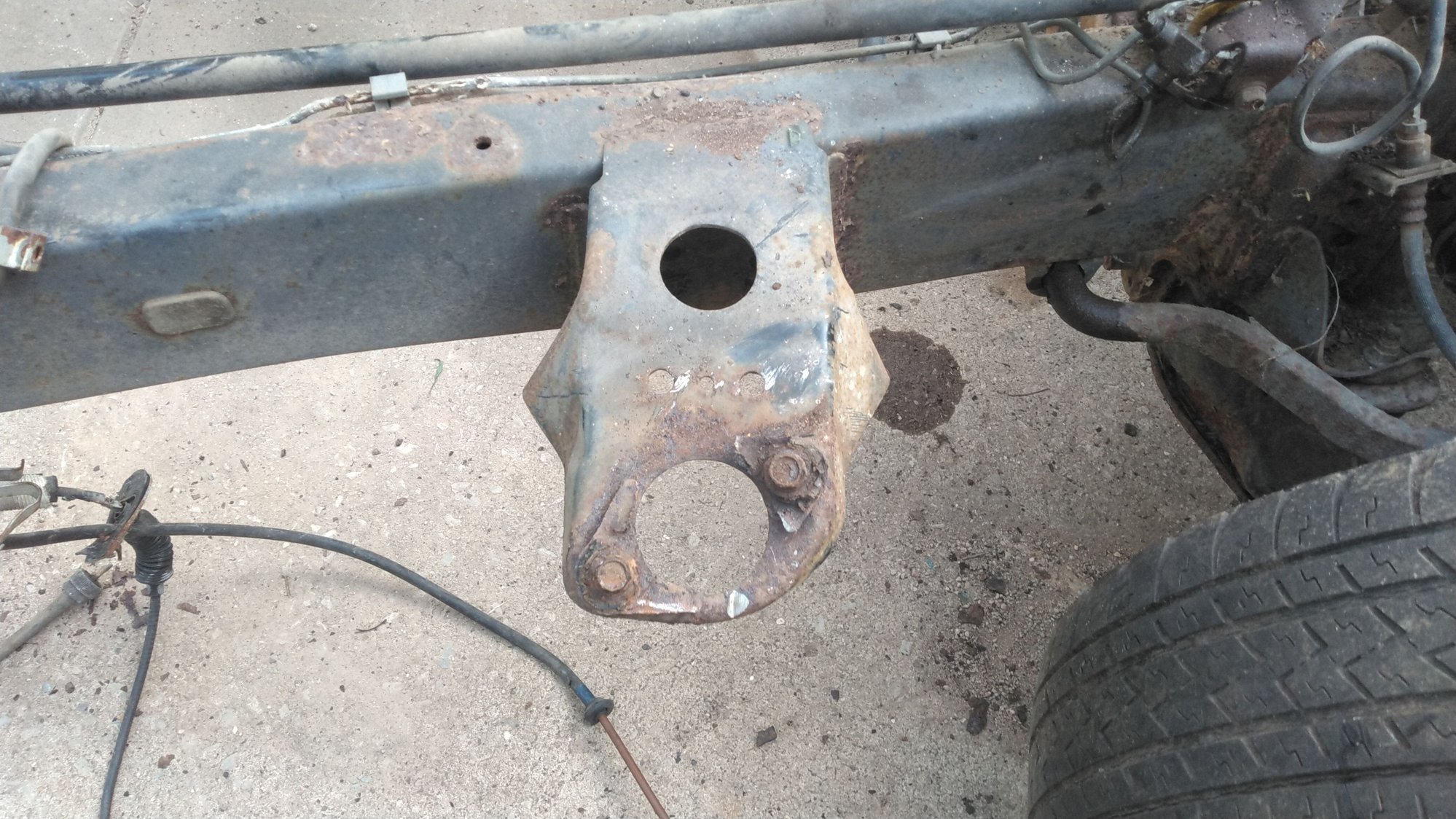

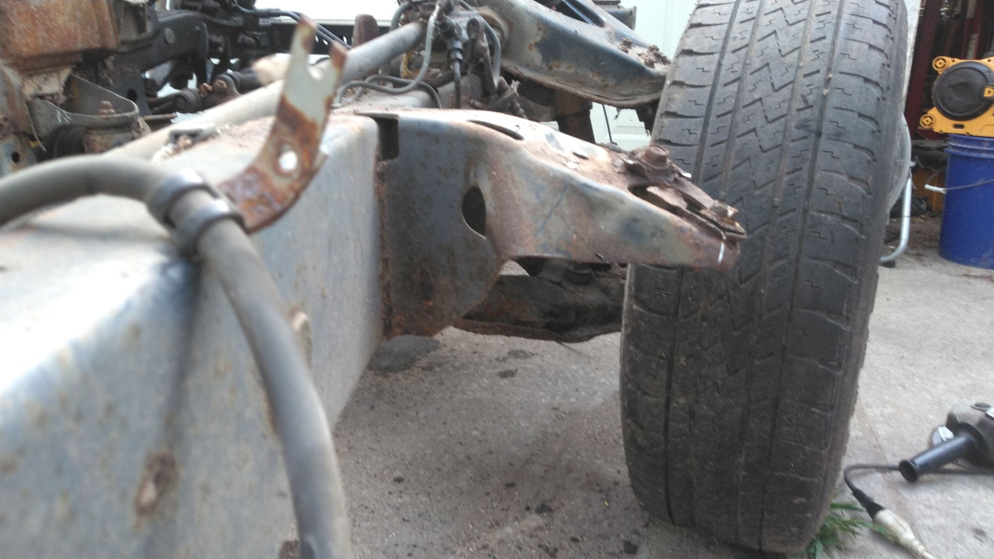

The only problem with the donor frame is one of the body mounts tab is slightly bent. Probably from when the tree fell on it.
i started to heat and beat the the tab as well as applying upward pressure with a crescent wrench.
i was able to get some of it straightened out but ran out of energy because of the heat.
Current plan is to finish straightening the tab, scrub down the donor frame and apply the Por-15 tomorrow. Then start the process of removing the body panels on the truck. To lessen the weight for when I lift the cab.

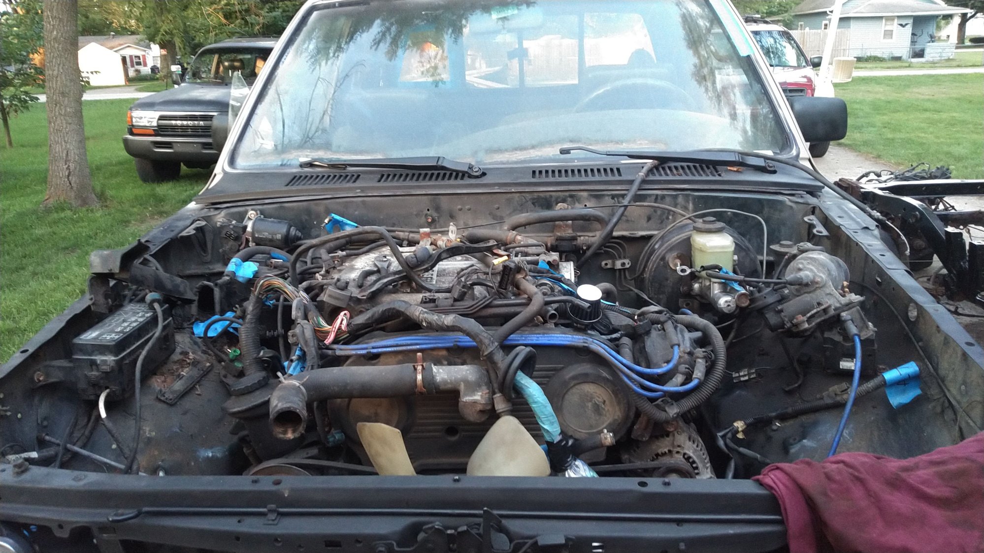

After a long hot week of work in Michigan I was able to return home and work on the truck for awhile. I have everything (I think!!??!!) Disconnected from the cab and the engine so I can lift the cab over the engine and set it on the ground. Everything is labeled and placed in a baggie to protect the important stuff. I took off the bumper,. fenders, and hood to save some weight. I still need to take off the doors to make it lighter. But here is where we are at.....

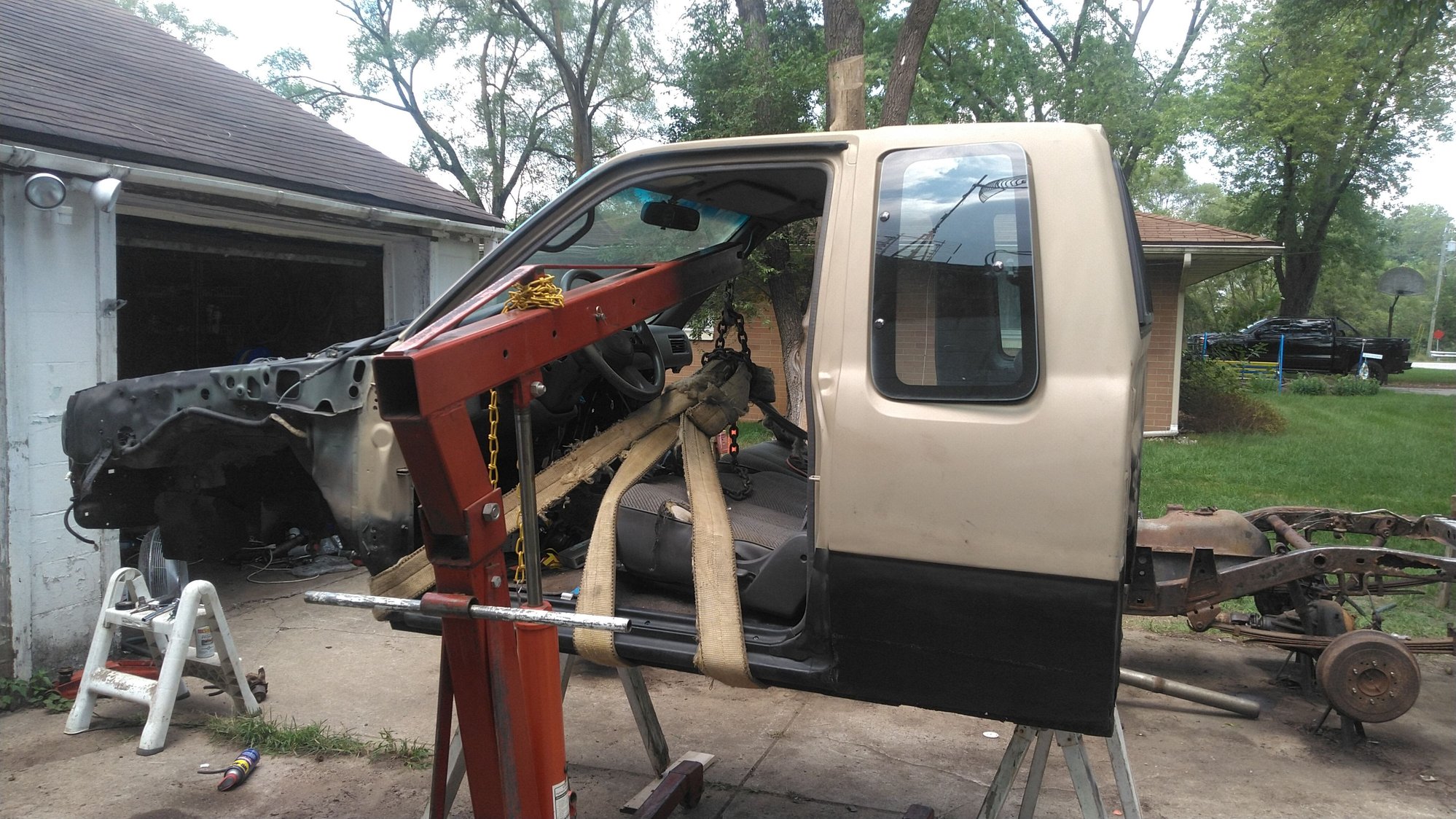

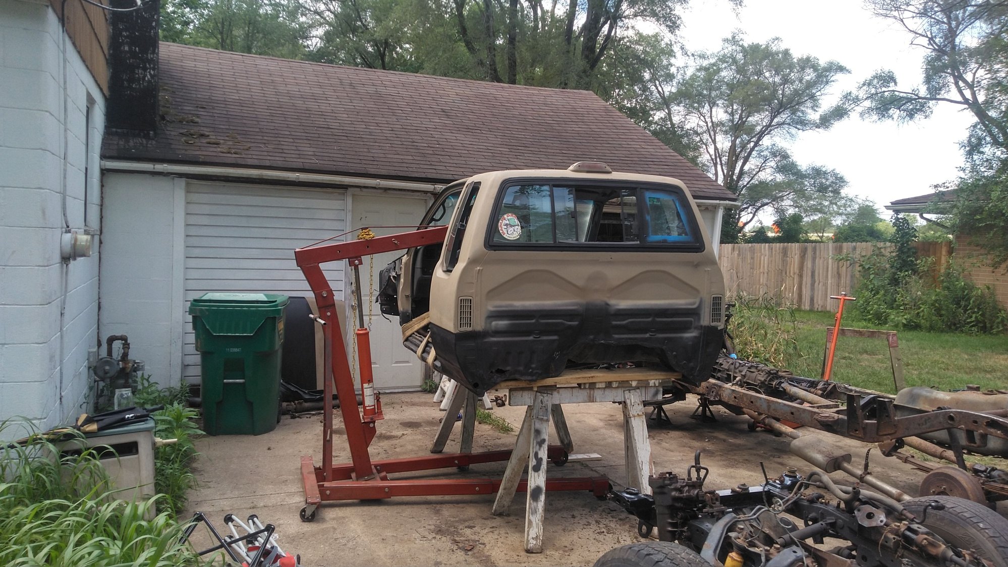

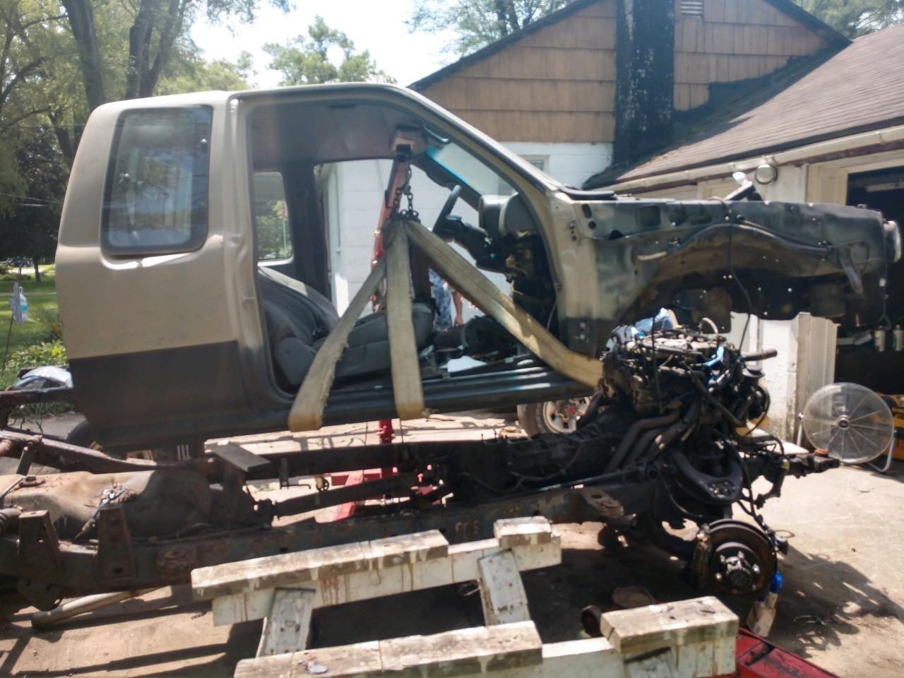

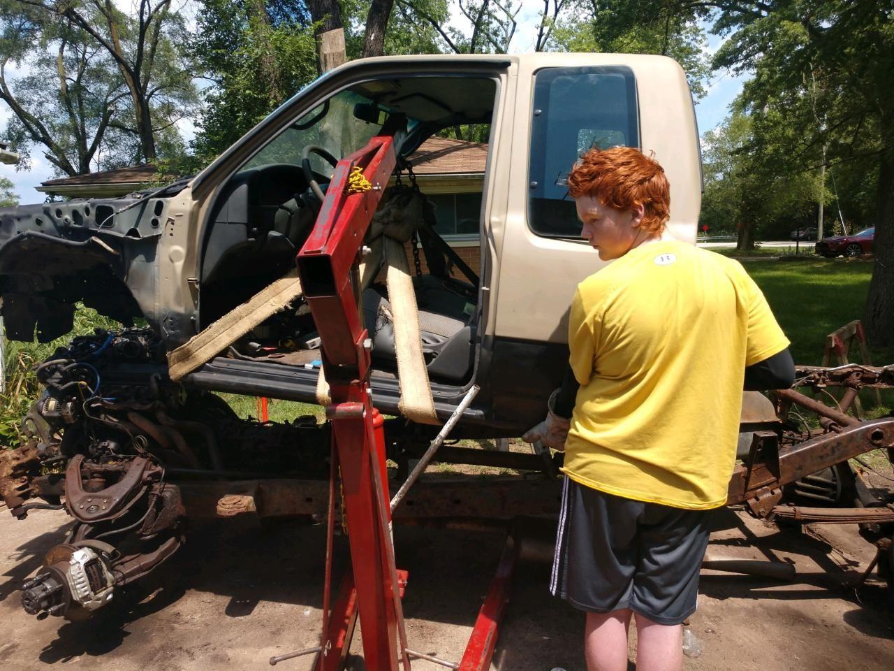

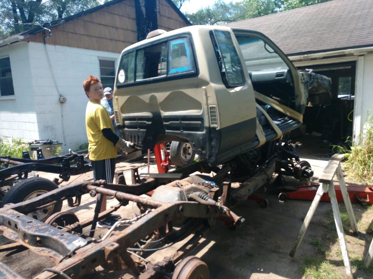

Well today was a good day, I got the cab off the frame. I took the doors off the cab and wrapped a 40 ft long 4 inch wide crane strap around the floor and above the frame. I then hooked up the hoist in the middle of the cab and started to lift.
I had some neighbors over and my sons were out to help keep things steady. I set it down on some saw horses and took a break.

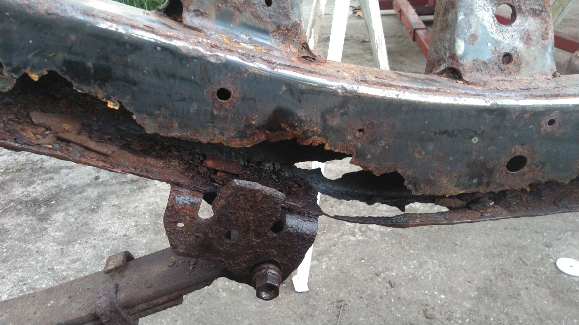

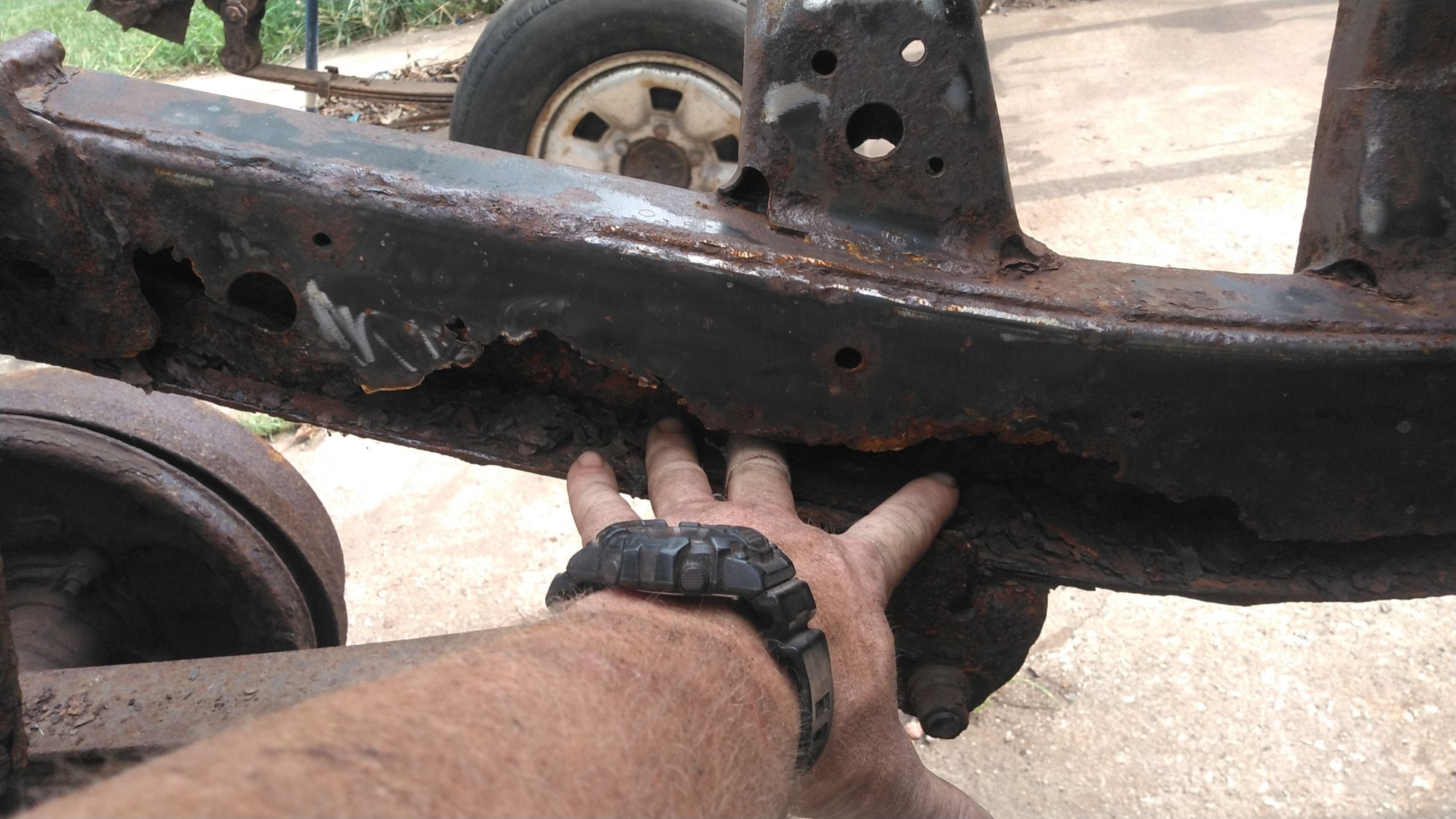

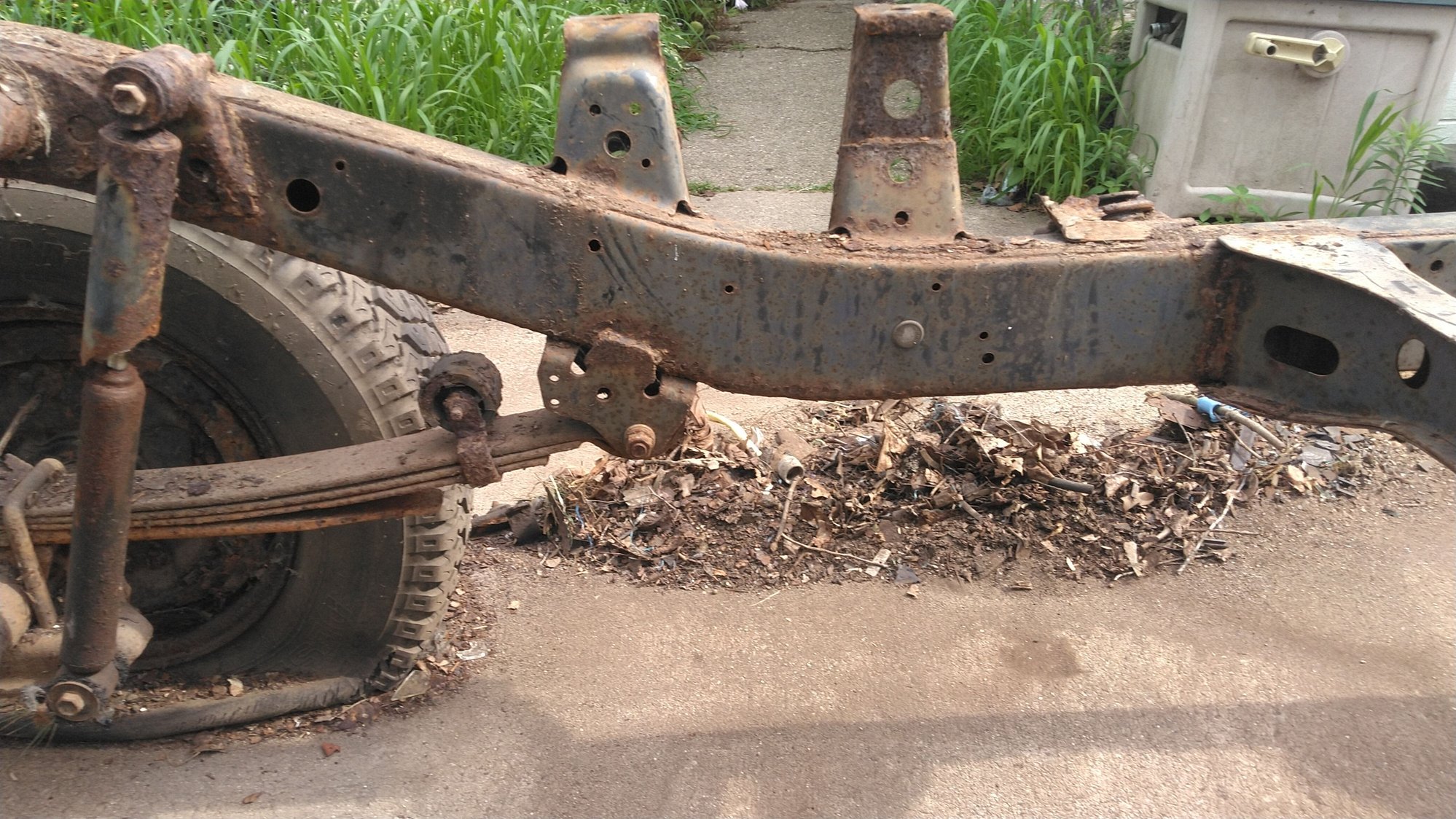

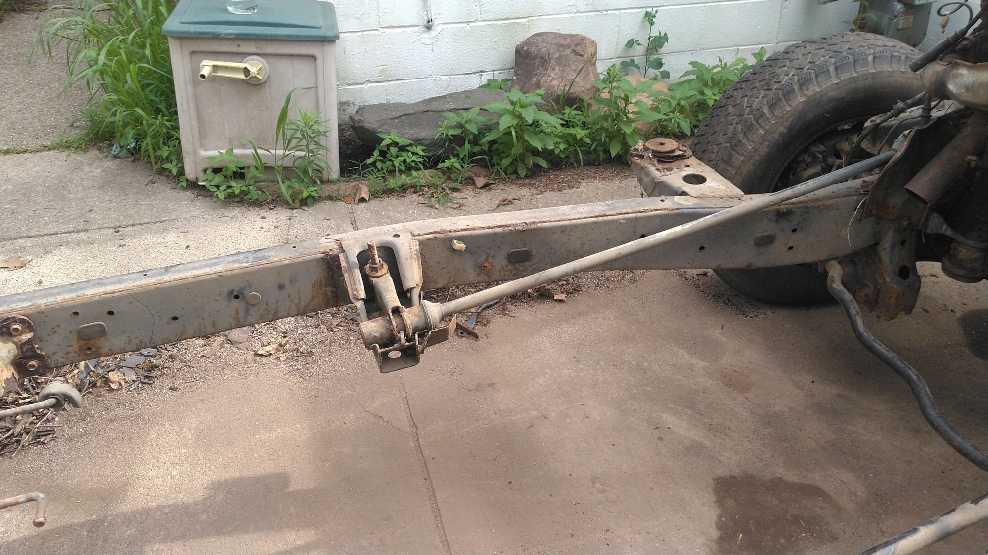

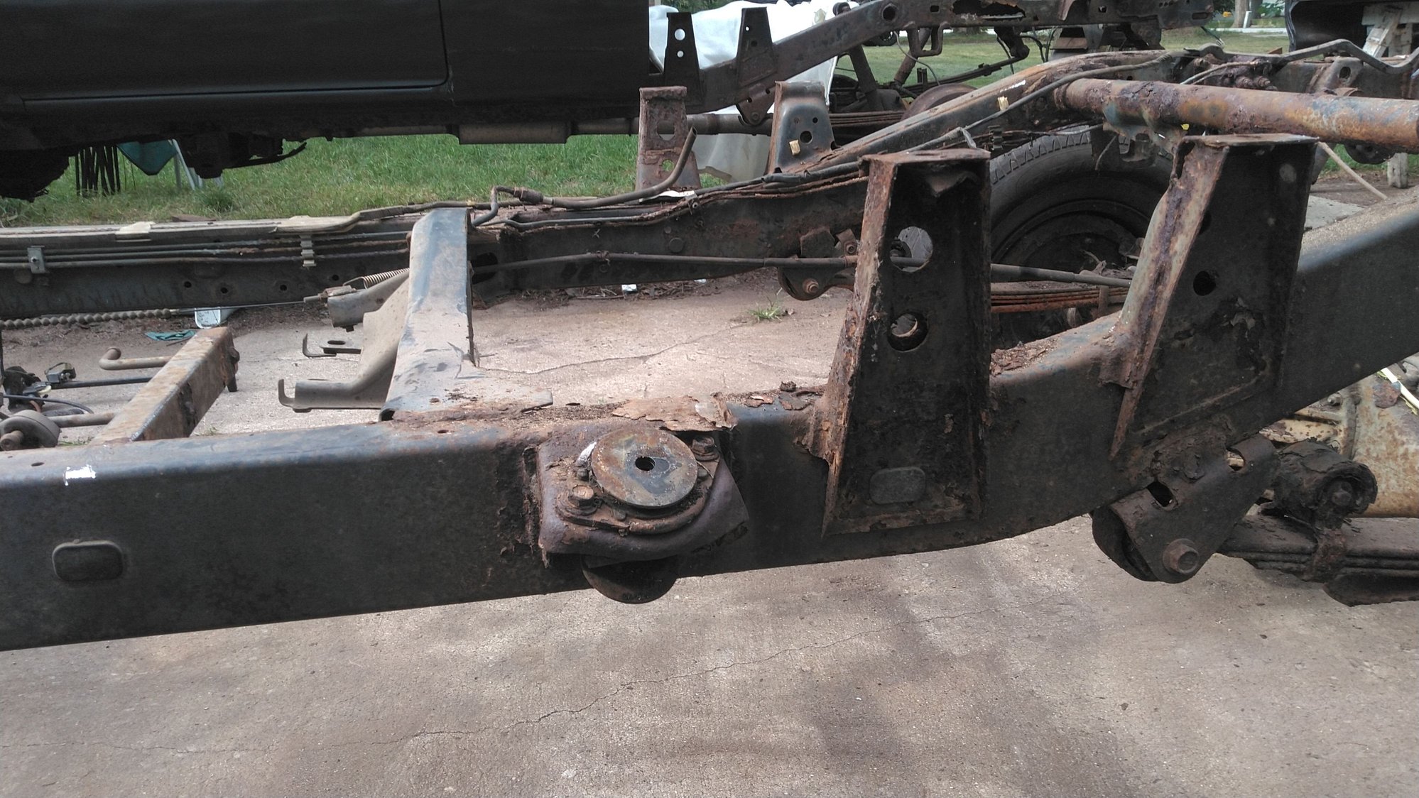

My youngest son and I went about to prep the engine and transmission for it's move. We removed the driveshaft and started to work on the rear axle as well. While working on the rear axle I found this.....
driver's side front spring mount. As much as doing this swap is a pain in the a$$ I wouldn't have made it very far before it folded....
Well I'm in town this week, hopefully I can get some more work done after work every night.

I haven't driven the truck in about 3 years. I was fixing it up to drive recently and found the bad frame. Luckily I had a spare...

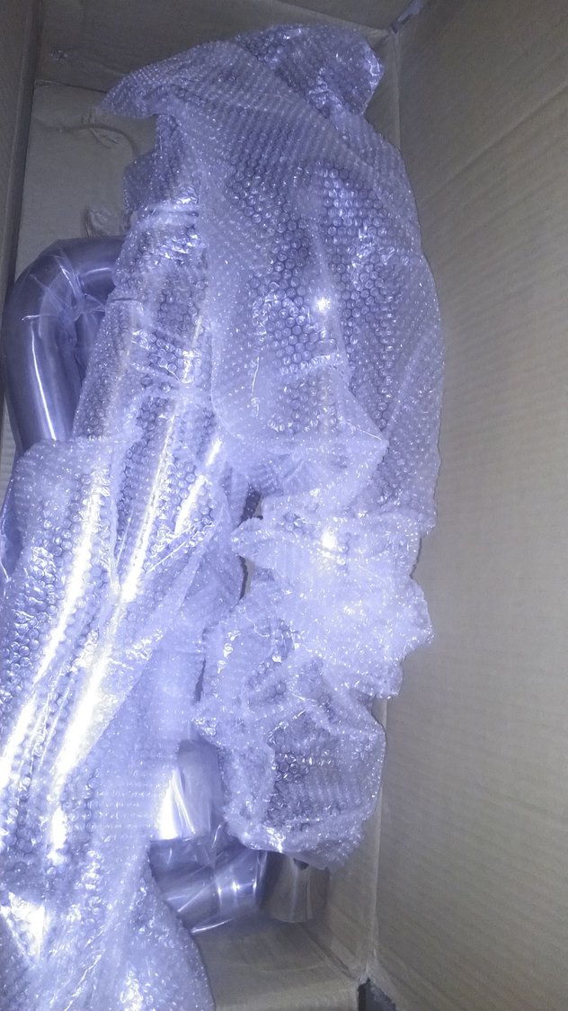

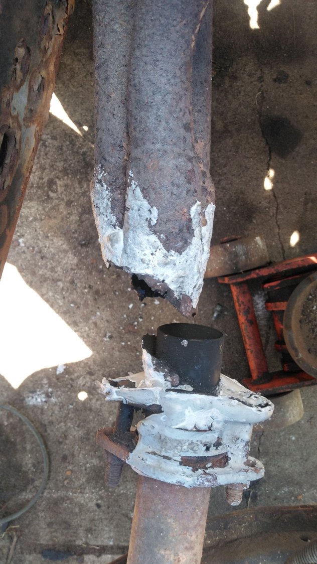

I forgot to post pictures of my headers last weekend, when lowered the muffler the header flange snapped off. Oh well, they were old anyway...
so I ordered a cheap set of headers from eBay for 170 dollars. I'm not expecting anything special from them. Just cheaper and quicker way to replace them and not have to do the exhaust crossover mod to keep the heat away from#6 cylinder. they arrived today..

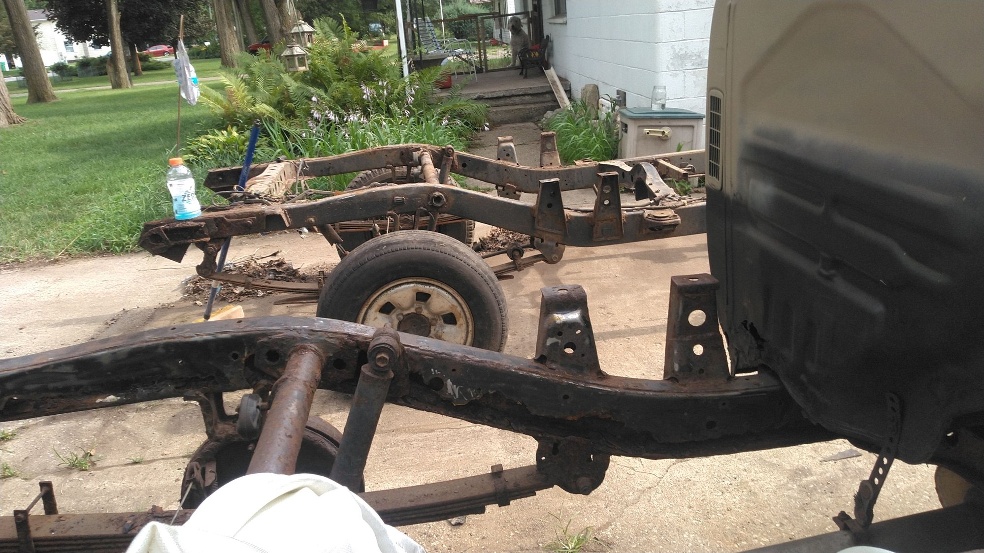

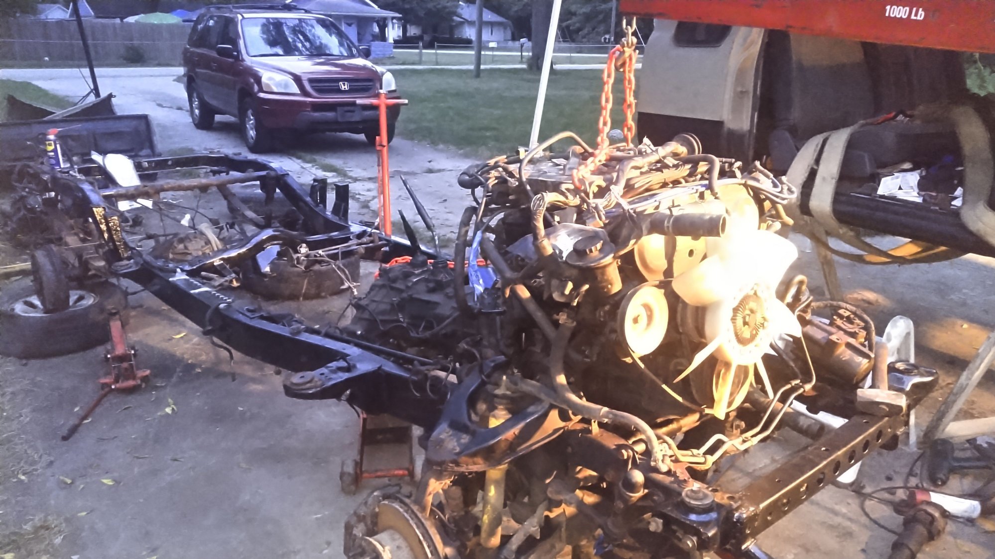

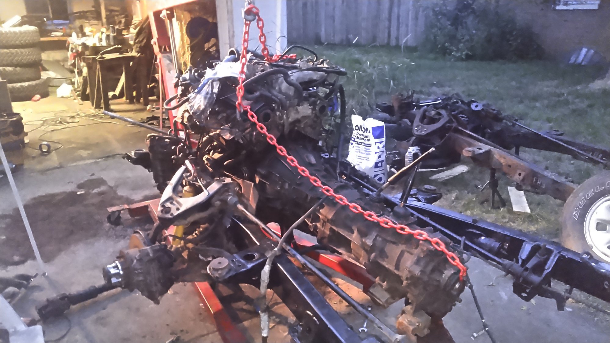

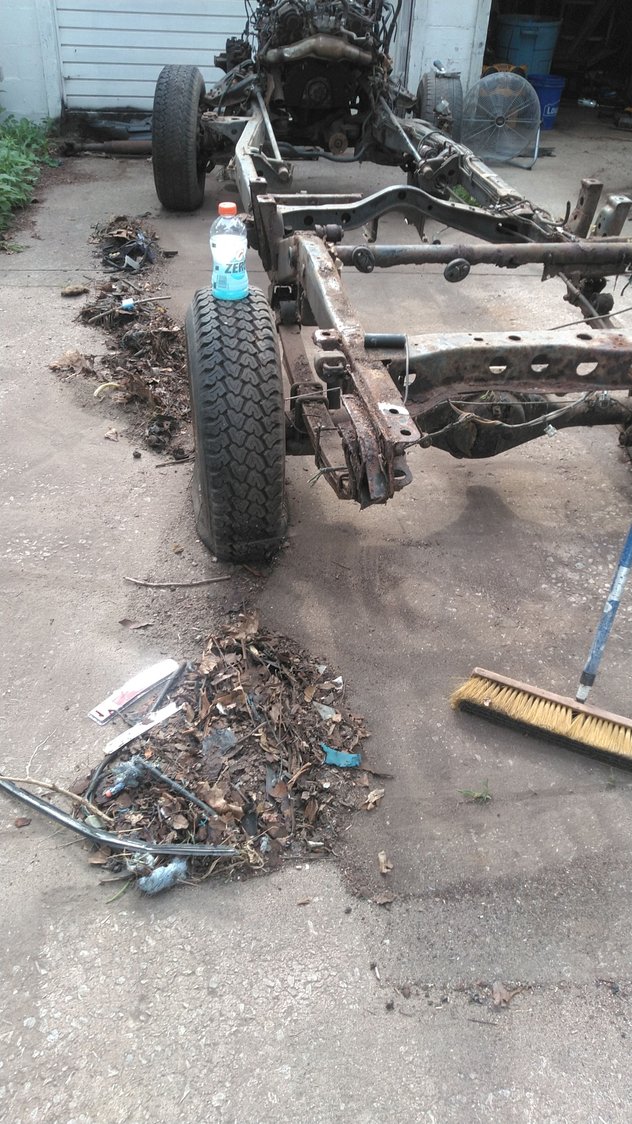

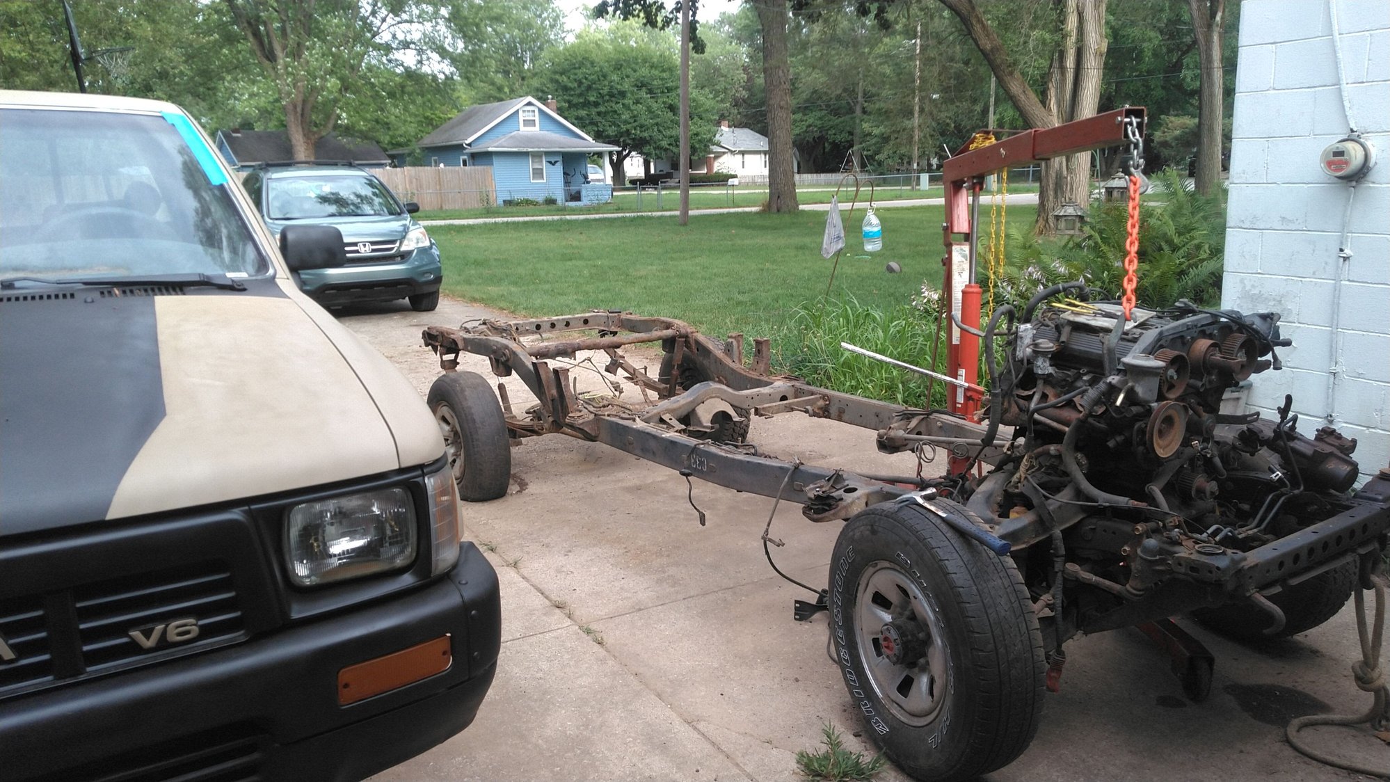

On Friday night I got the engine and transmission removed and sat down on the ground. I moved the Swiss cheese frame into the grass and moved the good frame into position. I cleaned up the driveway and called it a night. Today I had some church commitments in the morning and come home to take a nap. Then I got after the truck. I switched the 4.56 diff into the good frame and put the engine and transmission into place. Reassembly has started!!!! I'm going to clean up the transmission cross member and paint it with the Por 15 stuff and get that bolted in place tomorrow. I also need to finish up the rear axle swap and start working on fuel and brake lines. I can't believe I have turned the corner to start putting it back together!!! I'm motivated now!!!
