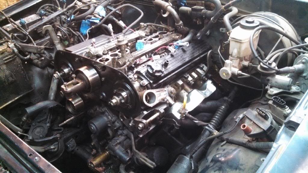

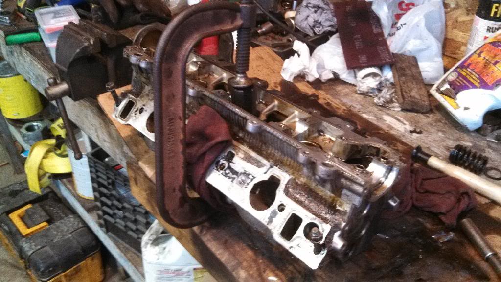

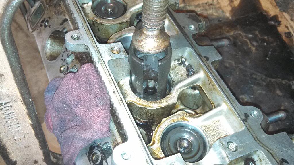

The driver side head still needed the valve seals done and everything cleaned up. So I got to work. I got creative on my tools. here is my valve spring compressor set up:
it is large 10 inch c clamp and a oxygen sensor socket. the slot in the socket was big enough to get a pair of long needle nose pliers in there to do what needed to be done.

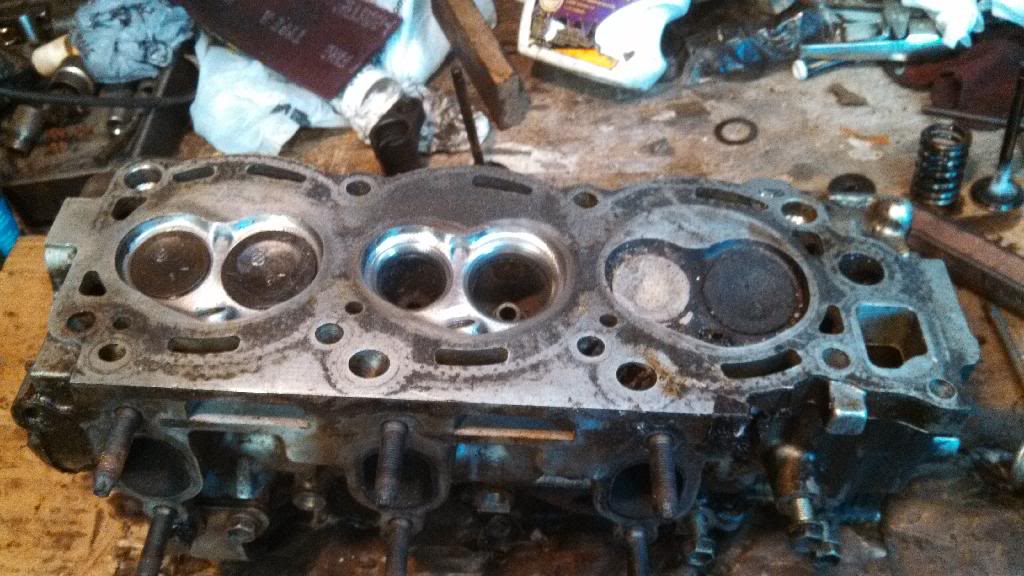

Here is a shot of before during and after the valve cleaning. Name:  IMG_20140106_134628_037_zpsfrepj3kb.jpg

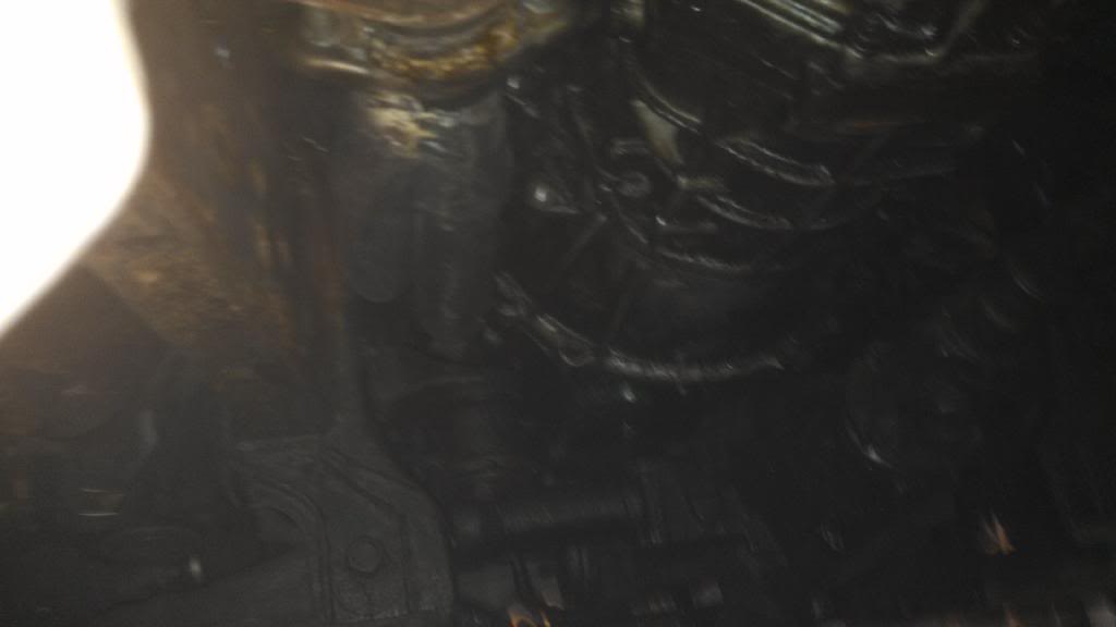

I got the heads torqued down and was installing the cam bearing bolts. The front passenger cam cap had both bolts strip out!!! UGG. About that time I found out I have to work tomorrow and I was getting cold anyway. Tomorrow is another day...

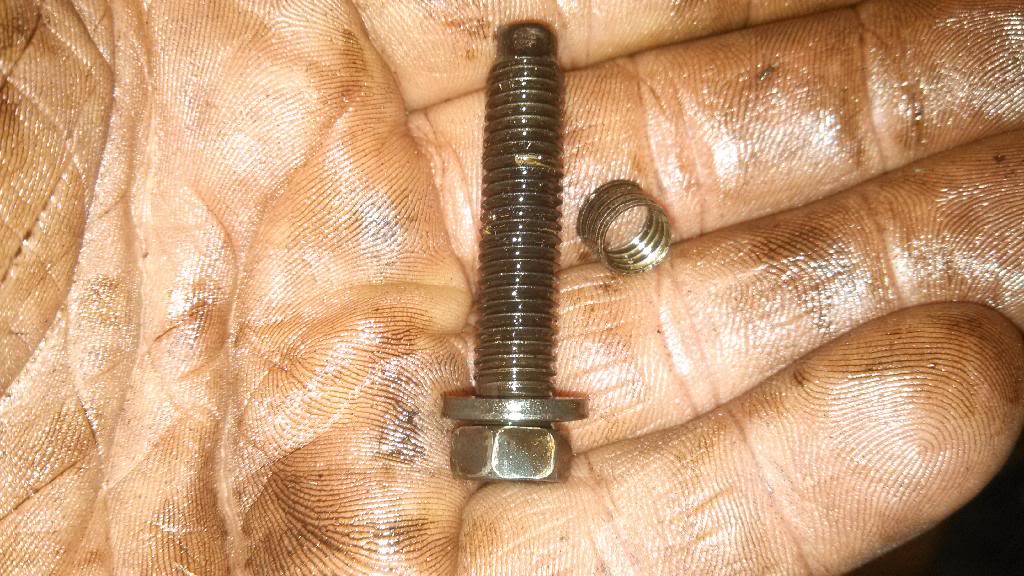

here is the bolt. the little piece of metal next to the bolt is the aluminum threads of the head.

Today was a good day on my truck. I tapped and helicoiled the bad cam bolt threads. and it worked!! whew I was definitely relieved that I didn't have to get it machined. I got a lot done on the truck. intake and injectors are installed,1 of the headers and a bunch of little stuff done too. Basically, I have to do the timing belt upper intake and finish the exhaust.

Thats a hell of a homemade valve spring compressor!!! That fj is awessome!! Great job on the helicoils.they can be a pain

yes that Cruiser is pretty bad ass. and so was my Valve spring compressor!!! lol I do what I do......

Nice going on the valve spring compressor! Whatever works!

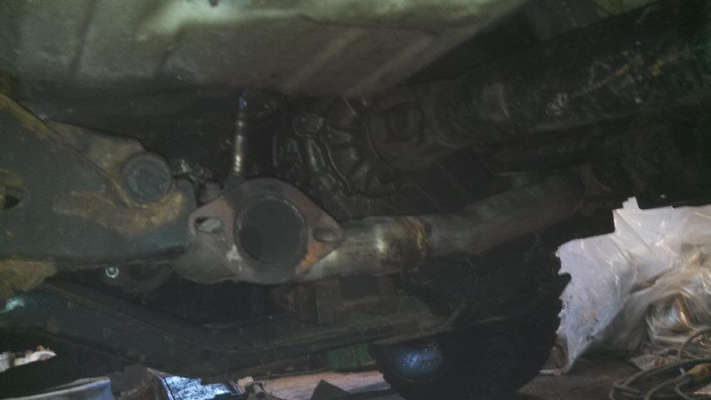

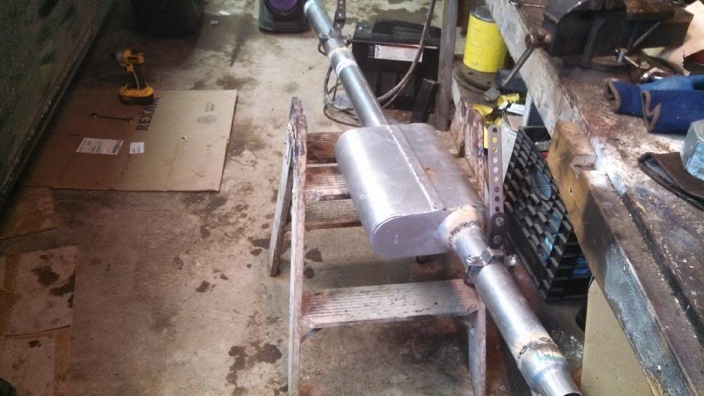

I got the exhaust done today! I went with 2 1/2 inch pipe and a Thrush welded muffler. I thought about using a Flowmaster 40 muffler but I couldn't justify the extra 40 dollars at the moment. I think it sounds pretty good.
Size:  83.3 KB I went on a test drive and WOW is this thing fast! off the line it really takes off! then new injectors and headers really make a difference. I am really a happy man right now. !! more photos of the exhaust:Name:  IMG_20140119_160906_279_zpsdstauqwj.jpg
