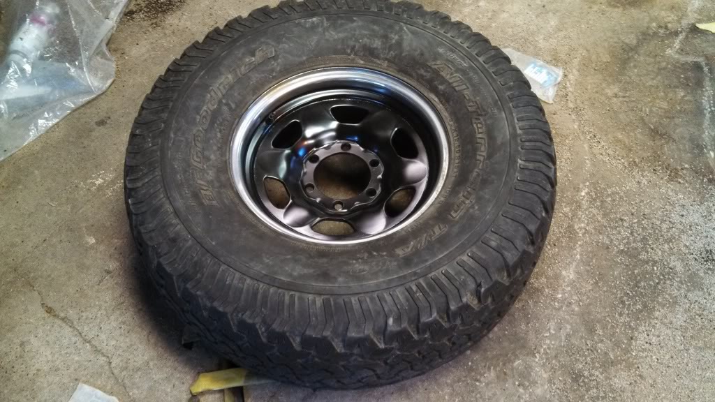

When I got home from work I put a third coat of paint on the rims and went to dinner.

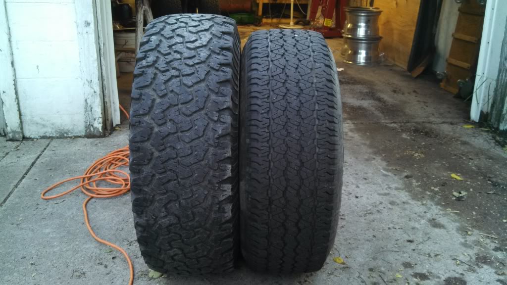

After dinner it was time to install these bad boys. I pulled the first tire off and compared them side to side.

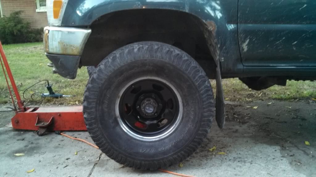

I like the way they look on the truck. I wish my truck sat these high but alas it is still on the jack.

I did have to do some "adjustments" to the fender wells to prevent rubbing the tires at full turn. Some persuasion with a BFH and all was well.
