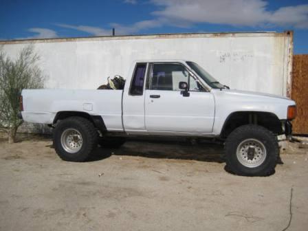

In other news I bought this 1985 xtra cab. Just too good a deal to pass up.
Time for the first ever IFSS??????

Oh god NO! That would be a hell-a-lot of work. Besides, I got the identical truck just a year newer with a factory installed IFS swap!
Attached Thumbnails BlazeN8's 1986 4Runner Build-Up Thread-img_0888compressed.jpg

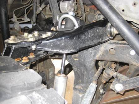

Did a couple of mods over the weekend. Pulled off the "Coil Over Assist" Race Runner shocks and stock T-Bars and went back to the Trailmaster shock with the SAW 25mm Torsion Bars. Needed the SAW Coil overs for the Desert truck. I had to make a bracket to bolt into the UCA cross shaft because my factory tabs were cut off years ago for the Downey Double shock hoops.
