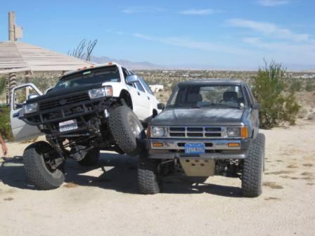

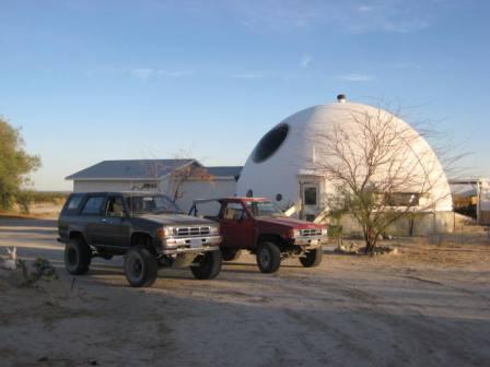

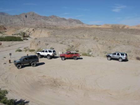

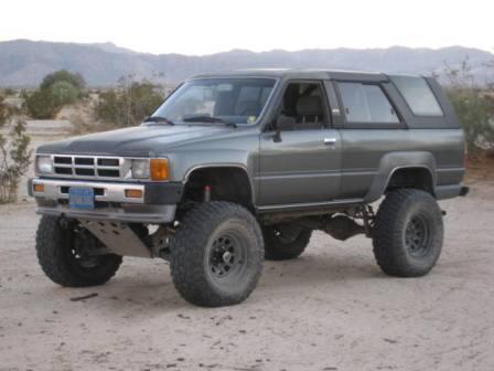

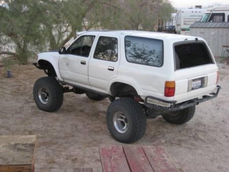

The trip went well. I logged 300 miles door to door with 60 miles aired down in the dirt. I didn't get any action shots or video. No one in our group has the equipment or knowledge.
Here are a few still pictures of our group. The 1st pic is our group, 3 LT runners and 1 SAS. Each has its strengths and weaknesses. Over all we all kept the pace with no one lagging. The 3rd picture is the SAS in the group showing off. 5.29 gears with ARB air lockers an dual transfer cases make this thing the dominant crawler in the group. It is very well suited for the desert as well.

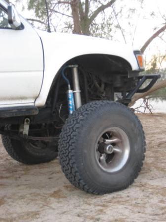

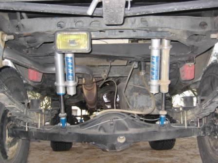

Some reasons whay the SAS rig keeps pace at the higher speed desert wheeling. Check put these shocks. The rear leafs are All_Pro 6" lift LT leaf springs (what I plan on doing to my rear)

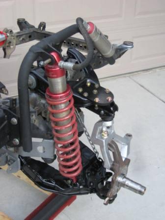

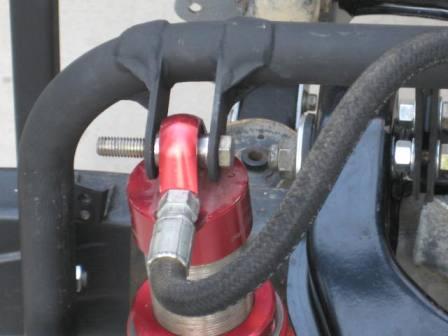

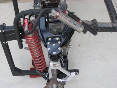

Geeze, side tracked again! Back to the 4 Runner build thread. Here are some photos of the "coil-over assist" on my mock up frame.
Attached Thumbnails BlazeN8's 1986 4Runner Build-Up Thread-side_view.jpg   BlazeN8's 1986 4Runner Build-Up Thread-front_view.jpg   BlazeN8's 1986 4Runner Build-Up Thread-rear_view.jpg
Old Nov 10, 2010 | 06:09 PM
  #118
BlazeN8's Avatar
Posts: 977
From: Southern California

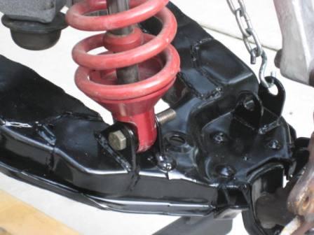

Top view and some close ups of the shock attachment points.
