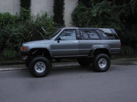

The past weekend it was raining so I took of the bald 35's and put on a spare set of 33's so as to be safe on the road.

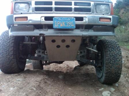

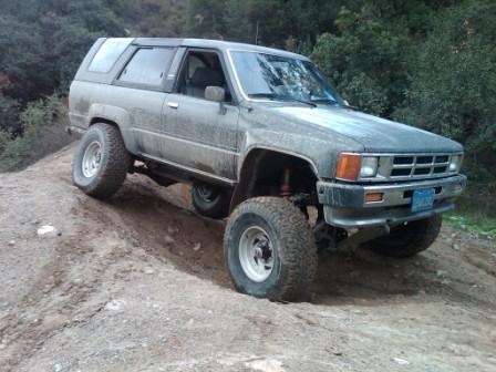

Took the 4 Runner to the local canyon and got into some dirt. Missing the front diff, driveshaft, and CVs so I was handicapped on where I could go. Non-the-less it was fun and worked well in pre-runner mode. I found a section to get the suspension to flex. Got the front fully drooped and compressed but the rear wouldn't come down on the bumpstops. The shocks might be about an inch too long? Need to further investigate.

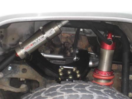

I am running a "coil-over assist" in this set up. I am using a stock torsion bar with almost no pre-load. The coil over shock also has a very light pre-load to a 250lb coil spring. If you had a 100% coil over conversion you would want about 600lb coil springs; but with a much greater pre-load. Also a 100% coil over conversion requires much more re-inforcing on the shock hoops. It is best to cage the engine compartment or at least incorporate a strut brace of some sort.
The coil over assist allows a lighter, less engineered shock hoop. It allows the loads of the suspension to be divided between two systems. Another advantage is there is a dual spring rate and multimple adjustment points. Think of it this way, neither the torsion bar assemby or the coil over assembly is working very hard, and a such neither is in overload.

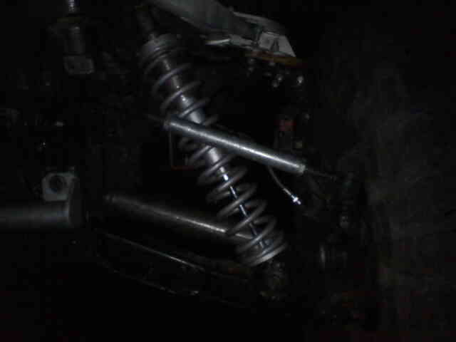

I am working on a similar set up my self. I was able to squeeze a coil over in the stock location. i used one 16 inch 200 # ebach spring with my sway away torsion bars set with a very light pre load. Also my shock is out by the tire so they might have some more mechanical advantage. They are at an angel so some of the mechanical advantage will be lost. My coil over are a Kyb conversion but I picked them up for free and i have a ton of 2.5 springs from my inability to get the spring rate right in the first 10 tries .

sorry phone pic at night.

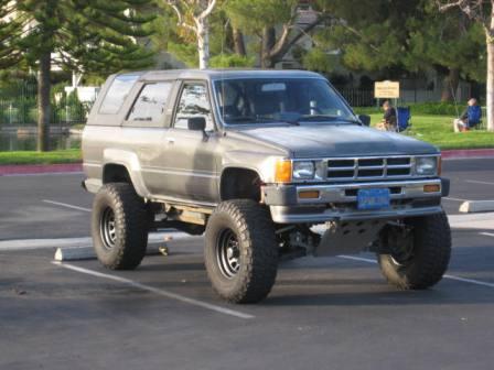

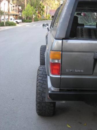

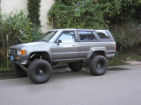

I have some excess coil springs in my inventory also! Trail and error is the price we pay for perfection. Speaking of which I have a few sets of rim and tire combinations now too! I installed some 315/75/16 BFG Muds on a set of Steel Rock Crawler wheels. The wheels are 16x8 with a 4.250" Backspace. I think the proportions are just right. Nothing rubs throughout the entire range, even the stock mud flaps work! The 8" width and deep backspace really keep the track width managable. The rear has 3" wheel adaptors. Still can't believe this is a 35" tire!

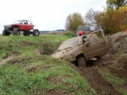

If I could figure out how to start a thread I would.can some one help?. Just so you have an idea how deep those holes are this is my bodys jeep on 33 locked front and rear, stuck same place next day.it did rain all night.
here is all the info. you need. thank superbleeder.
