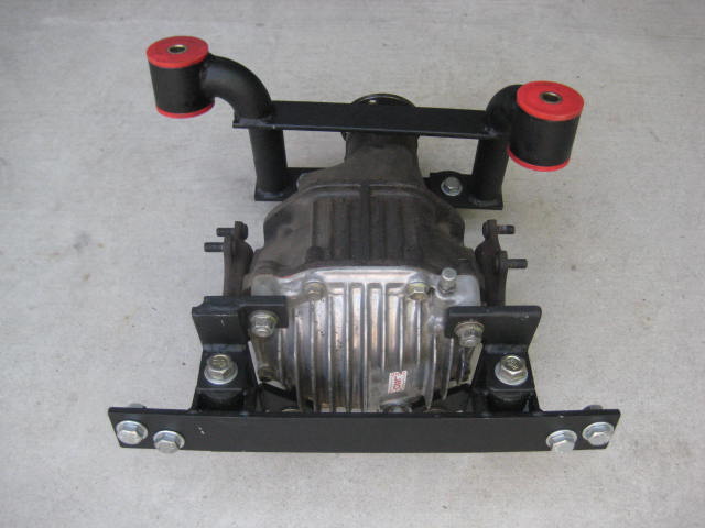

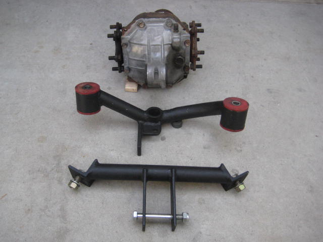

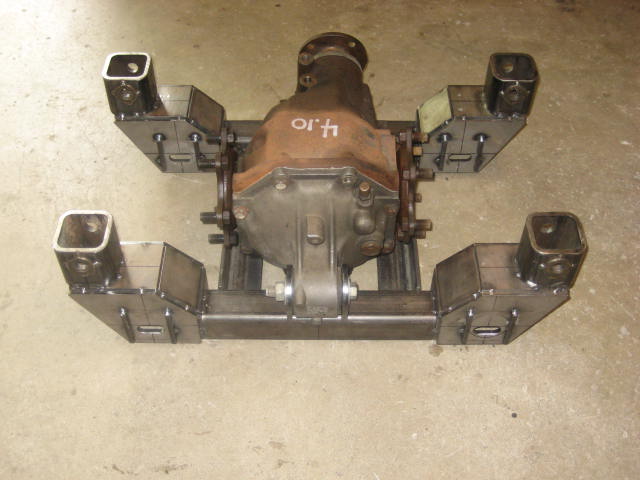

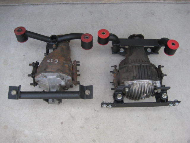

A few more photos of the Mega Travel. Here is the mock up of the drop bracket sub-frame.
I designed the subframe to accomodate either the CMdiff 7.5 or Supra 8. The brackets to either diff bolt onto the rear factory mounts with a new front cross member.

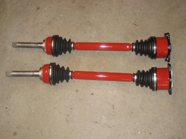

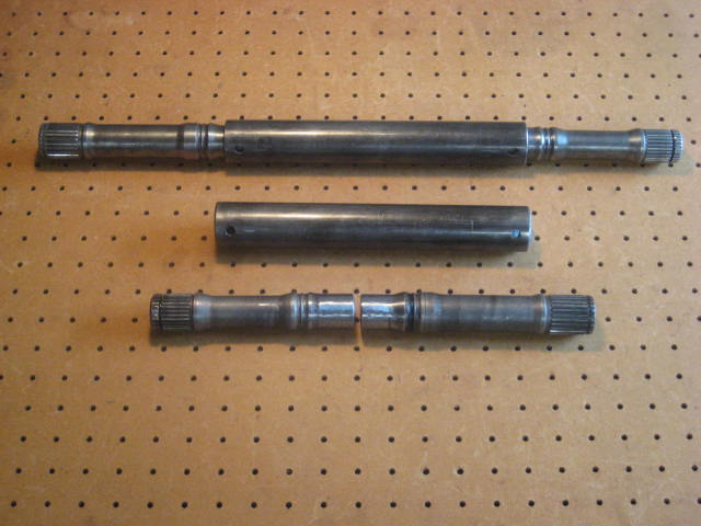

I cut and lengthened a set of standard length center bar axles. The sleeves are 1.5" OD / .250 wall DOM. The ID was machined to slip fit the OD of the axle and I welded the perimeter as well as plug welded in three holes per side.
So far the sleeved axles have held up! If I end up producing the Mega Travel I will have the center bars built by a specialty machine shop. If the sleeved version holds up maybe I will offer a low buck sleeved option too? Or some type of DIY kit?
Currently I am using factory upper and lower ball joints. The upper BJs have been clearanced to allow additional up travel. I may switch to a Uniball?

Love the unpainted sub frame picture, looks heavy duty. I didnt realize you moved the UCA pivot as well, how much did you have to bring them in toward the center of the vehicle?
Thought at all about adding a little skid plate on the bottom of the LCA?

Kornhuskerwizard, the megatravel has been on my 4 runner since September. Check out the dates on my build thread, it will take you back a few pages.
Zpd426, I moved the LCA pivots in 2-1/2" per side. About the same as I moved the UCA pivots. But I also moved the UCA pivot down. For the LCAs they moved down a different distance and because of the spindle spacer it gets even more complicated. Anyway, the LCAs are approx. 6" longer per side, but because of the pivot relocation the track width is only increased by 3.5" per side. Which brings us to Red Wagons question. I was hoping that it would be possible to install the Mega Travel UCAs with the Blazeland LT LCAs as an upper component only upgrade, sort of like the old Rancho / Downey design. By not reconfiguring the LCA components and pivots and adding a spindle spacer and drop bracket a bunch of other things happen. One is the lower BJ binds and contacts the LCA drop. The second is it creates too much plunge in the CV axle assembly. There are some other issues with camber gain as well.
Here is a photo of the +6 Mega LCA vs. the standard +3.5 LCA.
Even if there was a way to make it work out to do an upper only version the CMdiff wouldn't work. And with mega travel without a drop bracket you would be limited to dinky tires because of all the up travel.

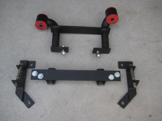

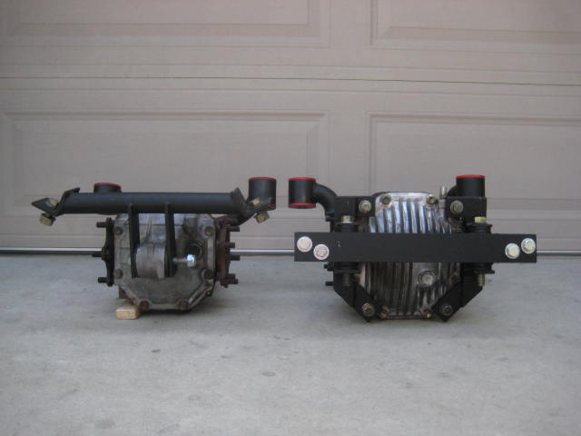

Earlier I posted a photo of the basic components of the MT (Mega Travel) laid out on my driveway (all parts inflat black). Then I posted the revised version of the upper kit (UCAs in silver) During the transition between UCAs I bolted on a factory UCA with UCA Extension Bracket so I could move the rig in and out of the shop for other projects. The geometry was all screwed up. There was a major positive camber and the wheels towed in. I was sketchy to move the vehicle a couple of hundred feet to park out of the way.
Anyway I am starting to burn out and am getting sleepy. Suffice to say I have played around with all sorts of configurations over the years and all the things most of you guys are brainstorming about I have thought of as well. I am really stoked on how its evolved and would like it to be something I can share with you all.

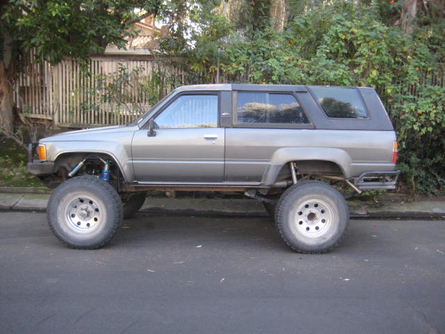

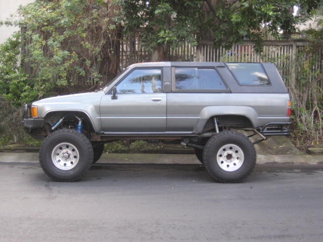

Happy New Year!
Its been a relaxing day. Watched the Gator Bowl this morning, nice job Cornhuskers! This afternoon I had a chance to get on my creeper and roll around to inspect the under carriage for damage and make observations. I was looking at bumps stop impact marks, shock wiper patterns, worn paint, fresh metal scrapes, oil drips, grease spatter, etc. Everything seemed in order accept one of the nuts at the limit strap to LCA was loosening. It was a worn out / used nylock nut I used when I ran out of new ones.
Here is a comparison photo of the some what clean Runner against the dusty Runner! I always love how sand cleans the tires. You can see from the remaining dust nearer to the center how far up the sand polishing went at 8 psi.
I could gain a little bit more down travel by letting out the limit straps via the adjustable clevis. I might shim the bumps a half inch to remedy tire rubbing. I may adjust the ride height in the front to sit slightly higher. And I need a better rear shocks......but we all knew that!

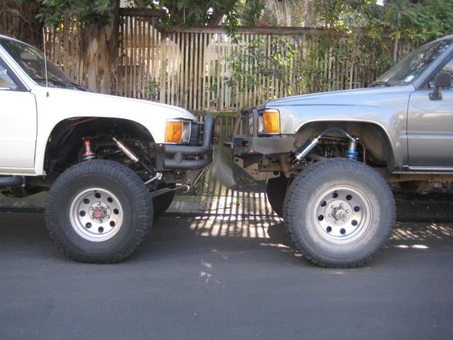

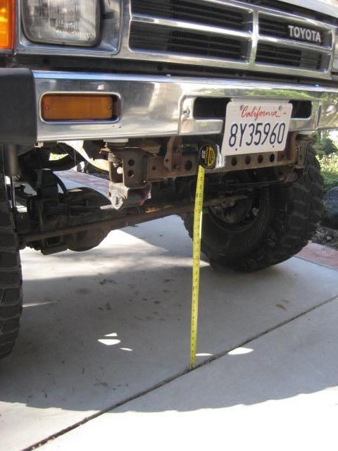

Here is a photo of the 86 Mega Runner next to my 1985 Truck. Both rigs have 215/75/R16 tires.
Here is the point on the frame I took measurements from.
Measurements as follows:
85 xtra cab p/u- 26.25"
Mega Runner- 26.50"
*Fordota w/ LA kit- 24.00"
Translates to ride height / or lift:
85 xtra cab p/u- 5.25"
Mega Runner- 5.50"
Fordota w/ LA kit- 3"
*Note: The Fordota has 33s, so I added 1" to compensate tire size.
Keep in mind the measurement point is at the frame so the body lifts are not a factor. Here are body lift sizes anyway for reference.
85 xtra cab p/u- 2" Body lift
Mega Runner- 1" Body lift
Fordota w/ LA kit- 2" Body lift

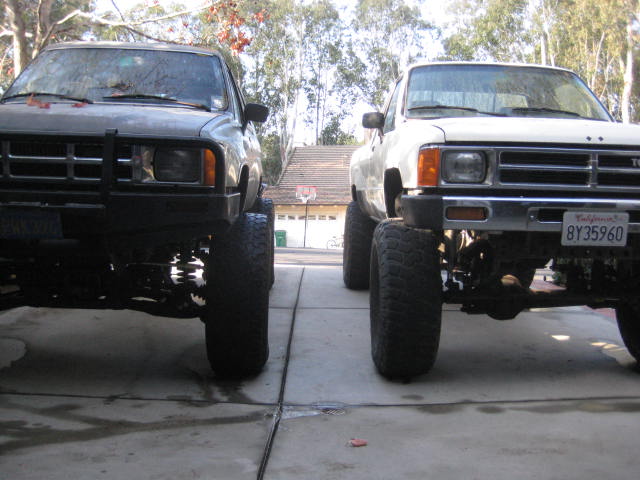

Here is a photo I took this afternoon to help visualize the ride height differences between the LA and the Mega. Don't forget, the Runner has a 1" body lift and 35s, the truck a 2" body lift and 33s.
I think another 2" of lift on the front of the truck and 35s would be nice. Going from 12-13" of wheel travel to 14-15" is a big improvement for some situations. The higher center of gravity, enhanced body roll, and unstable spring pre-load makes cornering more of a concentrated effort. But i think on the truck the rear will be lower as will the center of gravity. I probably wont set the front quite as high either.

the 7.5 diff is plenty strong imo. your axles will break before the diff. look at all the new toyotas now with IFS and 7.5 front diff. the newer vehiclies are much heavier and even more so when armored up. they all hold up fine and never heard of anyone blowing one up even locked. the axles is the weaker link which i think is better than the diff lol. faster and cheaper fix

I HAVE broken the stubby passenger side output shaft from the diff.
Sheared it right in two.
Sand... buried deep
I agree Toyo, My diff has been great. That stubby shaft is a weak point.
That fordota will look great with the Megatravel!!
My plan will be to get the 4" lift up front to level out the truck. Then I can justify getting a little longer shackle to soften the ride. (maybe one day mega travel?)
Sand... buried deep
