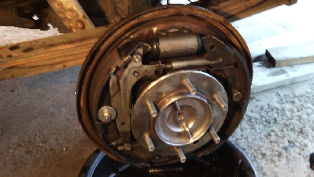

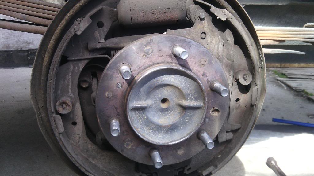

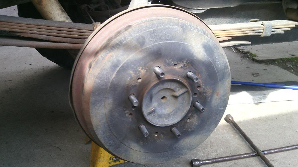

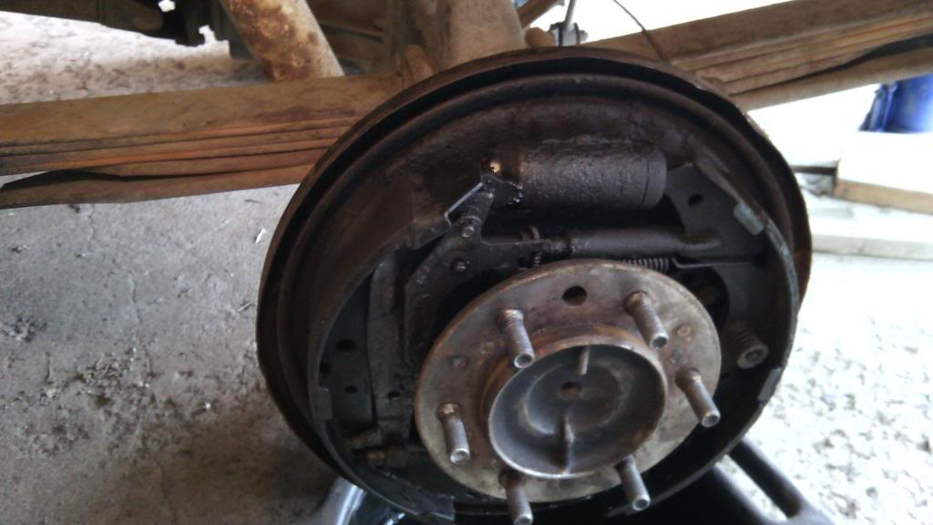

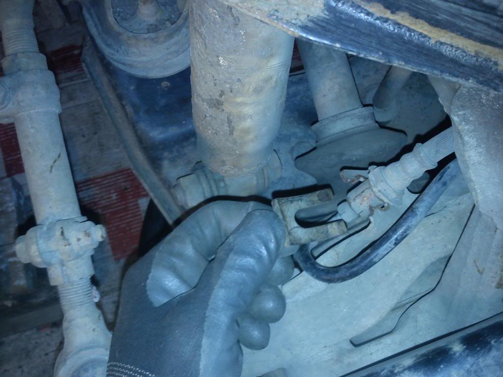

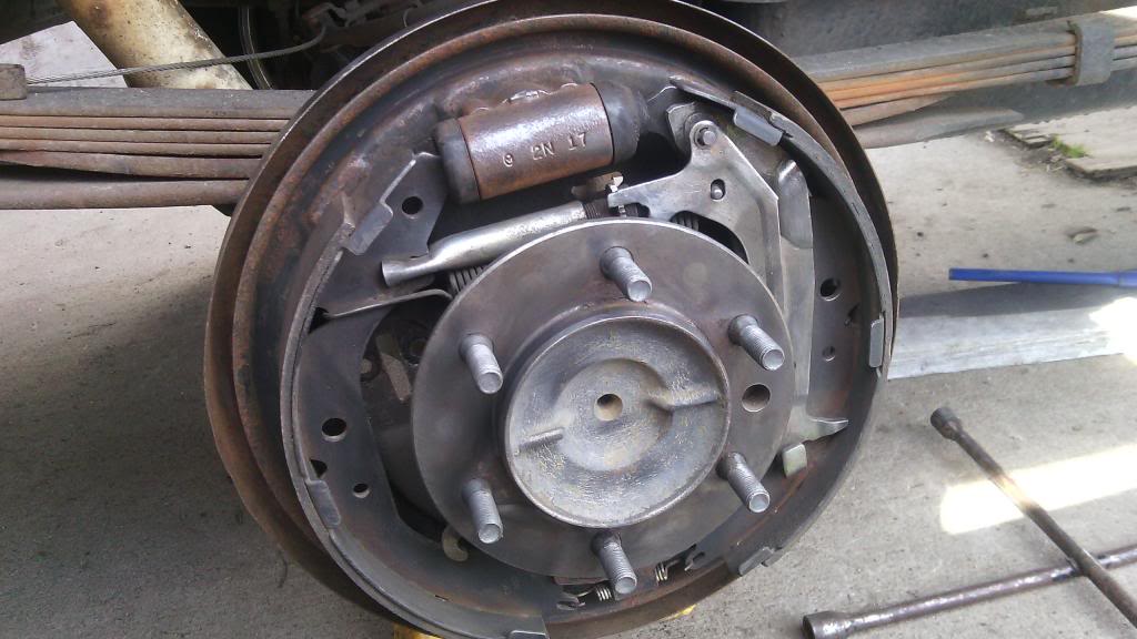

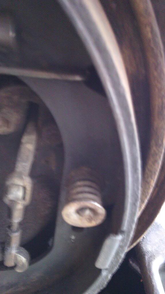

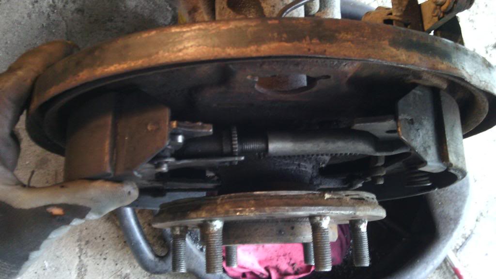

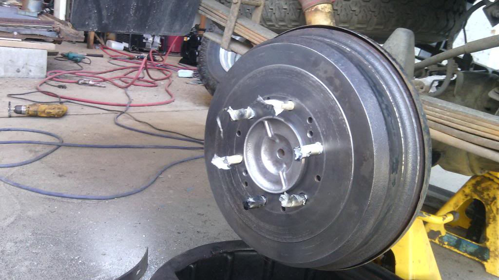

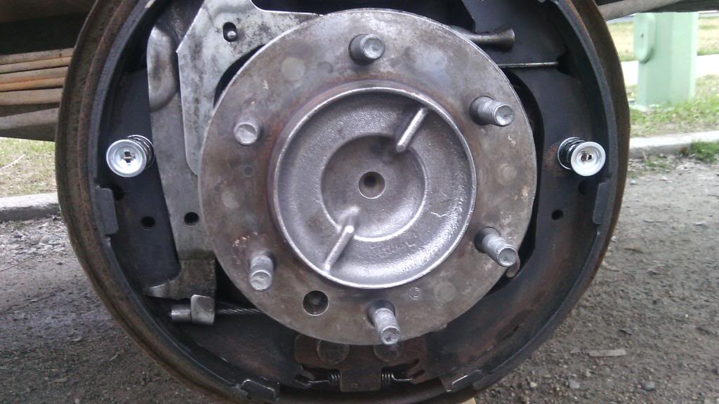

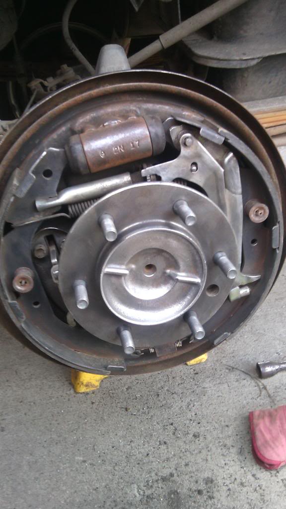

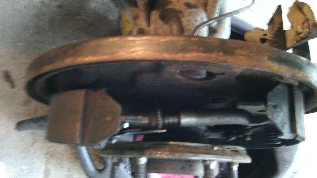

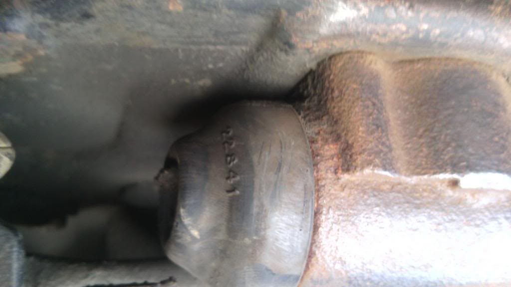

The first real issue/ repair not just boredom mod,
she was driving betty to langley from kelowna (350 km.. not sure what it is in miles lol oh, canada...)
and right as she got to the exit to get onto the Connector(main hwy) it just... wouldnt stop. she had to gear it down and pumped basically all the brake fluid out trying to slow down, but shes safe, i brought her our car and got the truck picked up and hauled home.
this is After wrestling it apart this is what i had to deal with Name:  IMG_20140324_162834.jpg
notice how the left isn't touching like the right.

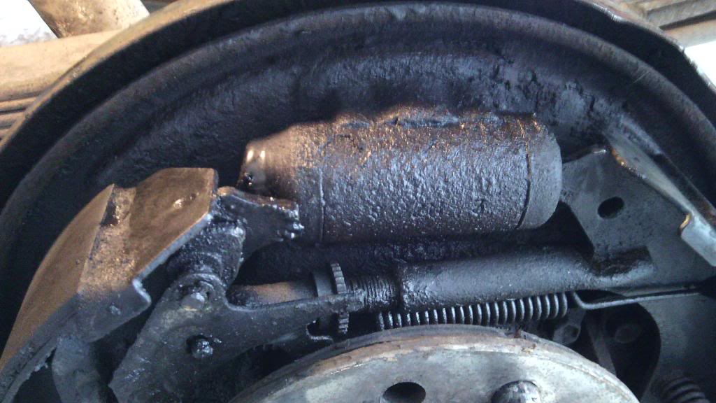

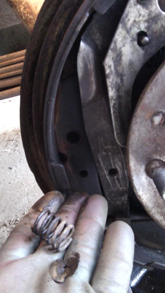

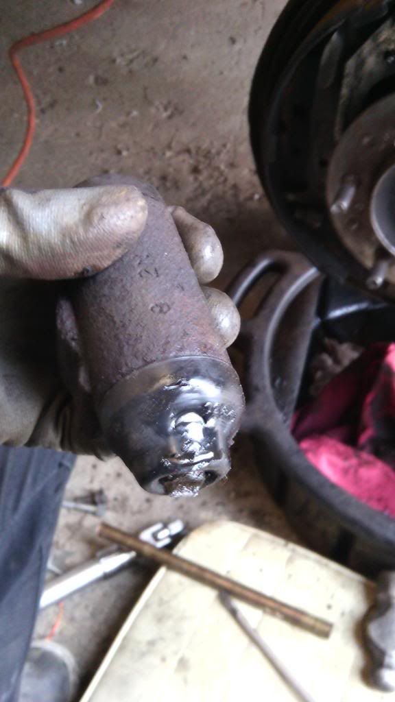

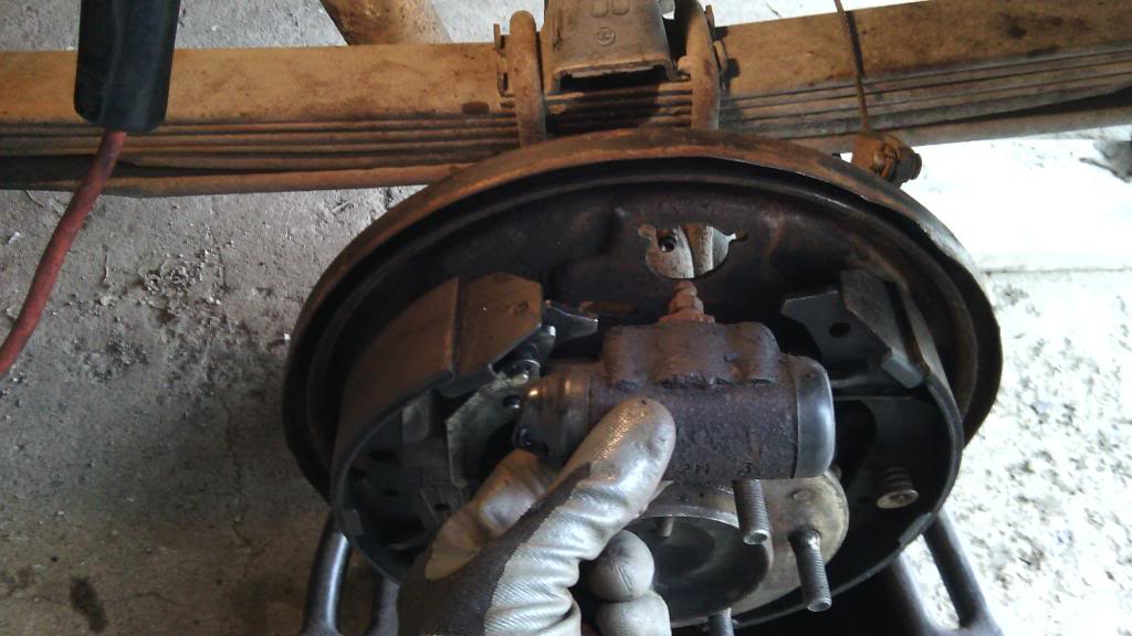

after tons of brake cleaner and penetrating lube i got around to taking the old cylinder out. brake line nut wasnt to rusty.
How the spring should look
How the front one looked
AND THAT let the shoe flop around
INSTEAD of sitting like this
Where the pivot gouged the boot and broke the tooth off

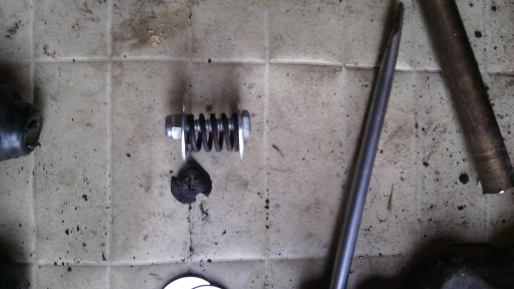

my new solution and the old rusty bent up washer. the pin was gone totally.
BACK TOGETHER [ edit- i used a longer bolt than in above pic]
hooked up and bled
ALL DONE!.... FOR TODAY...

Did you get it all adjusted into place? Also, I just did all this work on both rear tires but got a spring set, super cheap $13 from parts store! Worth it Unfortunately I have to take the wheels off and grease some things I didn't grease
Old Mar 25, 2014 | 06:57 PM
Yota's Avatar
Joined: Jun 2013
Posts: 363
From: kelowna BC
got a hardware kit, replaced my quick fix and the other oldie, and the bottom spring.
the big center spring seemed good, and is beefier than the replacement. so i left it.
and put in the rubber plug for the back.

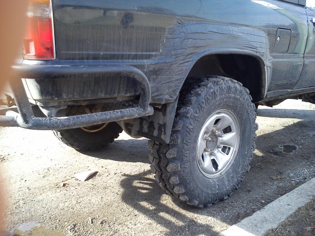

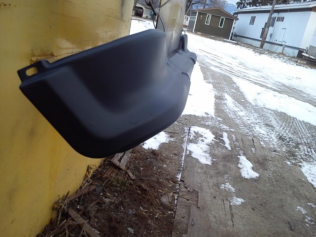

Other things ive done to betty since we got her last oct.

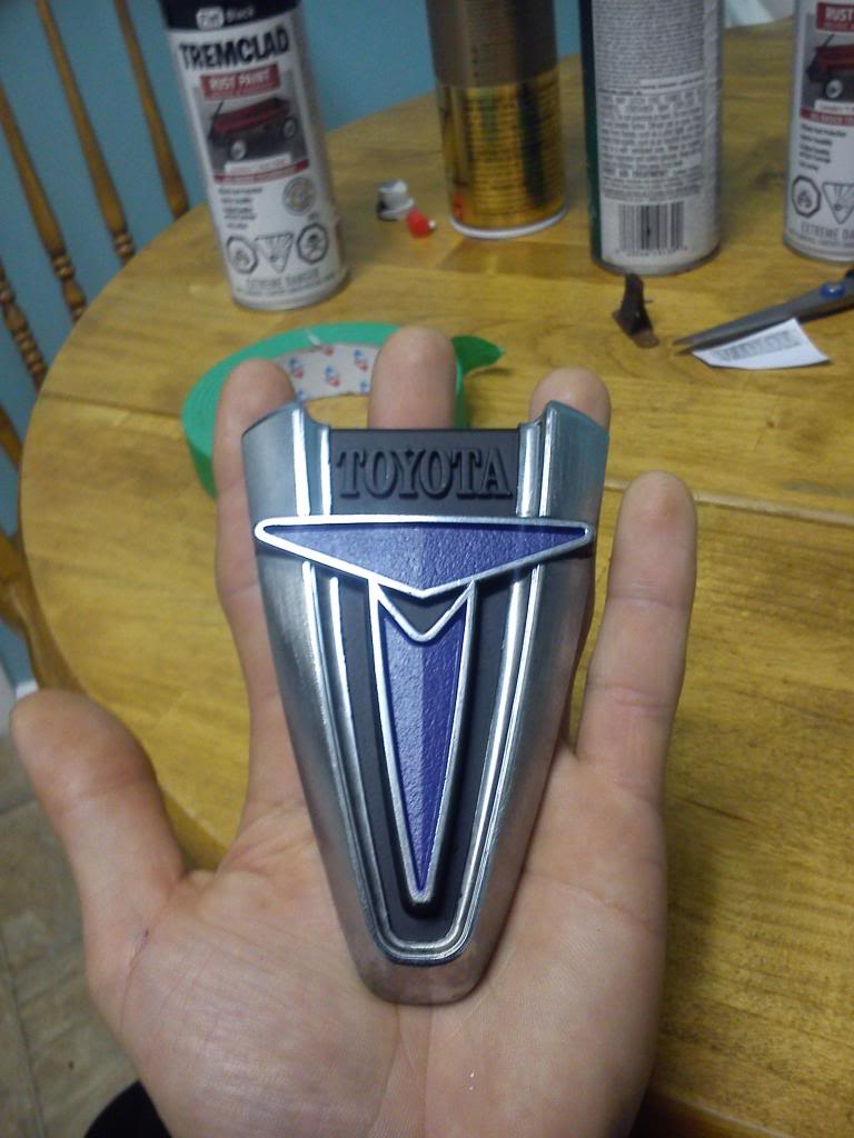

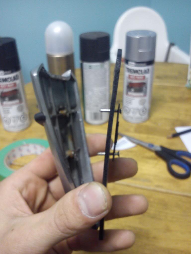

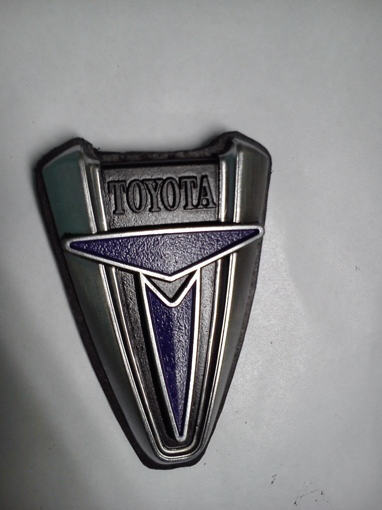

I got a grill badge and refinished it, but not sure where to put it
Got this from ebay,Name:  badge01_zpsec8953bd.jpg
decided it needed to go on betty.
taping and painting after i sanded it lightly
tadda

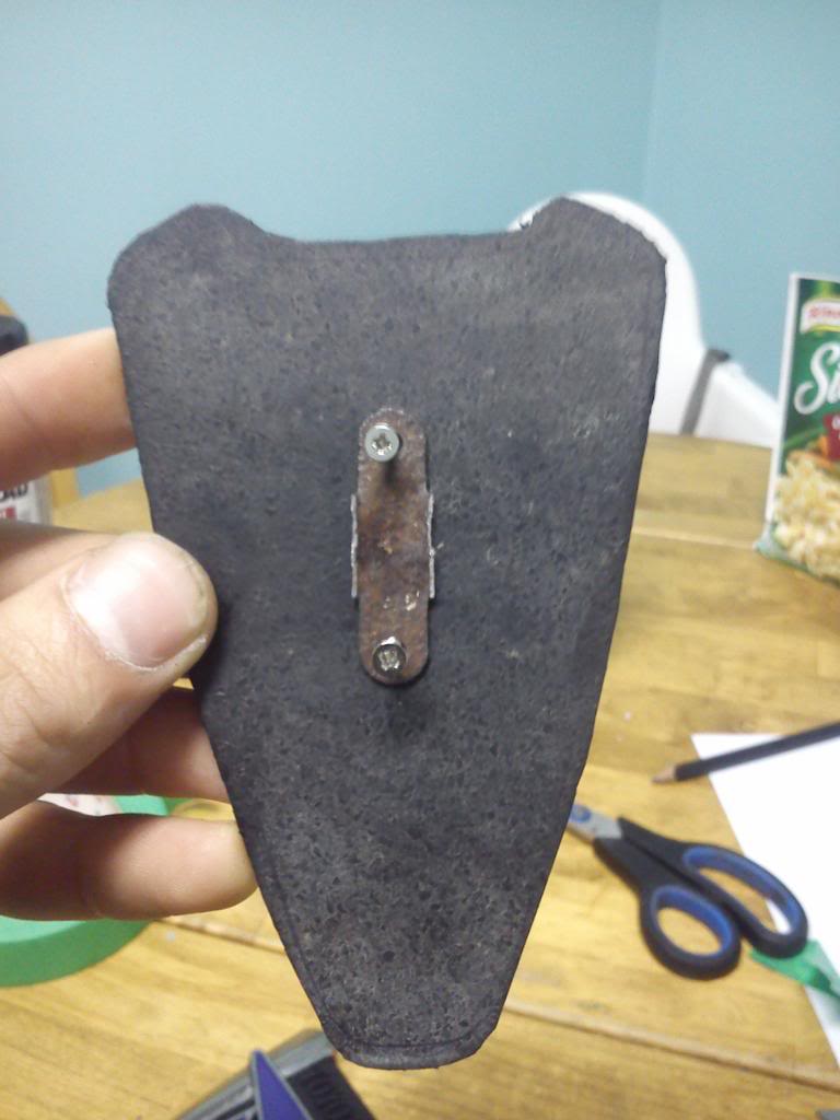

used the holes from the old grill clip to mark holes in the riser i made from the cropped mud flaps
all done
just need to put it on the truck. .. somewhere. might put it in the grill. might put it on the hood. or might put it on the tailgate.
not sure.

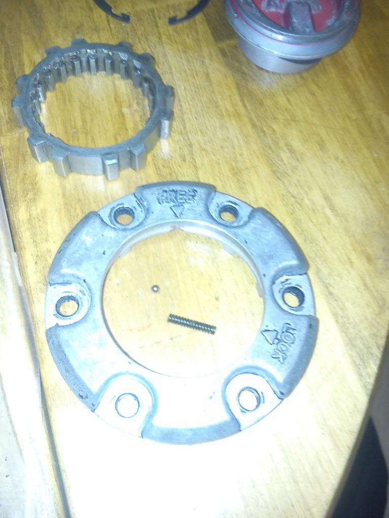

oh dont forget this day

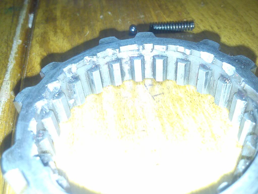

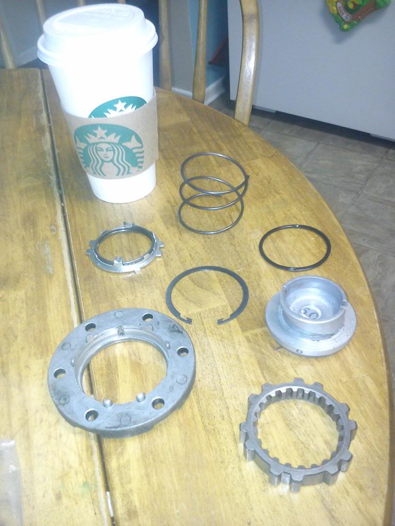

The first time me and my friend ben took the hubs apart to replace the bearings (both sides) we put something back together wrong. oops...
i got a new gear from Tyson, (toyotaking)
guy is awesome and has alot of sweet rigs and lots of parts for sale.

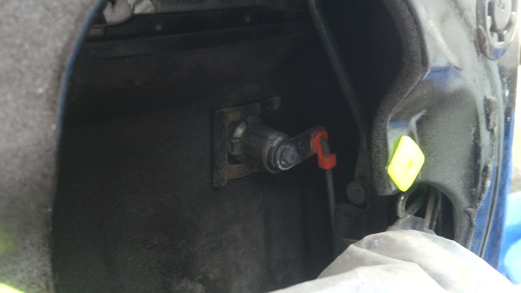

i replaced the weather strip on the outside of the drivers window and all the broken clips that where doing a horrible job of, ... working at all without the strip flapping in the wind. picture soon. to dark to take pics.

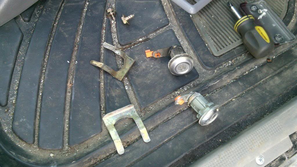

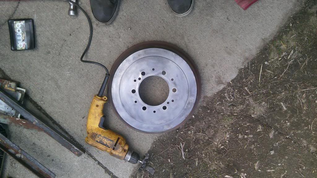

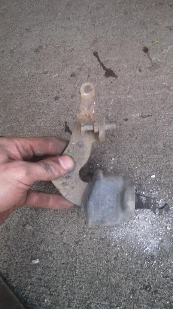

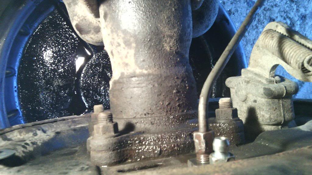

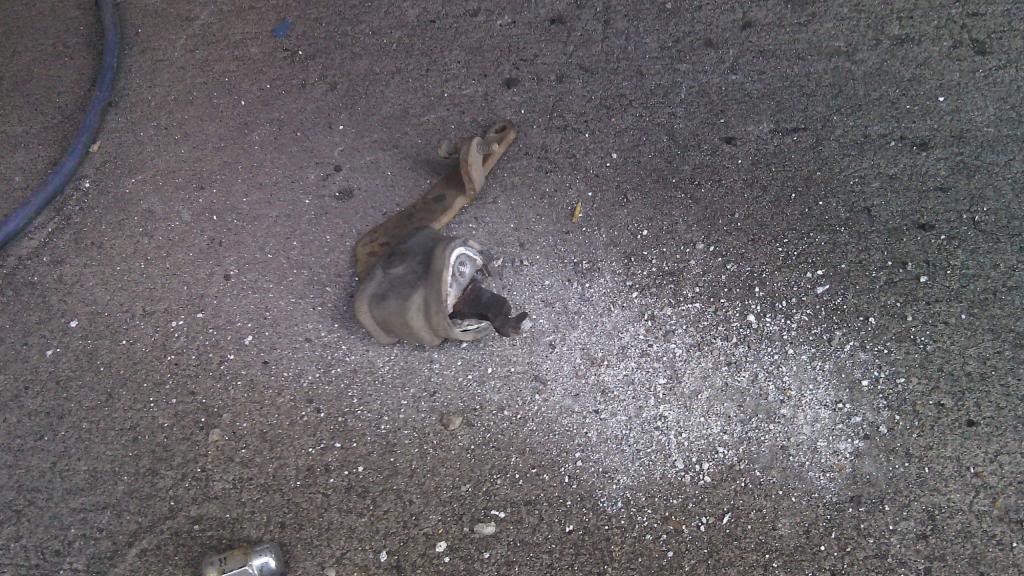

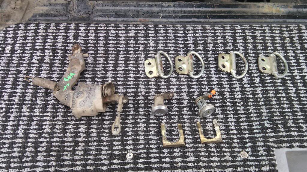

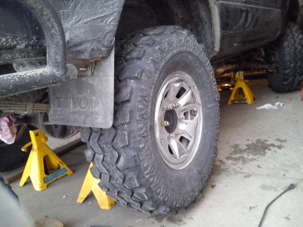

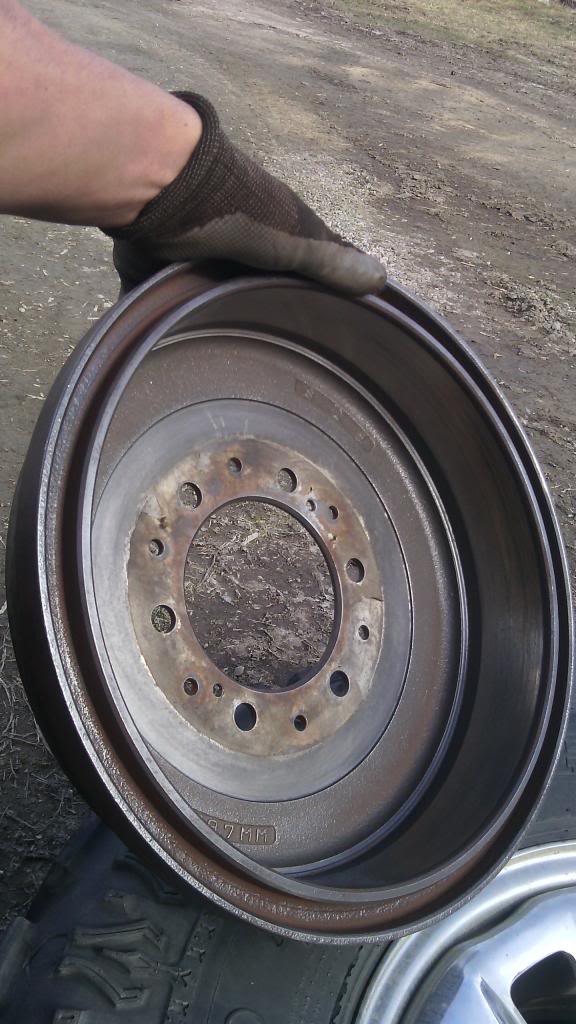

seized parking brake lever replaced and door lock
while at pick n pull i got these for 15 bucks

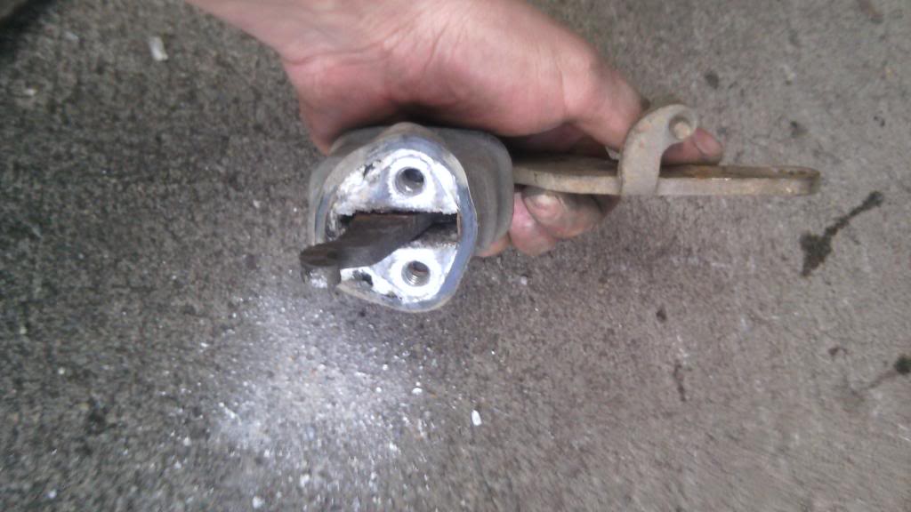

took the wheel off.
took the boot off, in my collection i found a bolt that said "sr5 88" for the boot release holes.
worked like a charm.
the teeth on this cylinder are pretty worn down too, so these will get replaced soon too.

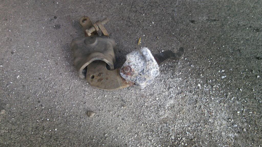

got the ebrake lever off. was super corroded, and rusted solid. even banging it with a hammer didnt even move
cleaned this up a bit
wanted to see just how bad this was
was pretty bad.
27 yrs old and can still clean up pretty good.
back together and (already painted the other side)

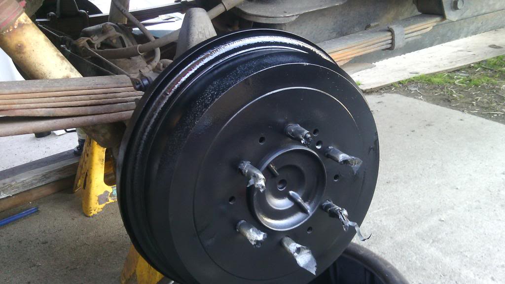

wired the rim and lugs on both sides, looks a lot better for now

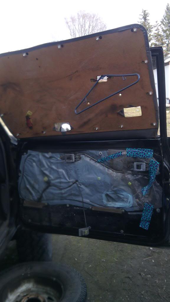

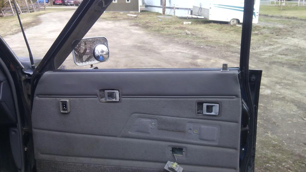

took the door things off
happend to have a coat hanger, worked pretty good.

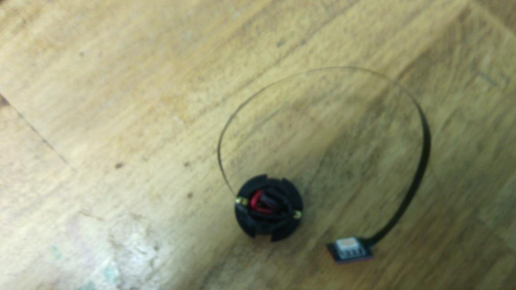

found it, popped the orange clip, popped the metal clip
found some at pick n pull that matched my key. so took out the spare one that matched machines key

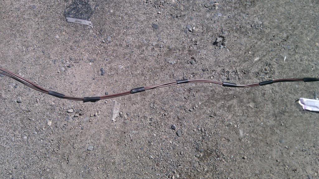

helped a friend move this morning and found this on the road in front of her house, so i cleaned it up and slapped it on for fun.( see how long it takes jenna to notice it)
and heres betty all done for today

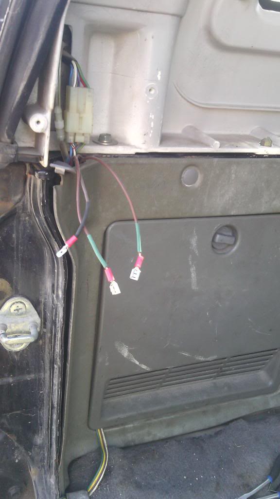

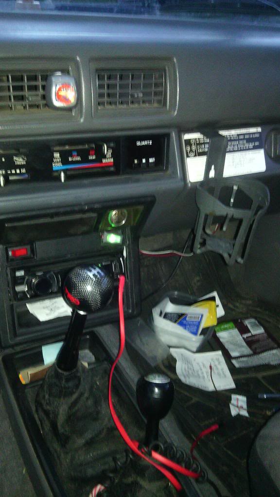

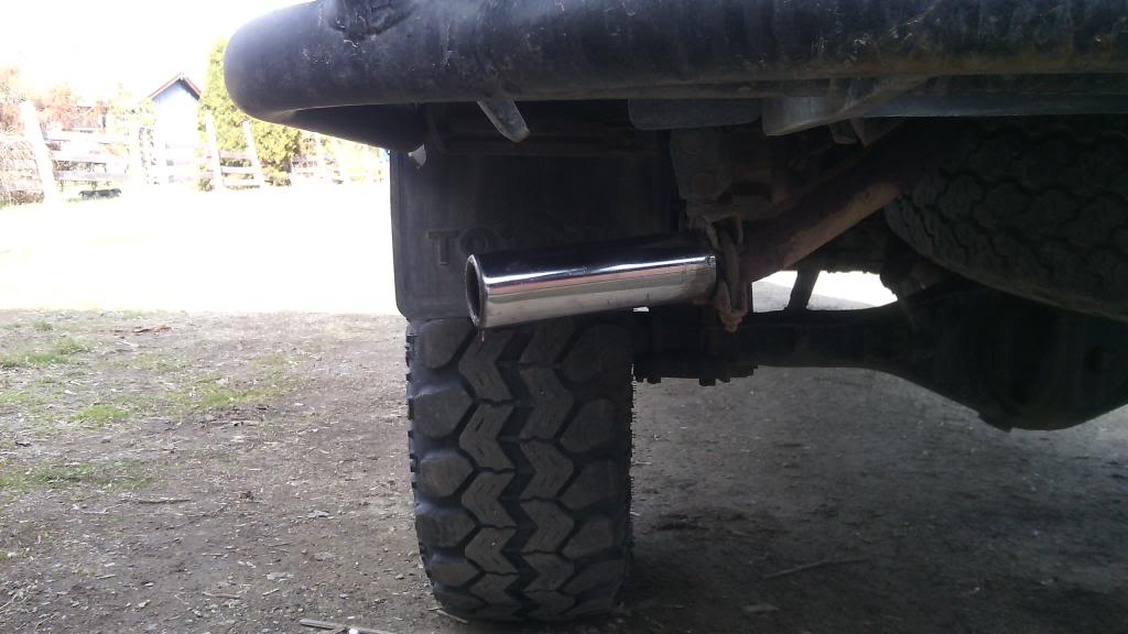

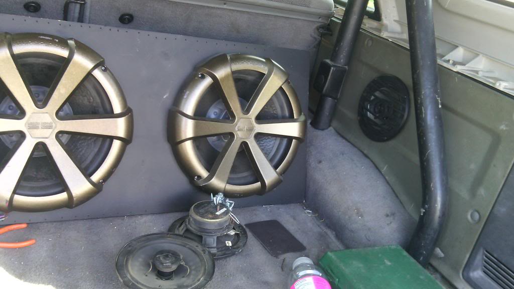

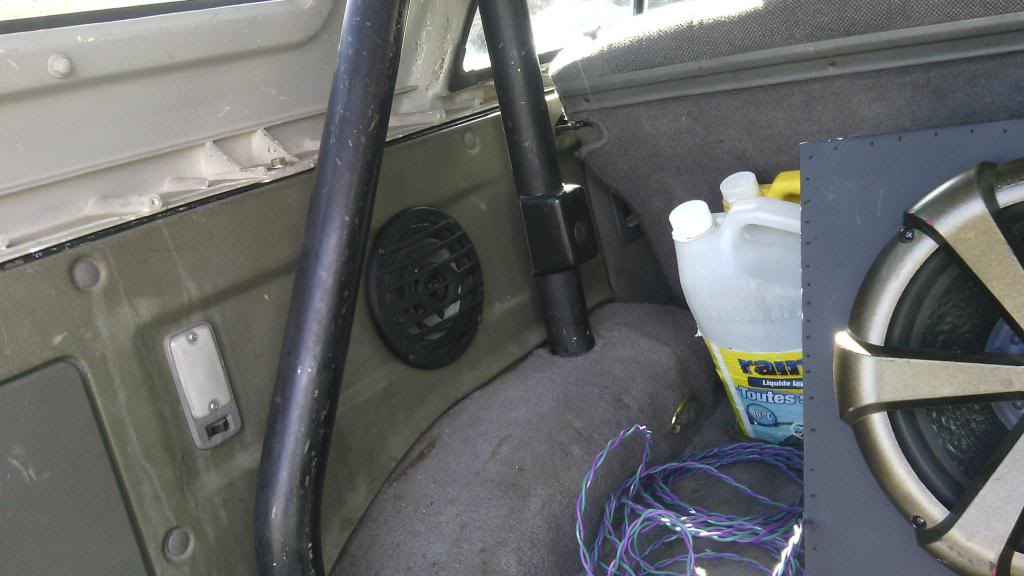

so the cheap exhaust tip fell off and jenna backed over it lol, but i did get some other things done. got some marine speakers for the back got them cut in and i finally wired in my cargo light.
So this is what i started with

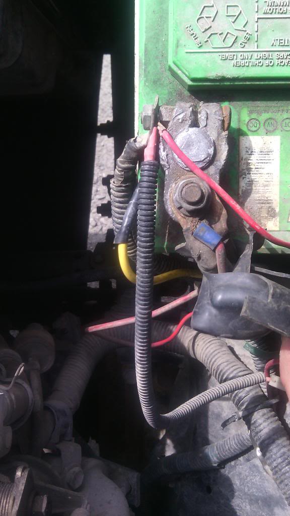

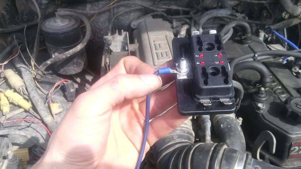

i added this to the mix (in time i will wire everything to this block and another one like it)
put these in today (got them from a garage sale for 10 bucks)
with the subs and old crackley ˟˟˟˟s

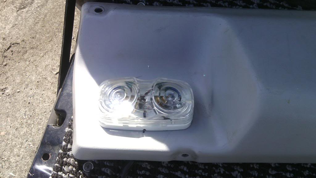

the original cargo light works too
wired in the cargo light to the wiper motor housing
some wires
quick connects so the top can still come off
need to cut out the switch housing but im tired

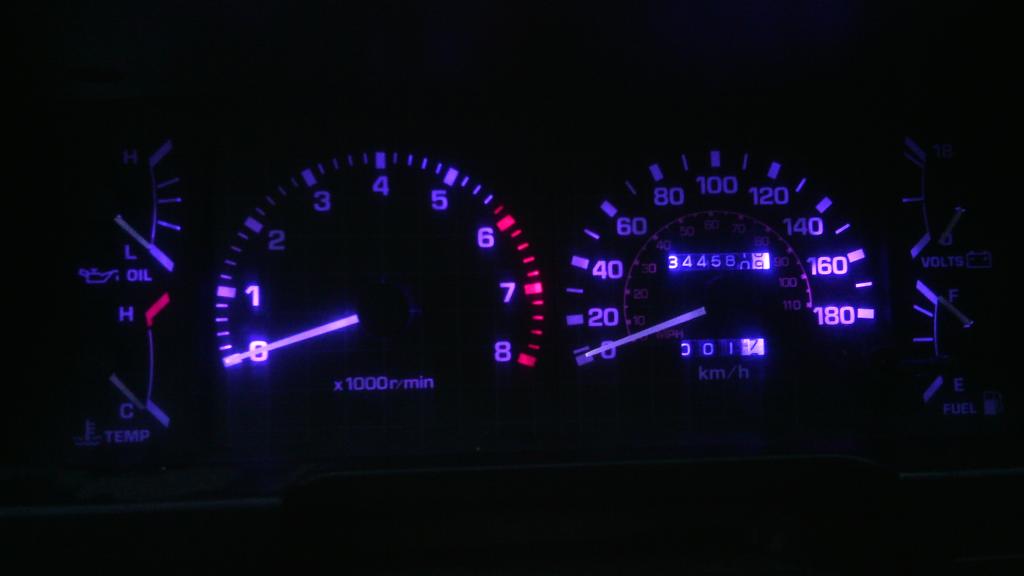

all lit up

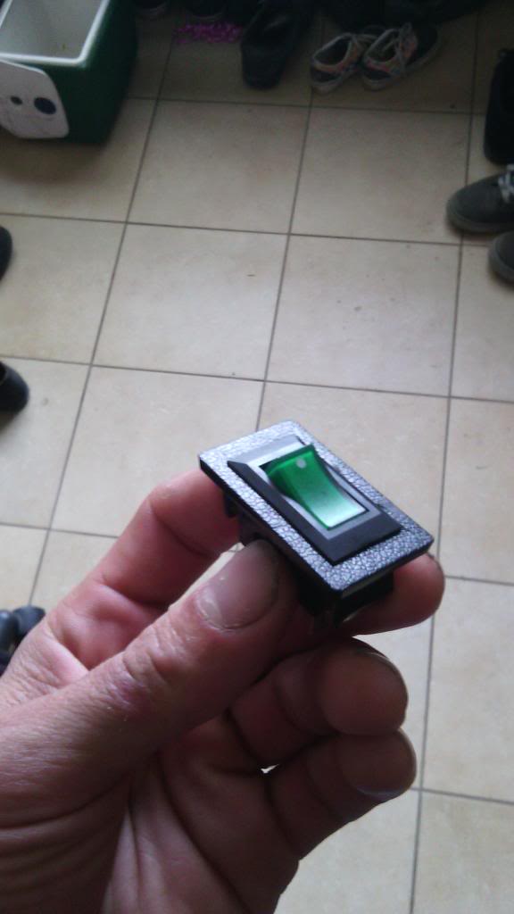

switch mounted

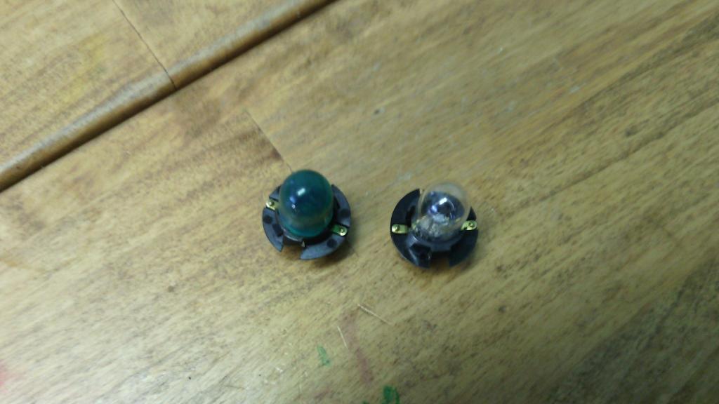

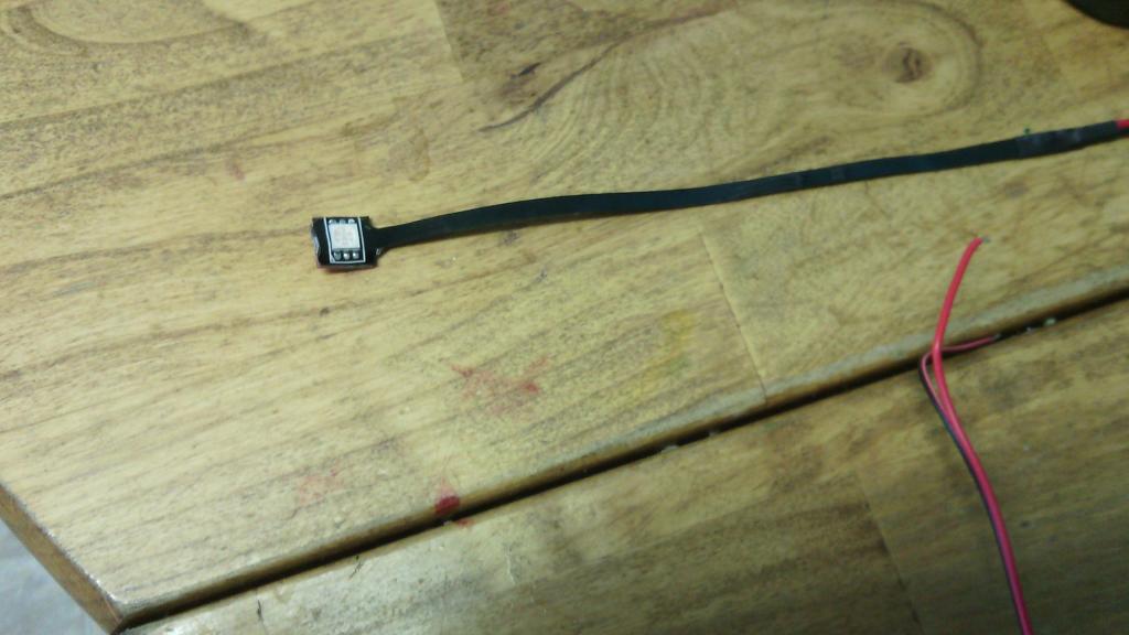

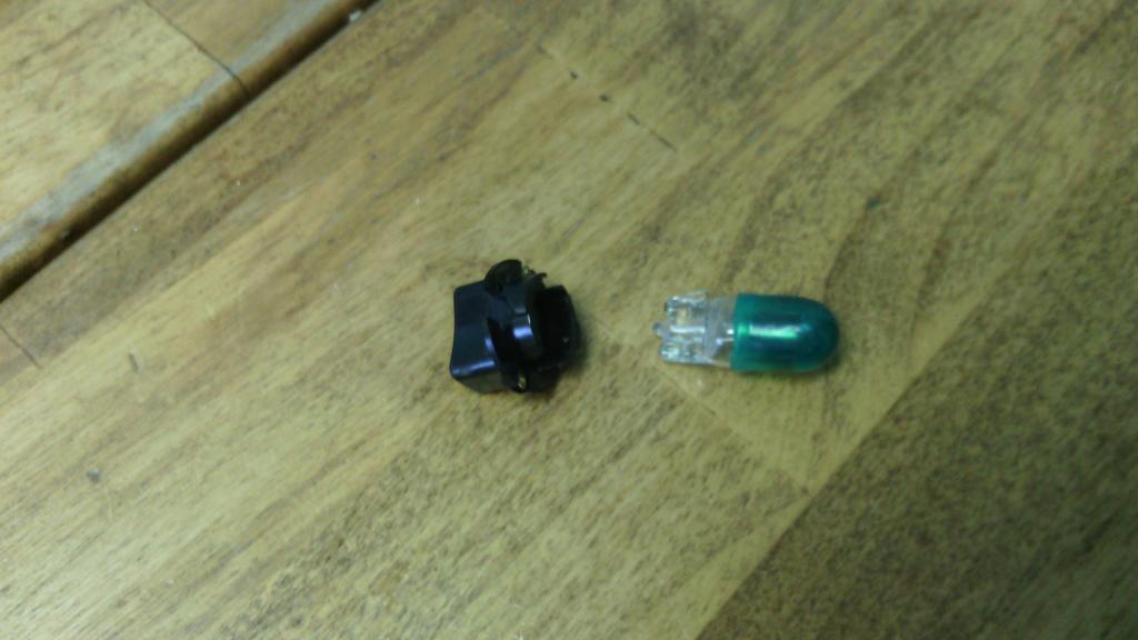

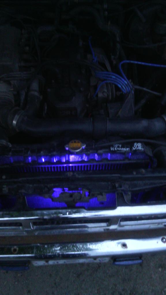

purple led dash lights and grill light
i did this today with some leds i got from ebay for 7 bucks. and a rocker switch from princess auto for 3. (plus some quick connects and wire i had laying around. and some fuses that made their way home with me from p&p)
my phone died or i would have taken more pics for a write up
but this write up is good too.
https://www.yotatech.com/forums/f116...10-mod-218638/
