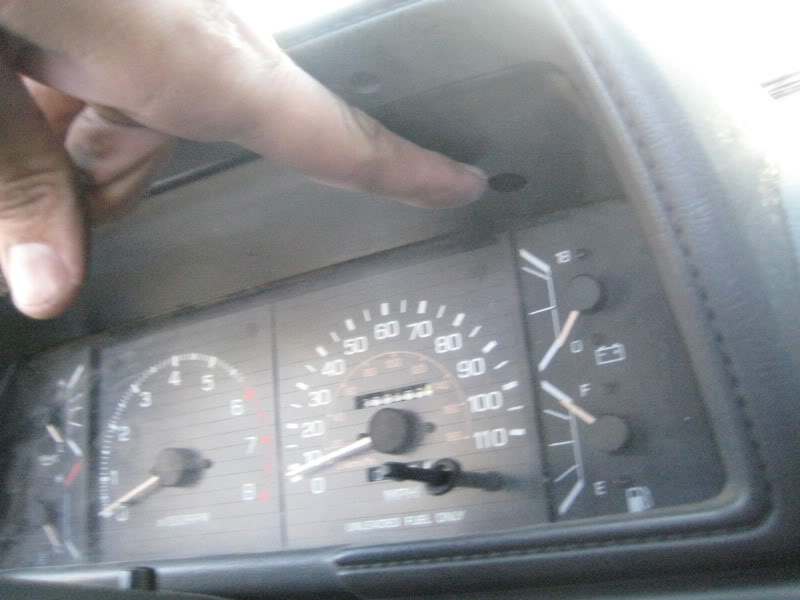

So, I was inspired by this thread to replace my faded dash lights today - best $10 mod ever!
Below are some pics:
The dash before, with no lights on:

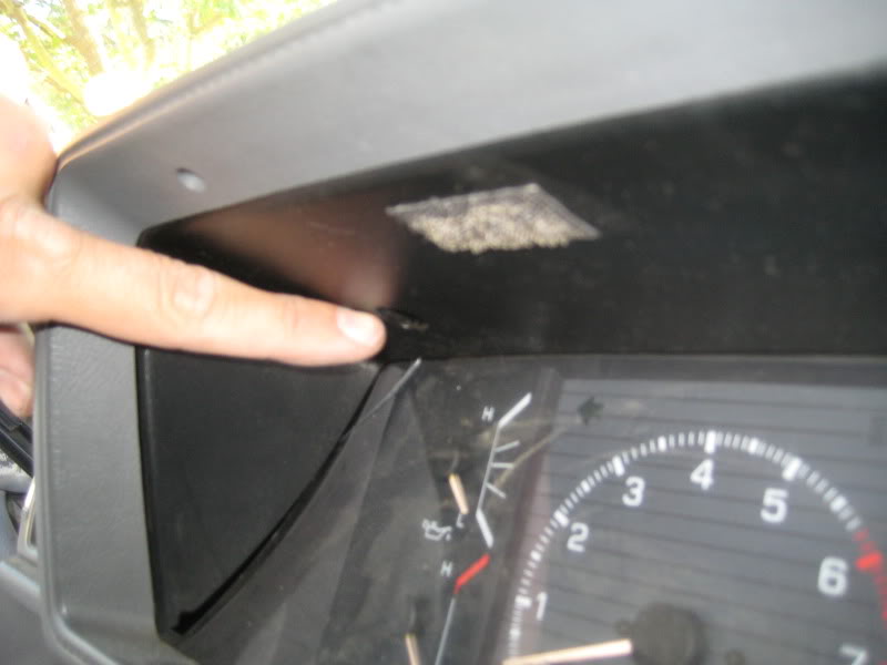

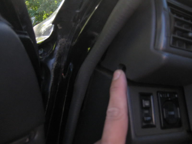

There are 5 Phillips screws you need to first remove to get the dash bezel off:

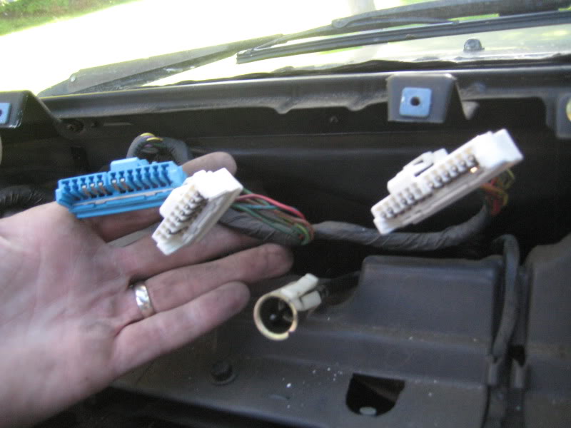

Disconnect the 3 plugs from the dash to the dash bezel:

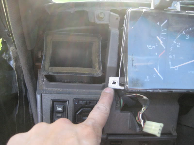

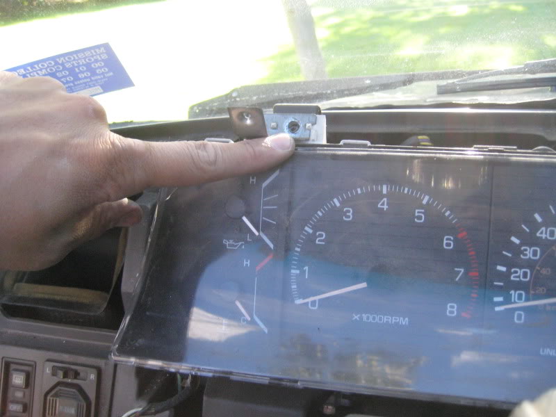

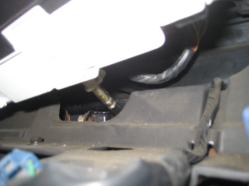

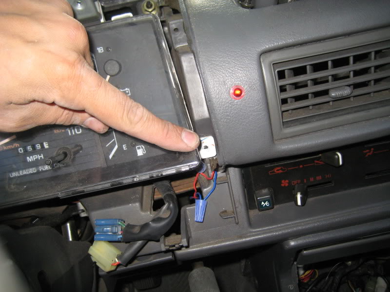

There are 4 more screws that hold the gauge cluster on:

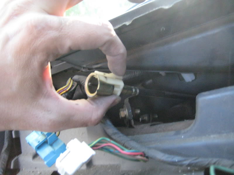

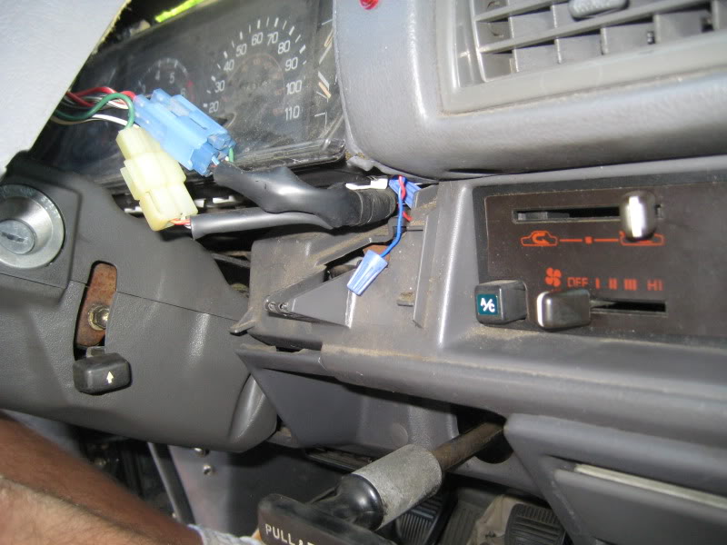

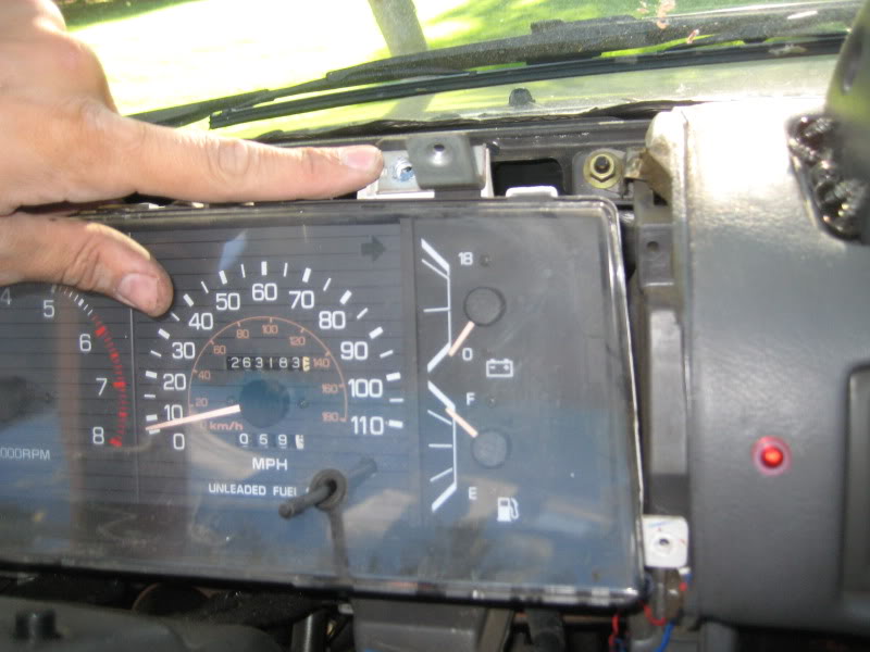

When you pull the gauge cluster toward you, there are 3 plugs that connect, as well as the speedo cable, which you see in the photo below:
To get the speedo cable off pinch the plastic tab and pull away from the gauge cluster, as you can see the tab on the cable below:

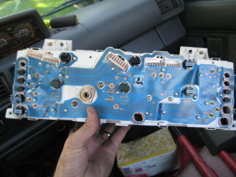

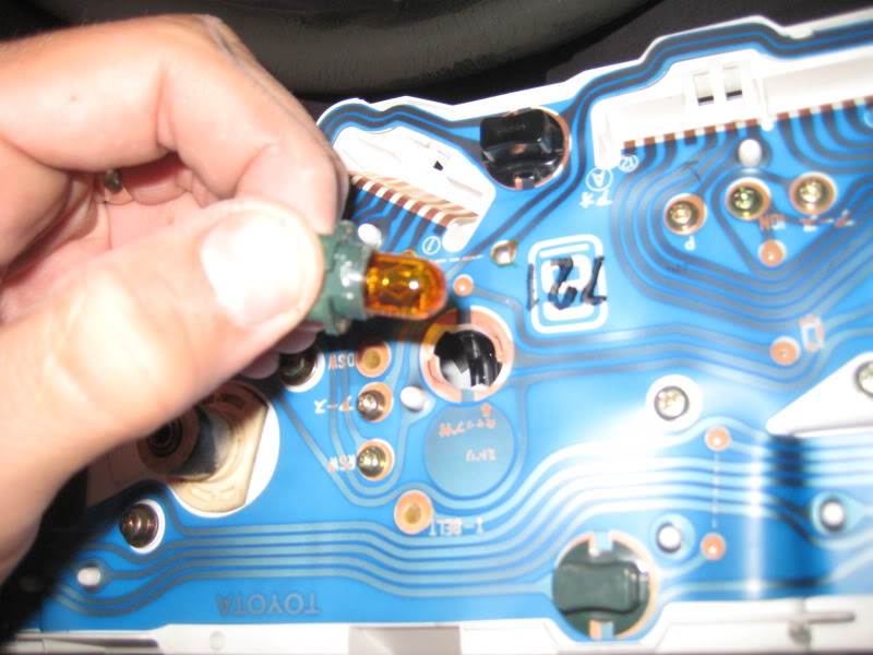

Gauge cluster is OFF:

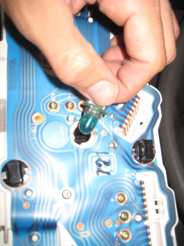

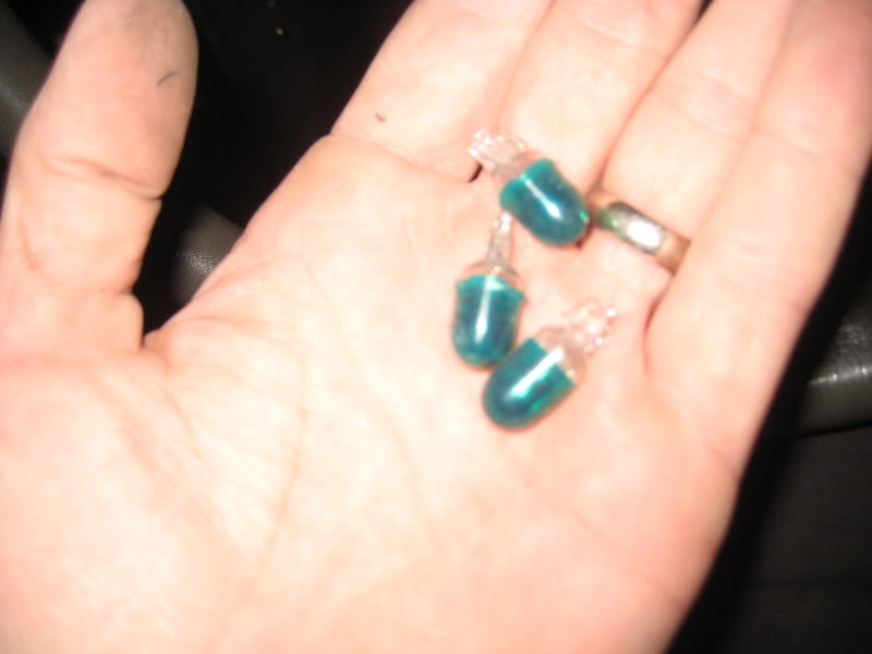

The OLD bulbs...covered in green plastic skin:

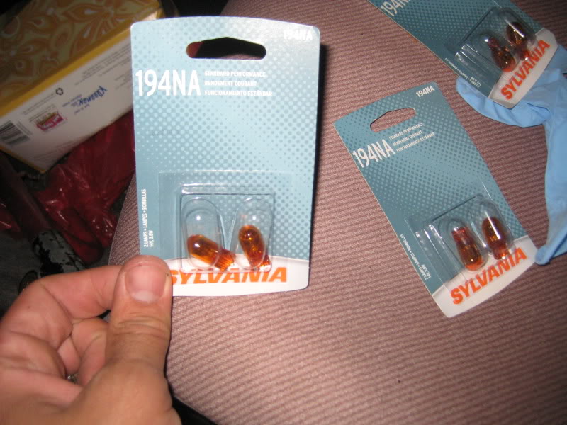

The NEW bulbs:

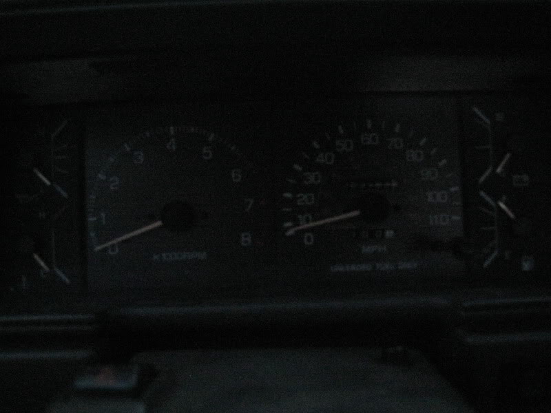

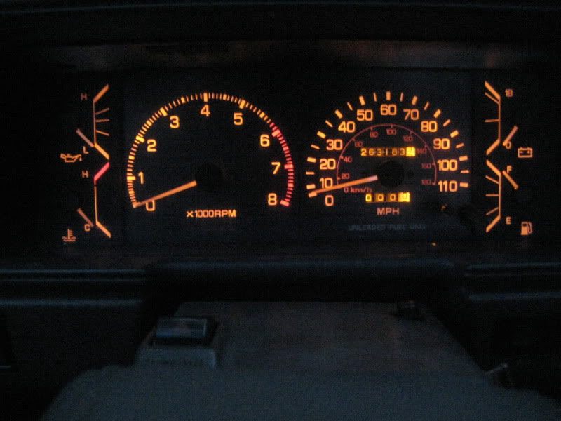

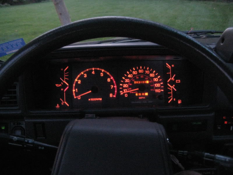

AND THE NEW DASH WITH AMBER BULBS:
Unfortunately, for some reason, the right side of the gauge lights fade in and out randomly....still need to figure out why that is and how to fix it :/

NICE, ...so it worked? Glad to hear, Phil.... Hope I steered you more in the right direction rather than wrong? hahaha. Looks great, ...now more vid of it not flickering out! lol.
My buddy has Red, btw, and it looks great. Another person I barely know has blue in there, with what he said are 'wide spectrum led's'.... ??? It's REALLY bright, but I can't see a need for any brighter than what you have, Phil.... LOOKS GREAT! 2 THUMBS UP! LOL.

thanks Chef - I tested voltage on the circuit board with the guilty bulb in place and lights on - 12 volts. That makes me think it's a loose Yazaki bulb carrier connection....so I took out all 4 bulbs and carriers, bent the 2 contacts out a little more on each carrier, and then used CNC electrical contact cleaner and dielectric grease for all the connections.
After hooking it up again, and letting the lights stay on for a minute or two, it seems to be holding with no flicker...I guess time will tell if that did the trick

I'd be a little weary of it though... 194 bulbs are brighter, but with that extra light comes more HEAT; I'd pull the cluster back out after about a month of use, just for a checkup to make sure nothing's getting too hot and discoloring or melting
